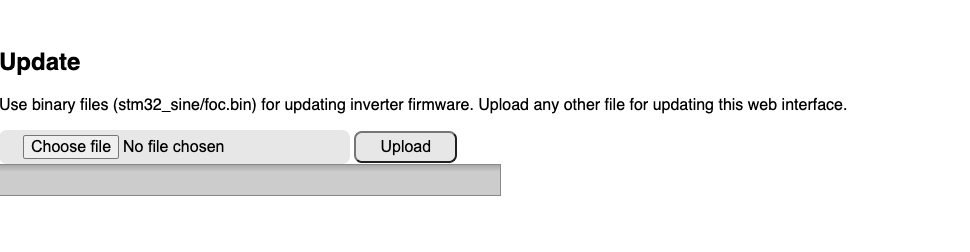

Now I realize that. The / was confusing to me. Dementia catching up. Now have downloaded stm32_sine.bin and board working

Thanks ... but these releases do not include stm32_sine/foc.bin

OK ... but I am puzzled as to why the wifi interface says to downloadd stm32_sine/foc.bin

Files
Can some direct me to where I can download an stm32_sine/foc.bin file for SDU board ?
