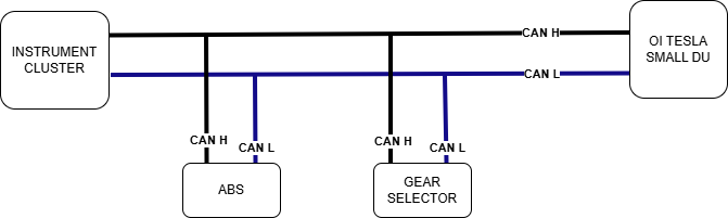

Sorry, forgot to add the CAN connection drawing. The Instrument cluster and OpenInverter board are on both ends of the bus, each with the 120ohm resistor.

Re: Sending CAN Buss comands
Post more info. Params + pictures.
What devices are on the bus? I anything acknowledging the CAN being sent?
Here are my CAN parameters
These are the CAN messages I have mapped for transmission:
For testing, I only have the Landrover Freelander ...
