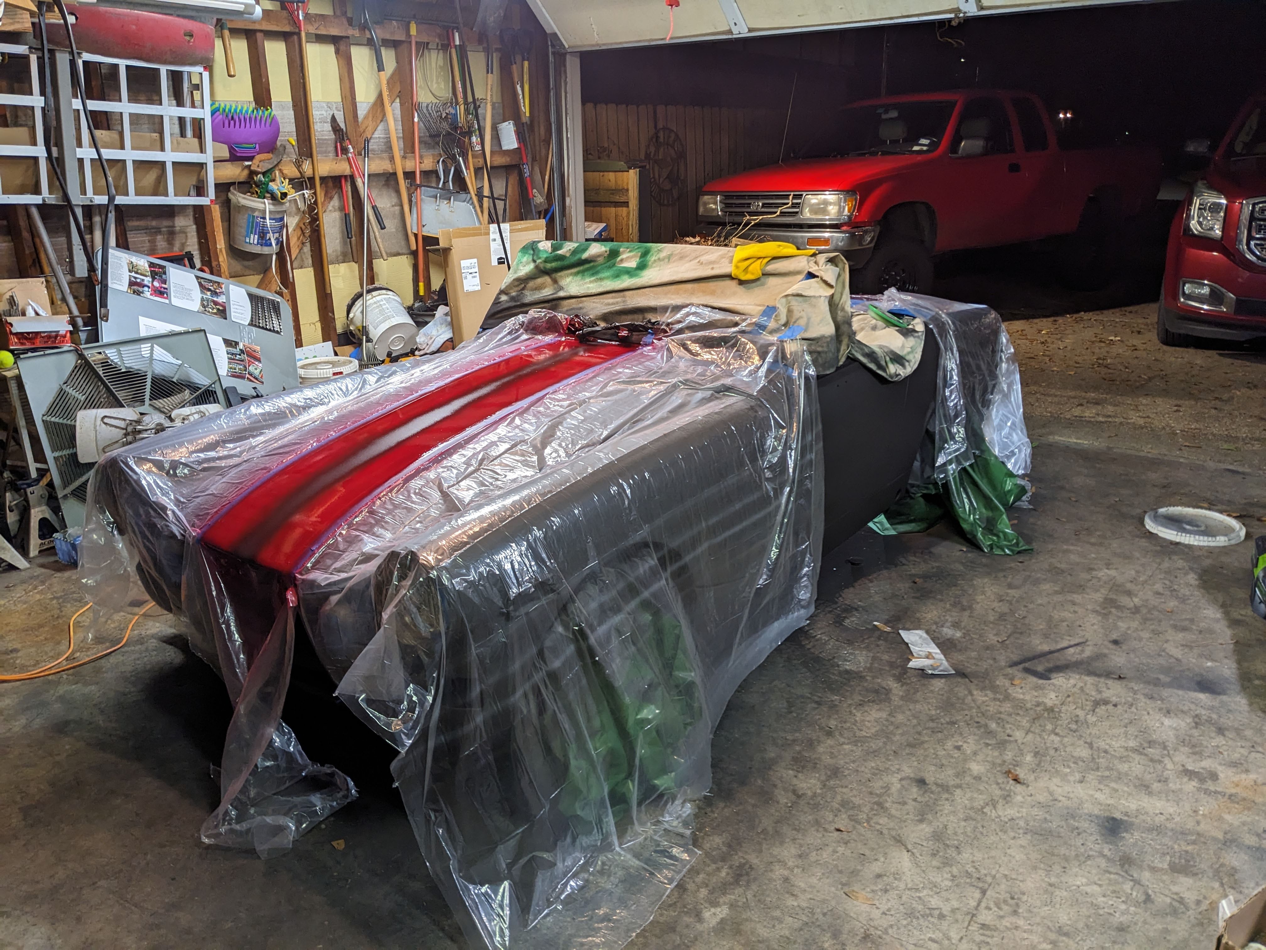

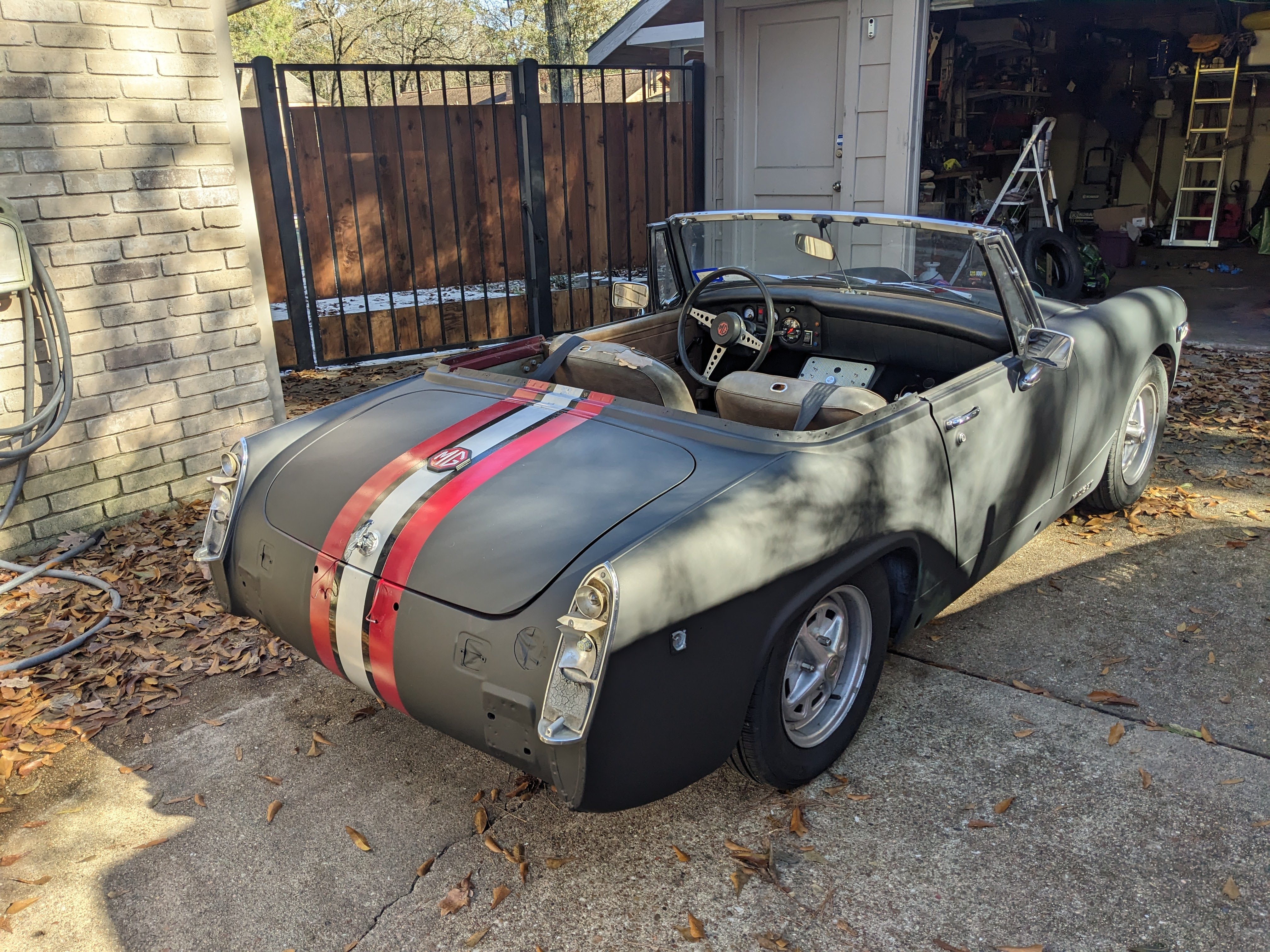

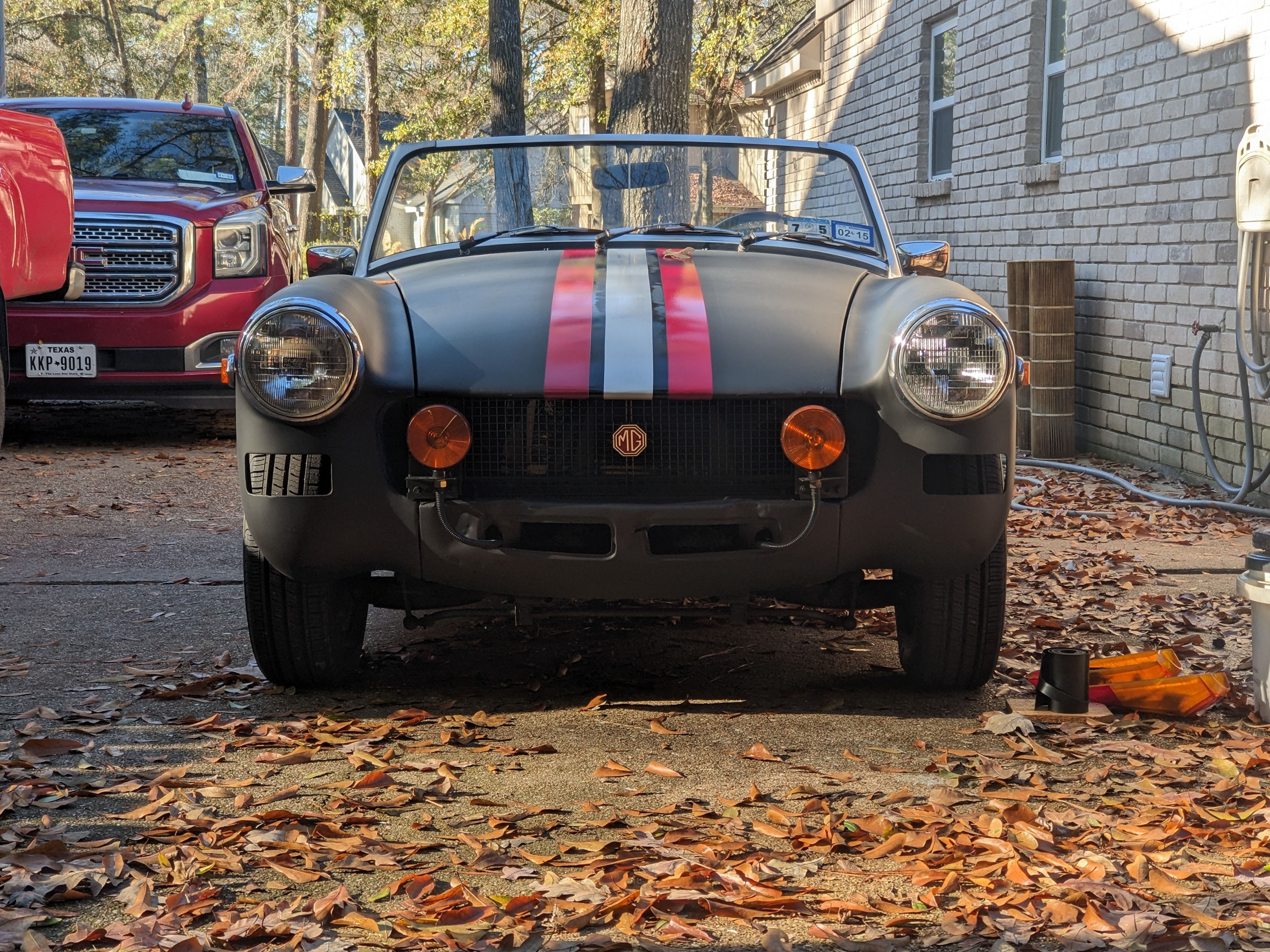

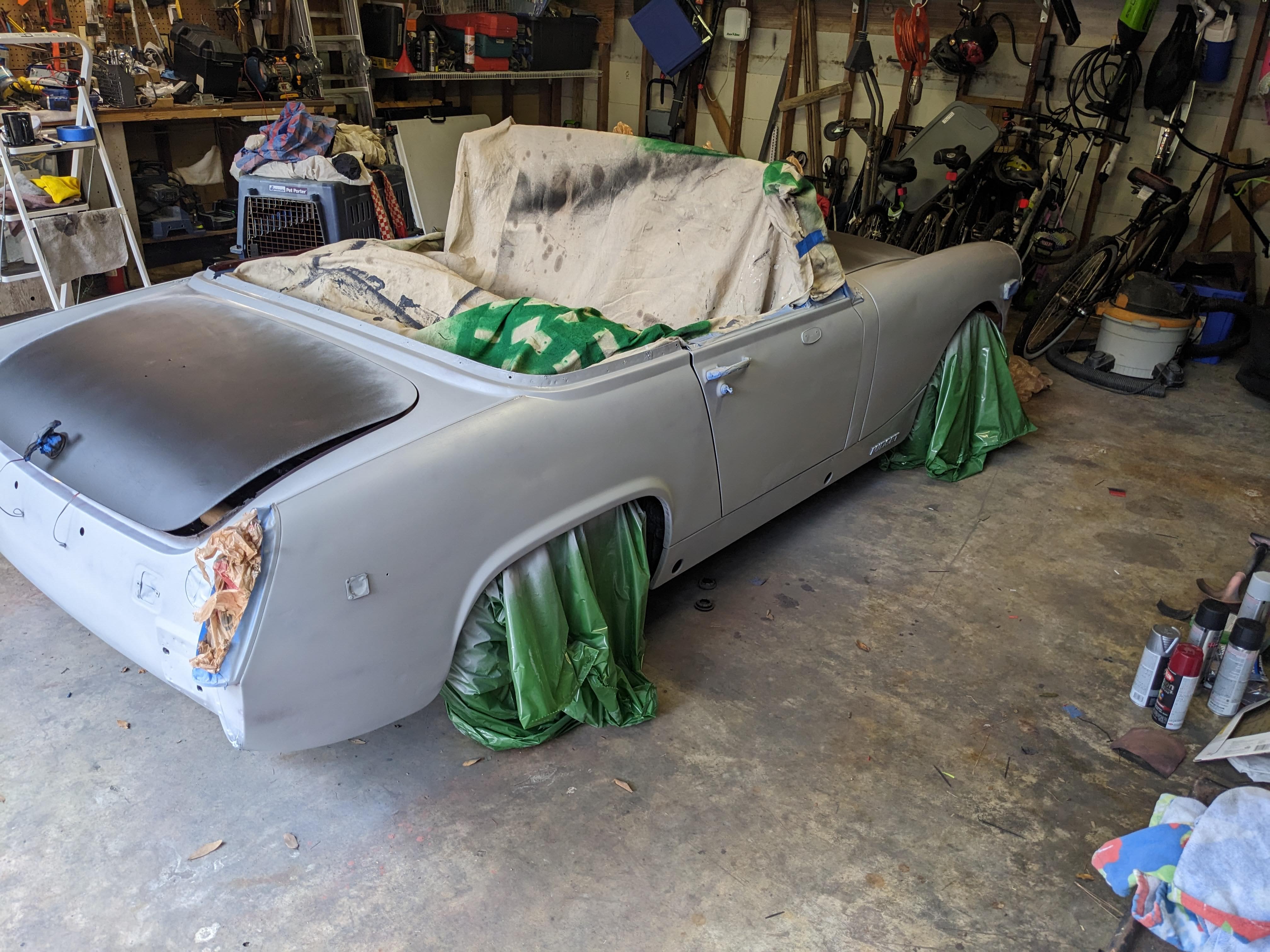

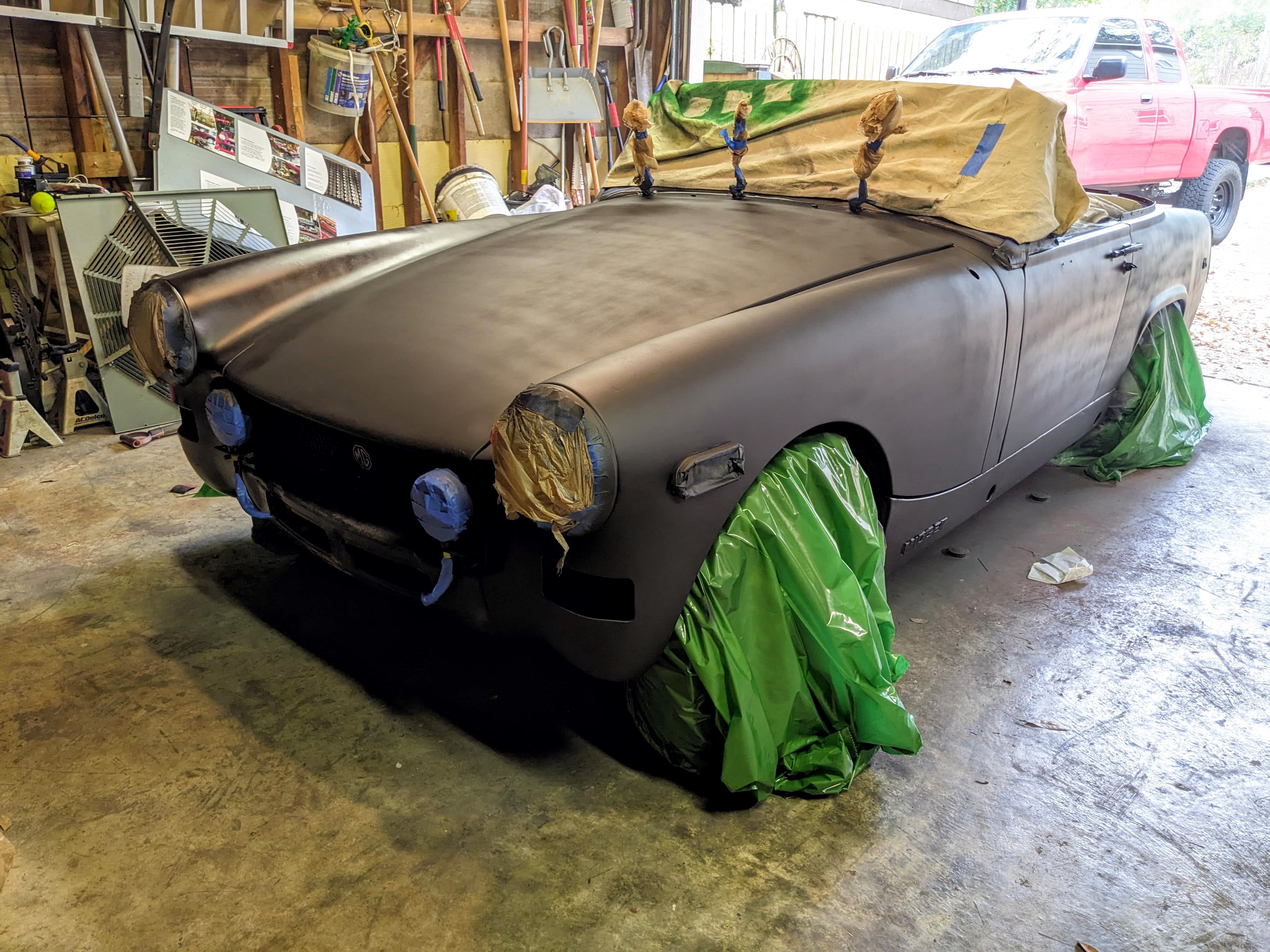

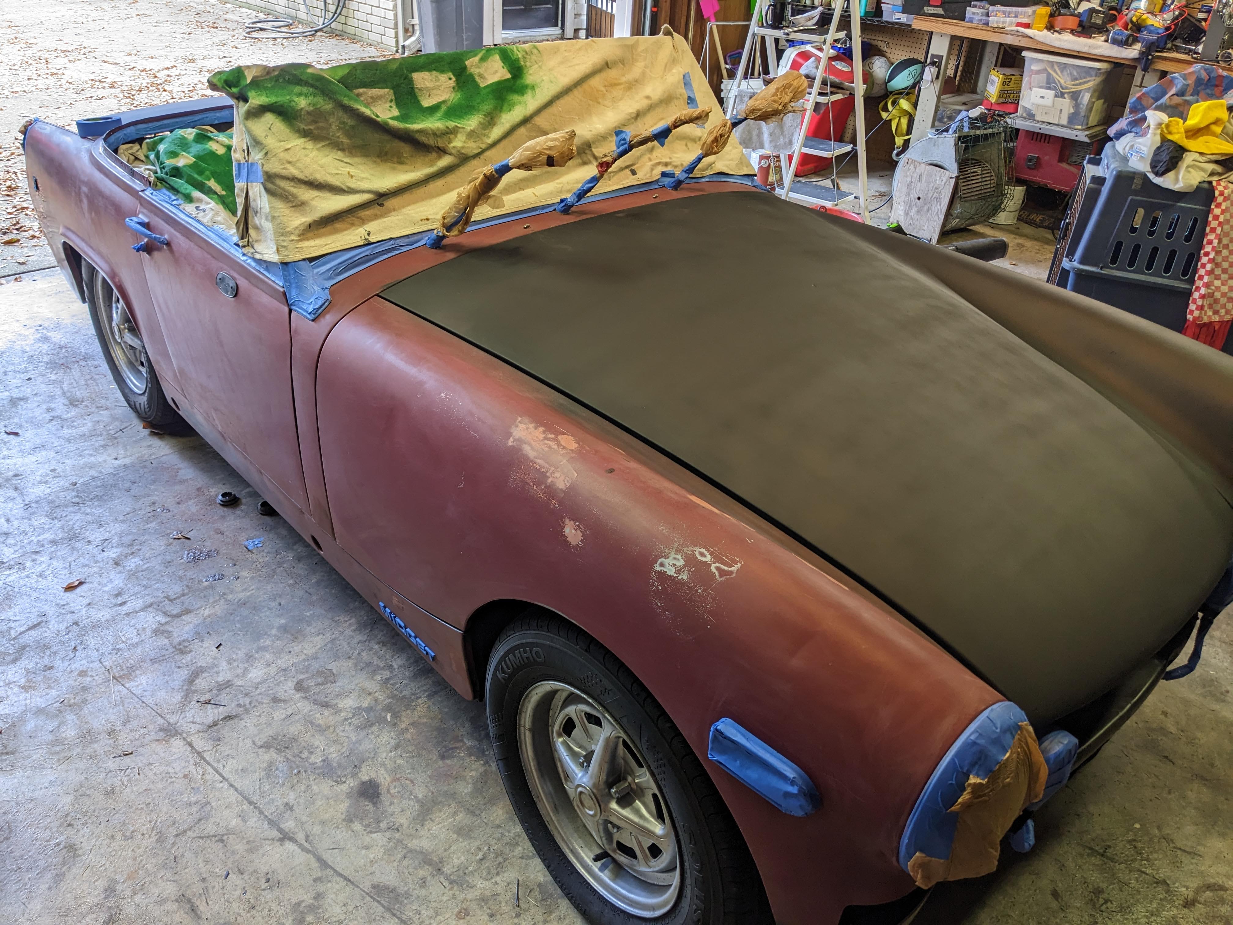

NEW PICS --
Rust-o-leum paint job complete. Officially 2 full years since I started work on the car.
