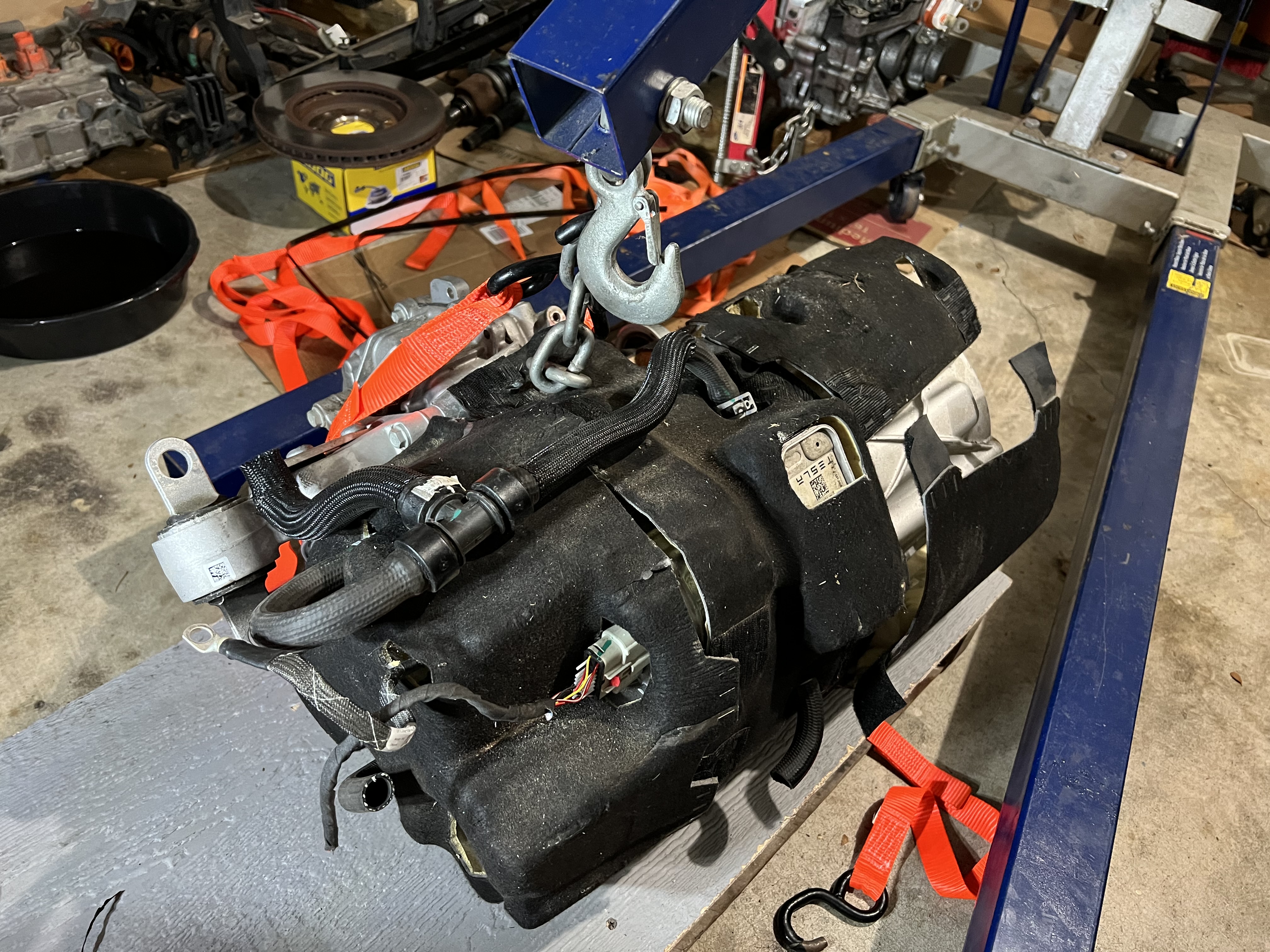

My 2018 model X front drive unit came with a ground strap. I connected it to a chassis motor mount.

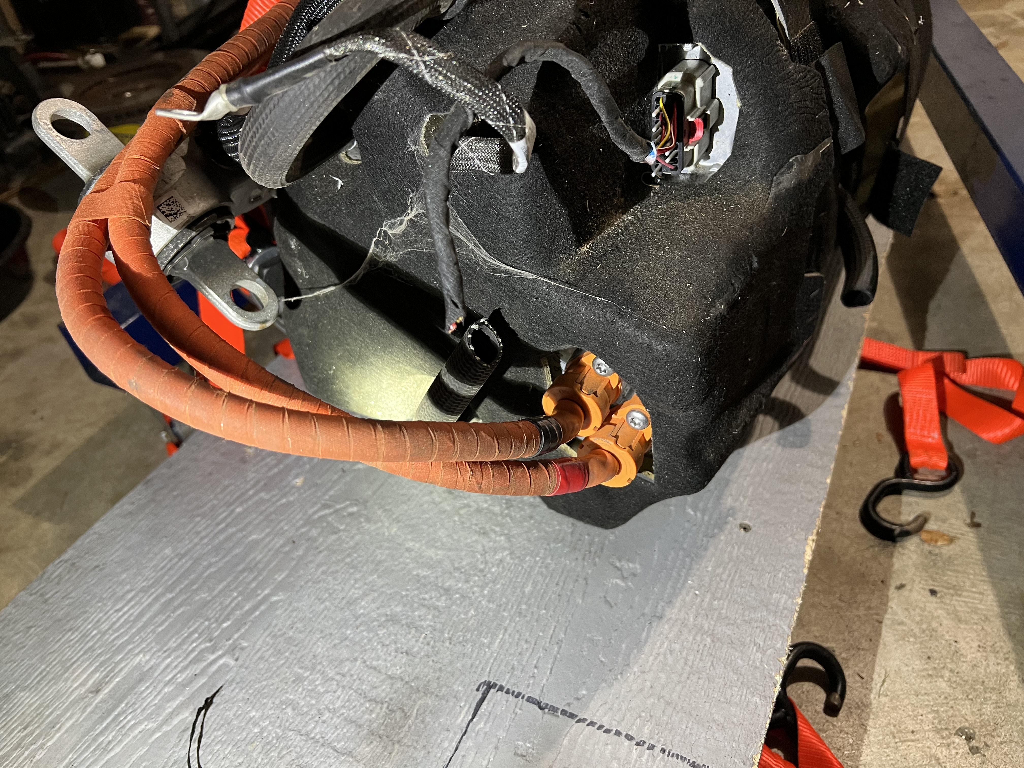

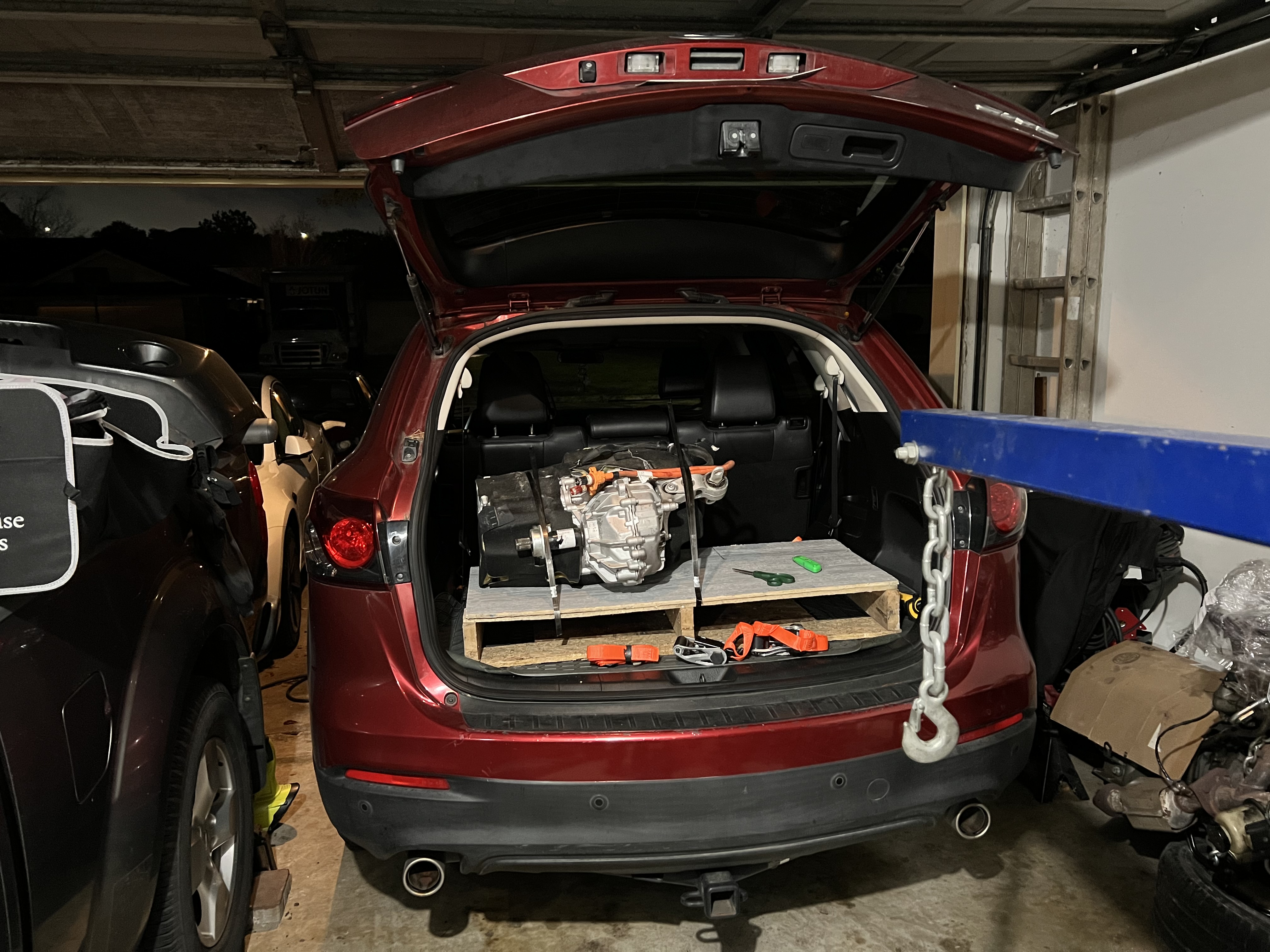

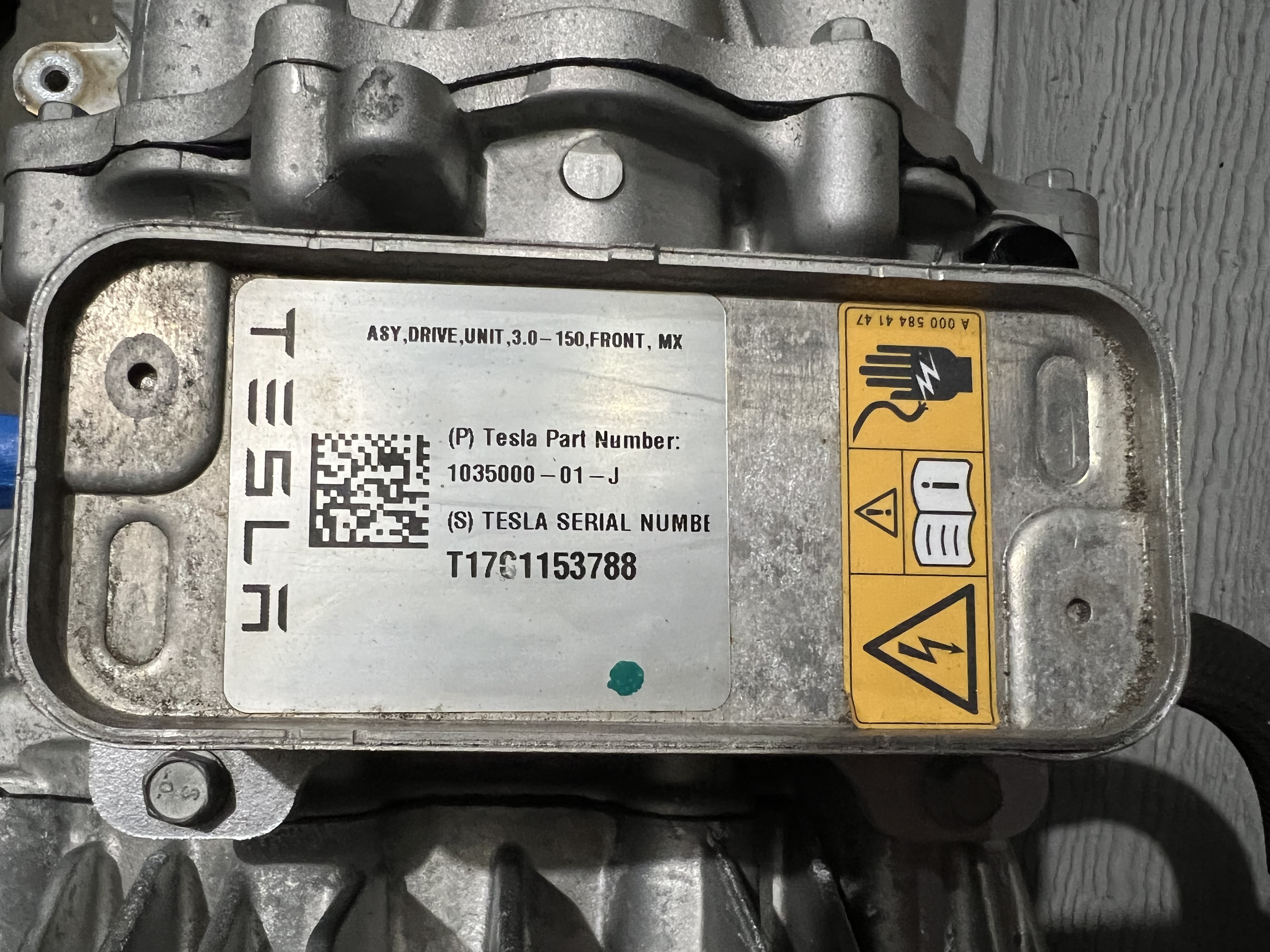

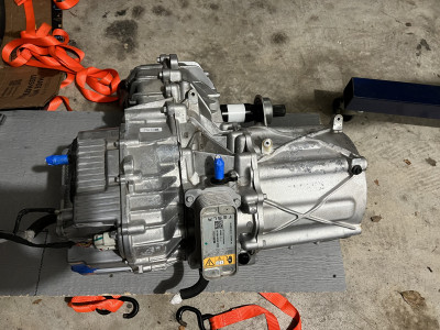

I bought a 2018 Tesla Model S/X front drive unit! This is from the alphaautollc ebay store for $1500 shipped with 30k miles.

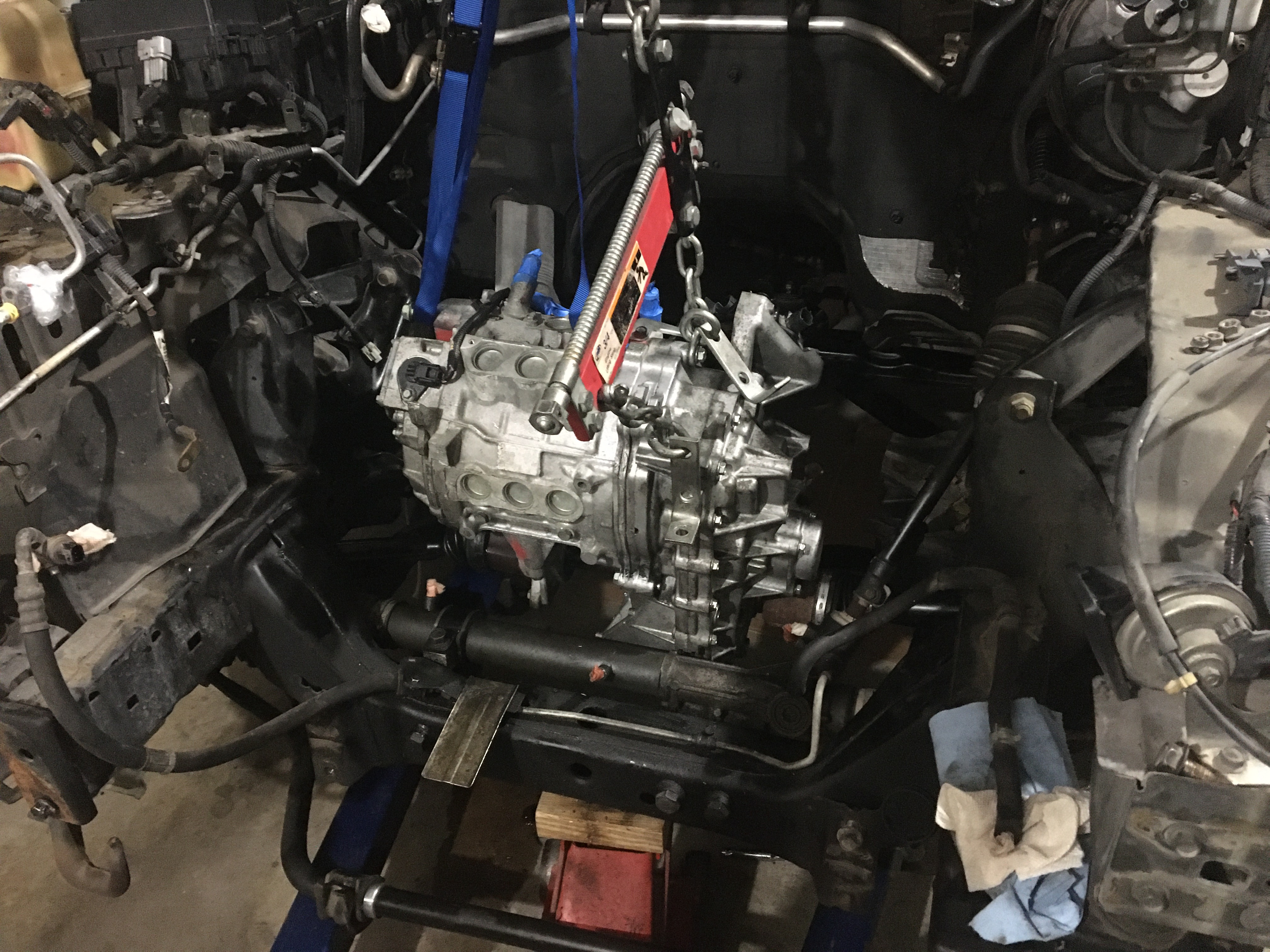

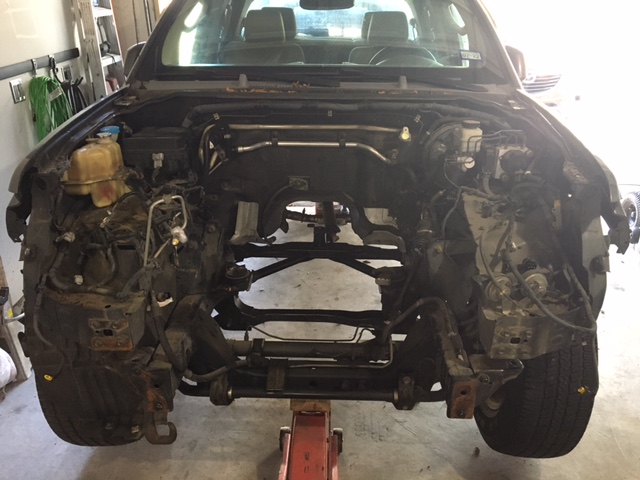

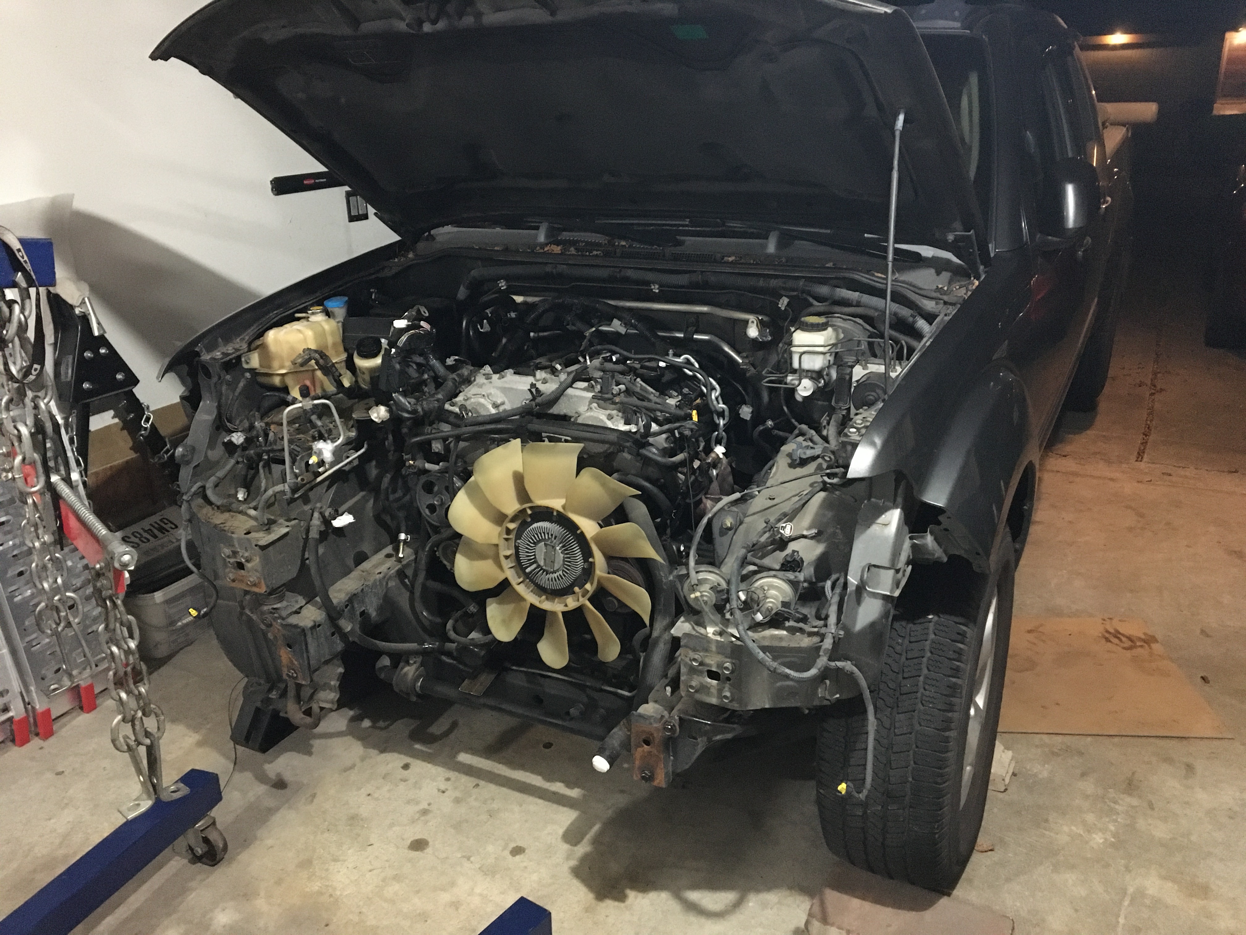

I decided to focus on the front motor first to ensure I actually make this AWD.
Original 2WD front hub.
Installed new Frontier 4WD front hubs.

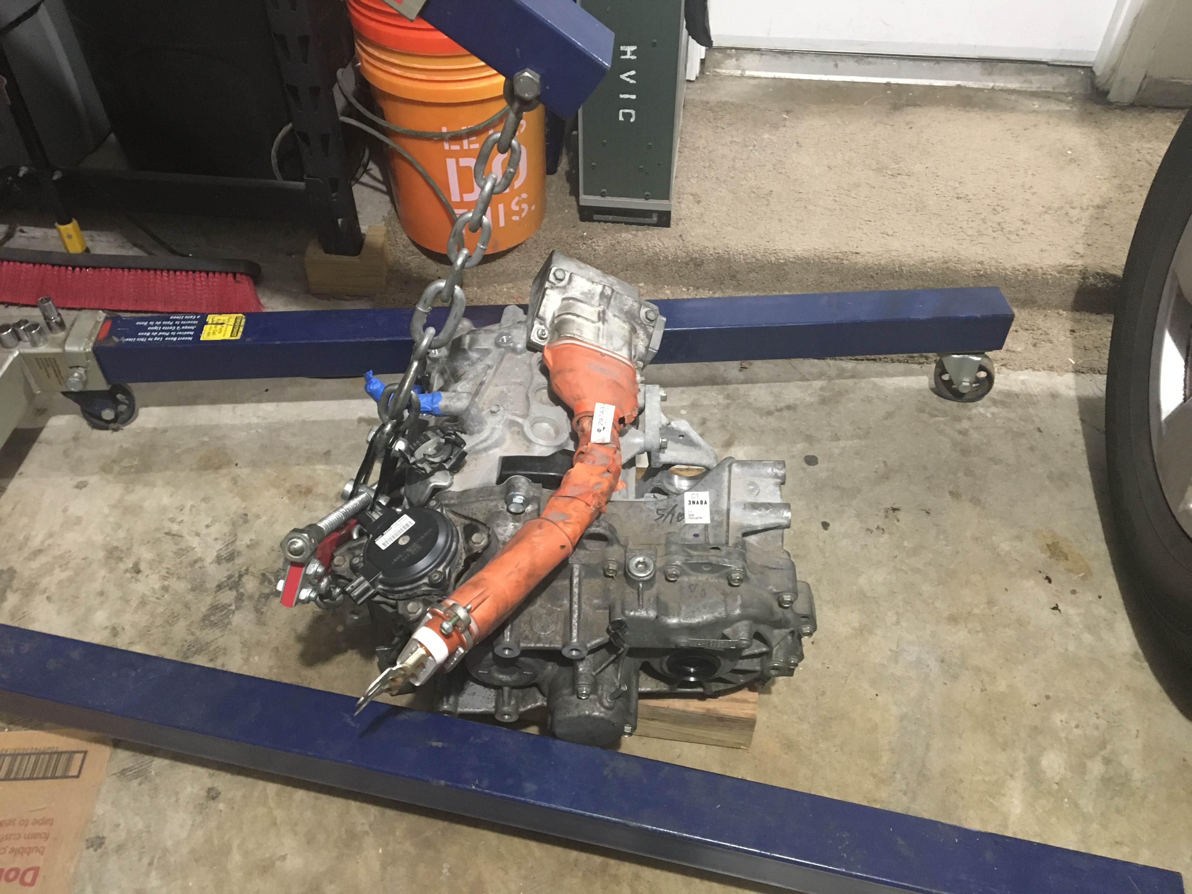

The Frontier front axle vs the Nissan Leaf axle. They use the same spline! If only I could fit the Leaf motor in the front ...

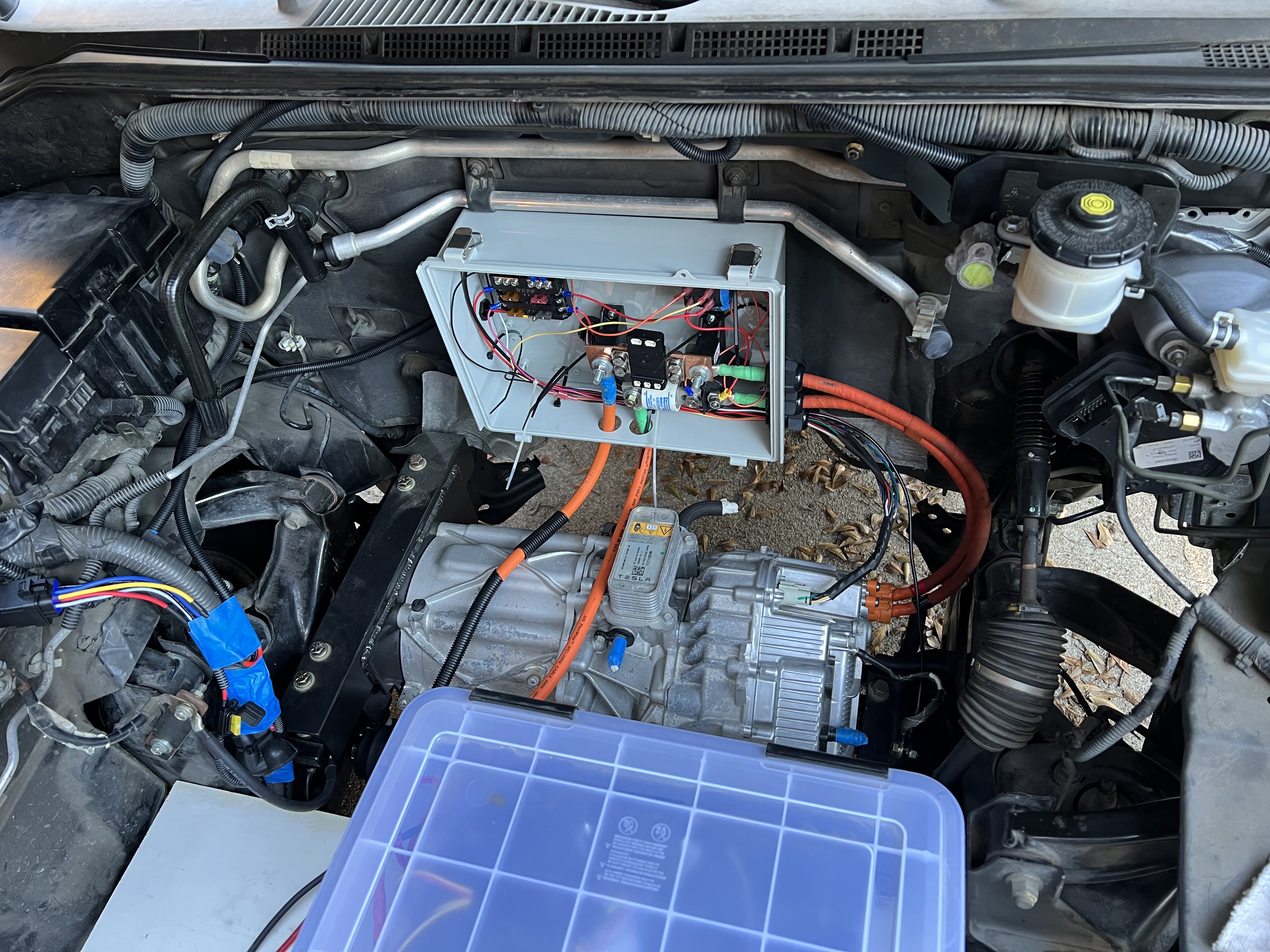

I figured out the hard way the polarity on the inverter DC input. I had it backwards at first and my precharge resister started smoking. The plastic next to where the lug bolts actually has P and N molded into it, dang! Definitely use thicker wire at full voltage and amperage. This is a test setup ...

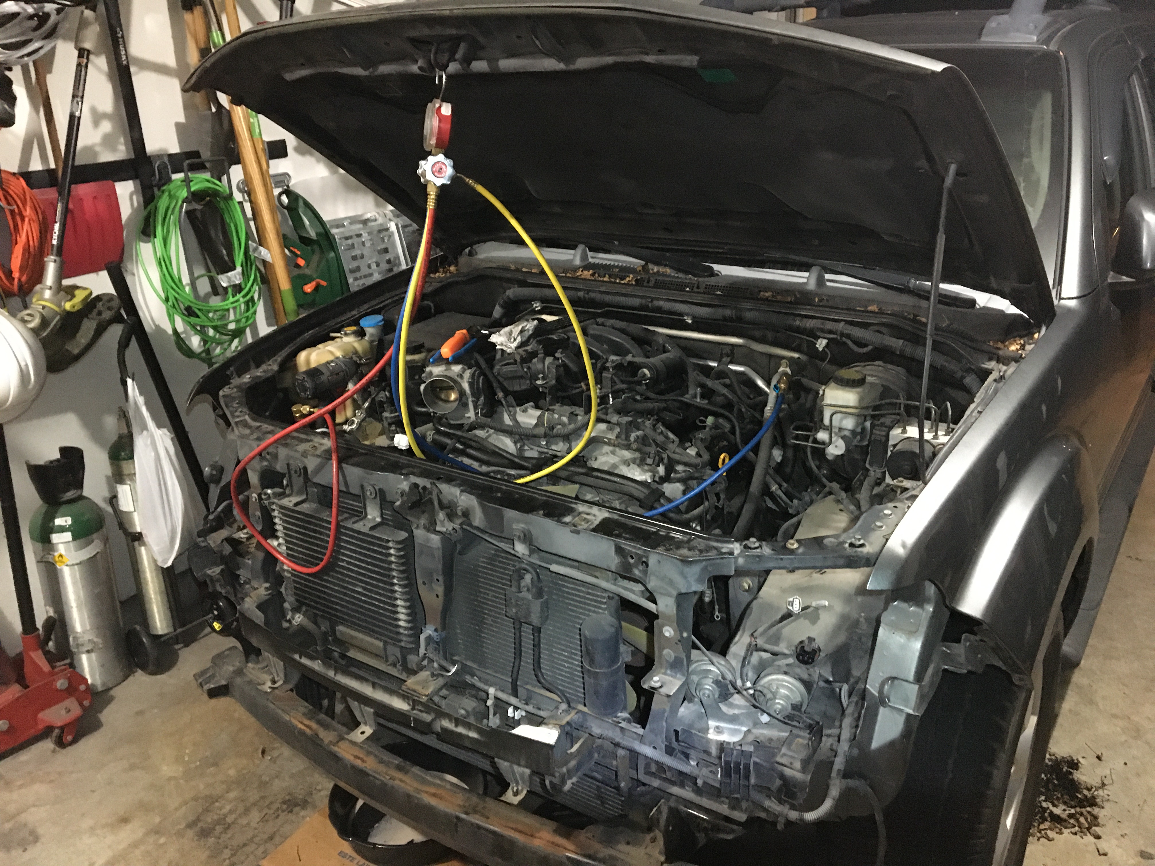

I have made a lot of progress on this project in the last year, but I still don't have a main battery. I will catch this thread up and hopefully keep it updated.
I have a 2011 Nissan Leaf motor, gearbox, axles, inverter, and dc/dc. I'm not sure if I will use all of these parts.
I ...
