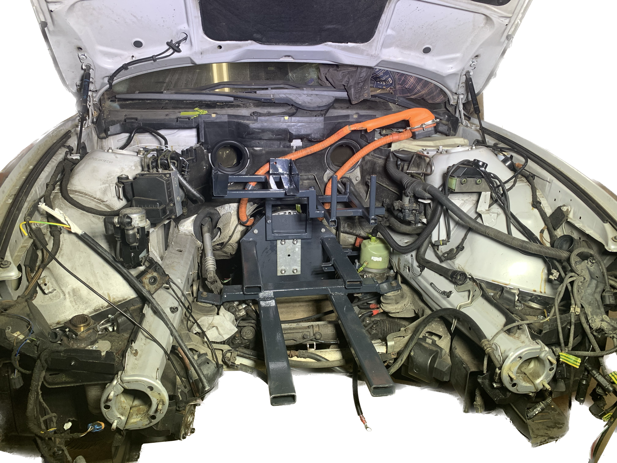

Re: [ WIP ]Bmw e39 + GS450h
MG1 Locking plate removed
inverter and outlander charger in position
I am in the process of building a battery box to hold 12 BMW Phev batteries . Three under inverter and charger and then three stacks of three to the front.
