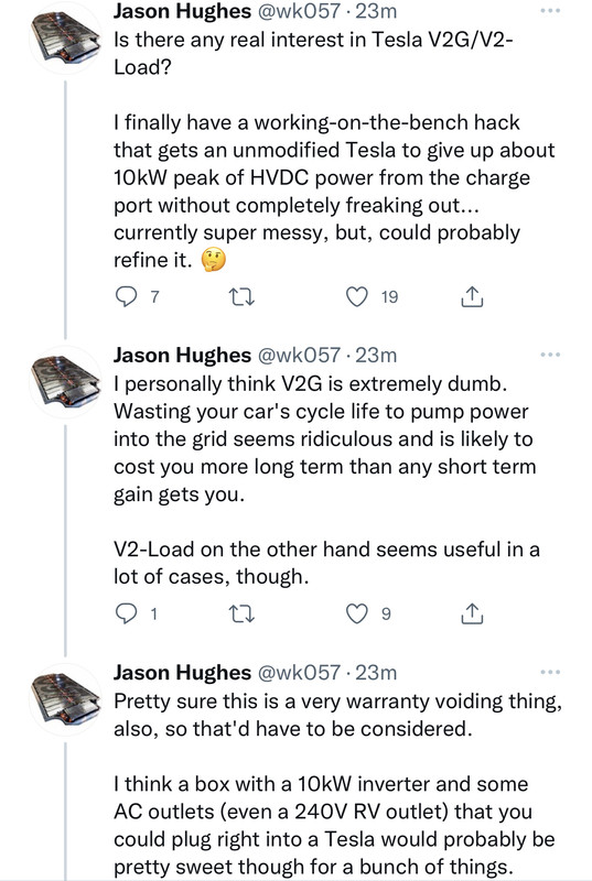

Tesla V2L and V2G
Jason claims he cracked pulling 10kW from the charge port. From his Twitter feed:
