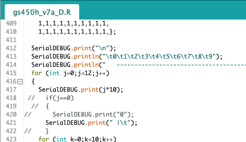

Dale, you've changed the behaviour of the debug mth printout in your tidy-up.
The "|\t" print should not be inside the if(j=0) bracket.
by evbuilder
