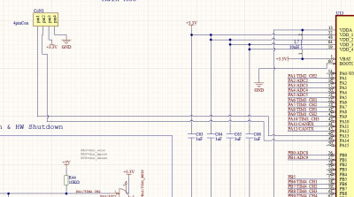

Romale wrote: Wed Jun 22, 2022 3:03 pm photo_2022-06-22_18-01-44.jpg
I noticed the absence of this place. how to program?
Hello
I placed 4 pin header close to the microcontroller also can be programmed via esp8266
