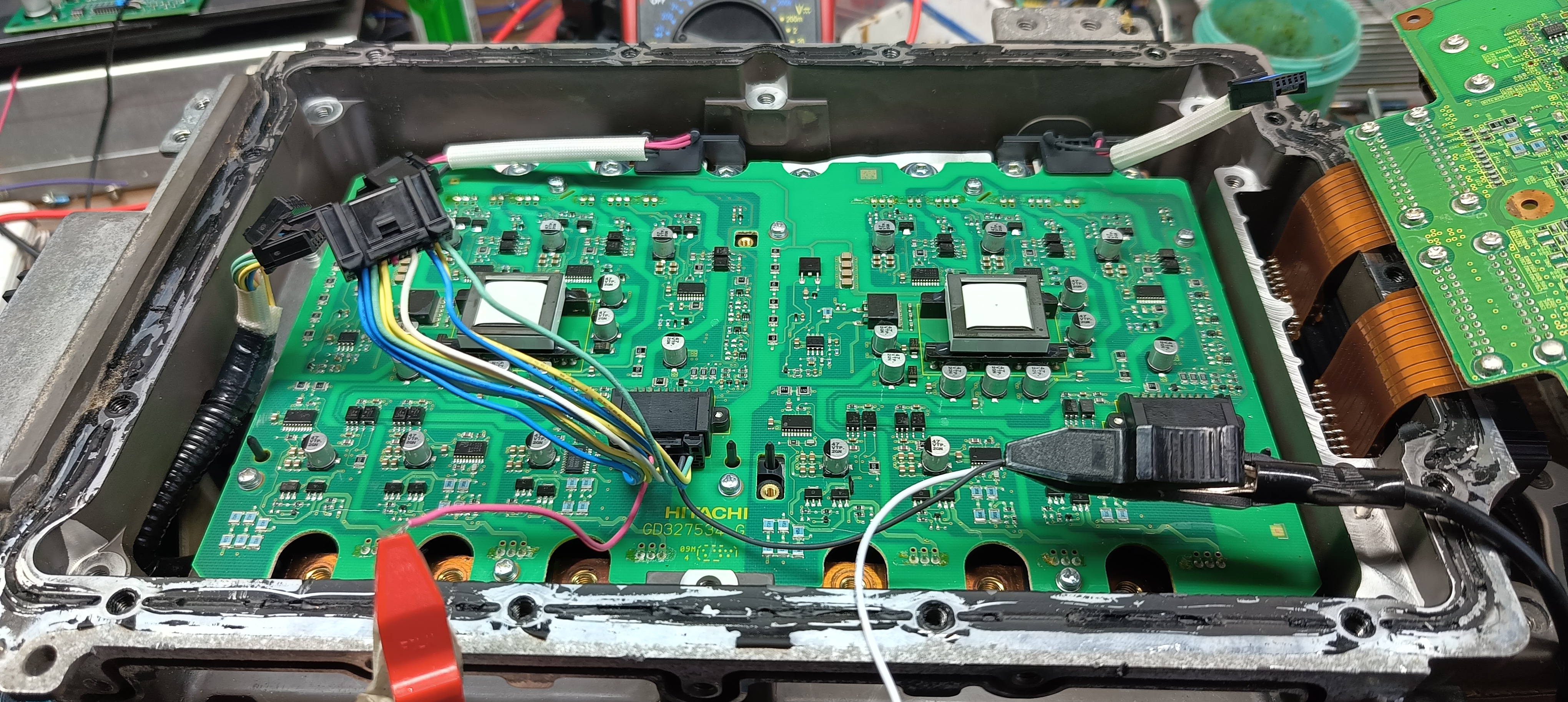

- Tue Jul 01, 2025 1:42 pm
- Forum: Chevy/Opel/Vauxhall/Stellantis
- Topic: VOLT/AMPERA inverter single controler dual IGBT drive
- Replies: 113
Re: VOLT/AMPERA inverter single controler dual IGBT drive
Hello everyone. I need help with this inverter.
I'm applying 5 volts to the red and black wires, but the drivers don't receive power, and connecting the inputs to ground doesn't open the channels.
What am I missing to get it working?
