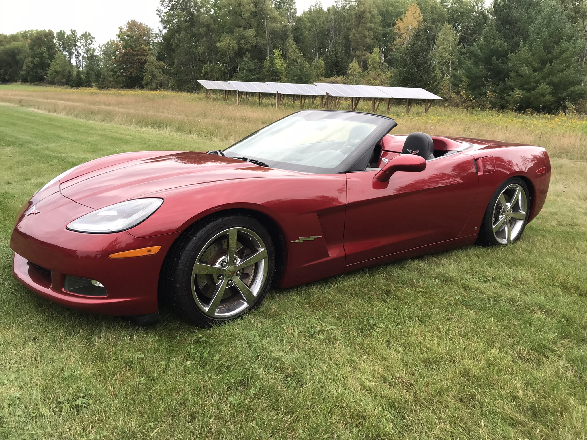

2008 Corvette C6 Conversion
I recently completed (of course, never really done) my Corvette conversion using a Tesla LDU with the openinverter board.
I'm uploading monthly to my YouTube channel -- https://youtube.com/@e-grandpa9778?si=lKo2O2nWbbQaJuvP -- to spread out my build process.
