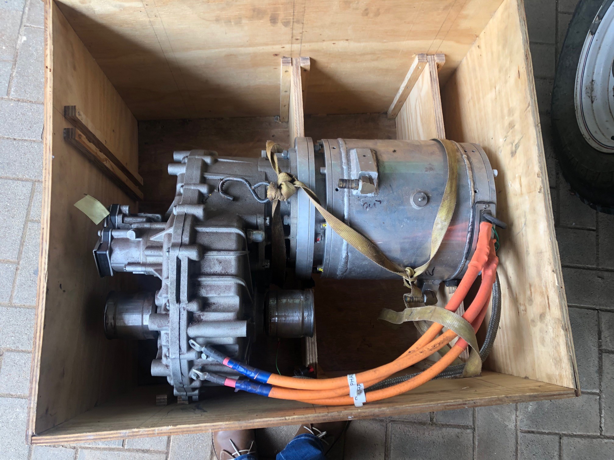

I have components of my EV conversion up for grabs :cry: :
150kW Rinehard 100-720V Inverter
3.6 NLG513 Brusa Charger (200-520V) (including all wiring/connectors)
BorgWarner eGear
Unknown motor (see Picture)
Unknown DC/DC Convertor (see Picture)
Benchtop Power Supply (30V/20A ...

Help me identify the motor, please...
I found this motor connected to a BorgWarner gearbox. It has no nameplate or any markings. Can anyone help me identify the motor?
Kind regards,
Jan
Kind regards,
Jan
