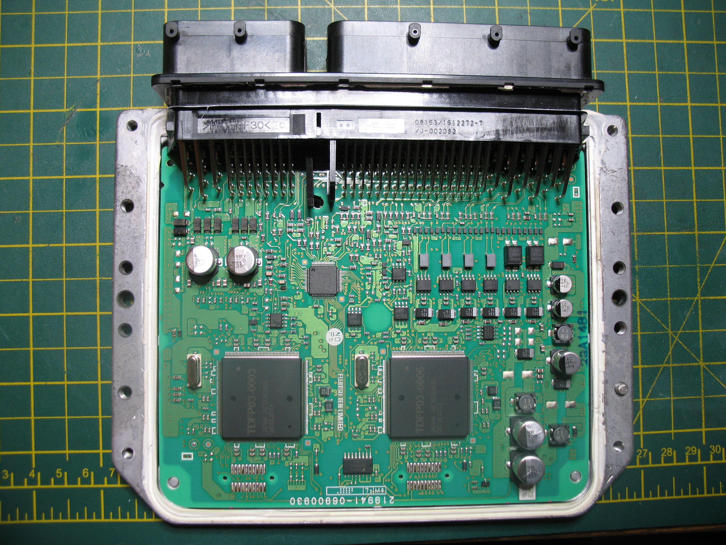

Re: Communicating with the Lexus GS450h Inverter/Converter
Coincidentally I've been looking at this today. Here is a picture of what Lexus calls the Hybrid ECU from a 2009 Lexus GS450h. This unit talks to the inverter using 4 CAN-like interfaces.
I've buzzed out the CAN connections using the lexus wiring diagrams. From left to right there ...
