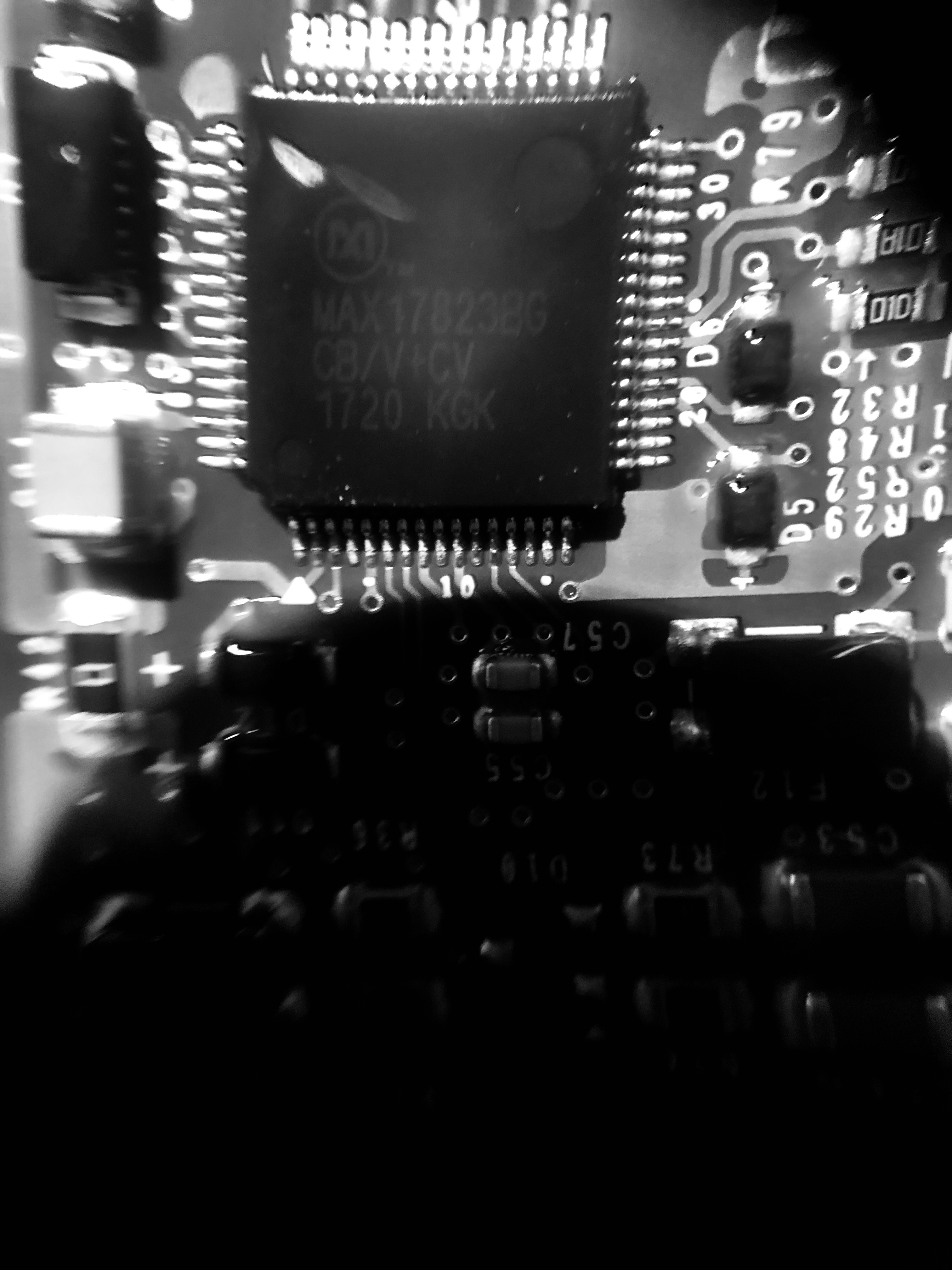

Re: Loresamp
I just got it all working, default motor settings were WAY off. I thought the Leaf board came with nissan motor settings pre-flashed. Assumption is the mother of all fuck-ups. Changed to Leaf settings from wiki and its revs silky smooth without errors
Thanks for the heads up, will install update ...

Re: Loresamp
No feedback from resolver :( I've checked wiring again and it's all good. I also checked resistance from resolver to main connector and everything was in range according to a document I got from Langoo. Any suggestions what to check next?
RES_R1 - GND = 13 ohm
RES_S2 - RES_S4S1 = 29 ohm
RES_S4S1 ...
RES_S4S1 ...
Re: Loresamp
Thanks Damian. Fresh parameters and software now loaded but unfortunately error still remains.
When engaging the throttle motor makes sounds and tries to spin, but it's like it doesn't know which direction to spin at. I've tried both fwd and rev.
Re: Loresamp
Resistor is replaced but I still get loresamp. But now at least the motor is trying to spin.
Seems I can't upload leaf parameters to 4.76 FOC firmware for some reason.
Re: Loresamp
I checked again to be sure and the R44 is 1k2. Do I need to replace this then?
Now I'm running latest software (FOC) and parameters but as soon as I start the inverter I get the WARN - LORESAMP error. If I start without connecting the resolver there's no errors and of course nothing happens when I ...
Re: Loresamp
R40 = 4k7
R41 = 4k7
R42 = 3k3
R43 = 10k
R44 = 1k2
Well 1 out of 5 is correct
R41 = 4k7
R42 = 3k3
R43 = 10k
R44 = 1k2
Loresamp
I'm trying to get my gen 2 motor to show a sign of life with no luck. The only error I get now is the loresamp. Wiring seems to be ok but I need some guidance to continue troubleshooting. I need to know which pins and what to measure and also if there is some parameters to check.
4.65.R-sine ...
4.65.R-sine ...
