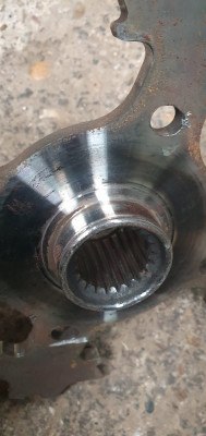

Any ideas on how the centre of this comes out? I recall Damian’s video shows him wielding it to a bit is square tube.
It may be too late now. But do you happen to have the part number for that piece? My gearbox didn't come with it.
I cut it out of this.
61829558-2377-42F6-8B8B ...

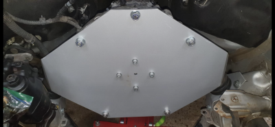

The gearbox fits like a glove and the car is now with a fabricator to create new mounting points, gearbox face incorporating the spline to lock the two motors, bracing underneath, and interface the prop shaft between the Lexus and Merc differential. I know my limitations...
