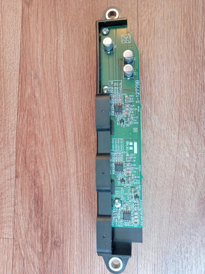

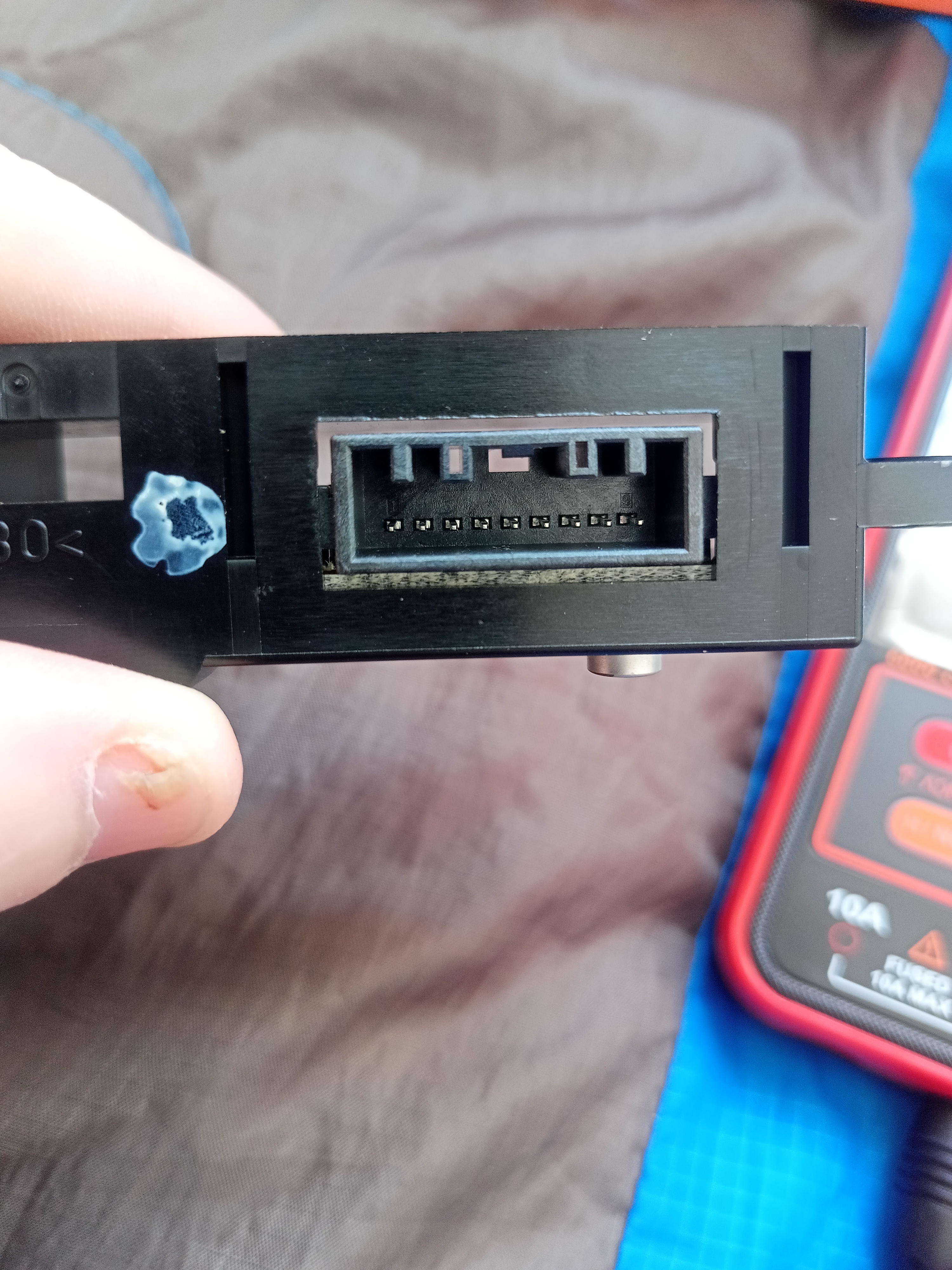

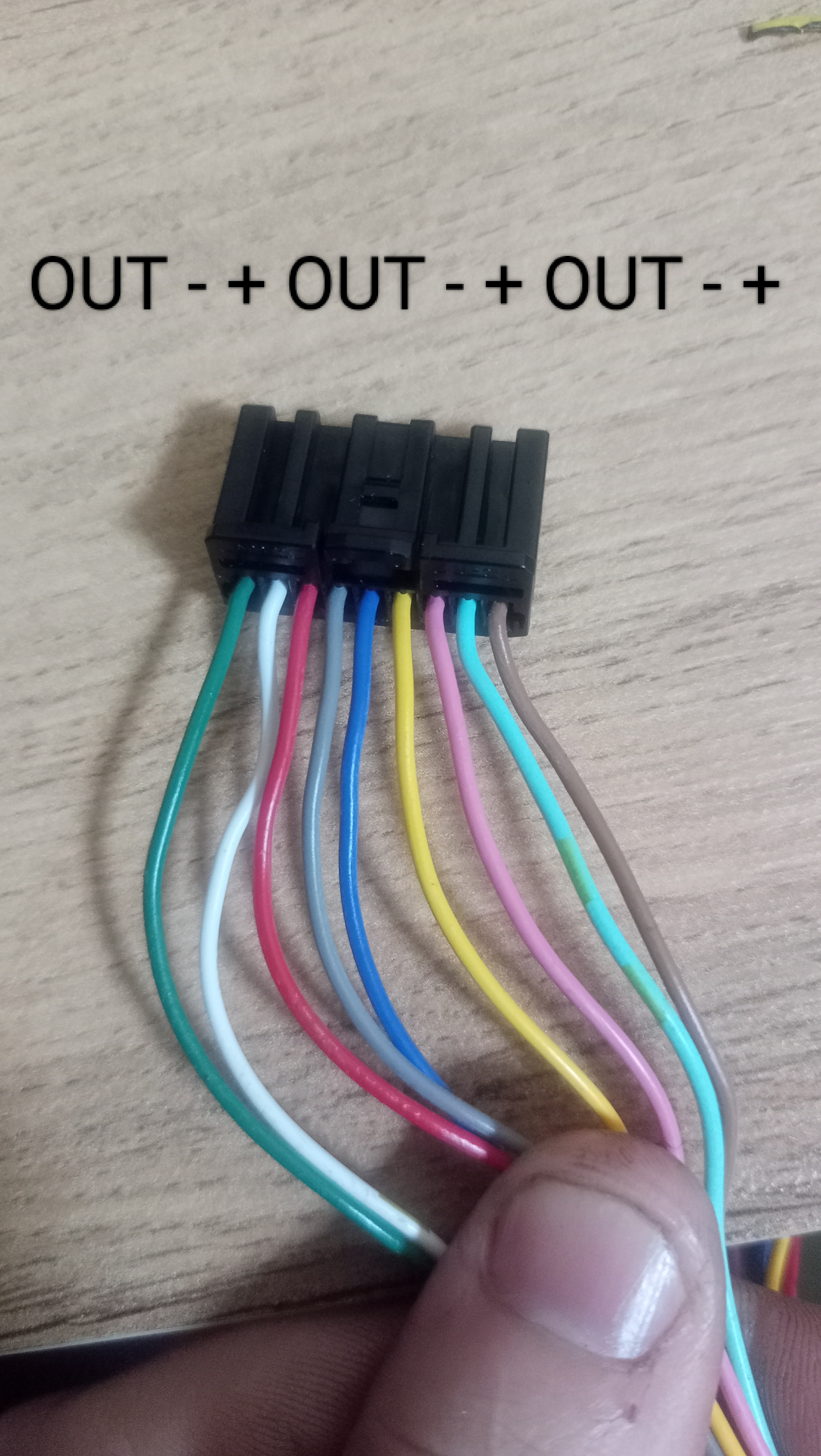

The pinout of the current sensors is ready, let's move on along the path

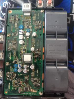

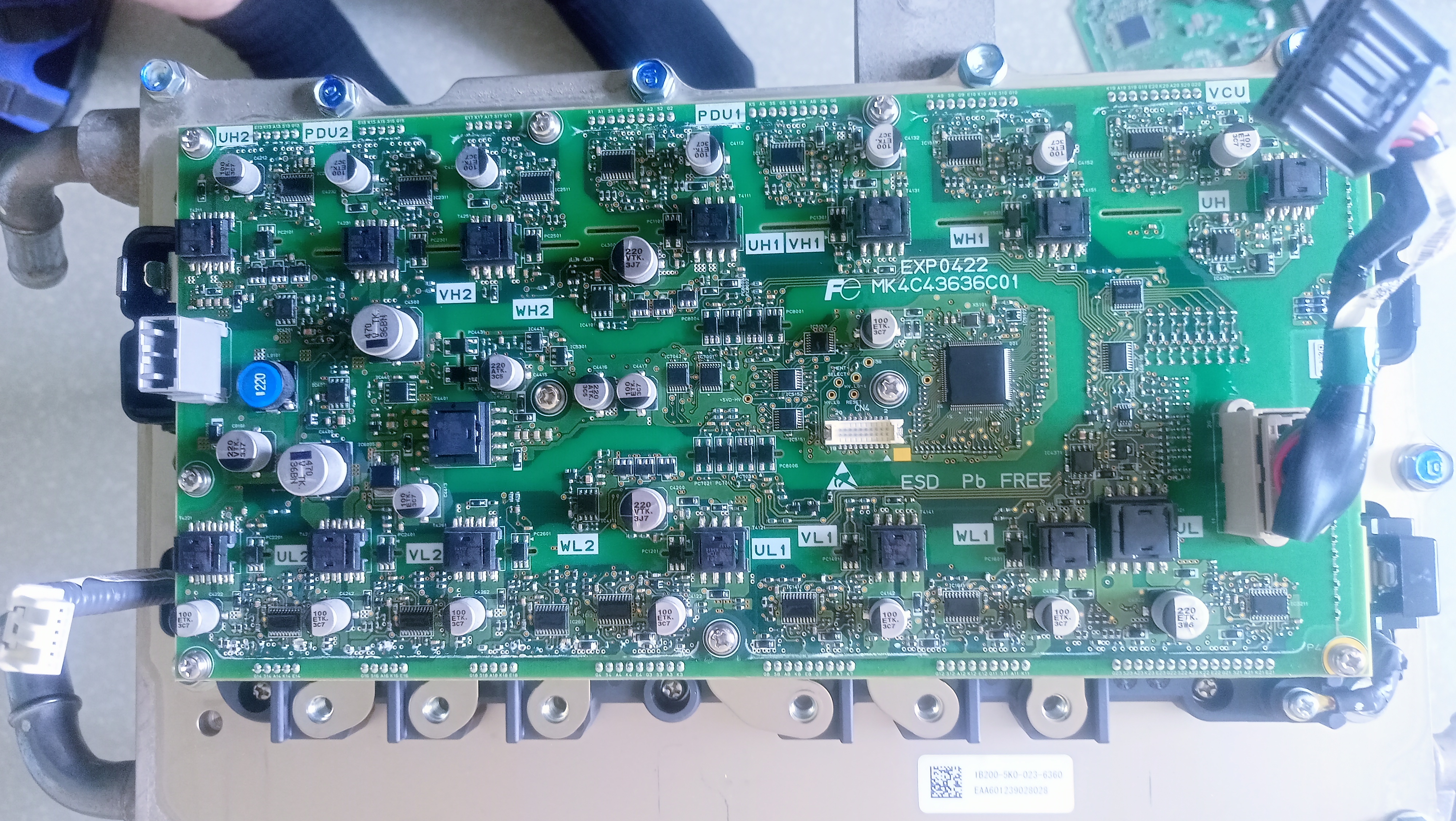

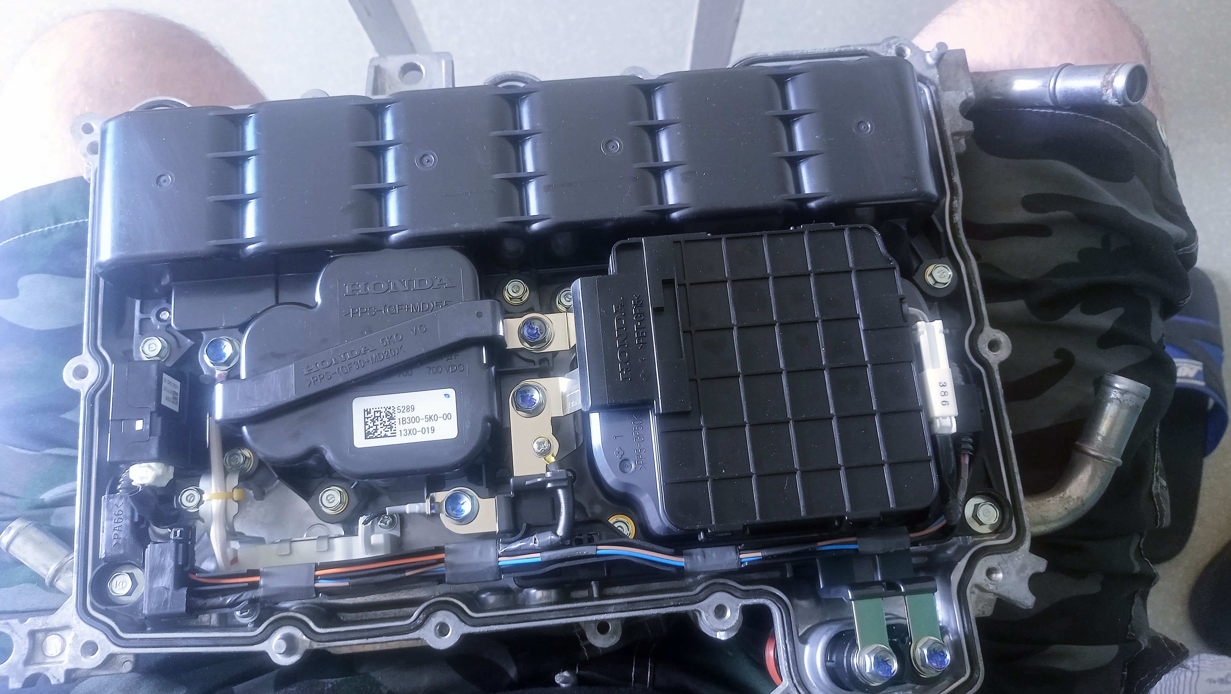

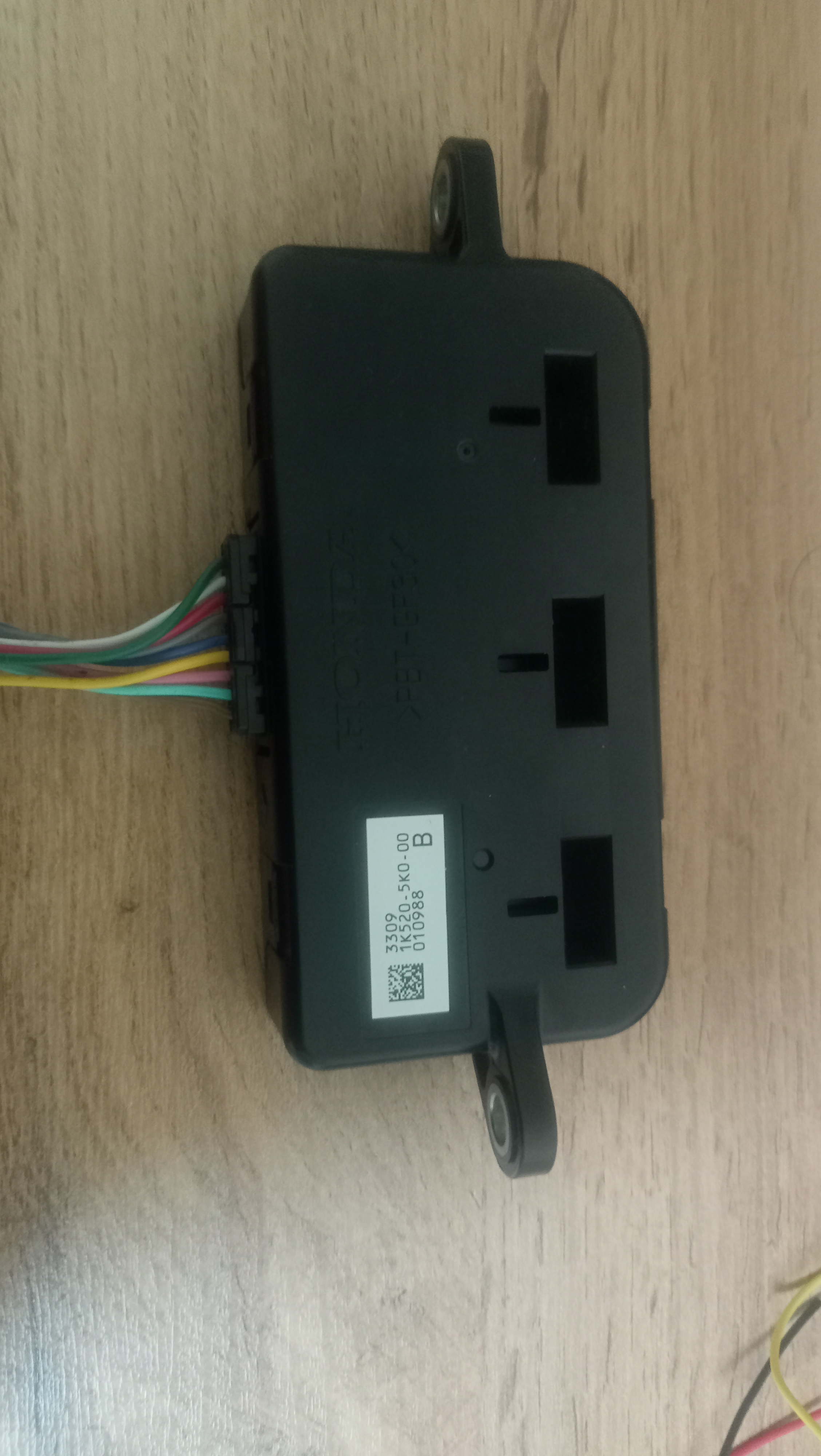

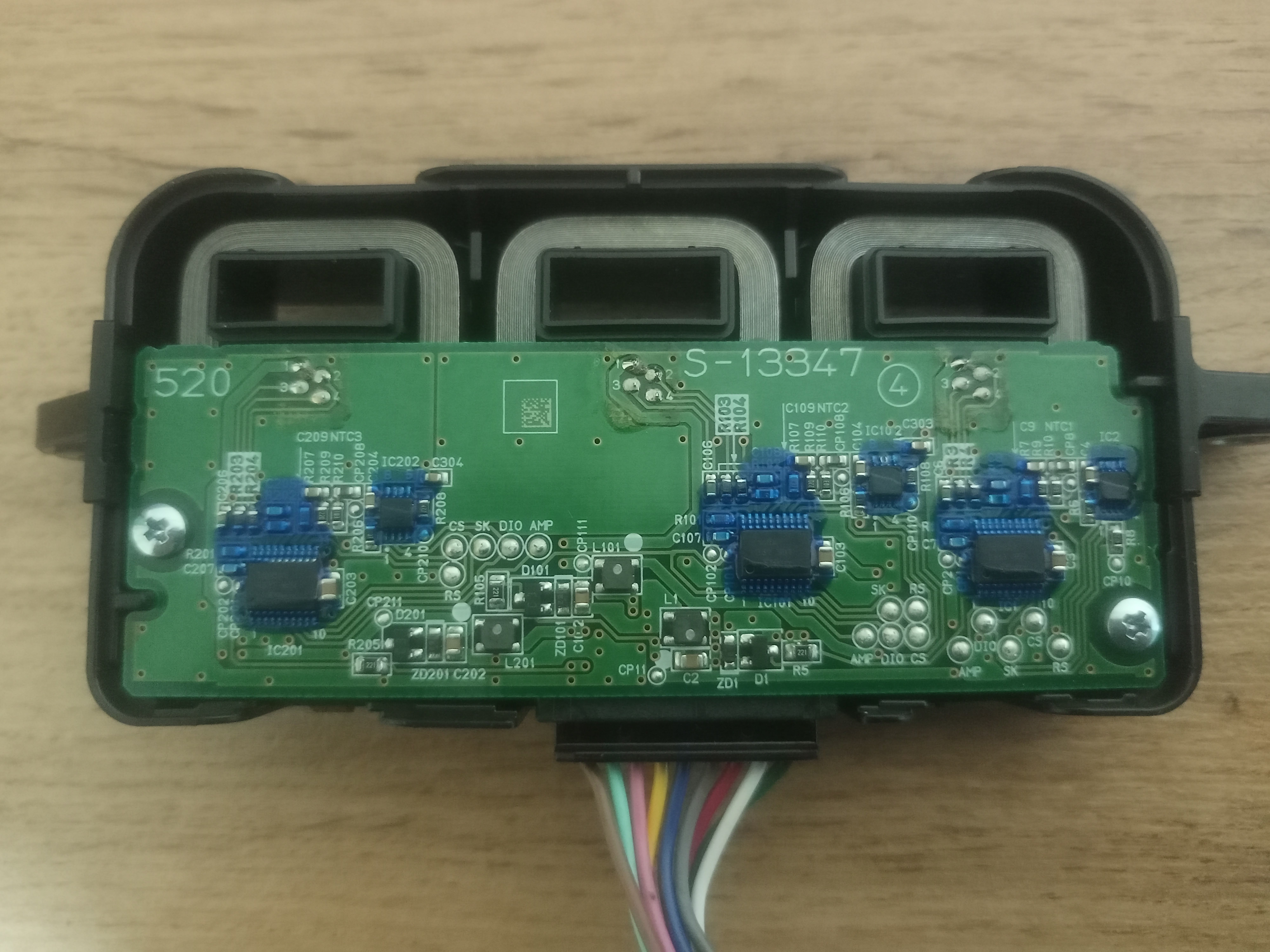

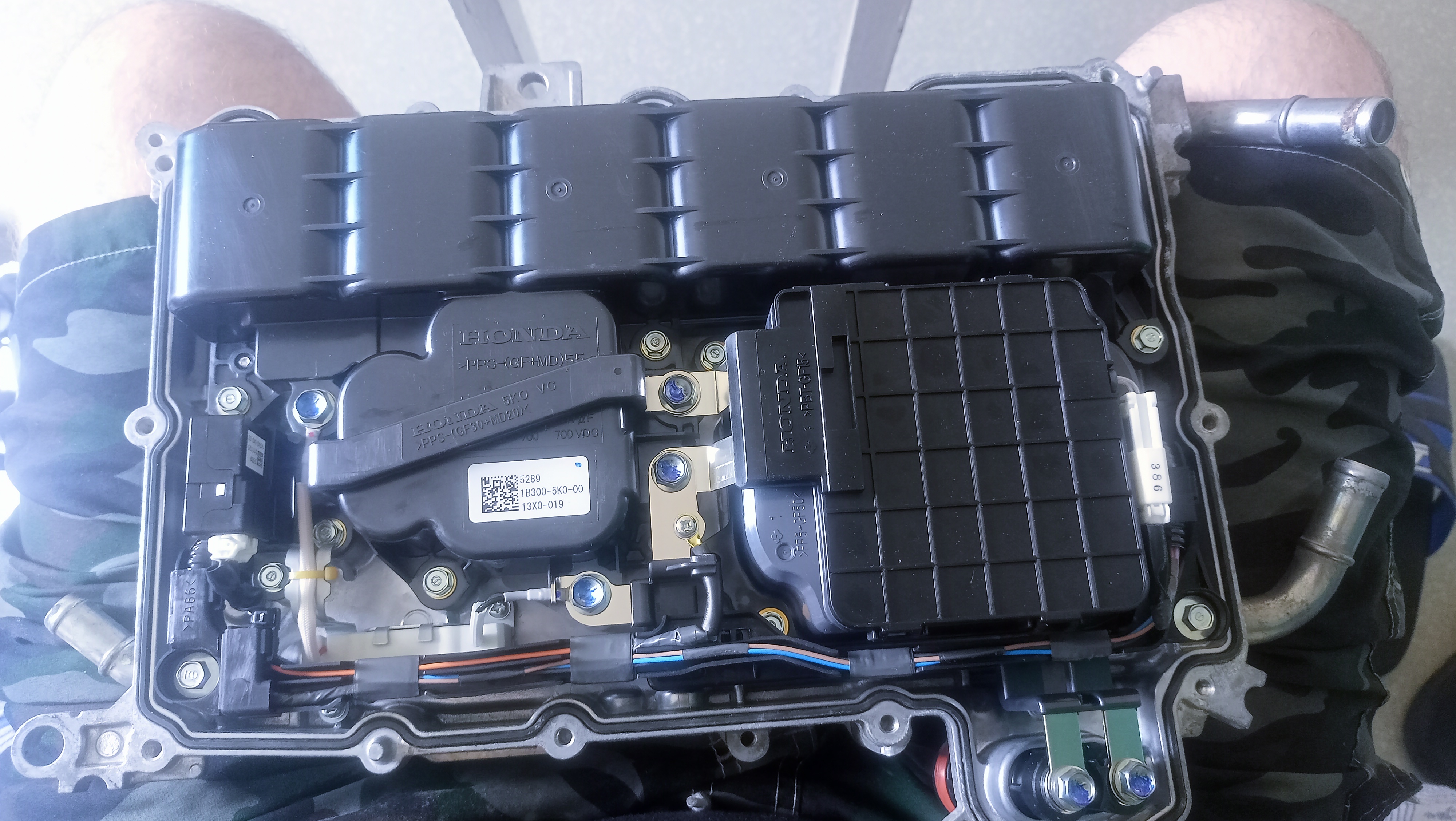

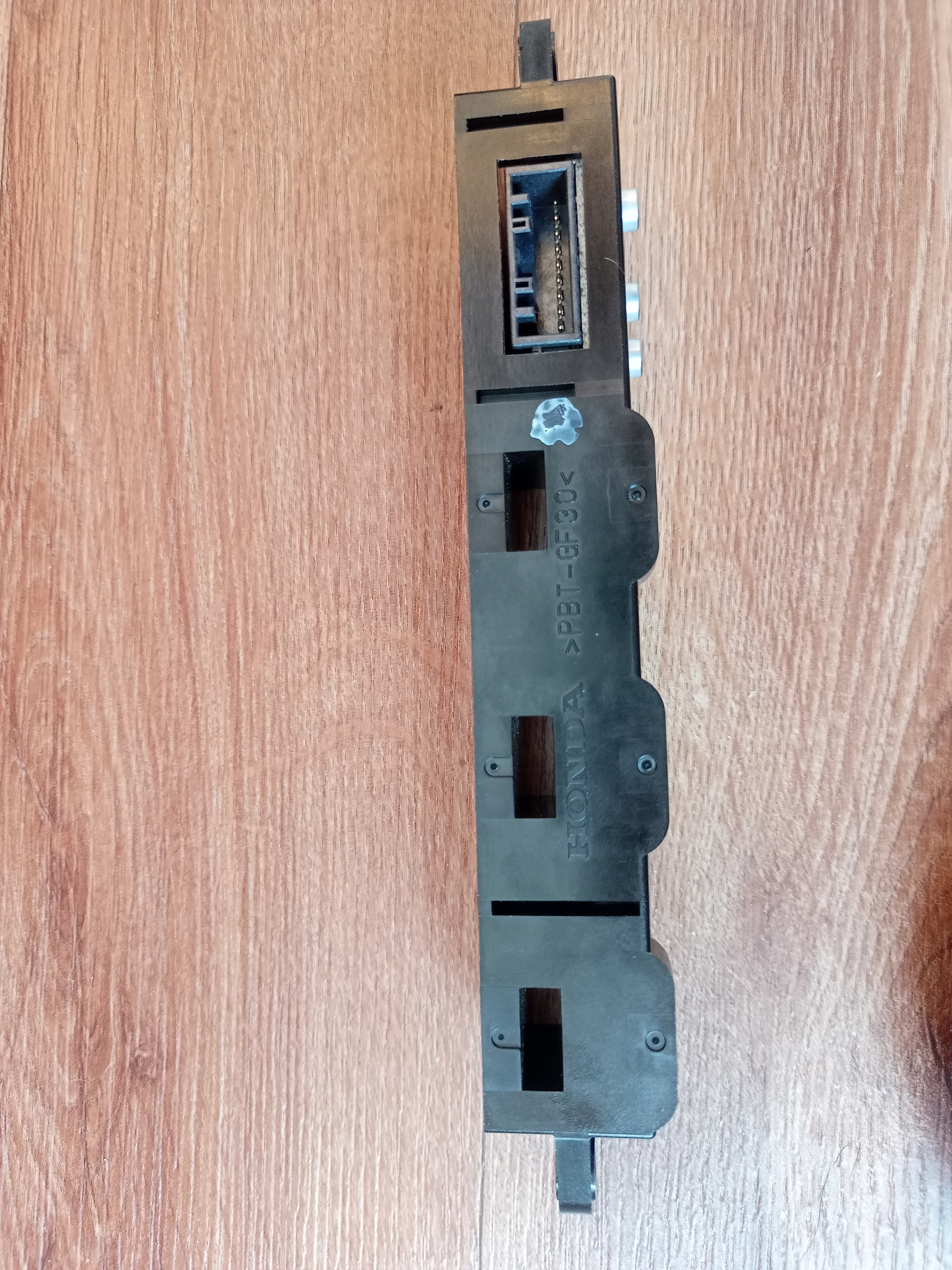

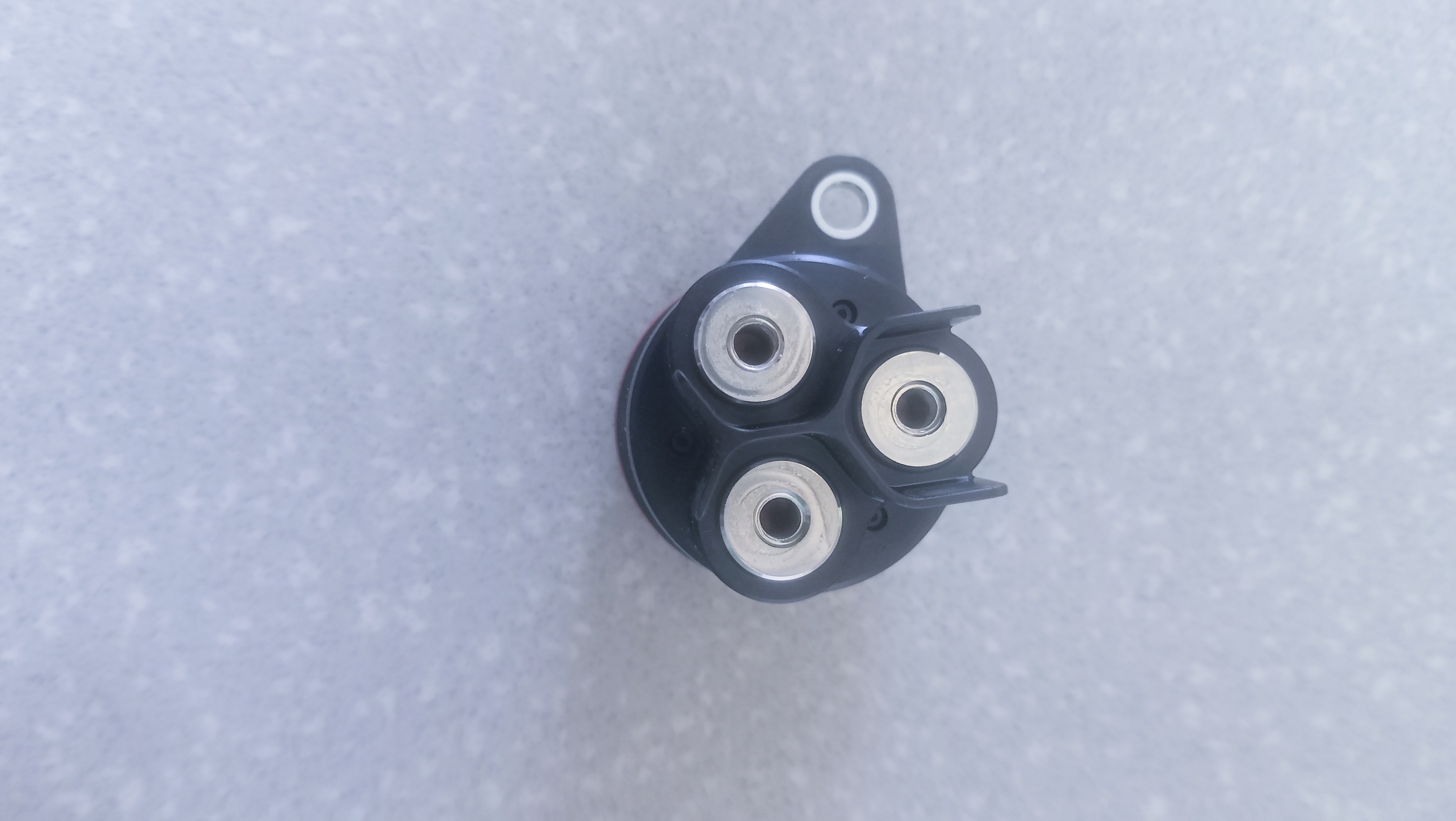

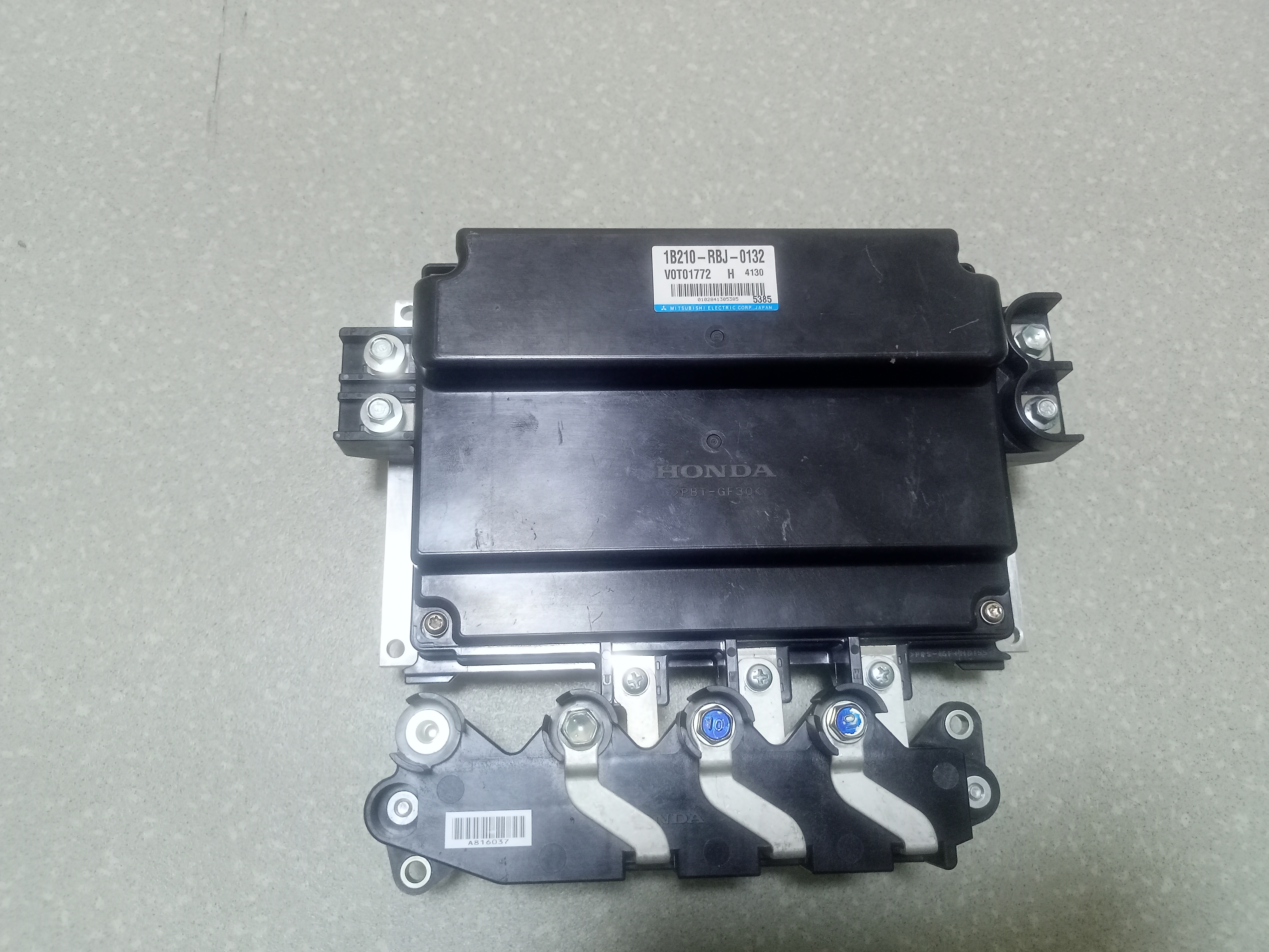

We continue disassembling the inverter, the top cover is held on by 4 bolts , Also disassembling current sensors

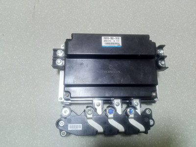

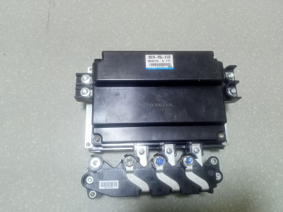

The honda insight IMA inverter
Good afternoon, I bought an inverter from Honda Insight

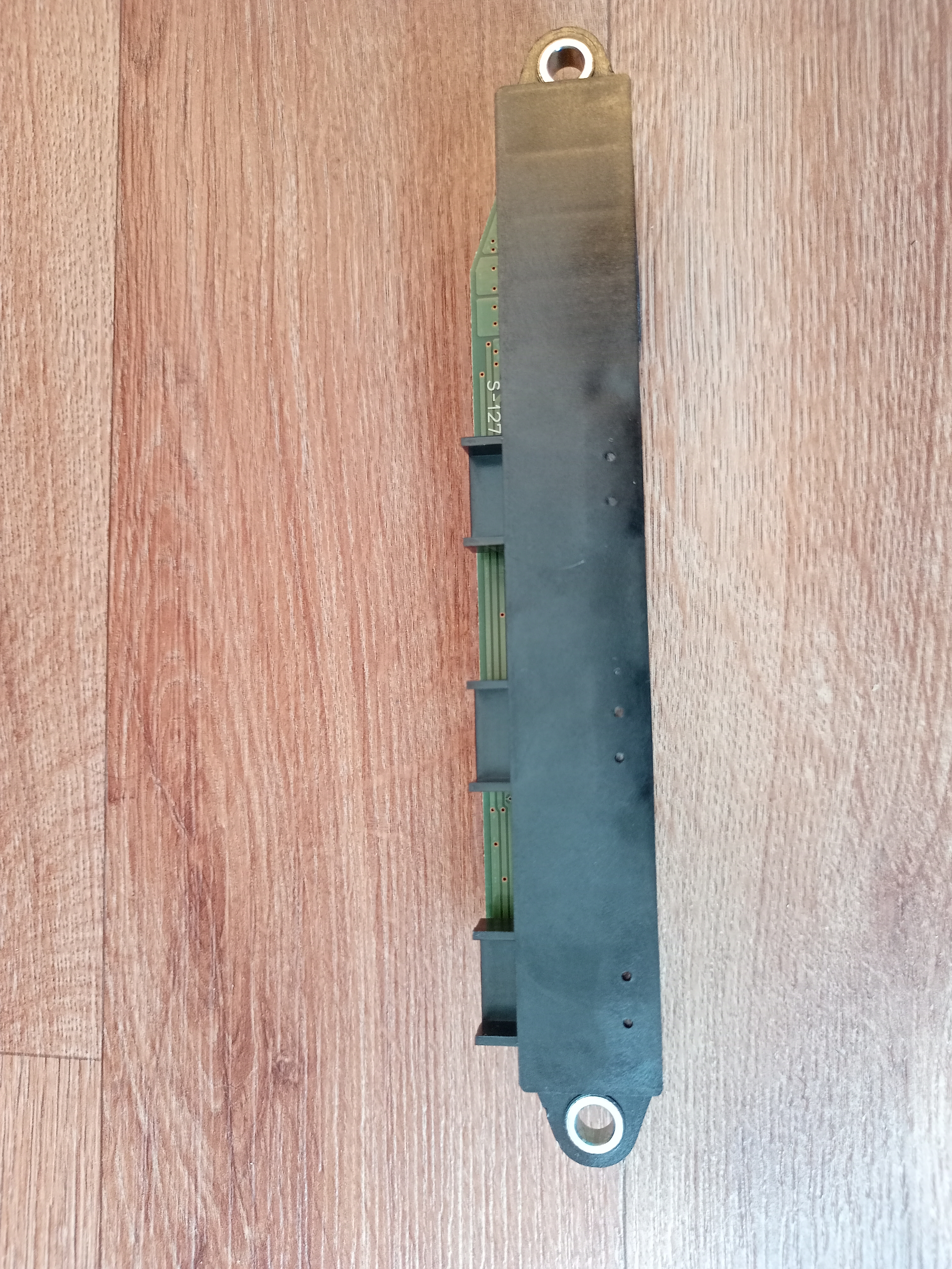

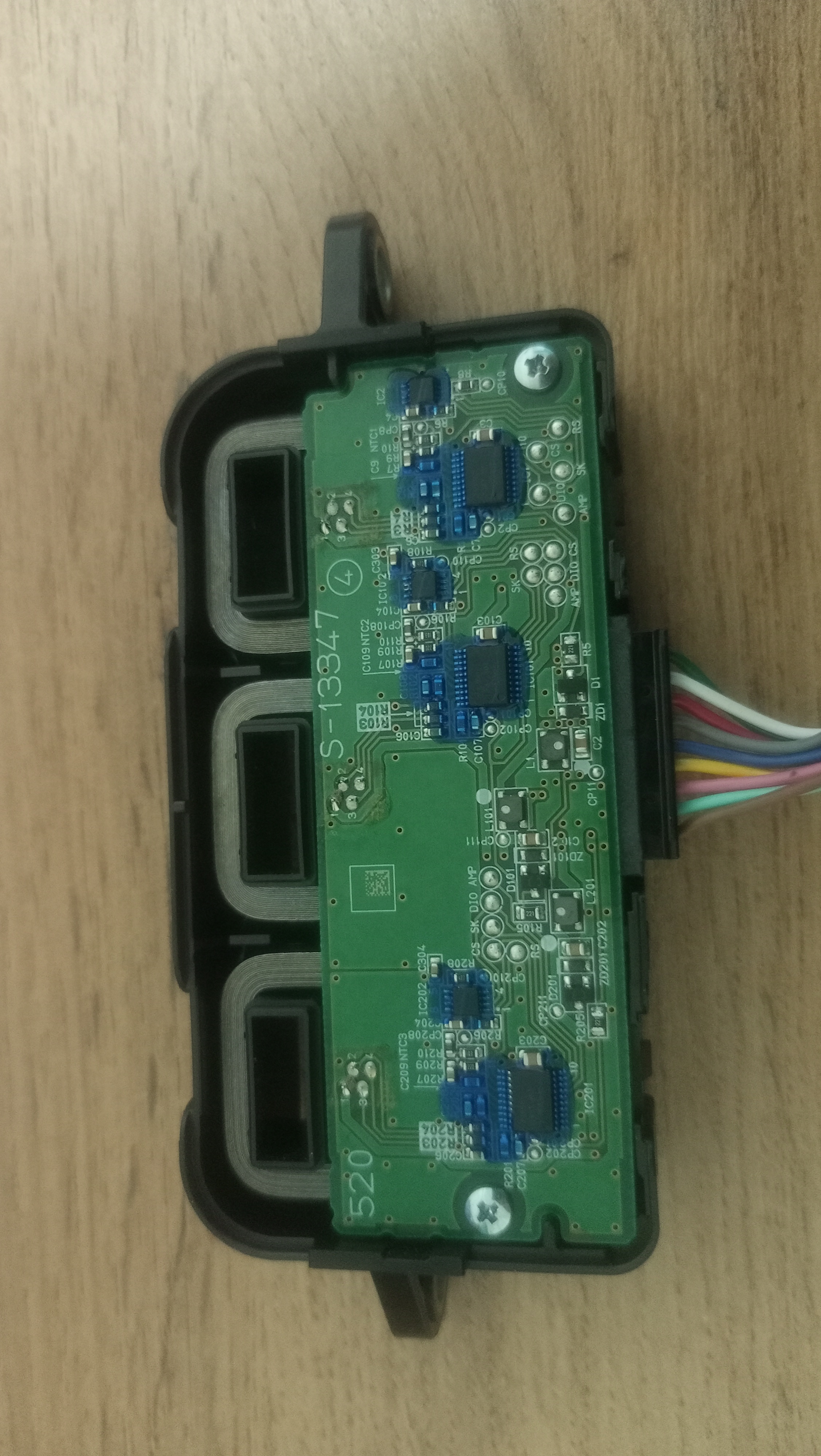

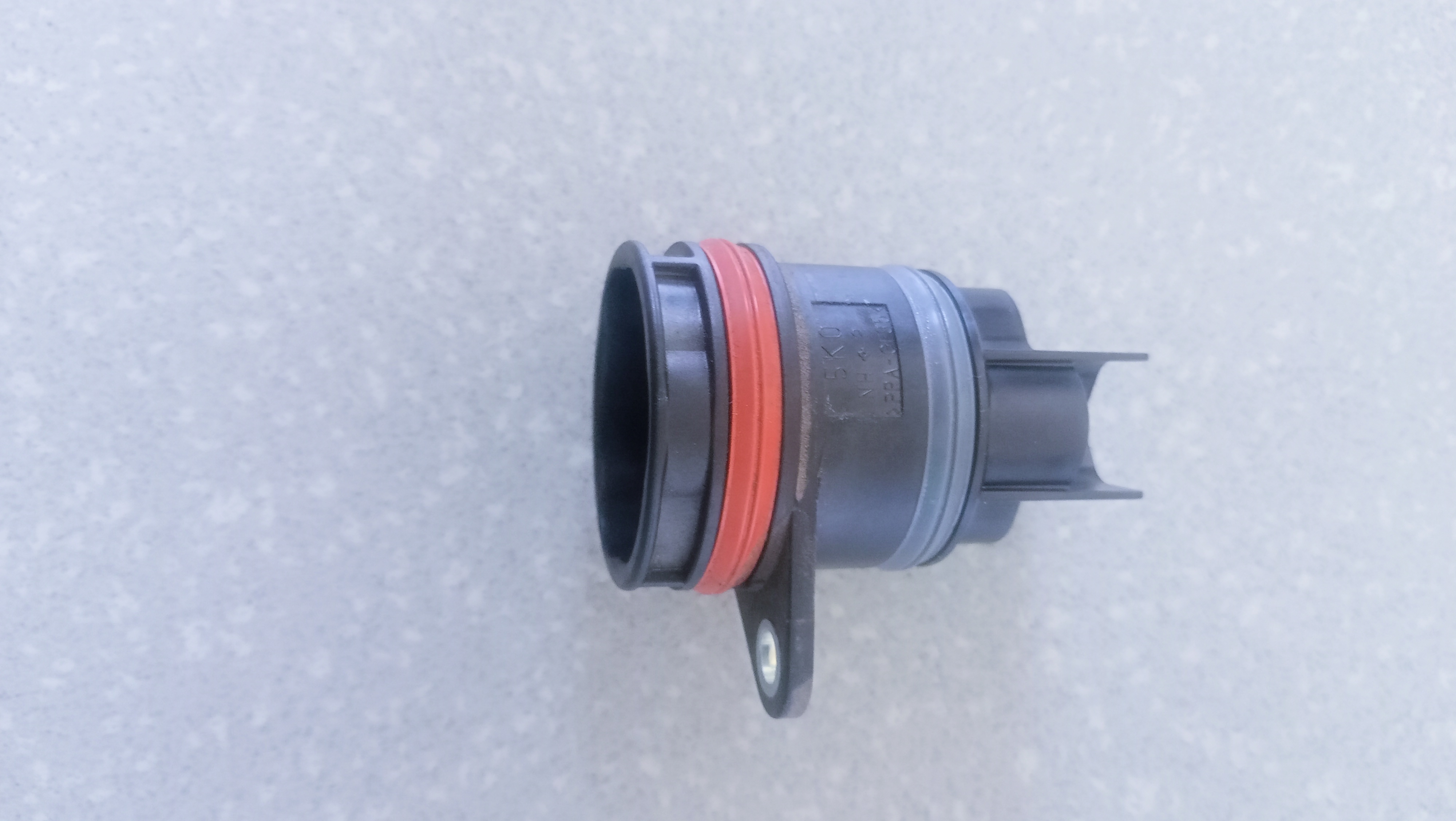

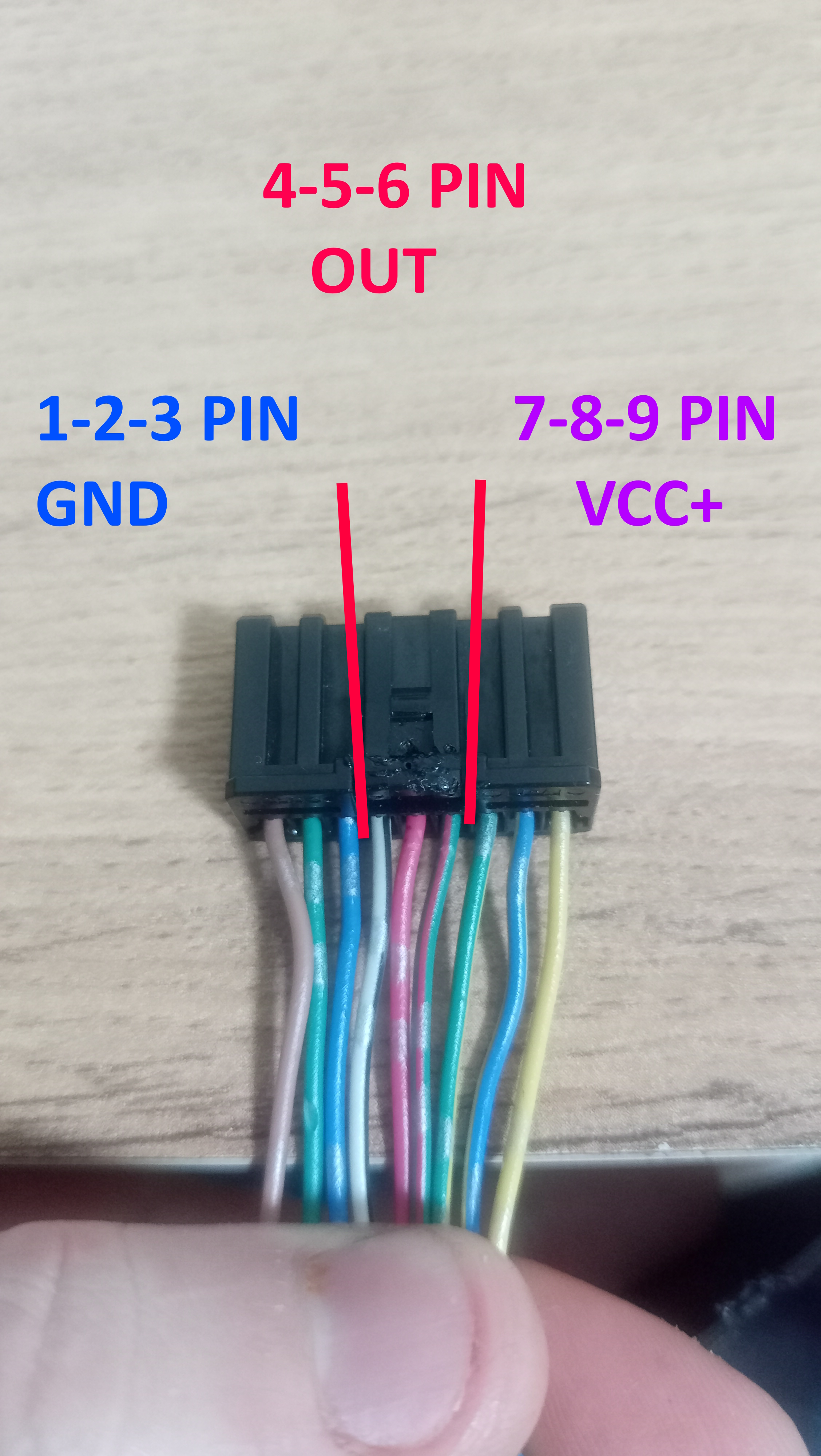

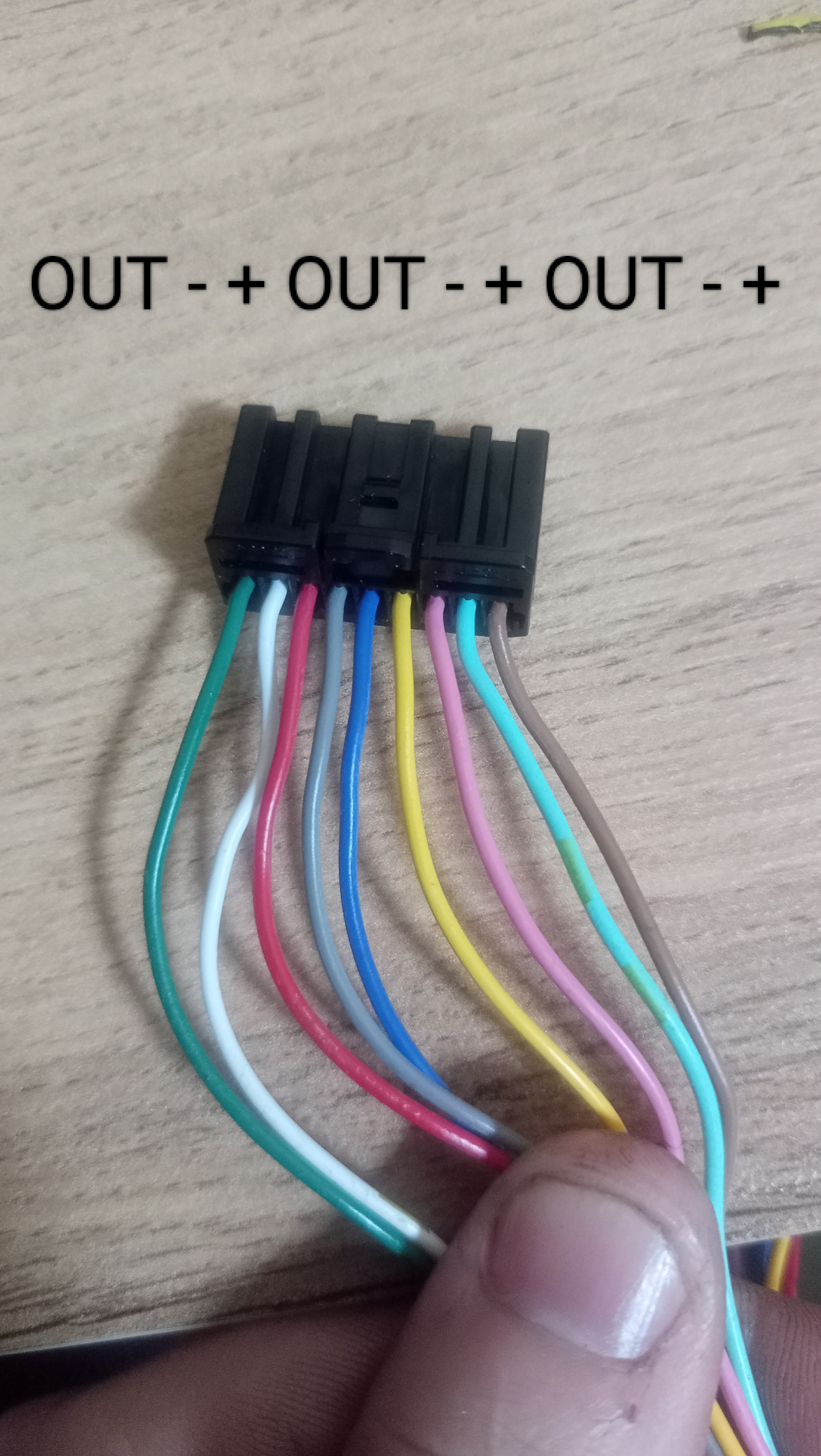

The current sensor has a pinout
Green ,Gray, pink - Signal output
White, blue, light green GND
Red, yellow, Brown VCC
I marked them in the
Current sensor from inside]

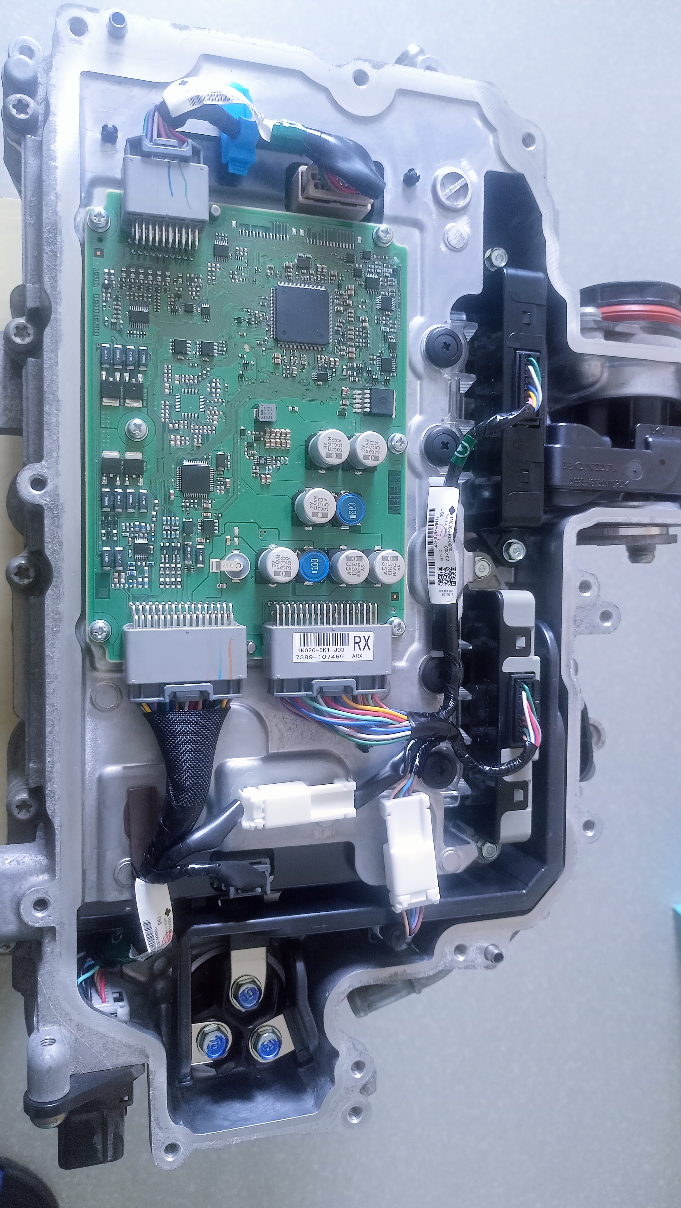

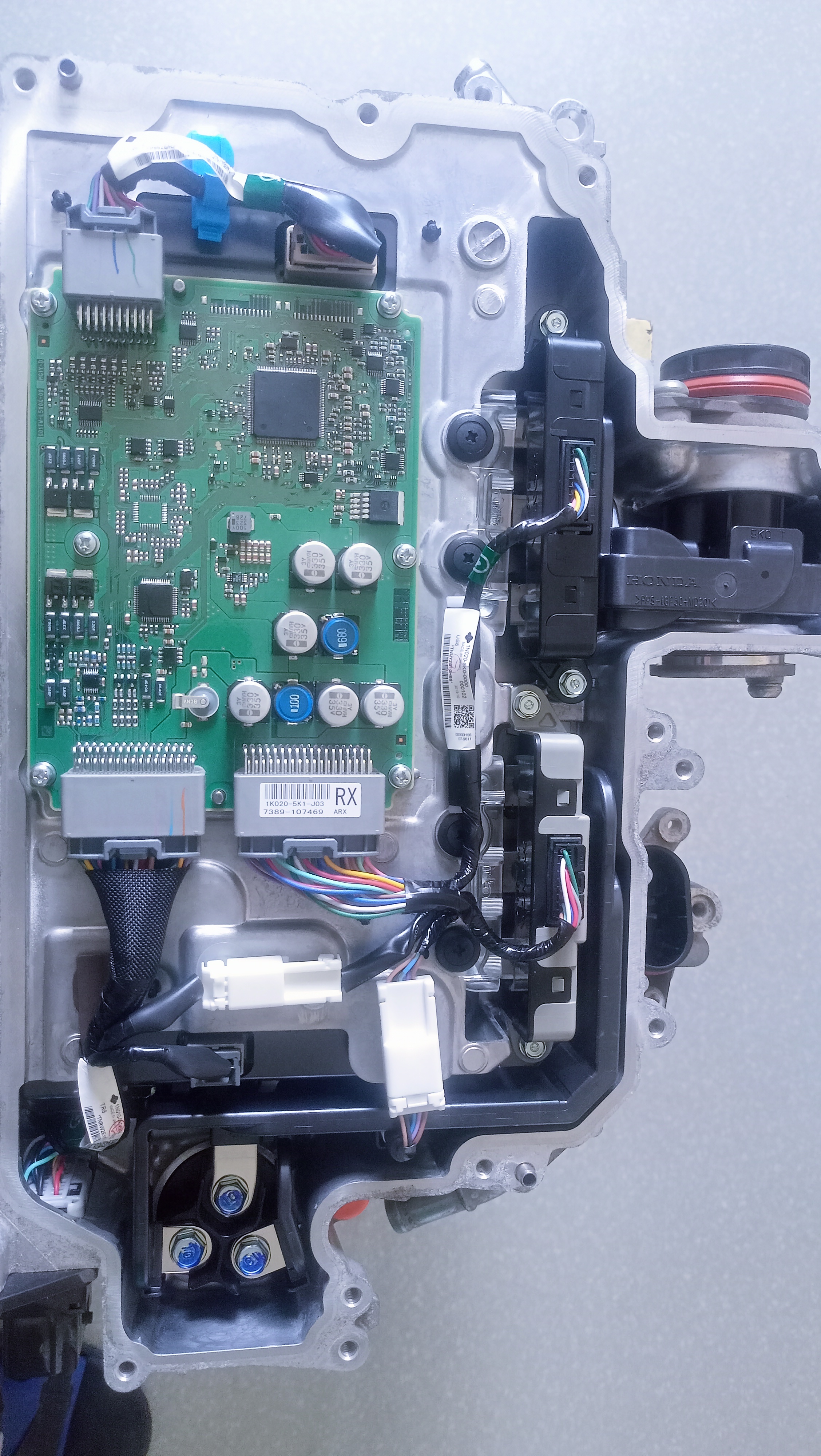

Disassembling the inverter honda accord
Good afternoon, I'm I'm a newbie here, maybe someone will find the information on the inverter useful Honda Accord and its disassembly
