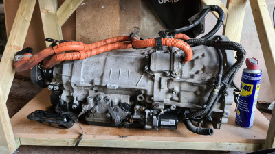

Bit of a stall in progress but trying to get back to my conversion project.
Made a mess of opening up the buck/boost converter part of the inverter, to allow access to HV terminals, but it'll do...

The Lexus transmission had a lot of oxidisation on it so I decided to clean it up with lots of Autosol and my Dremel before it's mounted in the car.

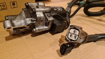

Never mind! Electric_SLK explained it all to me!
Seems obvious now: the oil pump motor is three phase, hence the three pins in the white connector! I need the oil pump controller (and he suggested that the controller needs to share the same ground as the 12V supply). Next stop, ebay and some lexus ...

I'm having trouble understanding the wiring for the GS450H transmission oil pump that's on the wiki.
Could anyone tell me how to test that my oil pump is still working.
I'm assuming it's 12v applied... but don't know where to hook up the + and - wires....
Can anyone help?
Can anyone help?

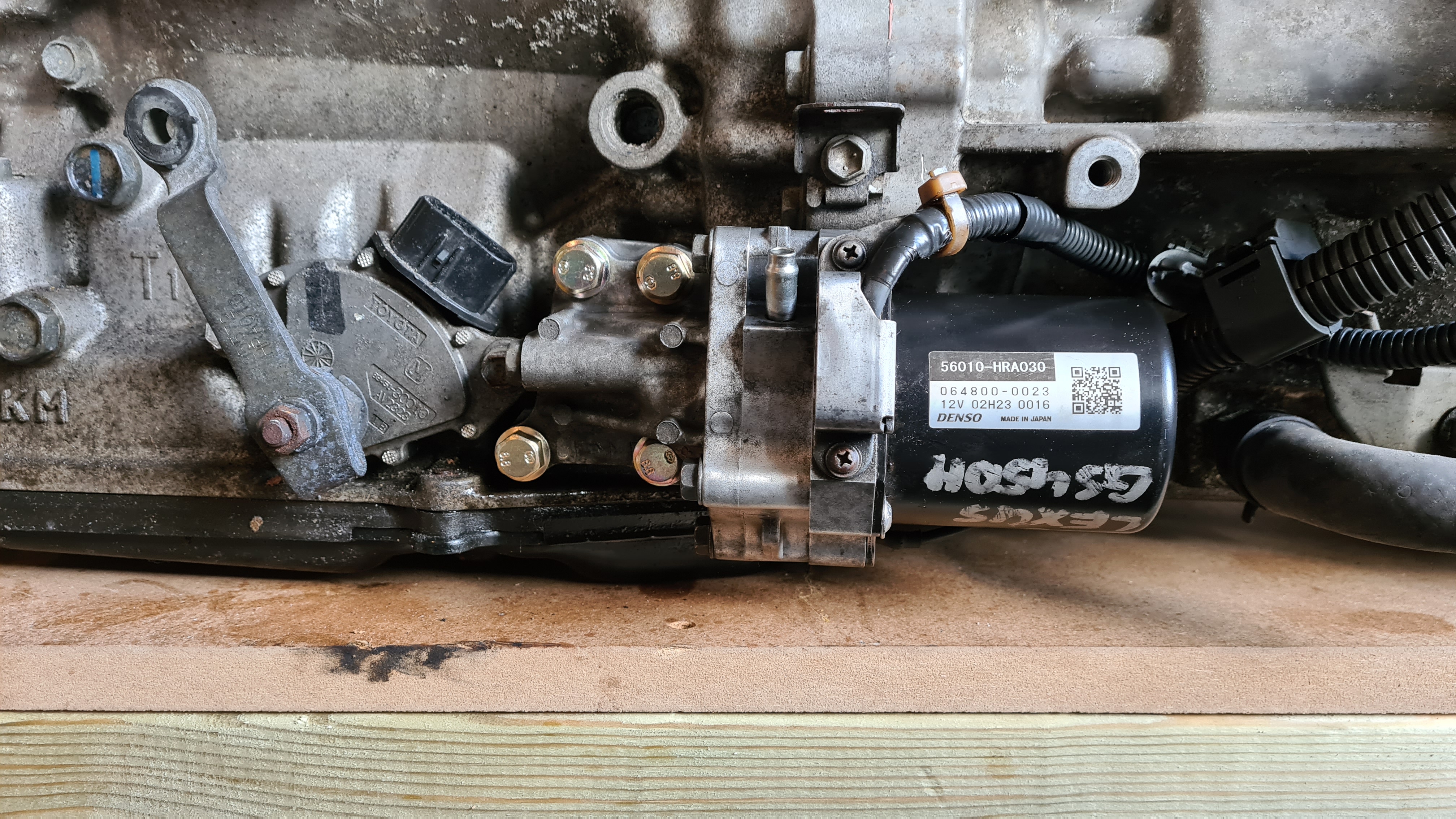

M8 35mm bolts arrived so I've fitted the refurbished oil pump.
(Next job is to test the pump runs ok before I continue.)

I measured the depth required and it's about 35mm.
xp677 and ggeter in another thread confirmed the bolts as M8 35mm long, with thread of 30mm, 1.25mm pitch. Ordered some, arriving next week!

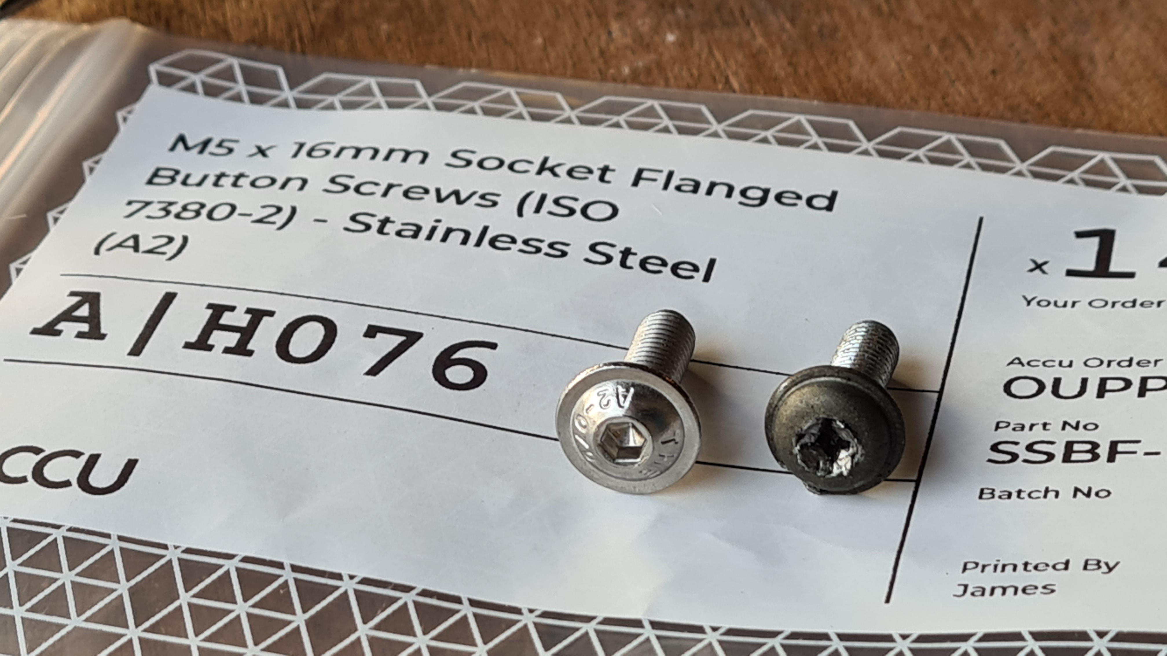

Also, in case it's useful to anyone...
The replacement screws I bought (see above) work great, replacing the screws I accidentally stripped...

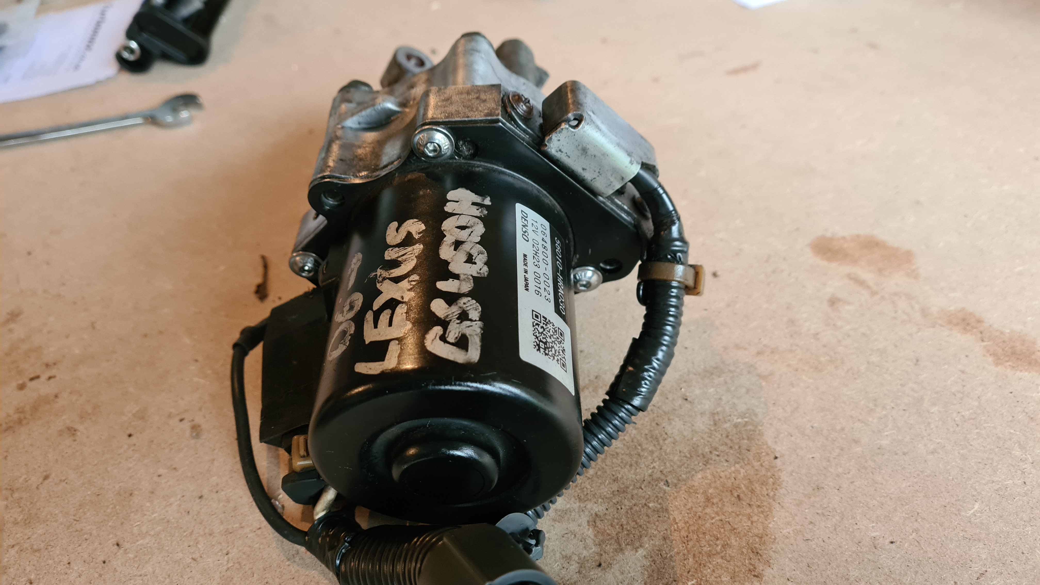

Have replaced all the o rings in the oil pump as they were corroded.
For others who are refurbishing this oil pump (part no. 56010-HRA030) if you need new o-rings you'll need are:
1 x 55mm int. diameter, 2.5mm cross section (For the black outer case).
2 x 50mm int. diameter, 2.5mm cross section ...

Bought some screws to replace the ones I accidentally stripped trying to disassemble the oil pump.
(new one on left, old one on the right)
Then whilst the oil pump was apart I cleaned up most of the rust (not sure why it was rusty, left in a junkyard in Romania for a few ...
