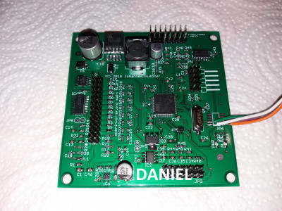

Re: Problems during starting Main Board V3
https://youtu.be/src0PSWVUYo
What are your current parameters?
The parameters are on the first page
When I swapped the motor wires physically, engine started working
I connected as follows:
Engine U - L3 - PWM3
Engine V - L2 - PWM2
Engine W - L1- PWM1
Why ?
Below is a photo of the readings
34 ...
If you have current sensor errors with FOC code you need to switch them on the board or inside software. I did the same mistake when designing according to old rev2 board made for ACIM motor. There sensors were there only for monitoring overcurrent protection. But with FOC code you really need to ...
Why the displayed current value in the program does not change ?
I give it 5A * (1.5mm² cable 10 times through both sensors) = 50A
