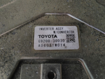

Kevin Sharpe wrote: Mon Sep 07, 2020 9:54 am I'll also try and find the inverter part number on LEXI when I'm at the workshop :)
Here is the label from our GS450H (2006 car iirc);
