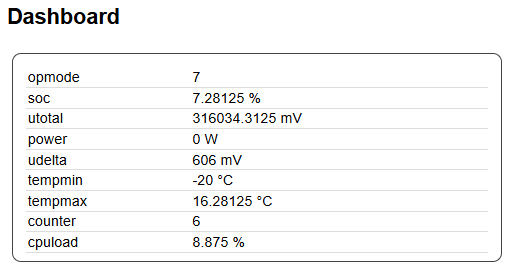

Re: Flying ADC 16 channel BMS 96S test
@johu I tracked it down to Q5 being defective and replaced it.
All the other components look fine, and I’ll connect the BMS back to the battery.
Do you have any recommendations to avoid stressing or burning components on startup?
Would it make sense to disable balancing before power-up, or is ...
@Mario How did you diagnose Q5? I have some possibly unrelated issues with my boards but looking for ways to test different components to identify issues.
Johu described this earlier... Measured source vs drain pin with multimeter in diode test mode... It should show about 0.5V if it's ok ...
Reporting status of my BMSes...
I did capacitor patch on all boards and uploaded newest firmware on August 28th. First I powered BMSes without battery and it was ok.
Then I powered up with battery connected and all worked like a charm. Balancing about 1 mV per day.
On September 2nd I decided to ...
