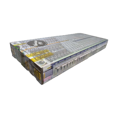

Re: Tesla CAD Models
Westside EV in the US sells a cardboard mockup of the model S/X battery module.
