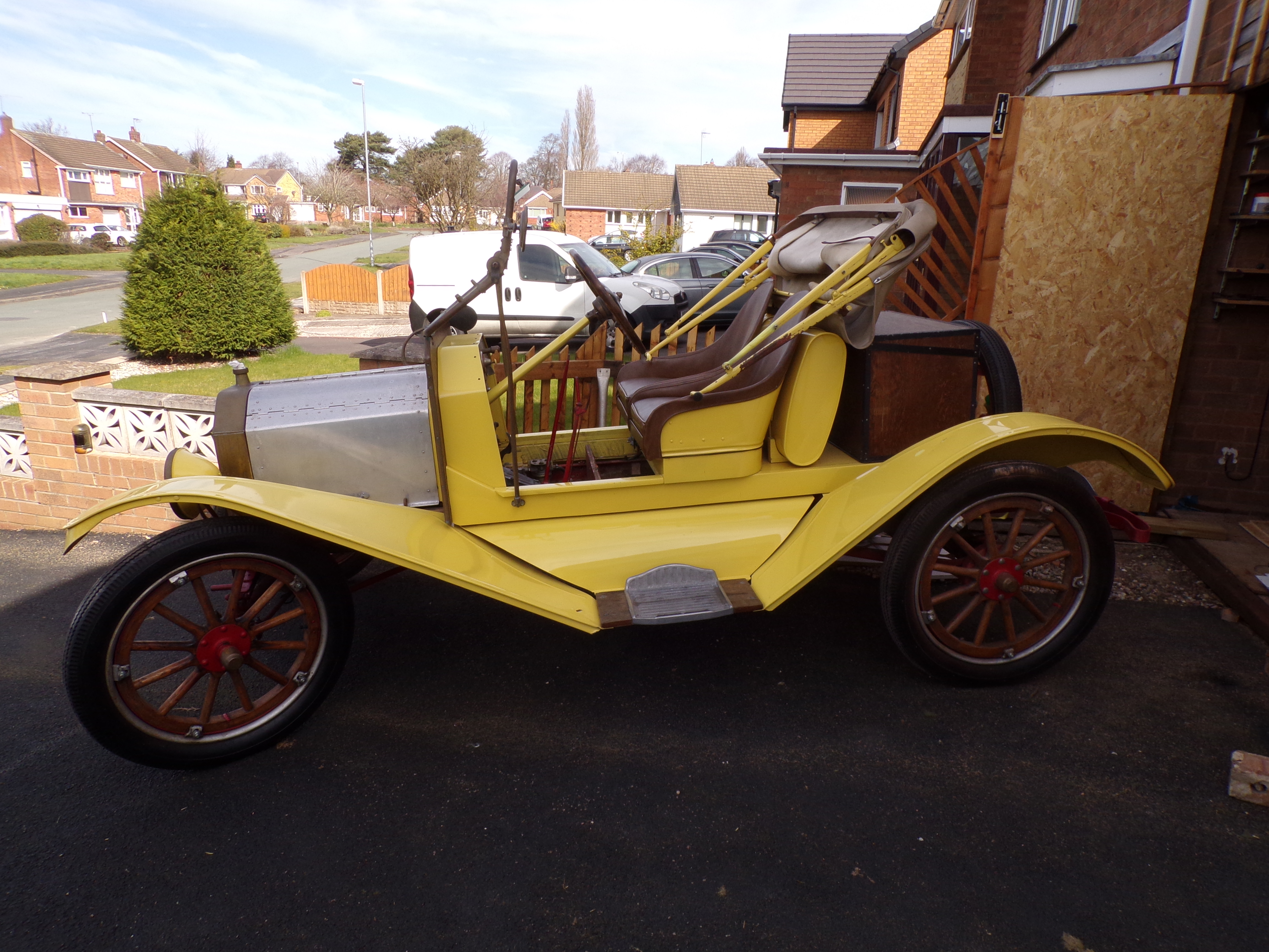

new project, Ford model T 1911
ready to start my EV conversion, I have the main components, motor, controller, charger and have selected the four batteries ready to order later, the original box at the rear will carry the batteries, the Agni motor will be coupled to the existing gear box, under the bonnet will be housed the ...

does anyone have experience of a CURTIS PMC 1204M-5305 DC Motor Controller controlling an Ignis 8.5kw 48 volt DC brushed motor, I have been told that there are incompatibility problems and just wondered what effect this has on the overall performance, thanks

I've used salvaged welding reactors in the past, but a Prius boost inductor would probably be a good choice these days.
thanks, but I have no idea what these are or how they are integrated with the speed controller, can you explain, or better still, for simplicity, will this controller work to a ...

The Agni motor is very low inductance. You get better efficiency with a higher switching frequency, which is why the designer Cedric Lynch liked the Brusa controllers. I've added external inductors to help Curtis controllers out.
The other thing to consider is that the no-load and full load rpm ...

Hi, I am still trying to find suitable means of speed control for my Ford model T, I have the motor now, it is an Agni 8.5 kw DC brushed 48 volt motor, I have looked at various PWM's but each time I find something suitable and affordable, there is some sort of problem relating to it which stops me ...

Brushes last pretty well and are available from third party sources. The motors aren't technically difficult to service, you just need to build a special rig to pull the motor apart. The only thing holding the casing together is the magnets.
thanks for that reassurance and so it is back to ...

AGNI are part of Saietta these days. Whilst they have a stock of motors and controllers, they're not making them any more and have not been able to offer servicing, or supply things like replacement brushes for some time.
The motor controller is a pain. I'm informed they spent £700,000 of grant ...

Hi, I have heard you mention this Prius inverter before, and yes these are readily available in the UK for around £50, sounds ideal, but I am not able to use one of these simply because I would not know how to reconfigure it for my needs, is there anyone on here who you know, would be able to help ...

does anyone know the best speed controller for an Agni 119 motor which is 8.5 kw 48 volt dc , 4000rpm please
