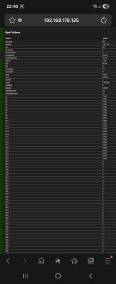

Hello,
I changed balancing a bit. If deltaV is big, BalHys grows.
Also showed it in parameters list.
But the strange thing is, I can upload it to both boards I bought, but 1 board it works, 1 led red constant, 1 led blinking ...

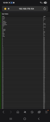

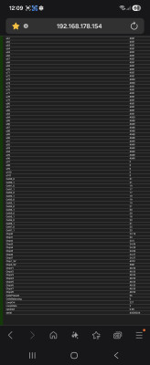

Screenshot_20251015_062544_Samsung Internet.jpg Screenshot_20251015_062602_Samsung Internet.jpg
4mv imbalance
89 balancing
After 29 hours working time
Works nice for me, as expected, only little speed up ;)
I measured balancing/bleeding time is approx. 25%
Hopefully Tom can speed it up to 95 ...
4mv imbalance
89 balancing

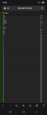

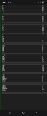

Screenshot_20251014_074135_Samsung Internet.jpg Screenshot_20251014_074144_Samsung Internet.jpg
After a night, seems cell balancing does not do anything (spectacular) (Can be my fault)
Question for makers: cell balancing M3 module is done by resistance wire, right?
1: How did you imitate this ...

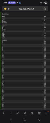

Did a update to both boards....
With STM programmer. What a hell of a job... Without Tom, never succeed...
I replace very little:
Balance voltage is highest cell voltage - balhyst (0.002v)
Hopefully it will balance nice....
Screenshot_20251013 ...
