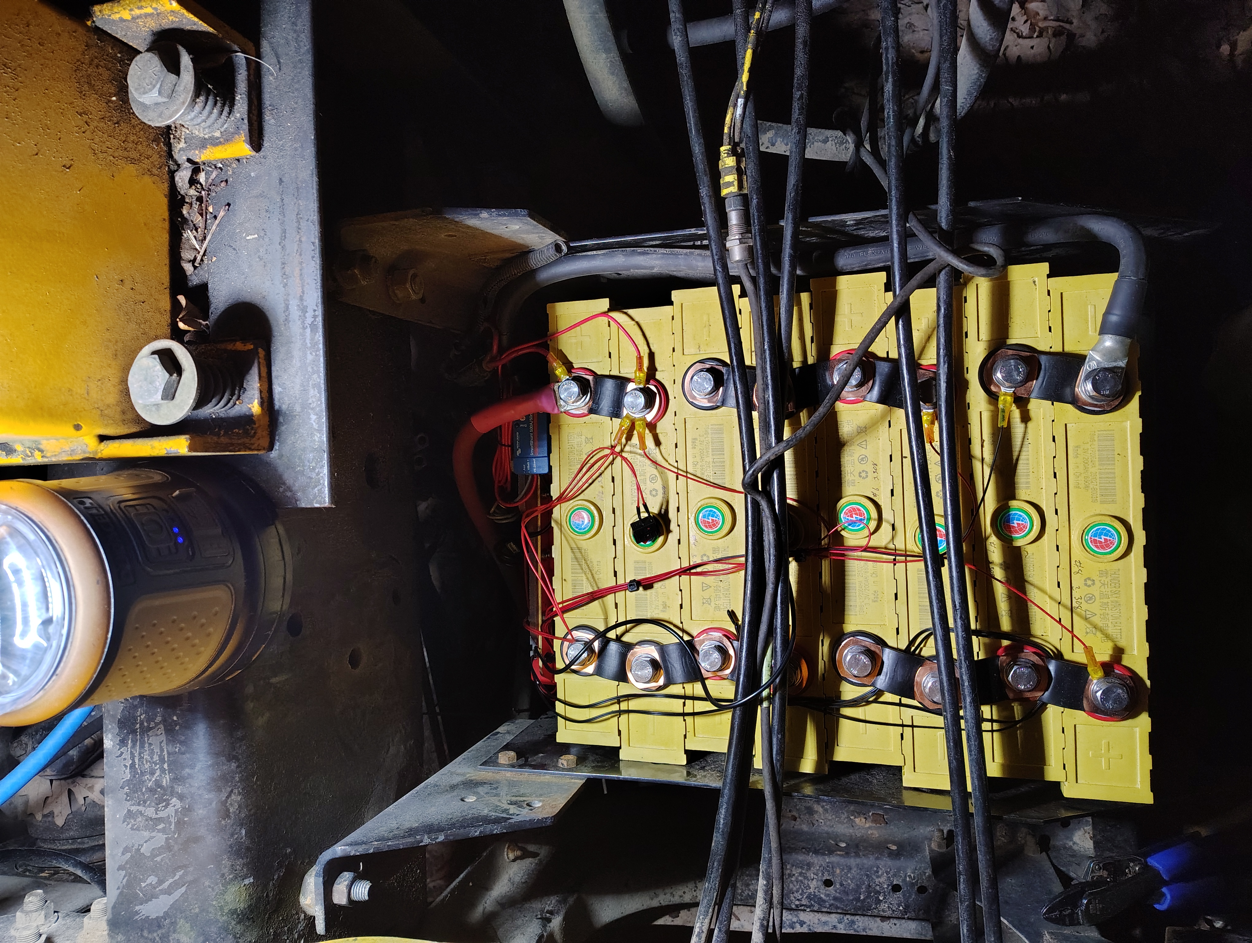

Re: Converting my dump truck
Need to tidy it up a bit yet. Not the cleanest install, but this is intended to be relatively temporary. It's all hooked up. No communication from the BMS or any indication that it turns on yet.

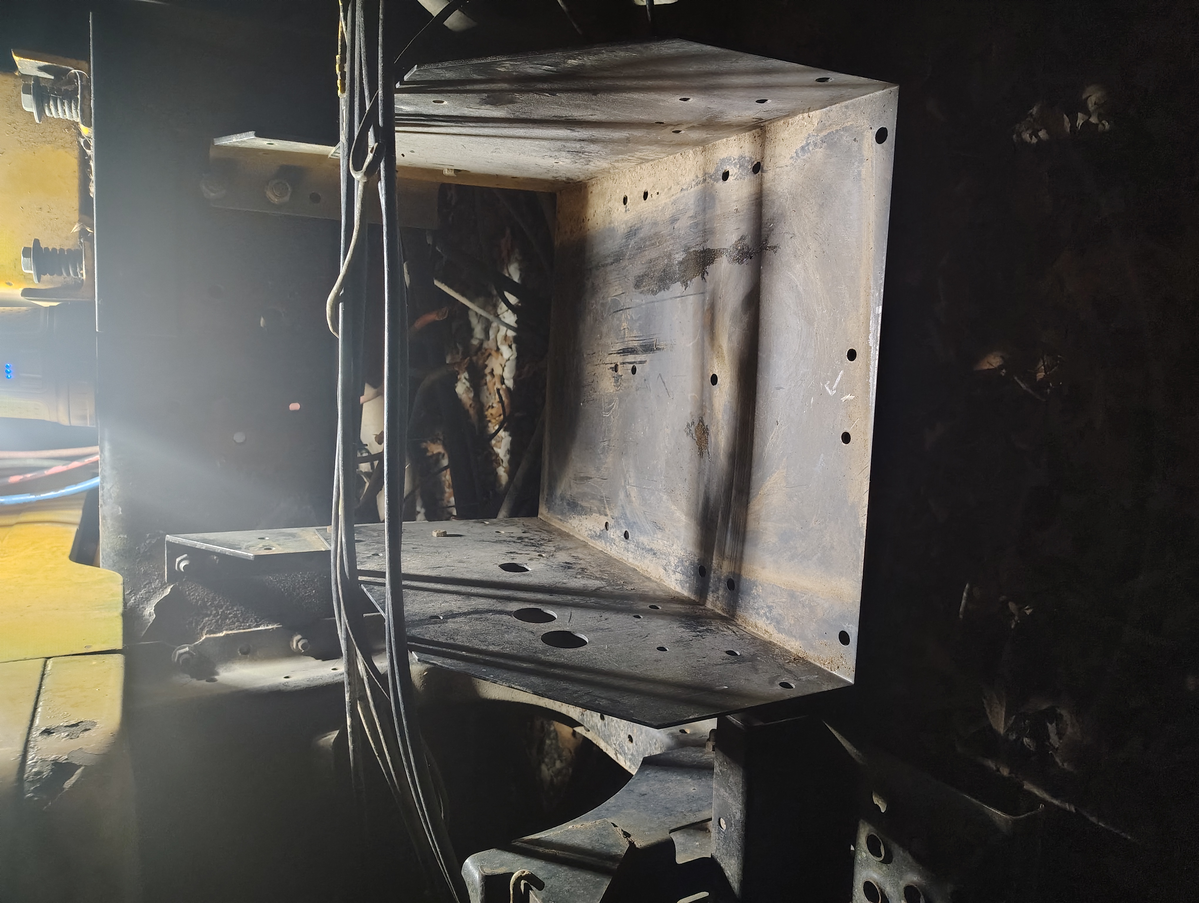

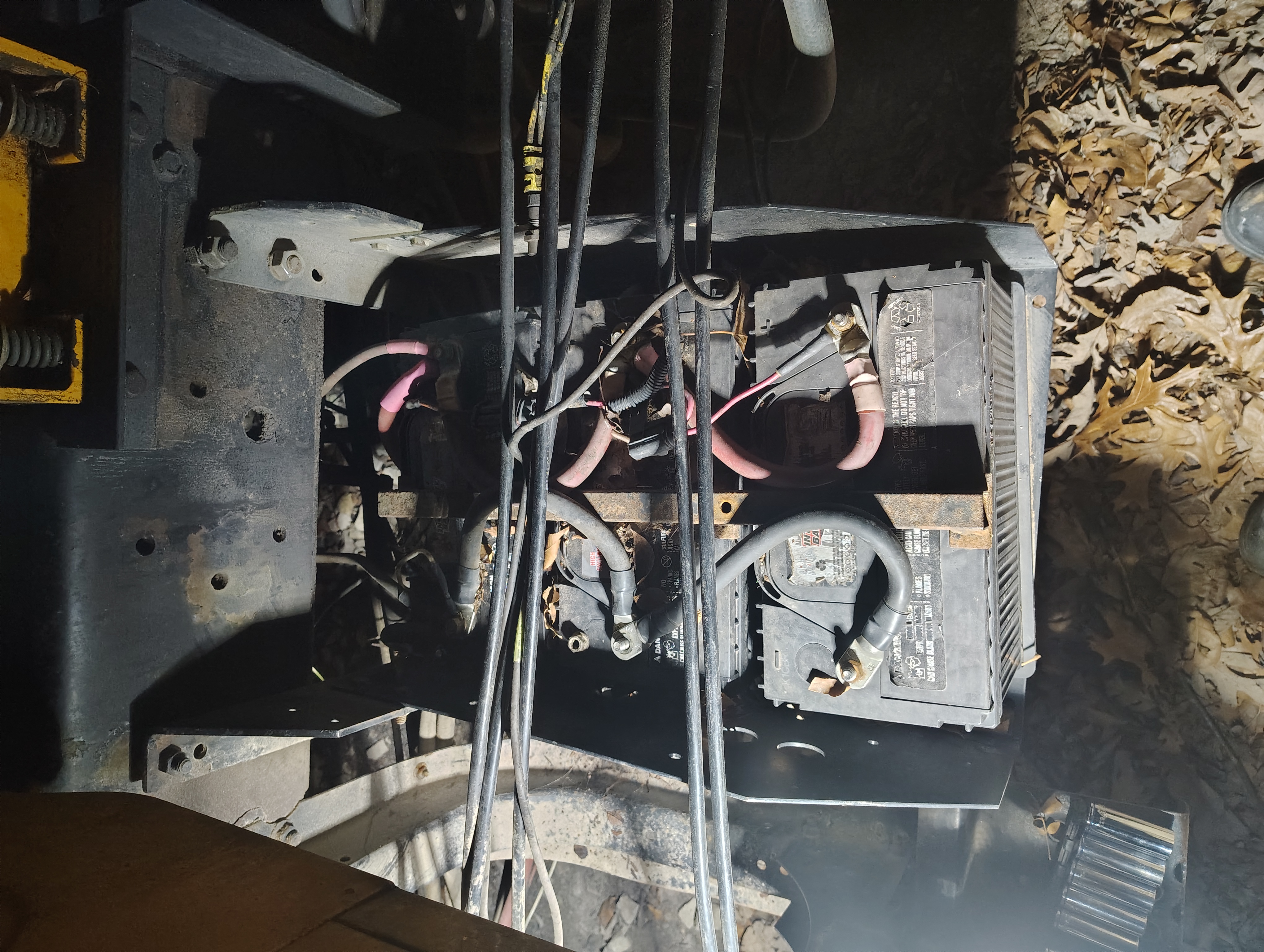

Felt like going ahead and pulling the lead acid batteries out. 171 pounds of lead acid in total. The eight Winston cells are around 139 pounds.

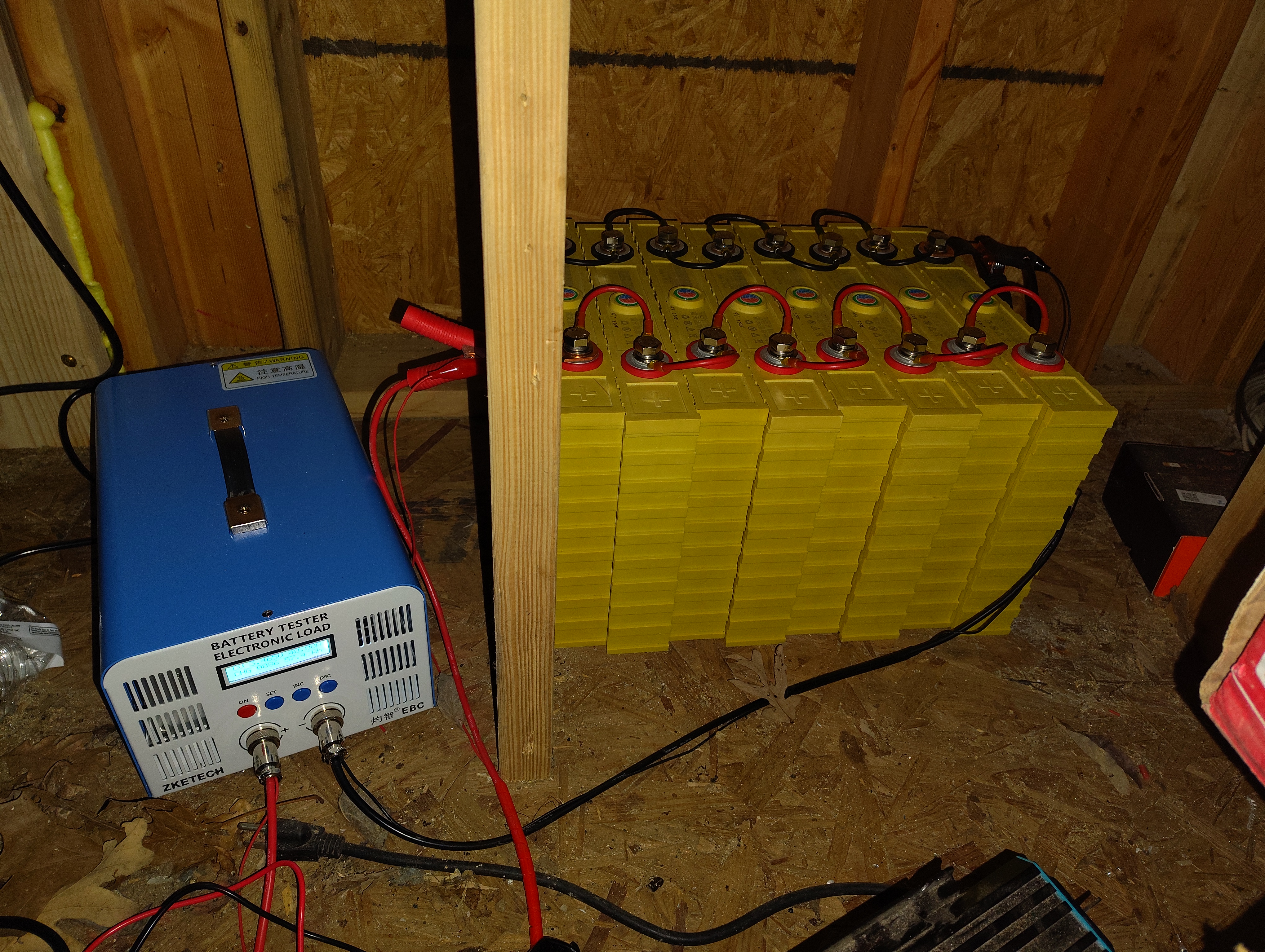

OI forum has been super buggy on my phone, so no pics. Got all the LTO cells balanced up and assembled into a 2p6s pack. Just need to finishing designing the case.

Keeping the build thread going.
Bus bars for the LTO cells showed up. Cleaned those up and fired up the EBC to top balance the cells. Wonder how long the three lead acids batteries in the truck will power this :D
Likely won't be until January that the first set ...

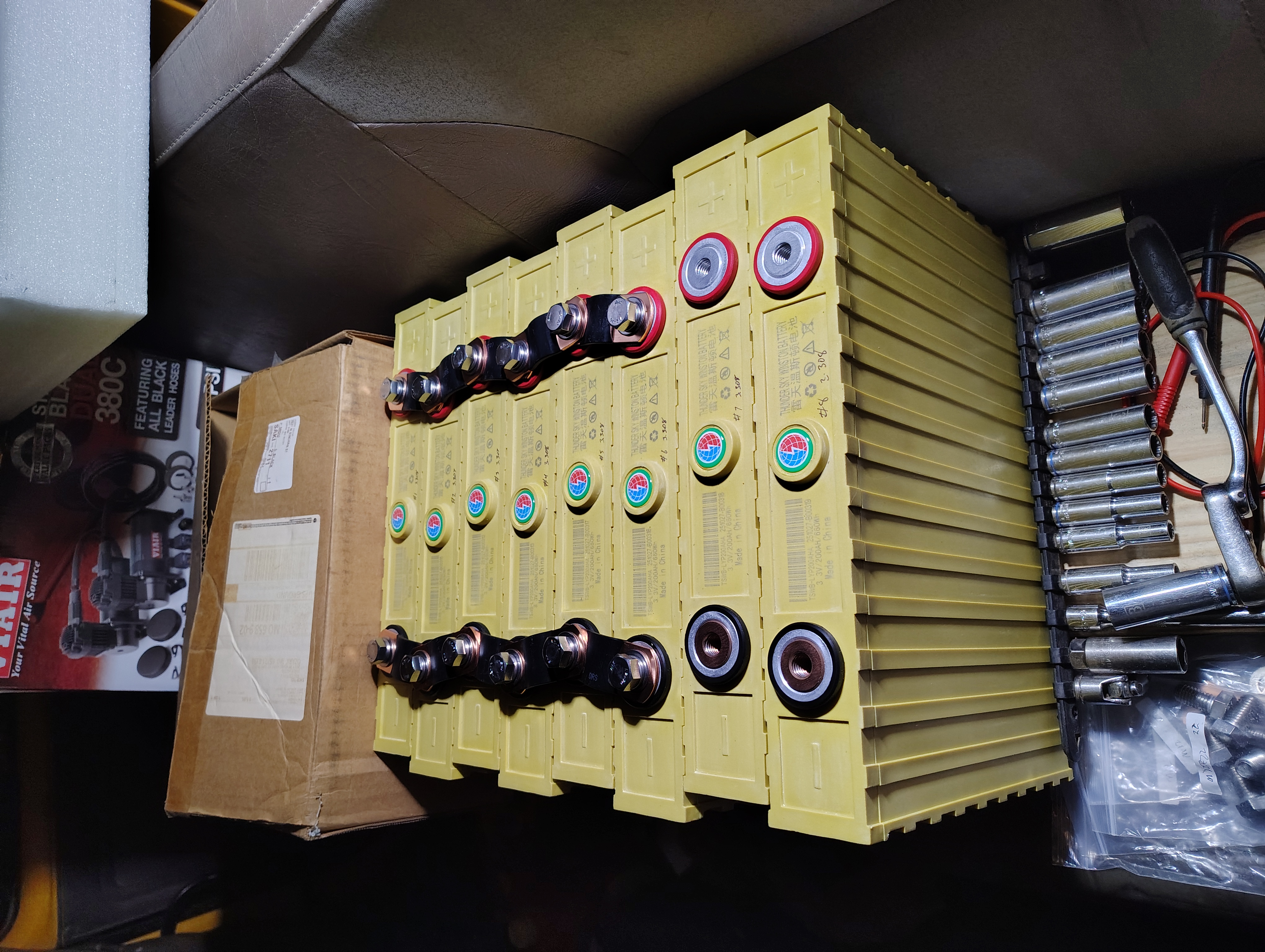

Some goodies came in a couple days ago.
Yinlong 40Ah LTO cells to make an 80Ah 12v battery. This will be for LED lighting, radio, maybe the air compressors, etc.
Set of four Viair 380C compressors to operate the air brakes and horn.
IMG_20251110_014632995_HDR ...

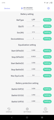

Re: Enerkey BMS
Update: Kiwi got me working. Just one setting had to be changed.
