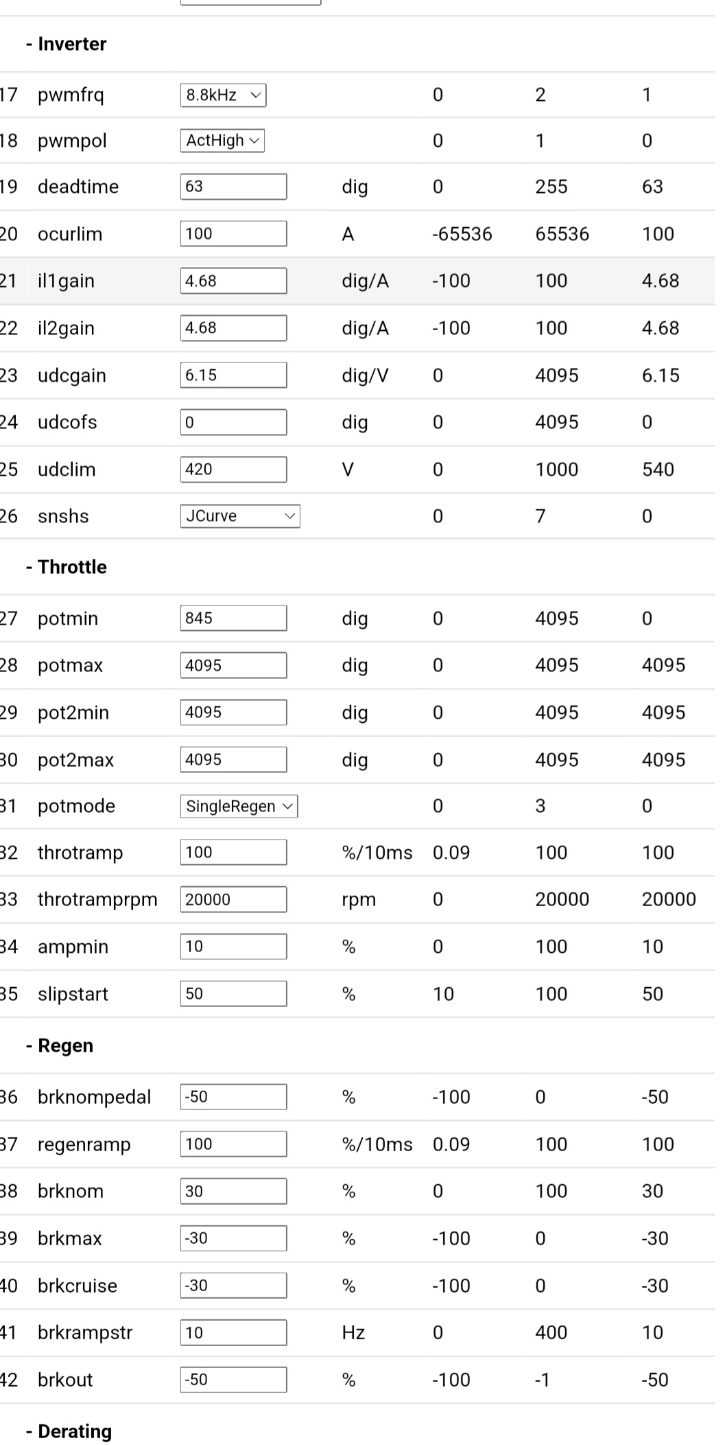

Here is the Parameter file.
- params.json
- (1.45 KiB) Downloaded 234 times
- qmedia2651
- Posts: 56
- Joined: Tue Oct 06, 2020 4:13 am
- Location: Orlando Florida, USA
Re: Main relay opening when throttle signal

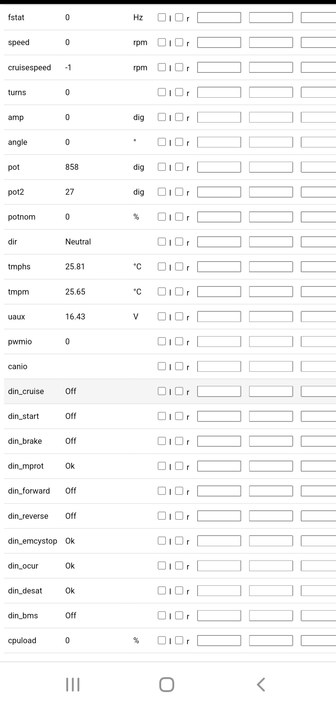

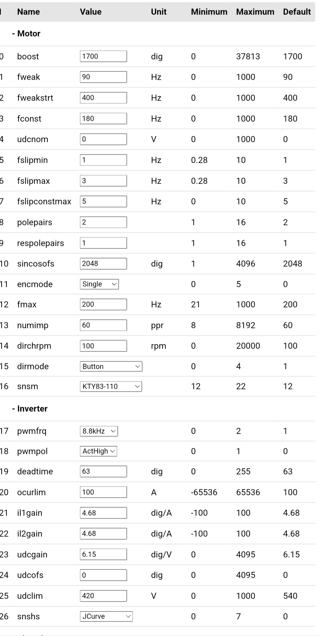

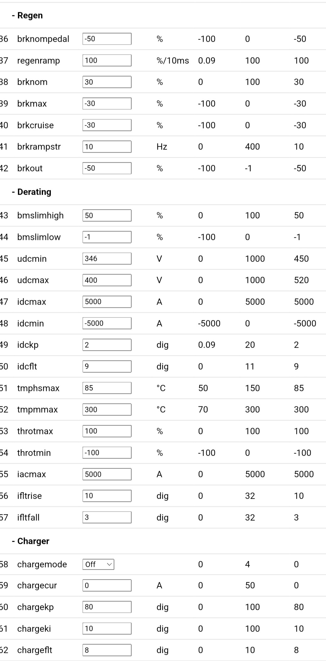

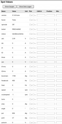

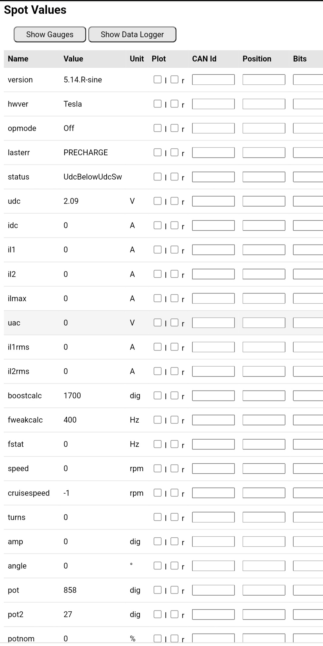

Johu here are some pics of the web parameters
with no voltage applied.

You have default parameters loaded, please use the "Download File" button here: https://openinverter.org/parameters/view.html?id=15 and then the "Upload parameters" on you web interface. Then save to flash. I'm guessing something in the configuration makes it trip.
