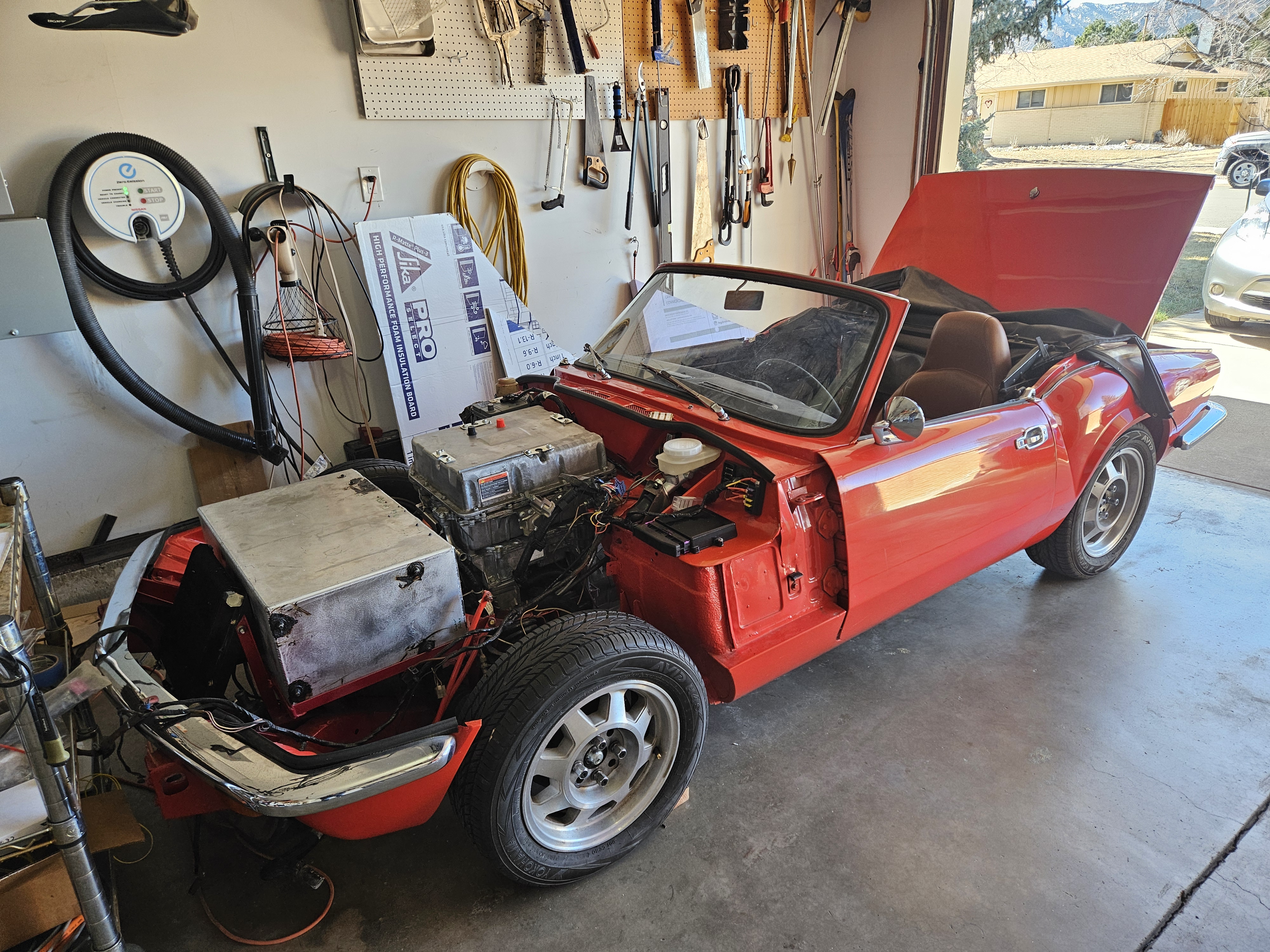

A WIP that is getting closer, its been over a year.
I have the motor, batteries and transmission installed. The batteries are split between the front and back. The transmission on the car was shot so I replaced with a torqbox (https://www.torquetrends.com/ev). As expected it has not gone perfectly to plan, but it feels like I am getting close to rolling.
Currently I am having issues with the master HV- contactors not turning on. I have a set of contactors in the trunk batteries and one in the front pack. Things worked prior to splitting the pack and installing in the car.
Next steps get the contactor working, plump up the coolant system then test with HV.

Hello I am using the Zombieverter as the VCU. The motor, inverter, charger, DC/DC is a Nissan leaf stack from a Gen3. The batteries came from the same car. The throttle is also from the leaf. I tried to reuse the radiator and pump but couldn't make it fit. I currently don't have a BMS which makes me nervous but I have temp sensors in the battery boxes. I use the IVT shut to measure overall voltage. Long term plan is to get a master slave BMS like the thunderstruck Dilithium. I like the people at thunderstruck and used them for contactors and the torqbox.
The car has rolled in the driveway but it was terrifying as I was using the stock Zombie settings. Something was off with the throttle settings and it gives 100% power with the slightest touch of the pedal. This basically launched the car then it does some madness with regen. I watched some videos on setting the pedal range and had that correct but the other settings such as the throttle ramp seemed to cause problems. I now have it detuned and have gone 1/2 a block at 6 mph. It really hates going slow downhill and jitters like mad. Some odd pulsing is going on with the VCU telling the motor to do odd things. I hope more tuning of the throttle and such will fix this.

I kind of have the contactors working. I went overboard because I split the battery pack and I wanted the power lines isolated when the car is off. I have four Kilovac EV200 contactors all on the zombie main2 control line(HV- pin 3). Two contactors in the rear box and two in the front. My best guess is this main2 transistor can't sink enough current to turn these on. I connected all 4 and measured the current was about 0.5 Amp. I then setup the rear box with a manual switch; this worked fine for one day. Two days later I started getting pre-charge failures. Now I can't pull down the front two contactors. I connected the front contactors to the same manual switch and that allows me to get through pre-charge. When I get back from my trip I plan on testing a low power relay driven off pin 3 to see if that works. The HV+ Kilovac has one contactor and is working fine on pin 33. I have looked at the HW design on the zombie board I think the transistor is a NCV8402 https://www.mouser.com/ProductDetail/on ... vSnQ%3D%3D and it could handle 7 amps but only 1.25W. I have 12V * 0.5 Amps = 6W, maybe that's a bit much.

I was able to drive the car around the block and it seems like its going to work. Granted I still have lot of work to do.
I am glad to hear the dcdc should just work. Something must be connected incorrectly or configured incorrect. I have followed the leaf gen3https://openinverter.org/wiki/Leaf_stac ... ombiverter doc but I have a IVT-Shunt.

Project Update
I have the AC to DC charging working. That is really simple on the Leaf, no need for the proximity line from the zombie.
The DC to DC is now working and it runs a 14V.
I have been working on tuning the throttle and having difficulty. The car ramps up very slowly then starts pulsing around 3000 RPM. I can't get it to go over 25 mph. I set potmin,potmin2 and potmax, potmax2 based on my throttle(they have always been set). At first I had some odd unfinished version of 2.30 FW. I am not running the official 2.30 FW release. I have been adjusting throtramp, throtrpmfilt. I will post a bit more as I learn more. I did go over the code and learned of the spot value torquederate. The plotting tool should help me figure out what is going on. I will post more as I figure out more.

Thanks for the responses. I didn't understand what udcmin was doing until I looked at the code and I watched the torque derating while driving. I saw udc derating get triggered.
Now that I have reviewed the code and some of my settings I see why its not working and I feel better knowing what is going on "under the hood".
For one thing I had limited the throtmax to 40% expecting that to be just a cap. I think it does a bit of scaling of the pedal so that a full pedal movement only represents 40% power rather than just capping the power to 40% when the movement goes above 40%.
I actually stated with a set of params like the truck set but I had a weird version of 2.30. I was testing that last winter to see how to run my gauges. I never noticed the beta version was unstable when I had the motor with no load on it. I just thought oh its so powerful that with no load it spins up really fast. I forgot to update to a official release prior to testing after install. I got too excited to see what would happen. Well the odd 2.30beta would just hit 100% power in forward or reverse with the slightest tap on the pedal. It was rather scary. This drove me to set what I thought where very conservative values. I finally remembered that I had the odd FW and upgraded to the official 2.30 but was still nervous.
I am excited to test with a more rational set. It raining so I won't do any testing until it clears up.

This is so exciting it stopped raining so I tested the truck settings on this. It is amazing. With those settings everything is working.
I have had this car for over years. I learned how to rebuild the 4 cylinder when I was 18. Many years later I rebuilt a GT6 frame and engine and put the tub on that. That was very fun. But the Leaf engine in this is a whole other dimension. Its almost hard to control as it has so much torque. So far the diff and "donuts" have held out.
Soon I will get brave and take it out beyond the neighborhood.
Again thanks all for the help. It should have been easy but I made some mistakes that lead me off course. I am very excited to get on with the project and build the gauges and clean up the interior.
