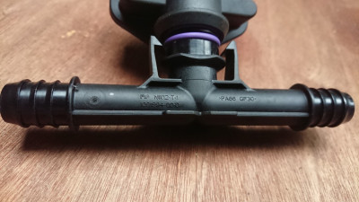

Anyone know a source for the coolant connectors used in the Tesla Model 3 battery packs, or who might make them!? Hoping to find a T-connector but with smaller port size to rearrange cooling lines

Thanks Amzoo,
I'll take a look and see if I can get a T-connector version among these

Re: Tesla Model 3 Battery Coolant Connectors
Which t-connector version did you find and use?

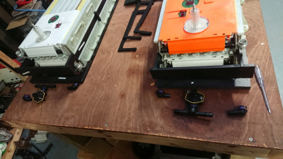

Change of plan in the end. TM3 battery pack has four separate inlets so decided to use the four rather than T from two. Allows me to reuse all the TM3 coolant connections and keep the relevant hose sizes
