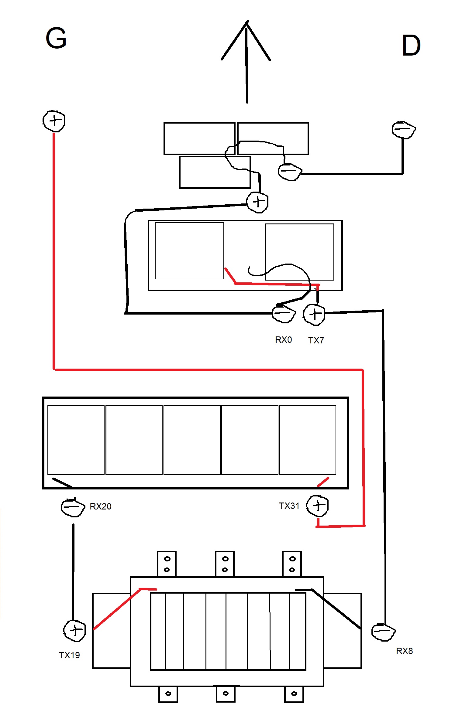

I have been building my car battery pack using the diyBMS.
This project was developed for diy powerwalls but i thought it would be great for my car.
Now that it's all working i have a few problems. :!:
When i drive the voltages are very slow to show any variation, i thint it's every 6sec.
When i charge the modules go crazy and i lose all communication.
The voltages go from 3.8 to 4.2 but it's not possible as the batteries are 240Ah and i am charging at 3Ah or 14Ah.
so i have a 32s3p battery (https://www.facebook.com/106.Electric)
Each bms is conected in a way that all 3p have the same lenght of wire to it.
Also there are temperature probes screwed in the terminals but don't worry about that.
All the cables are twisted.
All the cables until the last 10cm (when they go to the modules) are shielded.
The shield is grounded to the car chassis (negative) close to the controller and at each of the 3 packs.
Any idea of what i can do next?
I can't charge the car but i can drive it :roll:
Should i give up and get the 4-channel BMS from johu?

I only had time to test all the packs individually and they work perfectly, only the front pack has 10 crc errors out of 350 packets,
the rear and the middle pack show no errors while charging at 20Ah.
Next i will test the cables from pack to pack and see if i find the one trat cuts communication.
The strange thing is that only if i connect all packs to the bms controller they will go crazy while chanrging and start balancing the first cell of each pack because it shows more than 4.2v, but connecting one pack do the bms no cell or bms module goes crazy...

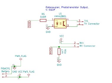

Do you think a bad isolation is possible?
What do you use for Rx on each module?
My BMS uses Pic12f directly on the Tx line (4V) and on the next cell i have optocoupler on Rx. That opto needs input resistor determined by opto CTR and its properties.

still why noise would change the voltage value of a cell?
https://github.com/stuartpittaway/diyBM ... ircuit.pdf
