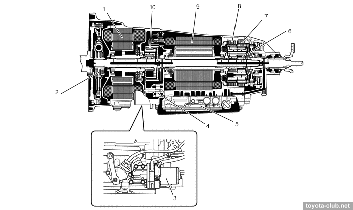

Uhm no! I would review the way the oil is routed and where it sprays out.
Note that there is also a lot of stacking of shafts with oil based bearings. https://toyota-club.net/files/faq/21-12 ... n.htm#L110
