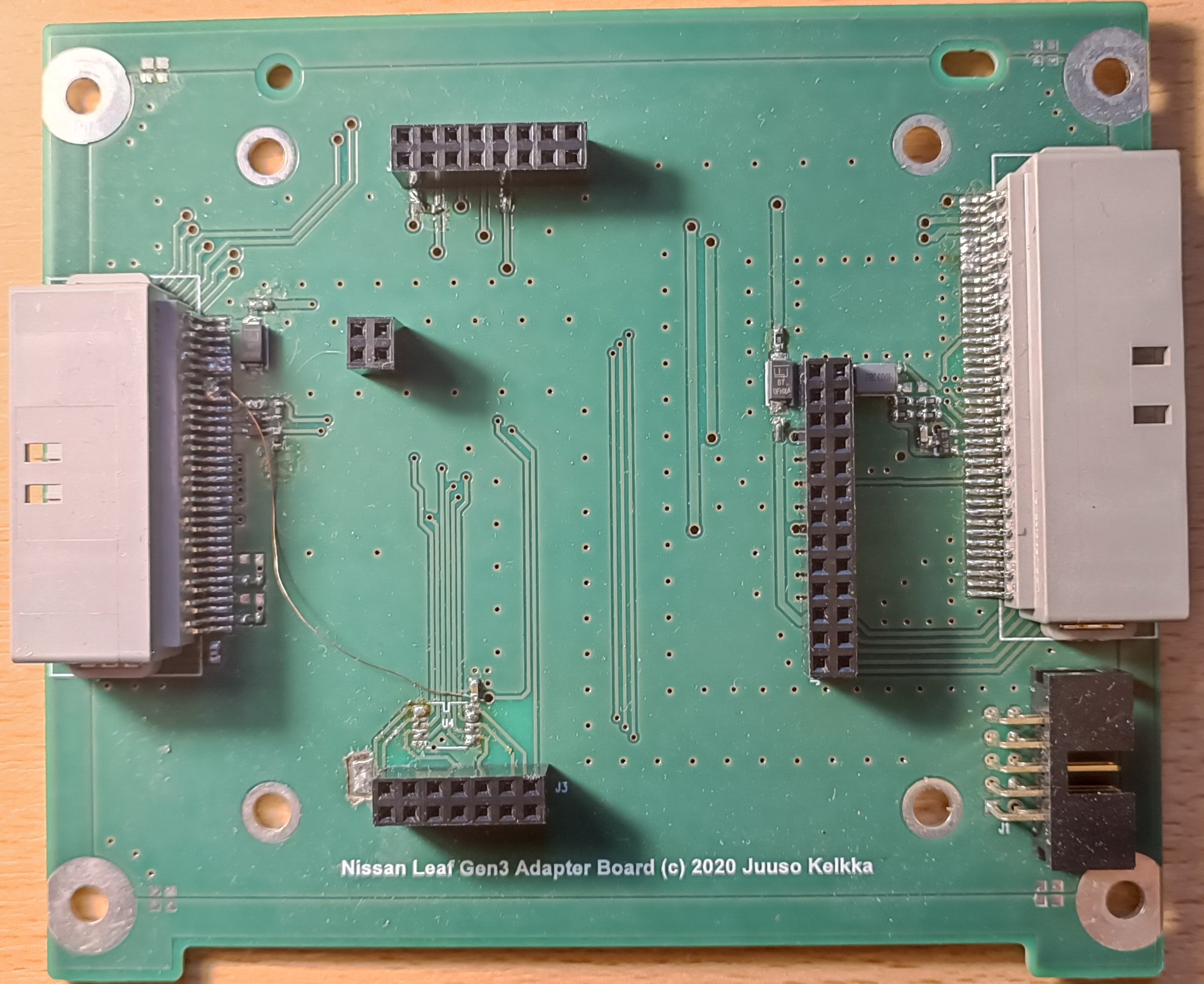

Attached is schematic from adapter board. There are some mistakes on it, will comment on the corrections later
Leaf_Gen3_Adapter_A11.pdf
(25.27 KiB) Downloaded 1271 times

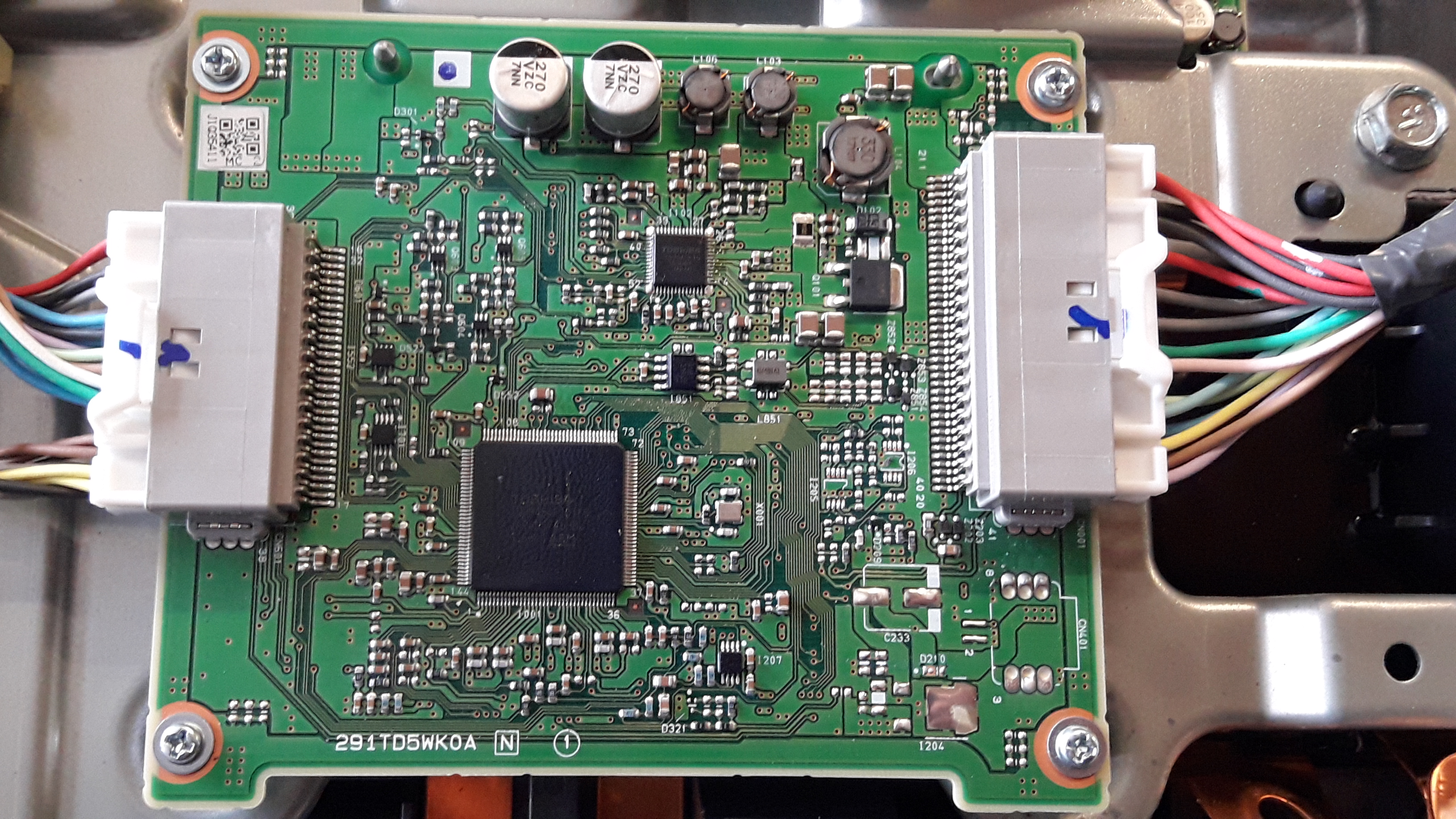

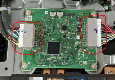

SRFirefox wrote: Thu Jun 02, 2022 9:29 pm Do you have dimensions for connector and mounting placement? Or a Gen3 mainboard for reference. I'd be happy to do the layout for this board as well.
A picture or preferably a scan of a gen3 main board could work for the connector.
Anyone happen to have a Kicad footprint of the openinverter connection they can share?

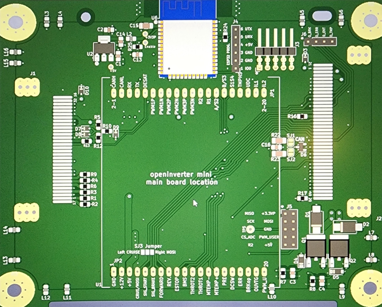

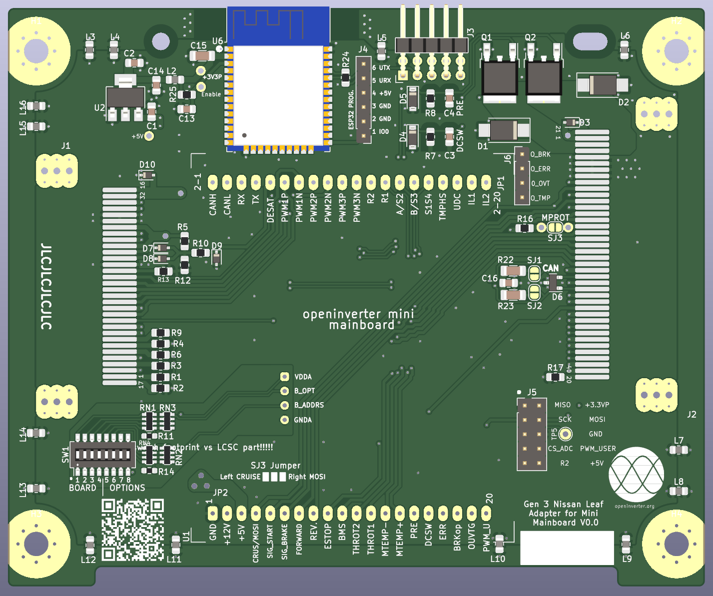

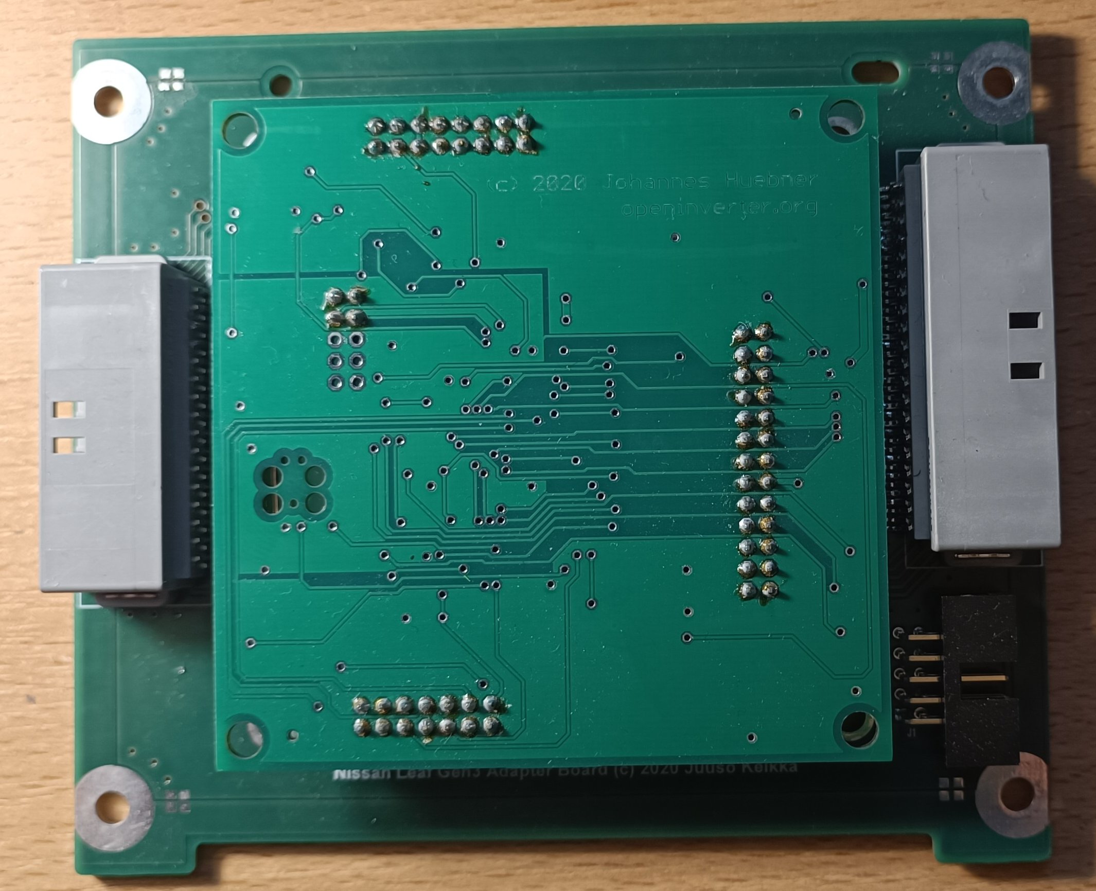

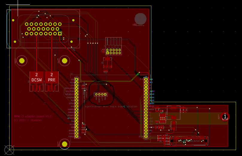

The i3 board uses the mini mainboard. It's just two 20-pin 0.1 in headers
Scanned the board in 300 dpi
Also attached two pictures.
The new design should be based on the mini mainboard as it is smaller, cheaper and lower profile. Also it should use the ESP32 directly soldered to the board.
Now the changes that were made:
- Correction of wifi module pins
- mprot pulled up to 12V
- removed the line driver, the STM32 can directly drive the PWM channels in open collector mode
- connected 5V to the inverter connector pin 7, 8, 9
BMW-i3-adapter-kicad.zip
(794.9 KiB) Downloaded 879 times

@johu, would you be able to measure the mounting hole dimensions? (sorry, forgot..)
Any idea on the Nissan connectors specs / footprints on the adapter board?
For the fixes, are those specific to the leaf gen3 inverter?
Any issues with the i3 adapter you shared as is?
JP1 & JP2 were swapped on a different board (Nissan gen 2?) Is that an issue with the i3 design?
Thanks for doing the legwork on this stuff.

I started a Gen 3 leaf page in the wiki https://openinverter.org/wiki/Nissan_Le ... 8_up_EM57) but I'm having a hard time finding some info.
Questions I have so far working on this adapter board.
Info needed:
- can someone measure 2 screw holes for me? I can scale Johu's scan image but need a length reference. Any will do but all screw holes and the 2 alignment pin locations would be appreciated.
- Is there a list of pin outs for the 2 Nissan connectors on this adapter board? The round connector pin out is for connecting to the inverter, that makes sense to be in the wiki but doesn't do much for making this board. I have the early attempt designspark schematic pdf, can I trust it?
- Anyone have the part #s / footprints for the Gen 3 Nissan connectors required?
Design questions:

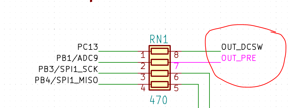

- Does it make sense to have the mini main board be separate? Worth pulling everything into 1 board?
- The 6 fet driver lines do not seem to have pull downs on them in the adapter board or the mini main board. Catphish had this note for the Tesla boards, https://github.com/damienmaguire/Tesla- ... t/issues/7 I think these pull downs should be added here as well unless they will be added to the mini main board...
- In the same logic / safety thinking I believe we should also add pull downs for the pre-charge and battery contactor fets.
Anyone have some design input / info for the above?

Re: Make Nissan Leaf Gen3 adapter board
I'm pretty rubbish at measuring, all I can tell you is the board is scanned with 300 dpi.
Personally I prefer to do the complicated routing only once plus I can order a larger quantity of generic mini mainboards to get me through the next chip crisis (let's hope there isn't one any time soon)
These operate opto couplers directly by pulling them to GND, so pull-down is not what you want ;) Plus it requires significant current to trigger them. That's why I prefer NOT to have a separate driver chip with super sensitive inputs that act like an amplifier.
Agreed, plus gate resistor, plus TVS across drain-source and as catphish prefers even across gate source.
EDIT: I prefer not to have freewheeling diodes with cathode on 12V on board as in some setups they will reverse power the circuit

johu wrote: Sat Sep 23, 2023 8:13 pm I'm pretty rubbish at measuring, all I can tell you is the board is scanned with 300 dpi.
I'll scale it from the connector lengths and work from there. I'll make a pdf of the board to print @ 100% and we will have someone try it before fab.
Understood. I made a Kicad footprint & symbol for the mini mainboard to help simplify future adapter board work.
I'm glad I asked. Thanks for connecting the opto dots!
Thanks for mentioning the freewheeling diode note.
Mini mainboard looks to have 470 ohm gate resistors inline already,
The rest I will add.
Johu, do you have any raw pcb's / gerber files with the Nissan connector footprints? I can scale those too but I don't know what they look like under the plastic / pins.

If someone has a gen 3 leaf inverter and is willing to check fitment, please print whichever of these pdf's fits your paper size.
Things I'm asking for help to verify (I don't have one of these inverters):
- The 5 holes and 1 slot all line up at the same time. If they don't line up, please line up the bottom left mounting hole, center the top left mounting hole on the line, and take pictures of the other holes.
- Board edges are close with holes aligned.
- if after those are verified cut your print along the red lines and across the terminals of the connectors. This should give a nice reference to use to check pin width and pin spacing for the 2 connectors.
The above will help verify the mounting & locating holes are in the correct places and will help me draw up footprints for the connectors.
If there is some pin numbering on the connectors that you could share it would help a bunch.
Early Gen 3 Leaf Adapter Board A4.pdf
(26.54 KiB) Downloaded 894 times
Early Gen 3 Leaf Adapter Board 8.5X11.pdf
(26.48 KiB) Downloaded 884 times

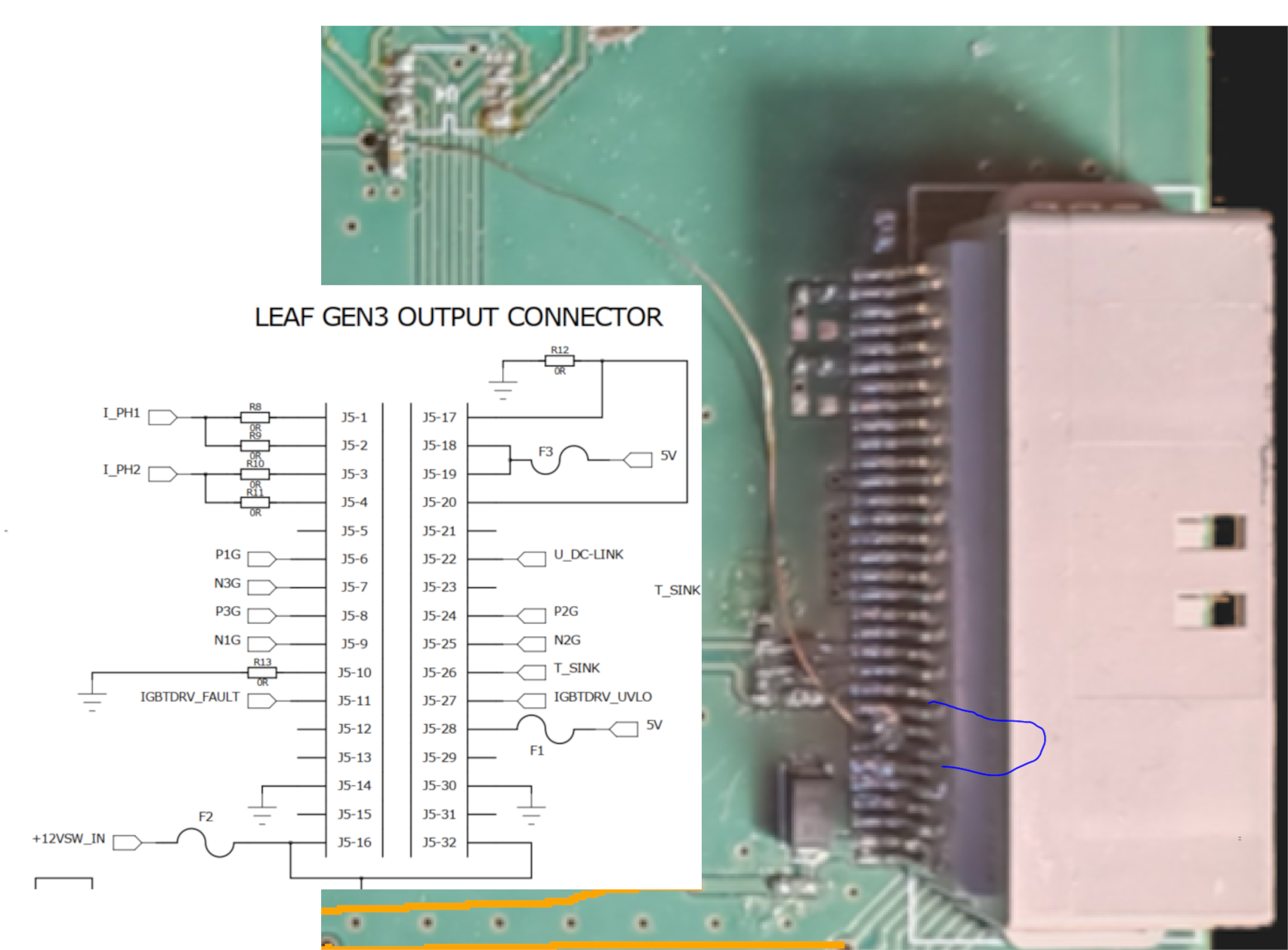

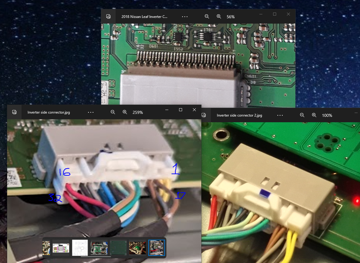

johu wrote: Wed Sep 13, 2023 4:25 pm
I could only figure that you meant the blob of solder on the above.
So 28, 13, 29 get 5v?
Can you confirm that's what you meant in the picture above?

Edit, found a picture of the Nissan controller (credit boekel @ electric car forum) that was clear enough to see pin labeling.
Been thanked: 1918 times
Just tested on mine and it fits perfectly.
Trying to remember why I connected 5V to 3 pins not just the one that Kelju marked out. Reading here: viewtopic.php?t=980
Here's something on the 5V viewtopic.php?p=23161#p23161

johu wrote: Mon Sep 25, 2023 7:22 am Just tested on mine and it fits perfectly.
Thanks for checking the board.
Were you able to check the connector pin spacing?
I went through all of that but did not find anything definitive.
From this image of the 32 pin connector I can see terminals 5, 12, 15, 21 are empty. It looks like positions 31 and 29 are empty as well. From what I'm seeing pin 13 is missing something and also not labeled in Kelju's schematic. Its a grey wire like pin 28, so I think that's 1 missing 5v.
I'll make sure 5v is where it should be on the adapter board, kind of sounds like this may have been an issue from your link / previous digging. Maybe one of the tiny fuses blew during testing?
Thinking of fuses, you want all the fuses on the adapter board removed, (from Kelju's design) correct?

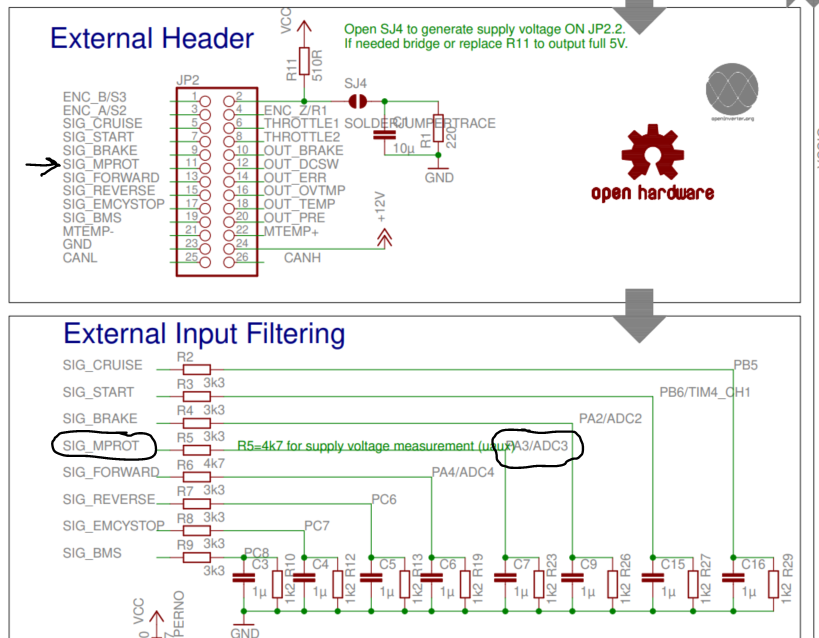

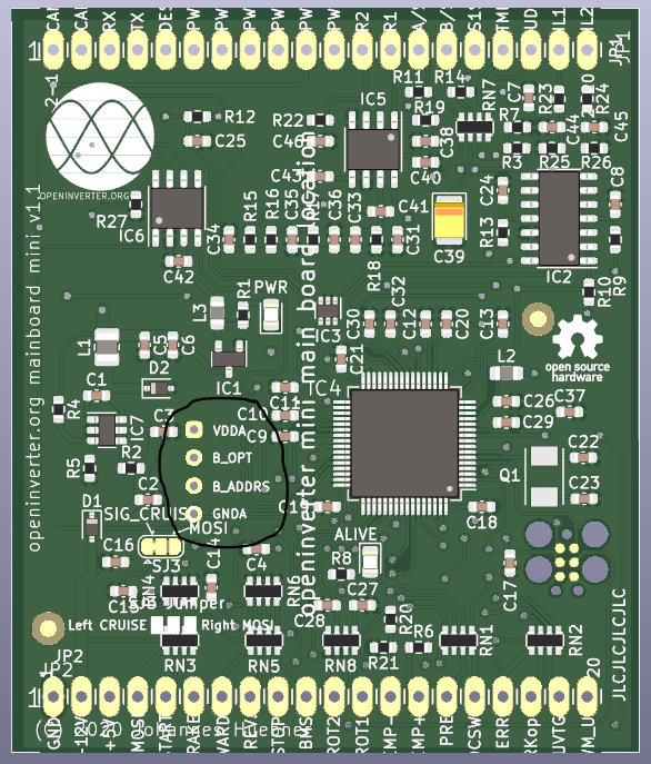

This is confusing me. In the mini mainboard there's this,
PA3 is MPROT but it does not go to either of the 20 pin connectors to get out of the mini mainboard, looks like it was dropped going to the mini.
v3.4 has it,
Does this just need a 12v pullup for the rest of the inverter to run and the mini mainboard ignores MPROT?
Sorry for all the questions. Referencing Kelju's work, mini mainboard, v3.4 mainboard, bmw adapter, and tesla stuff for the ESP32.

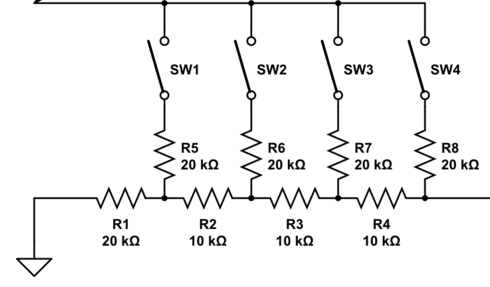

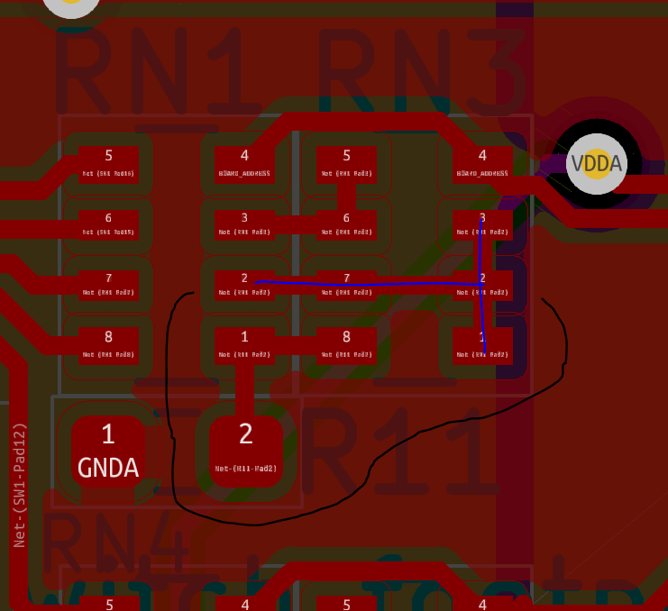

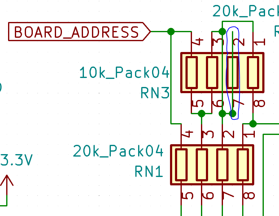

Has anyone considered using something like a R-2R resistor ladder network on the adapter board to set an address (specific voltage) for the adapter board / mainboard settings?

jrbe wrote: Tue Sep 26, 2023 7:44 pm This is confusing me. In the mini mainboard there's this,
Indeed mprot is no longer brought out on the mini mainboard, it is just used locally to measure uaux.
Only emcystop is left as a hardware shutdown pin. You can either pull it high or bring it out on the header with a cuttable solder-jumper that can be opened in case someone wishes to use emcystop.
jrbe wrote: Tue Sep 26, 2023 7:44 pm Has anyone considered using something like a R-2R resistor ladder network on the adapter board to set an address (specific voltage) for the adapter board / mainboard settings?
Yes, thought about, never done ;) So software will just detect it as Rev3 mainboard. That's actually ok for the Nissan board as there is no special handling. But on the upcoming Prius board some special Prius code won't be run because of lack of detection. Would need to devote one pin to that so one functional pin would have to go.
Alternatively a "variant" parameter must be introduced.

johu wrote: Wed Sep 27, 2023 8:07 am Indeed mprot is no longer brought out on the mini mainboard, it is just used locally to measure uaux.
Thanks for the background on that. I'll pull it out as a test point and add a shorted solder jumper.
R-2R network address..
So 2 analog pins with a 4 resistor R-2R network for each should cover it? I'll look for a spot on the mini main board where a connector for this might fit and add an unpopulated footprint for it on this adapter board.
I found this looking up what others are doing for pre and main contactors. Seems some are struggling with an early, unintended pulse. Is this still an issue?
A few snips from viewtopic.php?p=41435&hilit=Economizer#p41435
Hm... i think you could put one pullup resistor on each relay channel that would keep it off untill high enough signal would appear. Try experimenting with resistor values. I bet 1k pullup will do the job.
E46Driver wrote: Wed Jun 22, 2022 4:10 pm I tried 10K and 5K. Never went as low as 1K.
johu wrote: Sat Jun 18, 2022 9:36 am Do you have the newer Leaf board with Mini mainboard? Then you could add some significant capacity between gate and source of the corresponding mosfet. On the V3 mainboard version you could do the same modification as DC switch is also on a mosfet. Not sure about the value, maybe 10uF
I currently have a 10k pull down on the contactor mosfet gates. Mosfets are 1-2V vgs(th) range. Mosfet I currently have is a LCSC C3017, Infineon IRLR3410TRPBF. I couldn't see / find the mosfet # on the i3 board.
I added clearanced handsolder footprints for gate pull down & capacitor for each. I'll plan for around a .5 to 1 second delay range. I'll do the math and populate them and correct the 10k pull downs if necessary.

2nd post for where I am with this.
Adapter board so far:
I chose to go 4 layer because of how tight this is and the original design reference images. Bottom layer is connected to the 4 mounting holes along with the plane ring around the outside on top like the Nissan board. Inductor footprints around the outside, will set them to dnp. Should make for a nice shield.
I did mostly 0805 sized components so they can be swapped if necessary. Also this still has some 0R resistors where they were in the original. Can drop these once we know things are working / connected correctly. Some unknowns still there.
Added solder jumper CAN resistors on the adapter board. 60ohm - 4.7uF to gnd - 60ohm with a solder jumper for each resistor to can lines. If this is the can end point it should help people use CAN correctly, easily, & filter some noise which will hopefully reduce struggles across the disciplines & forum support. Footprint for a can TVS right next to Nissan connector too.
I drew up the Nissan connectors but the dxf / footprint looks off from the first attempt board. I copied the same sketch / dxf, not sure how it happened or if it's an issue yet.
I also extended the pads to help with hand soldering.
I have the 2x05 old WiFi / comm header in currently. Not sure of use cases people might have for it. Planned to just leave this unpopulated.
I set the ESP32 boot delay R & C to the commonly recommended 10k resistor & 1uF. Not sure how / why 4k7 / .1uF was chosen but can easily switch back.
Also added the 499R inline to esp32 TX line from the datasheet "to filter 80mhz harmonics".
Broke out unused pins on a 2x05 footprint with labels.
I added notes in the schematic on what pin names were to help cross reference the mini main board and Kelju's schematic.
Added short traces with vias off the unterminated Nissan connector pins if we need to connect something along with a 4 pin header top right.
I have some cleanup to do before asking for others to check it. I'll hopefully post it in the next few days.
If anything jumps out to anyone please feel free to pick it apart with some ideas how to fix it.
I think I'm moving the contactor fets to the top right and moving stuff up top to the left to make room.

I would love for someone or a few people to look this over, done in KiCad 6. I think I'm done besides cleaning up part numbers, checking the dip switch footprint, rotations, gerbers, etc. I feel like I can't see straight at this point.
I added an 8 pos. dip switch. Could potentially have all 8 on one analog pin but it starts to get tight. Need to discuss implementing this, if its on the mini mainboard or adapter boards, and implementing it elsewhere if it makes sense to keep it. Thinking is the dip switch can go away once addressing is defined, or half could go away to leave 4 option settings if it helps, or switch to solder jumpers.
To make the R-2R thing work with JLC inventory its 3 components instead of the 1 R-2R for 4 positions, so 6 components + dip switch, 2 analog pins. There's an unused position on one of the resistor arrays, I shorted across the resistor to make routing cleaner and easier, I know this will likely throw anyone looking for a loop. Blue circle and blue T shape. Schematic is ugly because its all squished on one page.
There's a separate 20k resistor (R11) like R1 below. Doing this,
The connector pokes through in a decent spot on the i3,
mini mainboard,
and this Gen 3 leaf board.
Definitely need to verify the 32 & 40 pos. Nissan connector footprints too.
Please critique, ask why did you... poke fun, whatever. A bunch of other info in the few previous posts too.

The adapter board is looking good.
I'm not a large fan of electro-mechanical elements in "challenging" environments (so dip switches or trimmers).
One last attempt to make this backwards-compatible and omit the extra pins. Maybe first we should clarify the goal - we want the software to be able to detect which adapter board it is running on, right?
So you could just connect a high-impedance voltage divider to brake_out that SW could read at startup and then switches the pin to output. The brake light will be too slow to actually light up, should the coded voltage be above FET threshold.
So you could have 47k pull-up to 3V3 or 5V if more convenient and variable pull-down for each adapter board variant forming a voltage divider. The lowest one would be 2k7 to not interfere with the 220R series resistor.
So there could be these steps (assuming 5V pull-up)
2k7 - 0.27V - 337 ADC digits
3k3 - 407 digits
4k7 - 564 digits
6k8 - 783 digits
8k2 - 912 digits
10k - 1088 digits
and so on up to 82k. I think this should allow for enough variants and have sufficient distance between the codes to not mis-detect.

johu wrote: Sun Oct 01, 2023 6:42 am The adapter board is looking good.
I was thinking this first batch would be a prototype and the dip switches would make testing code convenient. My replies are very wordy though. I understand your hesitation here for production.
