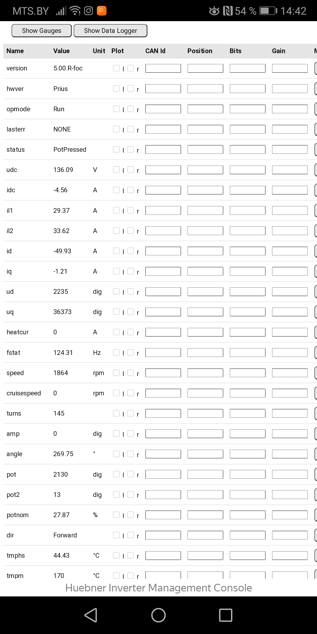

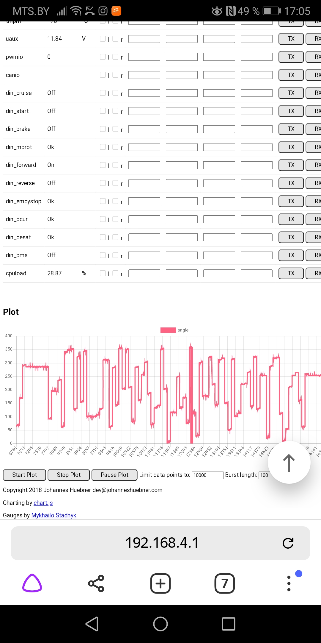

One problem has become less, the motor spun in both directions. The reason for the lack of rotation was the resolver, or rather the cos sensor. Now I cannot spin the engine, when I press on the throttle, it starts very sluggishly and then rests and does not react to gas, so in both directions. I changed many parameters and didn't get a good result. Who can help with advice?
These are spot values ​​exactly when RPM is not added and there is no throttle response.

Guys, I found the reason for my unsuccessful attempts to adjust the motor, the resolver was faulty.
