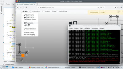

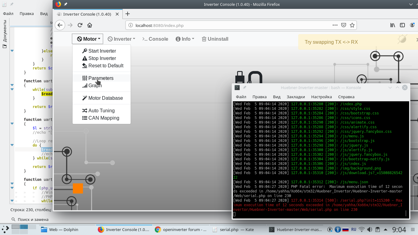

Hello! I don’t know if I am writing, but I have a similar problem. I have a 2nd version board, the bootloader and the main program are flashed. The green LED blinks pleasantly, the board communicates via Wi-Fi - but the truth is that the ping comes as if from Mars))) but nonetheless, the controller configuration is visible. But there is no connection with the USB-TTL board. / dev / ttyUSB0 is enabled, the user is in the dialout group, the minicom utility has configured the port speed of 115200 8n2. when you click the reset button in minicom, the 2D response comes. The json command sent sends the configuration. when you click the reset button in minicom, the 2D response comes. The json command sent sends the configuration. In the browser - nothing is displayed.
P.S I understand that the problem is in setting up the PC? And sorry for Google translator)))

Cannot just run it from a web server, you need to run "preparation script" -> "Huebner Inverter.sh" it will place proper ttyUSB into /Web/js/serial.json. It uses "php -S" command as a webserver on port 8080. The web interface will be http://127.0.0.1:8080

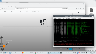

dima wrote: Tue Feb 04, 2020 4:42 pm Cannot just run it from a web server, you need to run "preparation script" -> "Huebner Inverter.sh" it will place proper ttyUSB into /Web/js/serial.json. It uses "php -S" command as a webserver on port 8080. The web interface will be http://127.0.0.1:8080
At the same time, minicom prints data exchange commands in the console
this happens through a call by the command: Huebner Inverter.sh

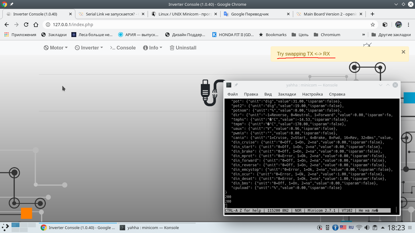

Do not run minicom and web interface at the same time.

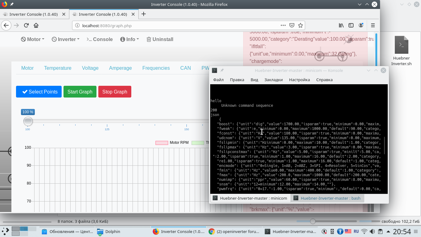

I used the minicom utility only for observing the comport to eliminate its malfunction. But the fact is that without it in the browser, the data of the microcontroller does not display.

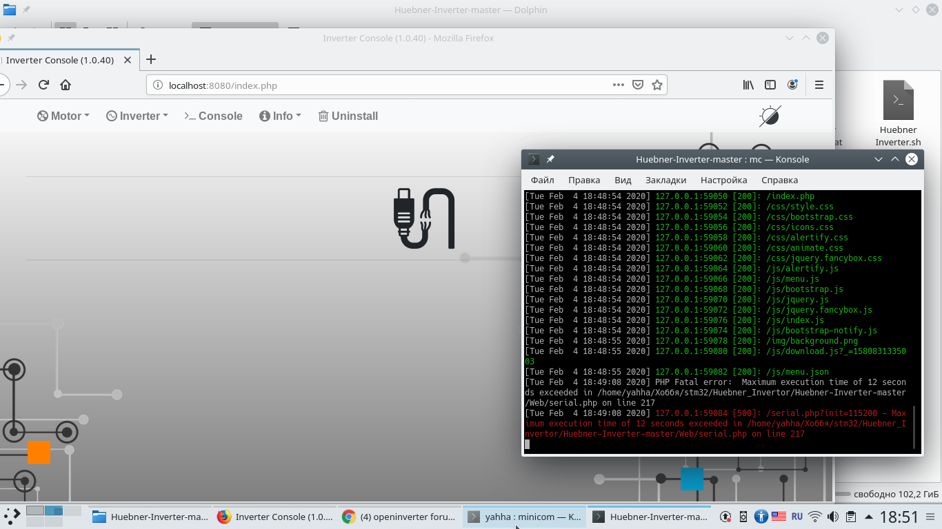

shell launch and attempt to call the controller config

It is a permission issue, try with sudo or this command before you run
sudo stty -F /dev/ttyUSB0 115200 -parenb cs8 cstopb
No time to work on Linux, tested with Windows and Mac. Feel free to fix it.
EDIT: Linux Fixed
