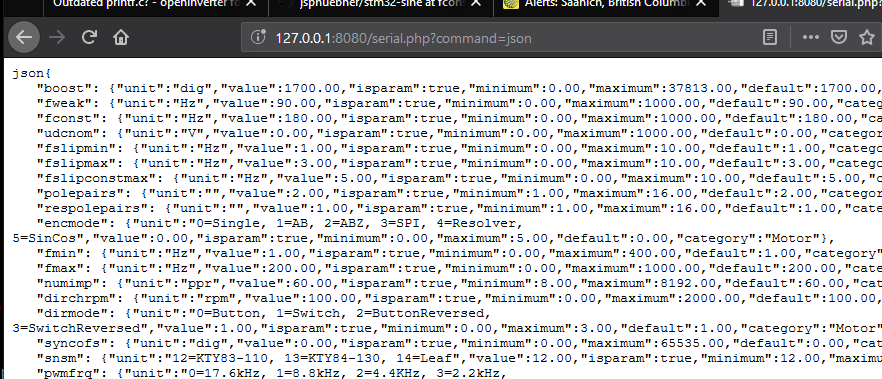

I noticed something strange after building stm32-test code. When built with "custom" printf.c Johannes provided the UART all of a sudden became "choppy" like it would split the line and send parts.
This causes problems with Mac particularly with PHP.
$uart = fopen($com, "r+");
fgets($uart);
If fgets does not receive full line it is difficult to know when it ends ...at least in Mac there is no wait until available ...the serial just freezes.
Why are we using outdated method for "printf" if libopencm3 has a simple solution https://github.com/libopencm3/libopencm ... art_printf
After trying libopencm3 example all is good. No freezing with Mac. fgets receives complete line.
I suspect same this is the same issue I've been having with main firmware as well. :?

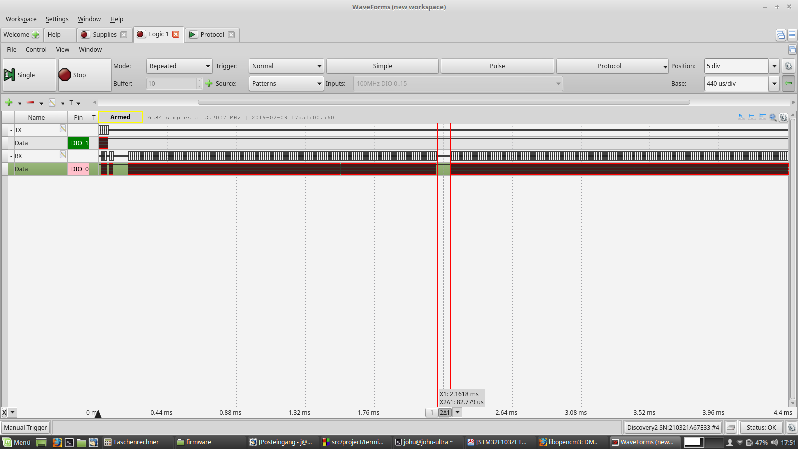

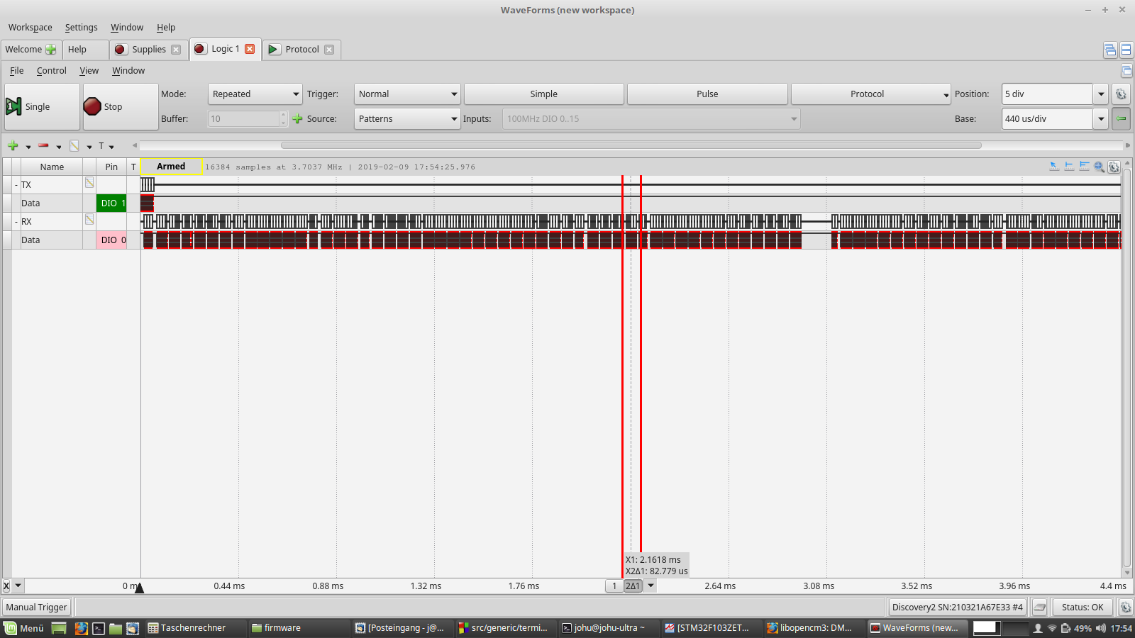

Now I tested double buffered DMA writes. Basically a buffer is filled up until a "\n" is hit or the buffer is full. Then it is dispatched to DMA for sending. Meanwhile the application can fill up the other buffer.
It makes sending more continuous as you can see on a screen shot which seems to help Dimas frontend on the MAC (see above). If breaks to occur, they will be at the end of line. It also speeds up total transfer time. I didn't look into it closely, I guess it's between 30-50% faster on a system loaded with 17.6kHz PWM.
It will not work on REV1 hardware.
I put it on an extra branch (fconst_dmatx), since the commit also contains another sort of breaking change.
https://github.com/jsphuebner/stm32-sin ... onst_dmatx
Dima, can you test if that improves things?
EDIT: now tested performance. Command "stream 20 cpuload". Takes 2.5ms w/o DMA, 1.8ms w/ DMA. So 28% faster.

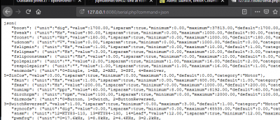

Tested, works ... feels faster :)
Web interface issues, echo comes in with data on first line. I normally expect first line as echo, rest is data. Can you keep /n after echo?
Been thanked: 1913 times
Re: Outdated printf.c?
Oh totally missed your reply!
Yes I just ran into the same problem. I thought the delay between command and reply was too long but actually is the missing echo. Thanks!
Re: Outdated printf.c?  [SOLVED]
I've made the change in the fconst_dmatx branch
