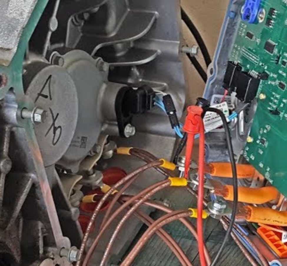

What makes you think that the encoder isn't of a high resolution enough?
It's quadruple.
How many PPR does it has?
It's quadruple.

It has 36 teeth. That means 144 increments per revolution, or 72 per sine wave period. This is enough to keep the output in sync, but only to an accuracy of about 1Hz (assuming 10ms period of calculation).EV_Builder wrote: ↑Sun Apr 17, 2022 12:21 pm What makes you think that the encoder isn't of a high resolution enough?
It's quadruple.
PS. this really only matters if you are trying to use the frequency to set the voltage as I am.

This picture gives me the idea that the encoder is driven with a ratio in relation to the motor?
