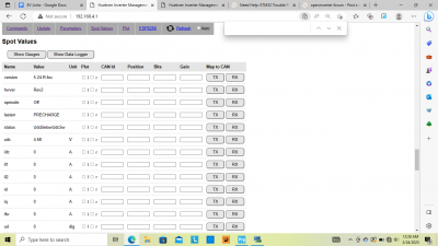

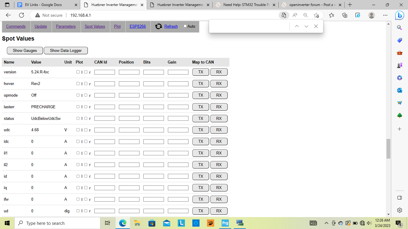

I tried accessing the web interface again with he the fixed flash size code on the board, and I must have made a mistake last time because now it is working! There are bunch of (I believe default) parameters, and the spot values, showing version "5.24.R-foc"

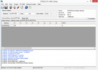

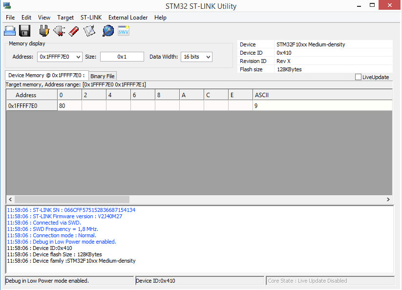

I suppose the next question is where would you like to go from here? In terms of what you have there I can see two possibilities:
1) The chips are very early silicon that doesn't return the correct flash size. It seems ST did release a batch in the very early days that did this and it's possible that someone had a batch that was put back on the market when the chip shortage hit.
2) The chip is not a genuine STM one, if so it is one of the better ones I've seen device marking wise.
Either seem equally likely. The recent chip shortage is the worst I've ever seen which has made sourcing parts almost impossible.

Ember wrote: Thu Mar 23, 2023 9:21 pm When I read the flash size register for both chips with your instructions, it did come back as 0xFF!
Sorry, forgot to check, did it return 0xff or 0xffff (when reading in 16-bit mode)?
Also forgot to check your readback file, just had a look now. MG2 is fine but there is a section in MG1 that doesn't look quite right (memory address 0x0801E514 to 0x0801E797), it's all 0x00 when it should be 0xff. Might be worth doing a full chip erase, reprogramming my full readback image and then checking the chip contents against my file. You can either compare it yourself (if using stm32Cube there is an option on the memory viewer command dropdown to compare with file) or read it back out again, post it and I'll check it. My guess is that the chip hadn't had a full chip erase before you programmed it the first time.

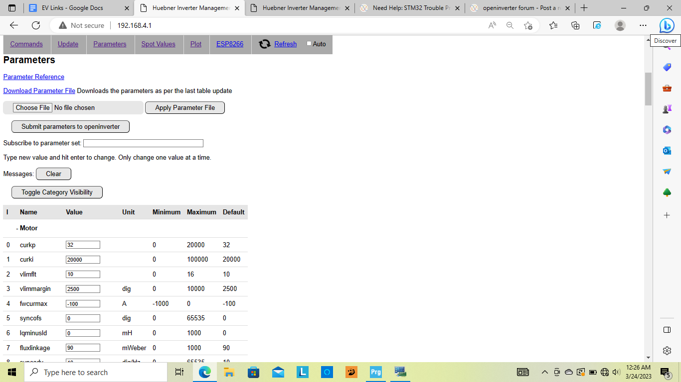

Now you have the web page working it would also be worth checking that the parameters are correctly being saved to flash. Just change one, save parameters to flash, power cycle everything and then check when you power it back up the new value is still there.
