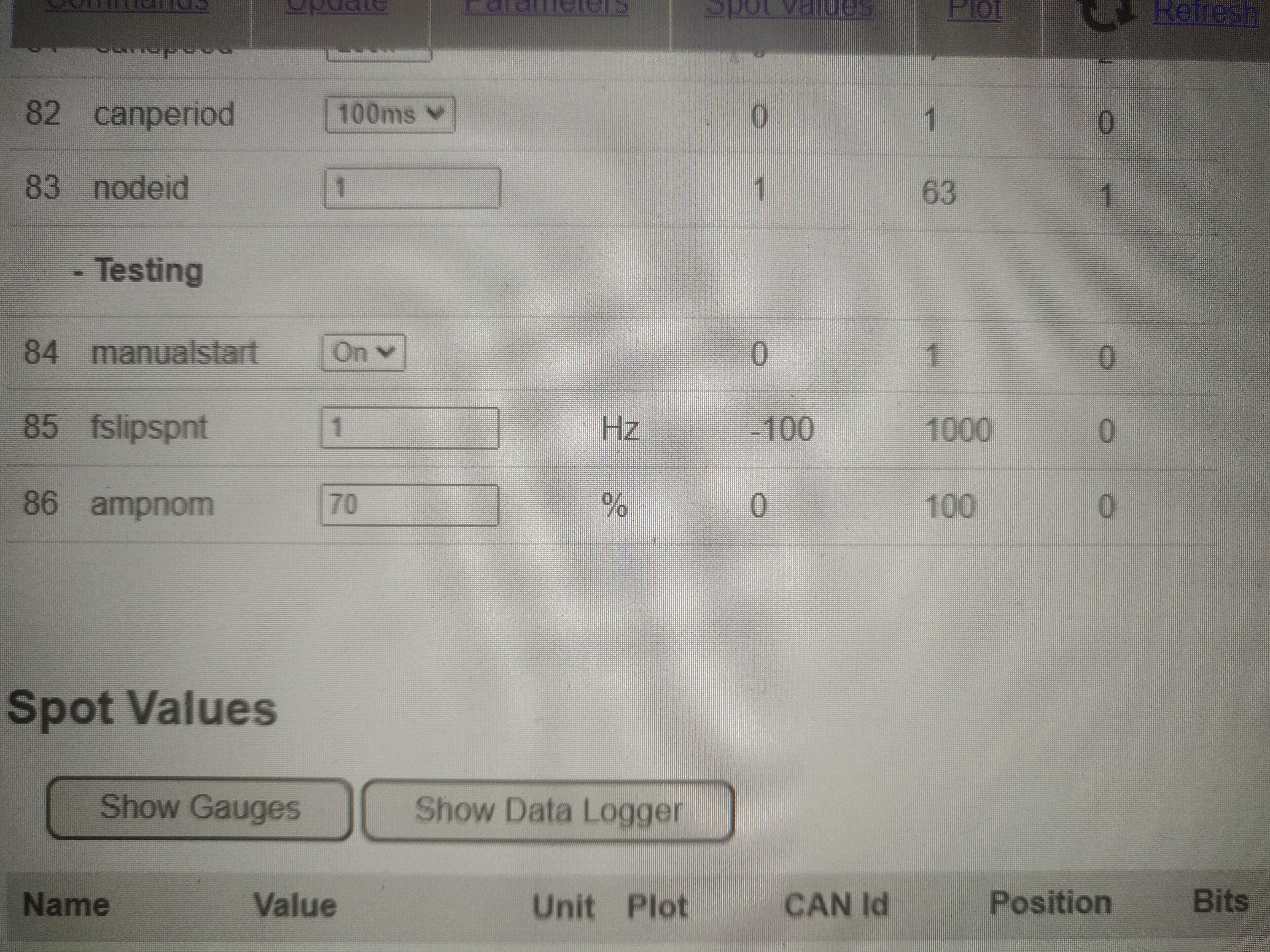

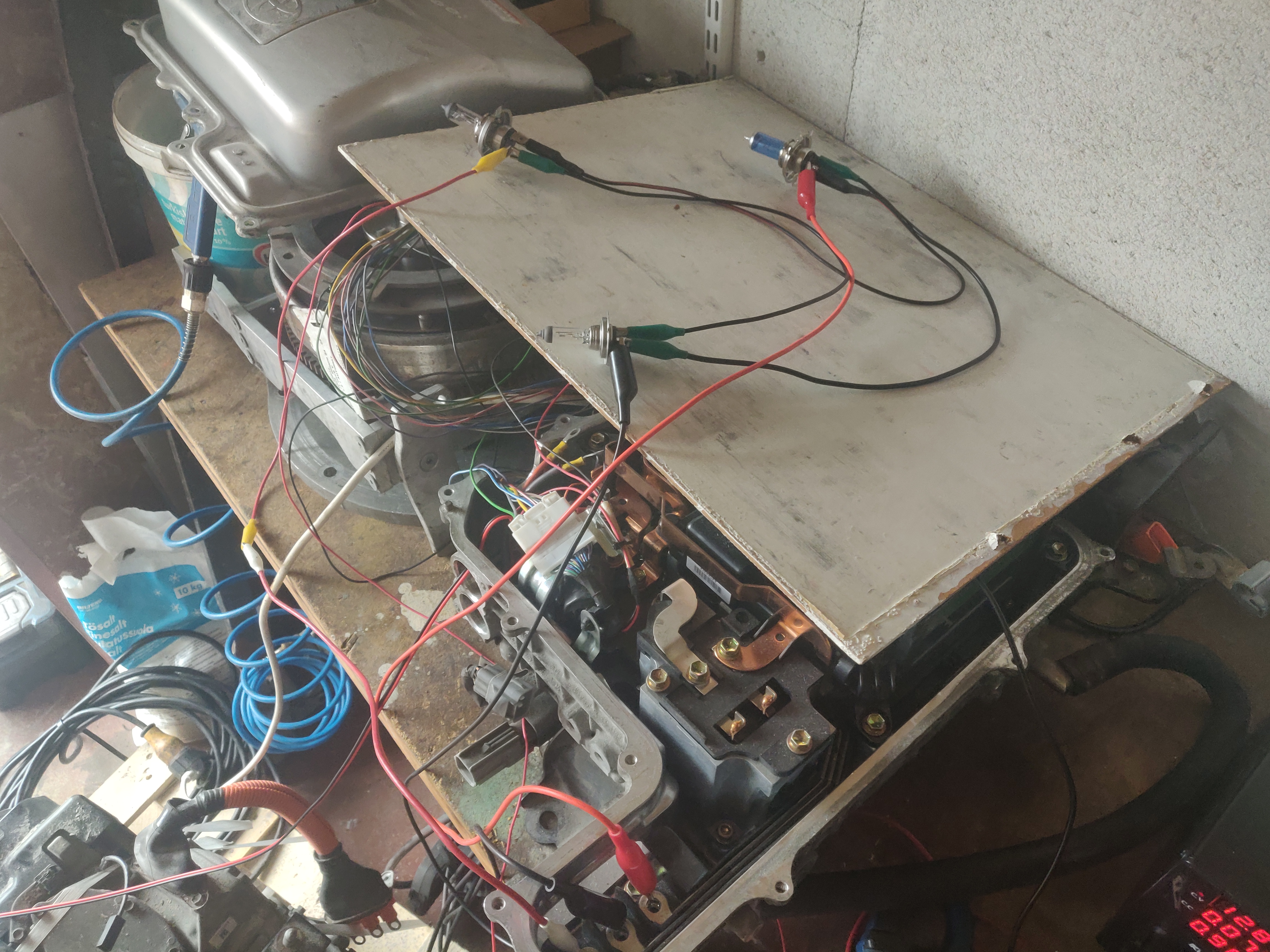

Hi, I have purchased the Toyota Prius™ Gen2 inverter controller:
https://openinverter.org/shop/index.php ... duct_id=63
I have Prius Gen 2 inverter and Gen 2 transaxle/gearbox.
I am now in the process of getting my first spin.
In this guide:
https://openinverter.org/wiki/Toyota_Pr ... Controller
It says:
"Step 9 : Web Interface Basic parameters ( stm32_sine. bin) set up - to confirm PWM outputs : Full boost (curki= 20000 min) with 12v supply, default forward, ampnom @ 70%, and fslipspnt @1 Hz. Select - "Start Inverter in Manual Mode" Confirm flashing lights."
My problem is that I don't have ampnom or fslipspnt parameters. Under "Testing" I have manualiq and manualid. All the guides I find talk about ampnom and fslipspnt. I am not sure what to do.
Under version it says "version 5.14.R-foc".
This is all new stuff for me, challenging to understand everything, but I am doing my best.
I have connected all the wires 19-27 on the open inverter ECU.
https://openinverter.org/wiki/images/a/ ... 2_v1.1.png
How can I get a test spin on my setup?

I uploaded a new parameter file from here:
https://github.com/jsphuebner/stm32-sine/releases
So right now I have version 5.27.R-sine and now I have the fslipspnt and ampnom parameters, but still nothing happens when I put in values there.
Must I change more parameters or connect more wires to get my motor spinning?

Do you have the 55watt light bulbs set up and getting any signal when they are in the delta connection setup as per the wiki link?

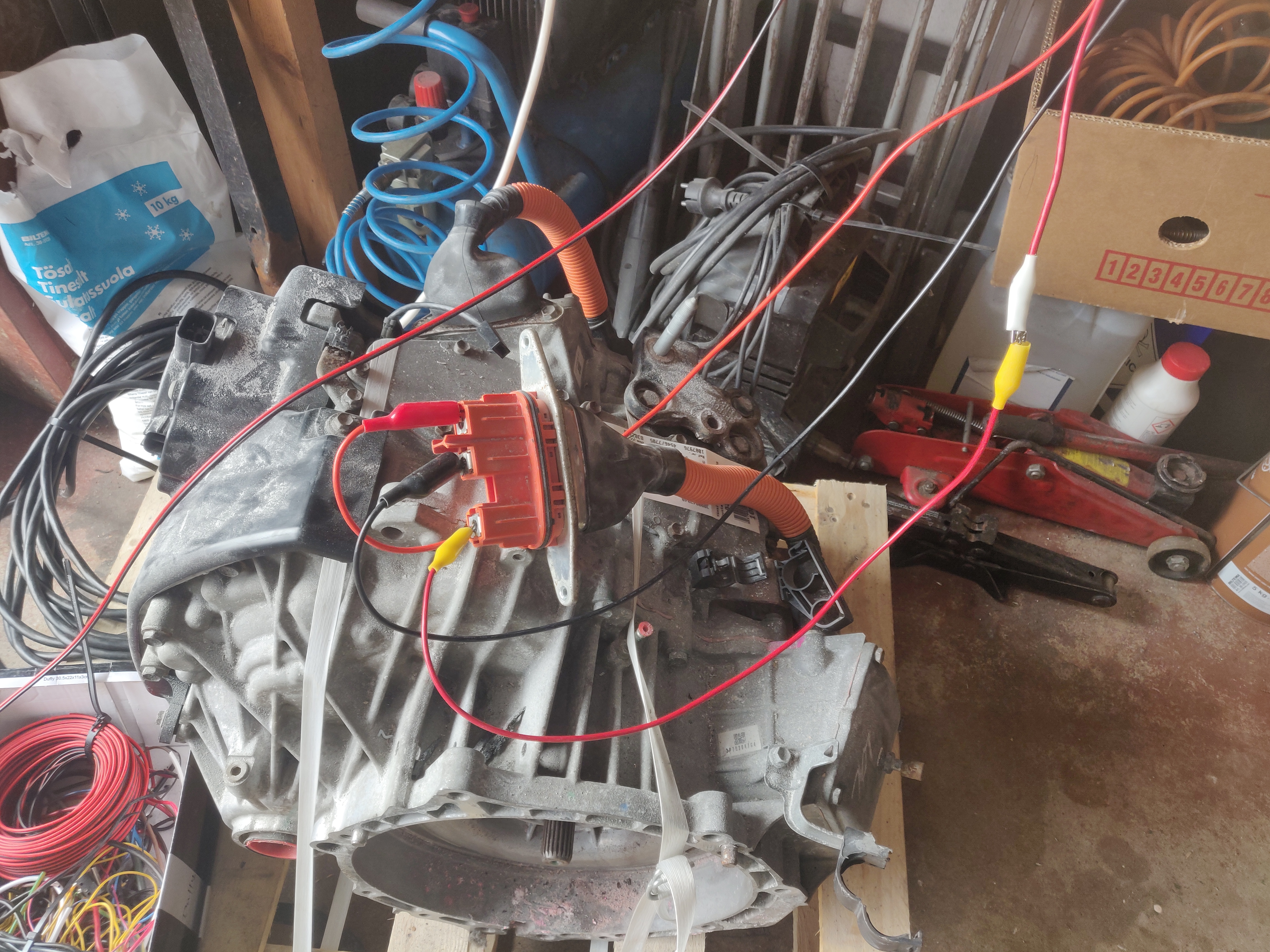

Re: Prius Gen 2 inverter with Gen 2 transaxle no test spin
Post by Bagheera »

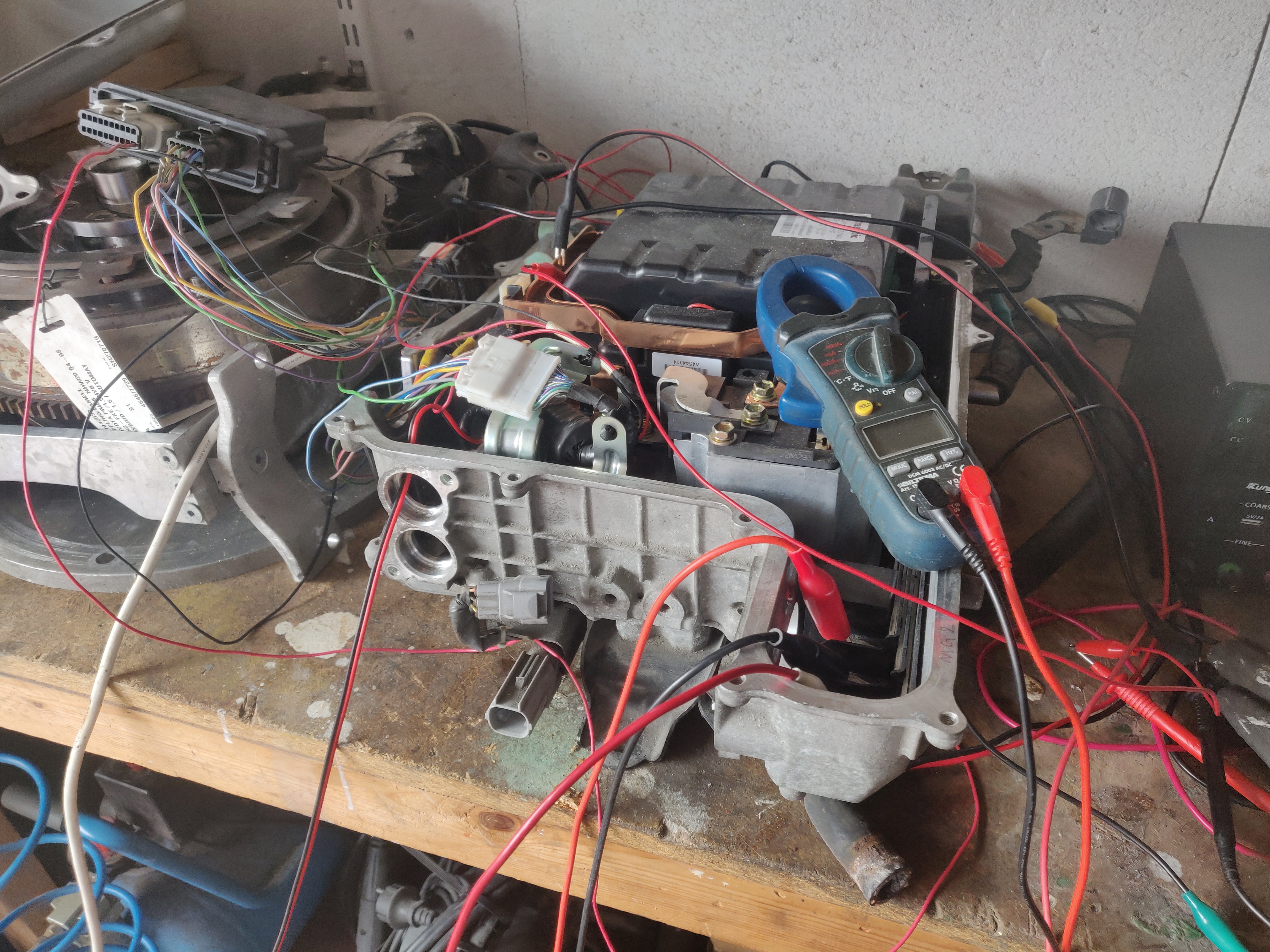

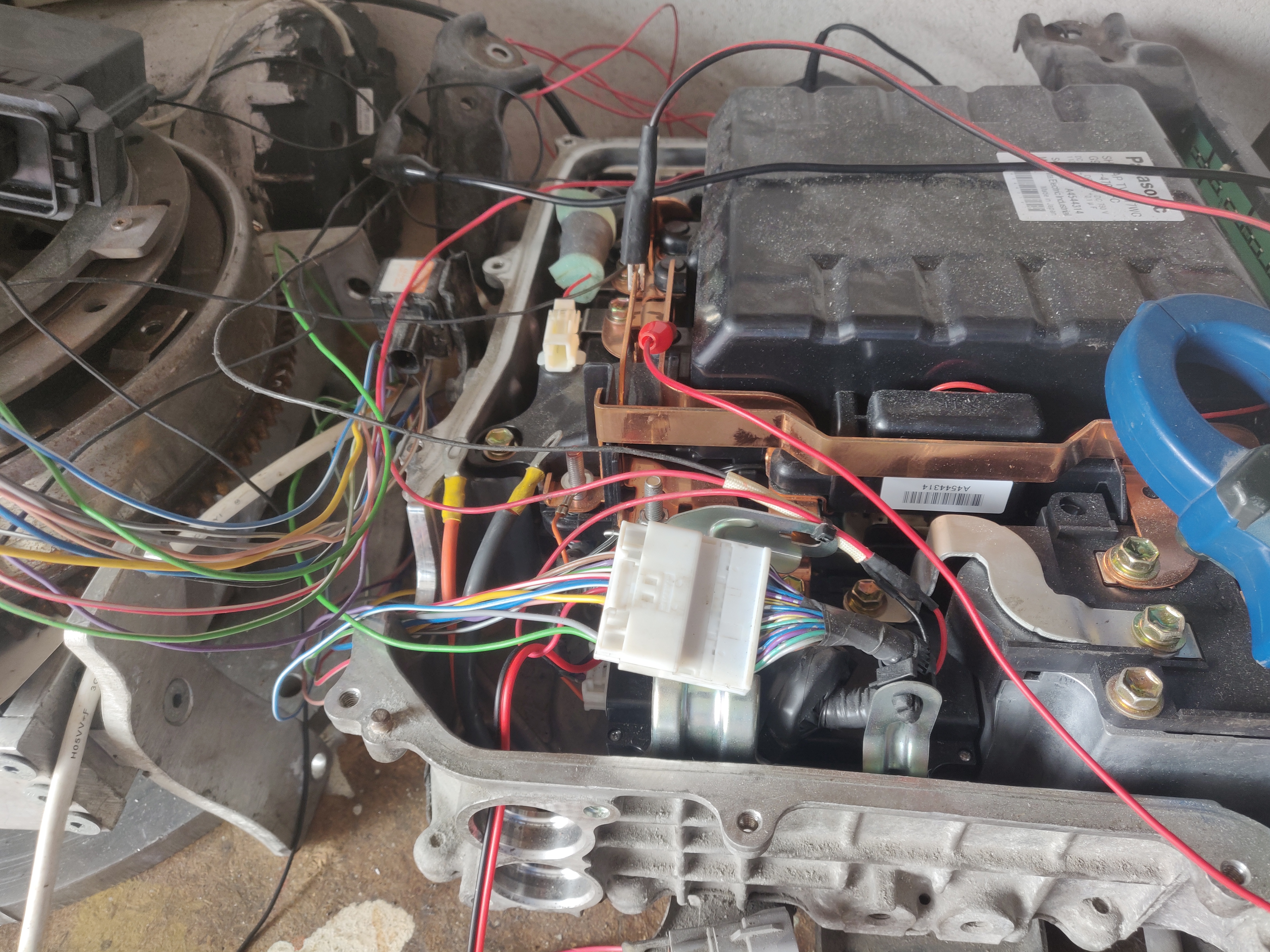

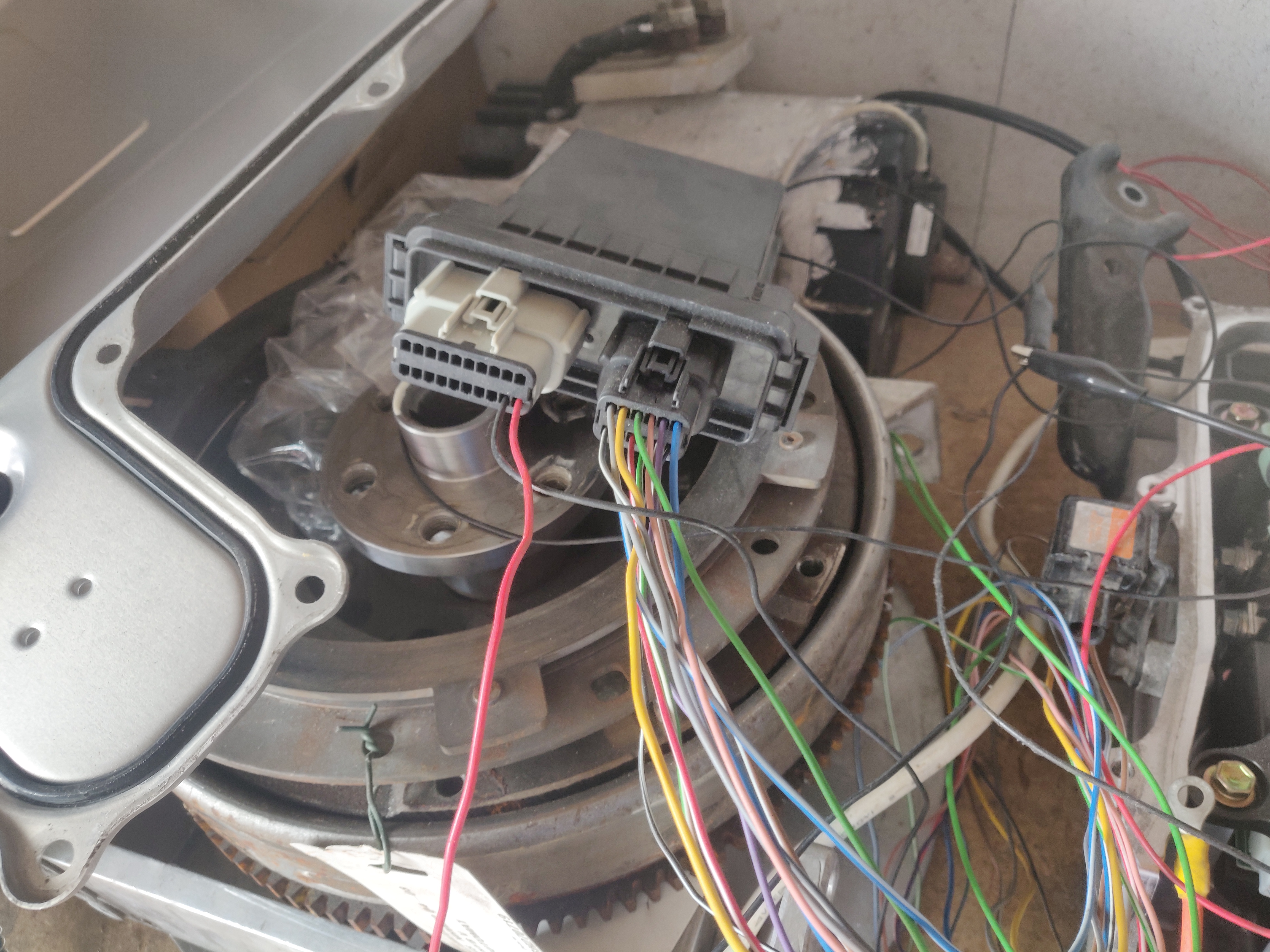

I tried with the MG1 motor, didn't get any voltage to the MG2 output. Here are some pictures of my setup, 3 lead acid batteries in series with a 230v lightbulb that never lights up, but I could read 36v at the rails, slowly declining when batteries are disconnect so I would guess that capacitors was charged.
Forgot to mention that I did put something in the safety thing for the lid, so it's not that.

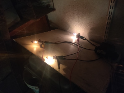

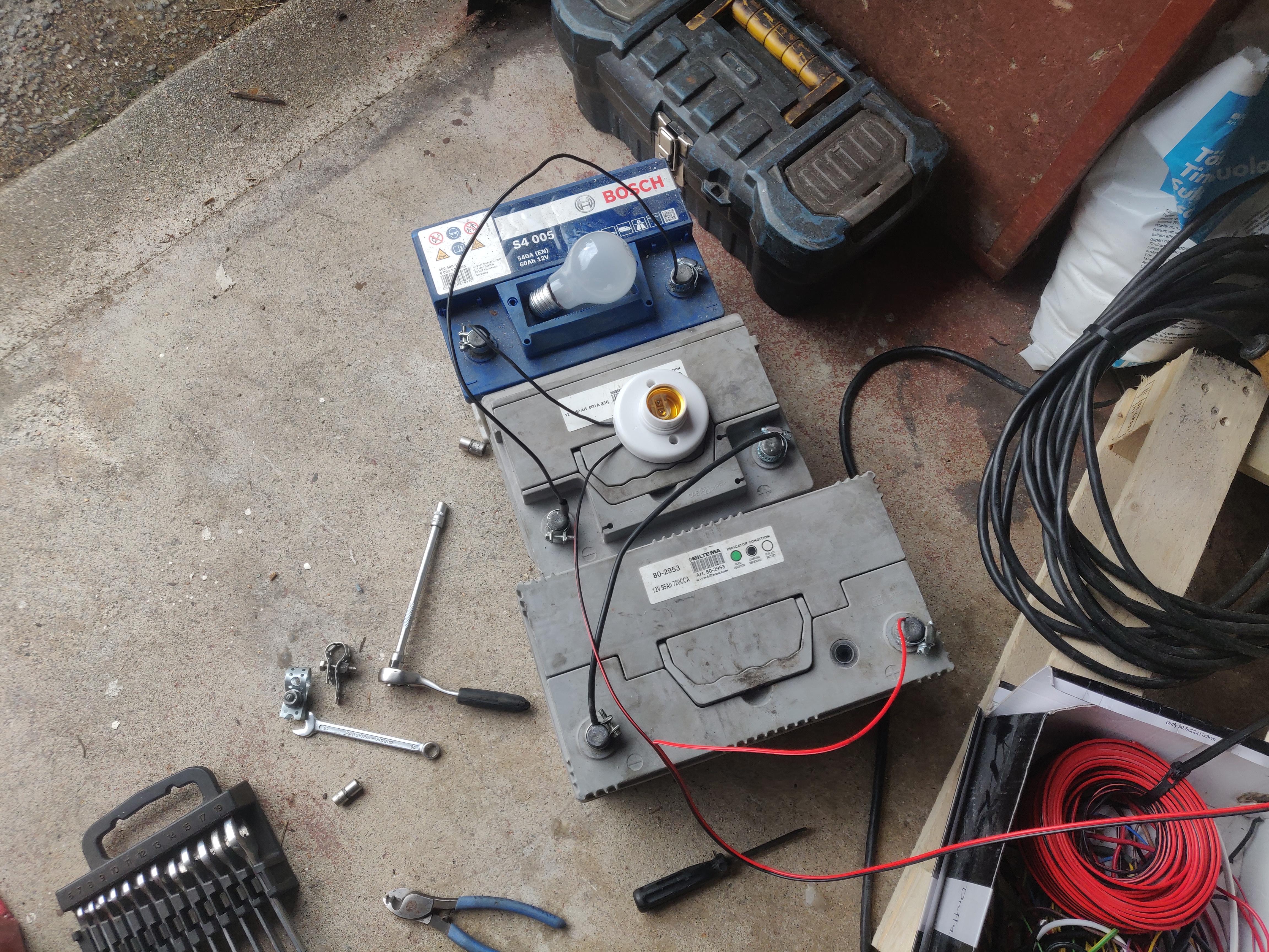

Bagheera
Posts: 14
Joined: Sun Jun 05, 2022 7:14 am
Location: Sweden 🇸🇪
Post by Bagheera »
I have the lightbulbs in delta configuration and started the inverter but I have no light. There is only one 12v battery as HV now.
12.6V at the rails in the inverter.
RetroZero
Posts: 947
Location: France
Has thanked: 643 times
Been thanked: 64 times
Post by RetroZero »
I think manualstart needs to be ON

I don't think I can strip my setup down anymore I already have.
I have lightbulbs as the "motor" in delta configuration, tried with motor before but no difference. Also a 240v lightbulb from 12v HW in series with inverter.
I have tried several times measuring the voltage from the output of MG2 with a multimeter, but it's always 0.
I double-checked all my wires from the PCB to the inverter, they are all correct. All pins going to inverter has a cable, pins looks fine, they are in the correct place according to the wiki.
My inverter seems dead, the only life sign I have ever seen from it is that the capacitors takes a charge, if I plug in the 12v HW without a lamp in series I do get sparks.
The only thing I have done to the inverter is to remove the cover, connect my connectors and the HW cables. There are loose wires in it that the scrapyard unplugged. Those seem to be to unrelated stuff anyway, like the dc-dc & ac compressor.
I can't see any signs of damage or brunt components. There was nothing stated by the scrapyard about the inverter being in bad condition or not working.

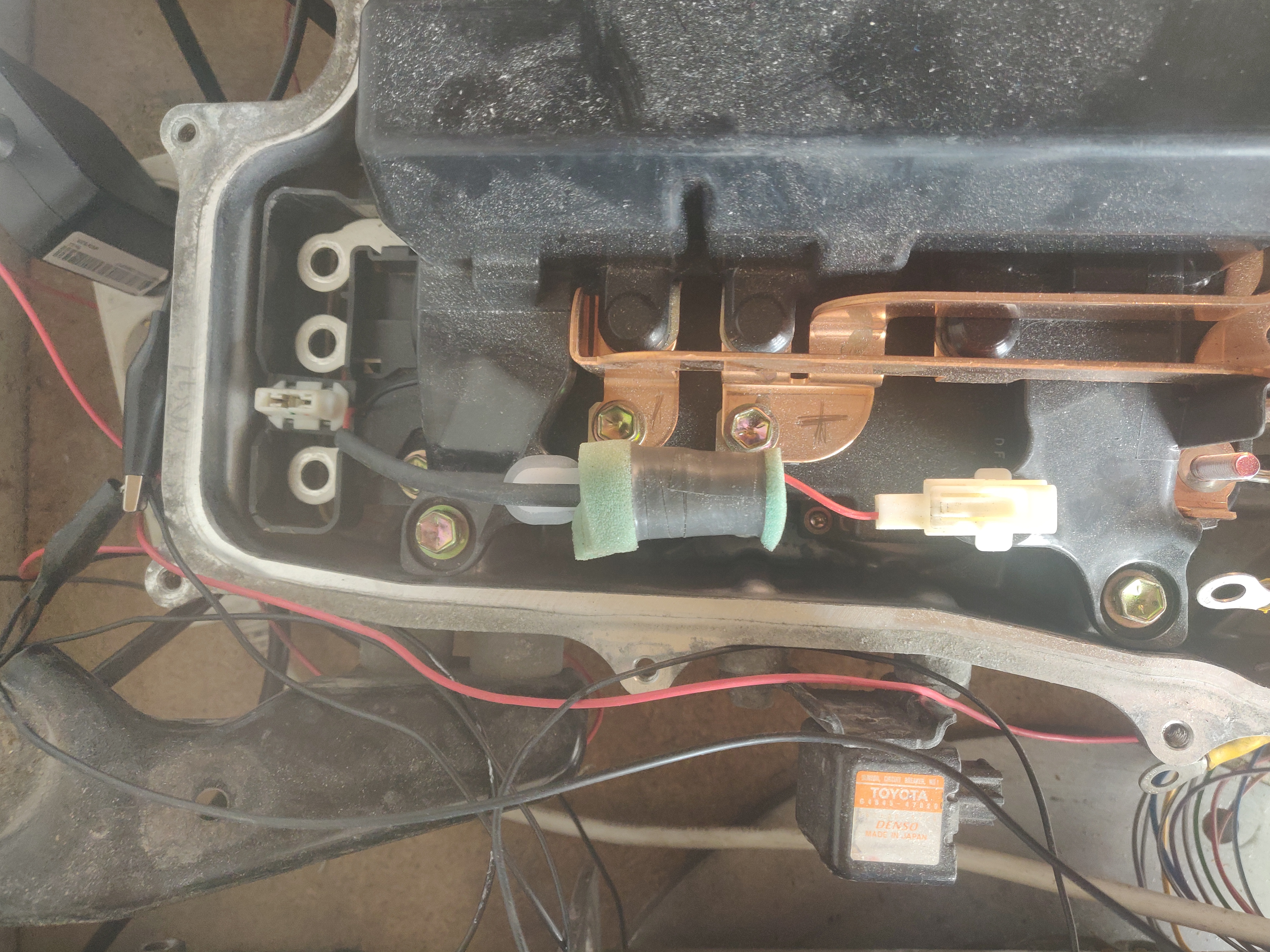

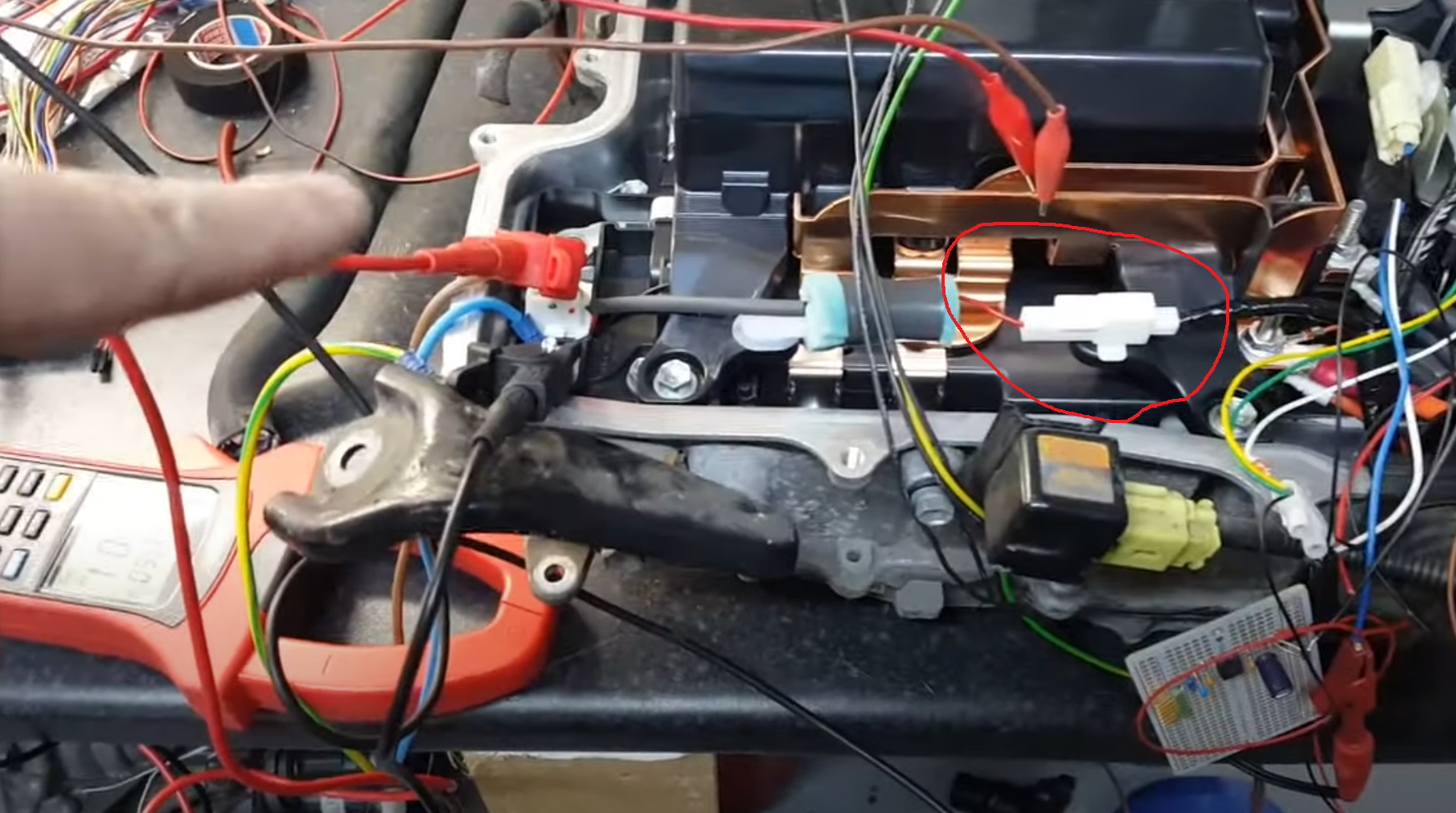

Bagheera
Posts: 14
Location: Sweden 🇸🇪
Post by Bagheera »
After writing my last post, it does sound like the lid switch is the issue. I took a closer look at it. 2 cables goes from it, red and black, and the red one goes to a connector that is not connected to anything. The first picture is a screenshot from a video from Damien Maguire, the second picture is my inverter. Should this red wire have + LW or + HW? I would guess LW (12v) but I am not sure, the black cable goes down and is hard to follow without taking stuff apart.

Been thanked: 1914 times
The lid switch is optional. When the lid is closed it just connects the case GND to the red wire. So if you expect to get GND from the red wire, two preconditions must be met: case grounded and lid switch closed.
Normally while bench testing you don't run anything via this red wire.
Bagheera
Posts: 14
Location: Sweden 🇸🇪
Post by Bagheera »
johu wrote: Wed Aug 09, 2023 8:49 am can you download http://192.168.4.1/cmd?cmd=json and upload here as a text file? All that while attempting to light up the bulbs.
I'm assuming you have MSDN (pin 25, for MG2) or GSDN (pin 20, for MG1) connected to 12V? What's the current draw of the idle inverter on the 2-pole power inlet next to the 32 pole control inlet?
MSDN (pin 25, for MG2) is connected to 12 LW
The 2-pole power inlet next to the 32 pole control inlet is taking 0-0.01A
With inverter running and ampnom @ 70%, and fslipspnt @1 Hz. Now I am ignoring the lid switch if doesn't matter.

Good news, everyone, I have spin!
Minimum settings needed for spin or lights from default (version 5.27.R-sine) are the following:
0 boost 20000
15 dirmode DefaultForward
85 fslipspnt 1
86 ampnom 70
There was an issue with low voltage (12v) supply to the inverter for me, when I fixed it the power draw went up to 1,2A for the inverter and Openinverter PCB together.
But still the lights wouldn't light up, once I changed dirmode to DefaultForward I could hear noise from the inverter, first real life sign it has made for me, then I knew I was getting close. The "high voltage" (12v feed) was 1v at the rails, so I put a 5A fuse in parallel with the 230v lightbulb, then I got lights blinking.
When it tried the MG1 motor the 5A fuse blew, but with a 25A fuse everything worked great, had to increase the fslipspnt to 10 to get smooth rotation of MG1, MG2 doesn't want to rotate because of the parking break I would guess.
Thanks for the input from everyone who posted on my thread, it would have been even harder without help.
I hope this helps someone else trying to get their first spin.
