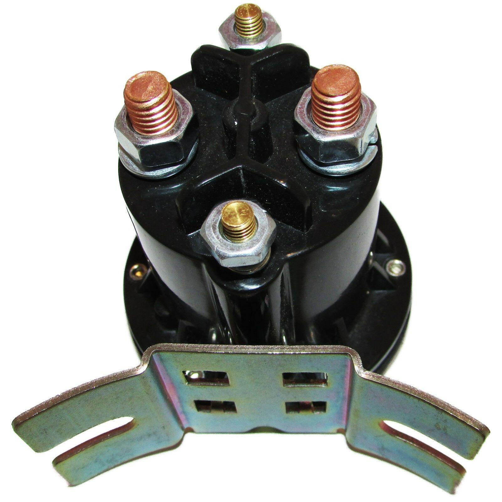

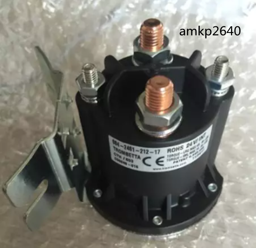

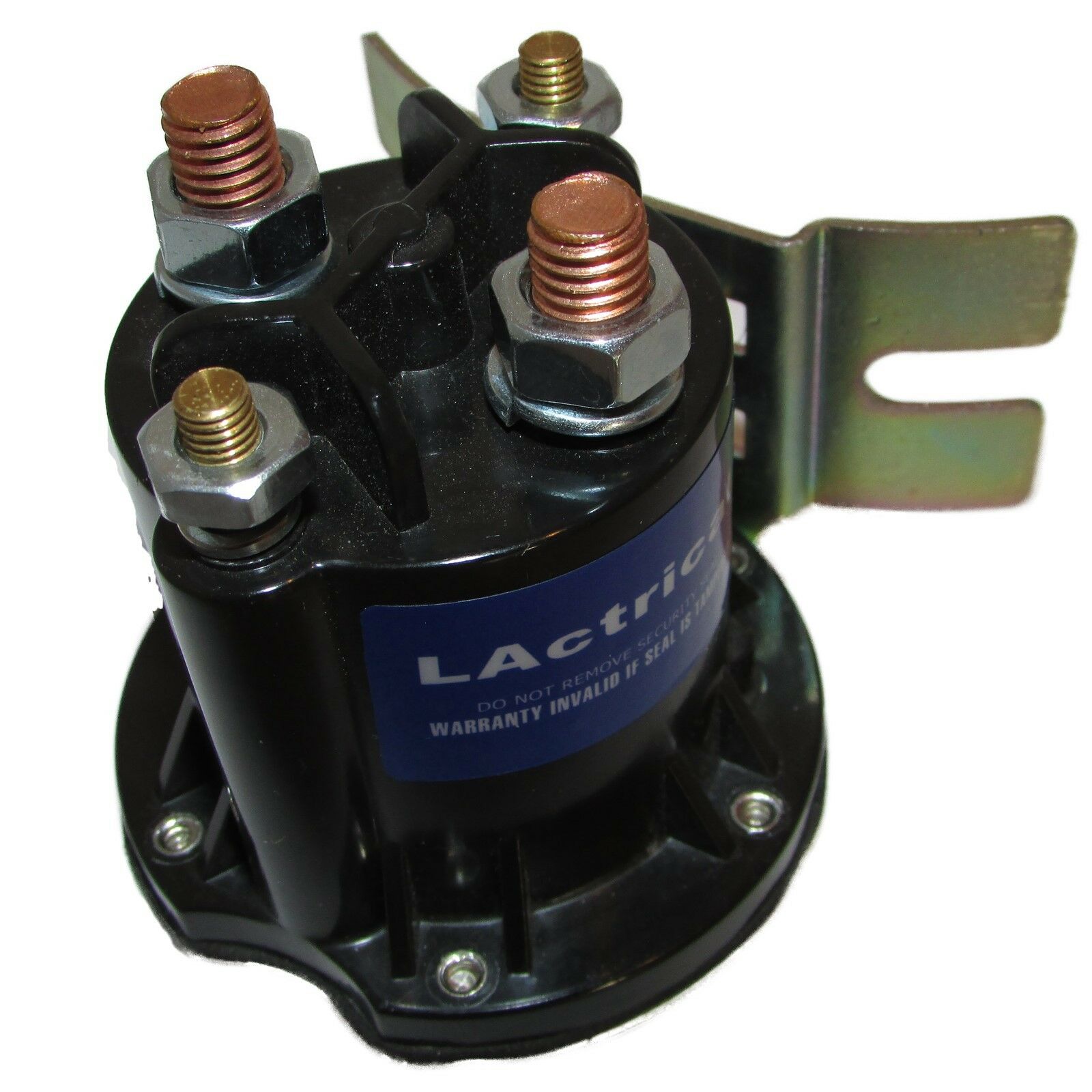

newb question here so please be gentle
whilst eBaying contactors I came across this listing of a "Solenoid Relay 4 Terminal 12V Intermittent 150 Surge 800A PowerSeal DC Contactor" and similar ones claiming to be from or for forklifts (1PCS new for forklift oil pump DC contactor 684-2461-212-17 DC24V 150A), so that got me to thinkin' why can't we just use a relay like the type on the inner fender of an old Ford which runs to the starter, they sure can handle all the amps
I'm asking cause true contactors can run upwards of a $100 bucks each and these could be had for only $20, so learn me please
