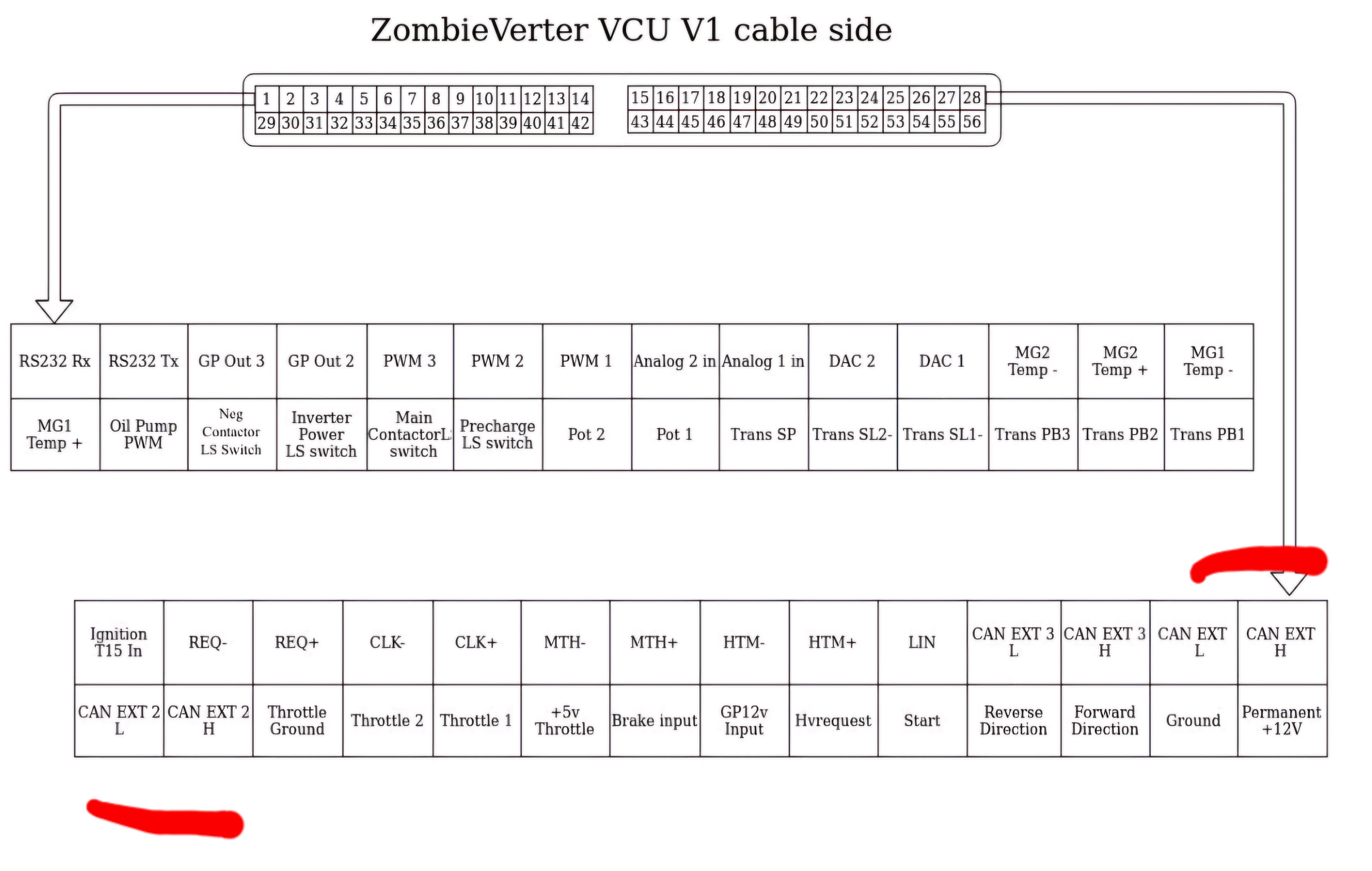

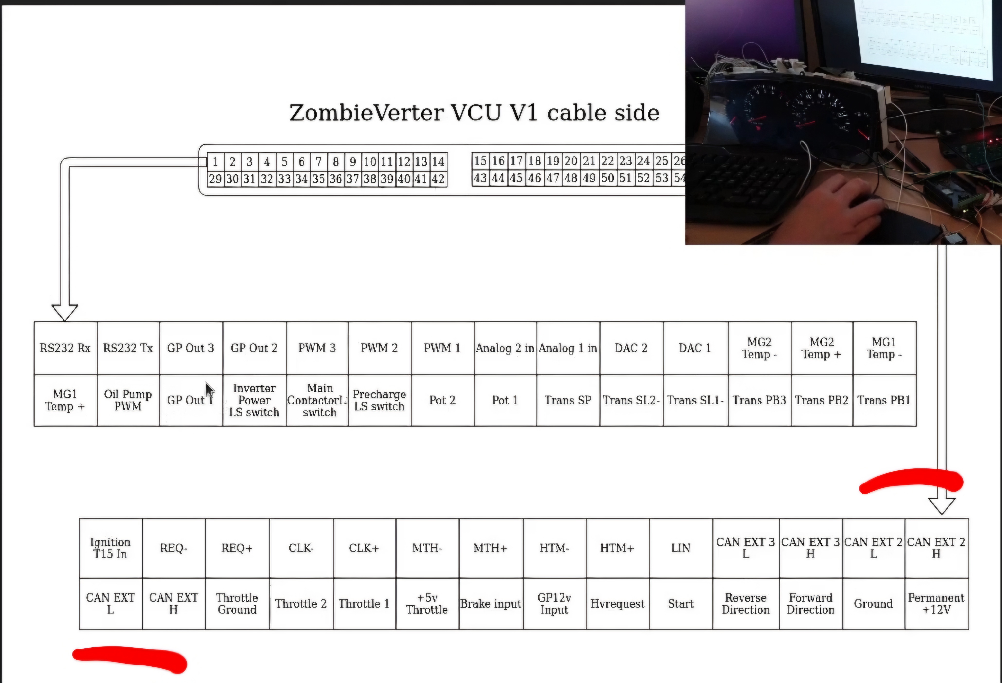

Hi. 2 different pin locations for CAN2 on the wiki vs D's YT vid.
CAN someone confirm which is correct please.
Many thanks 😊
(My pics a little blurry, but CAN1 and CAN2 are switched)

Wiki is correct
