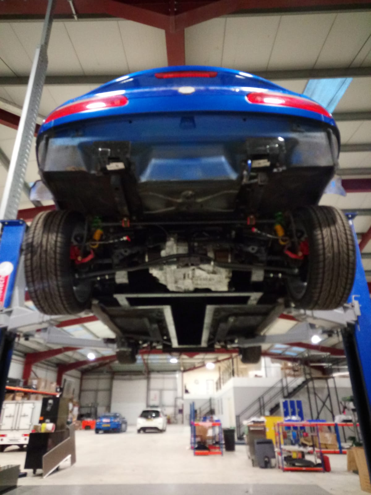

Re: Does Firmware now support "Field Weakening" for Leaf Motors
Yeah. We could support that - have a mule vehicle for our powertrain controller (vcu replacement) that we could adapt - leaf motor and 45kwh battery.
Director and Tech Lead at indra.co.uk

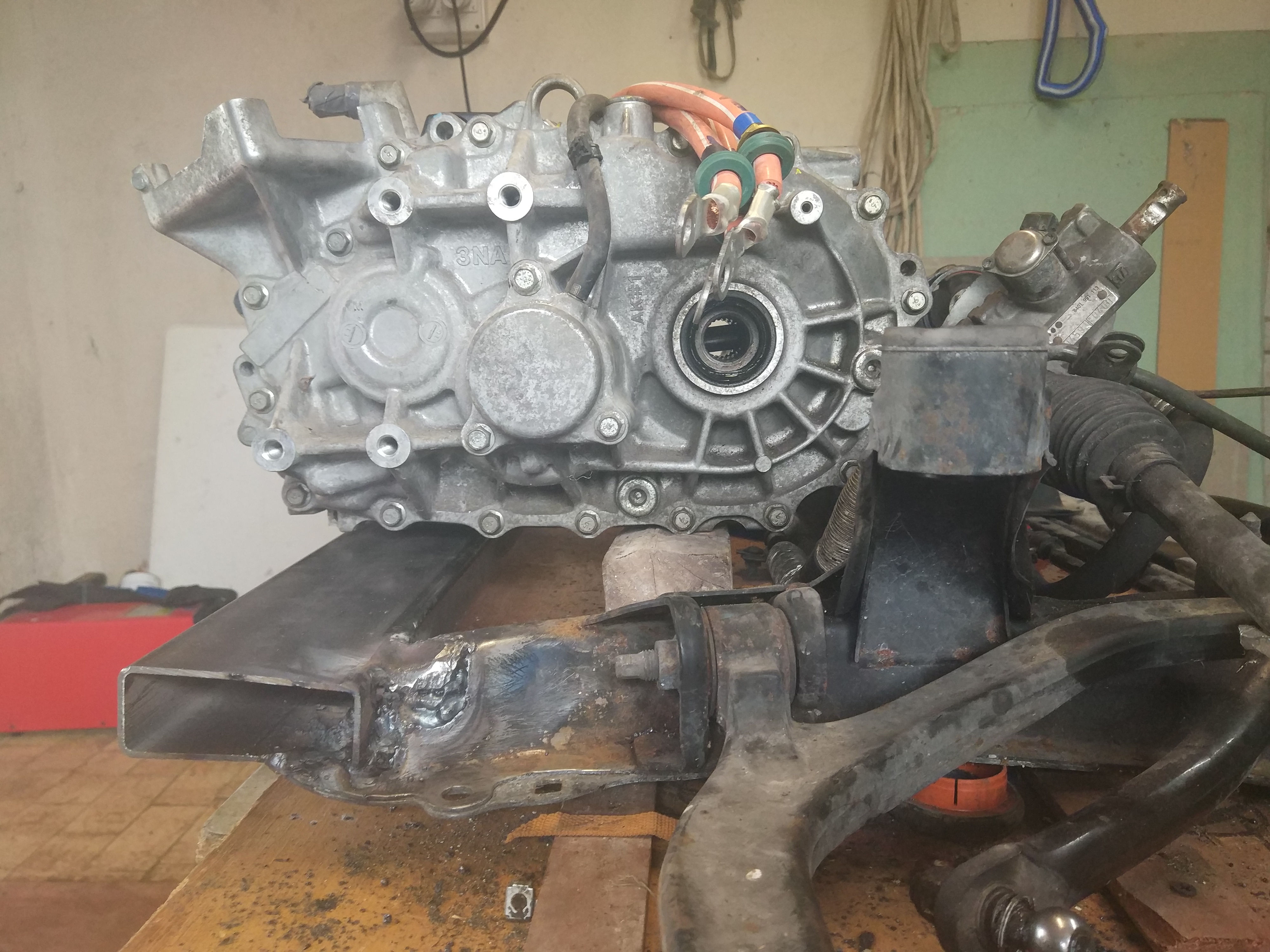

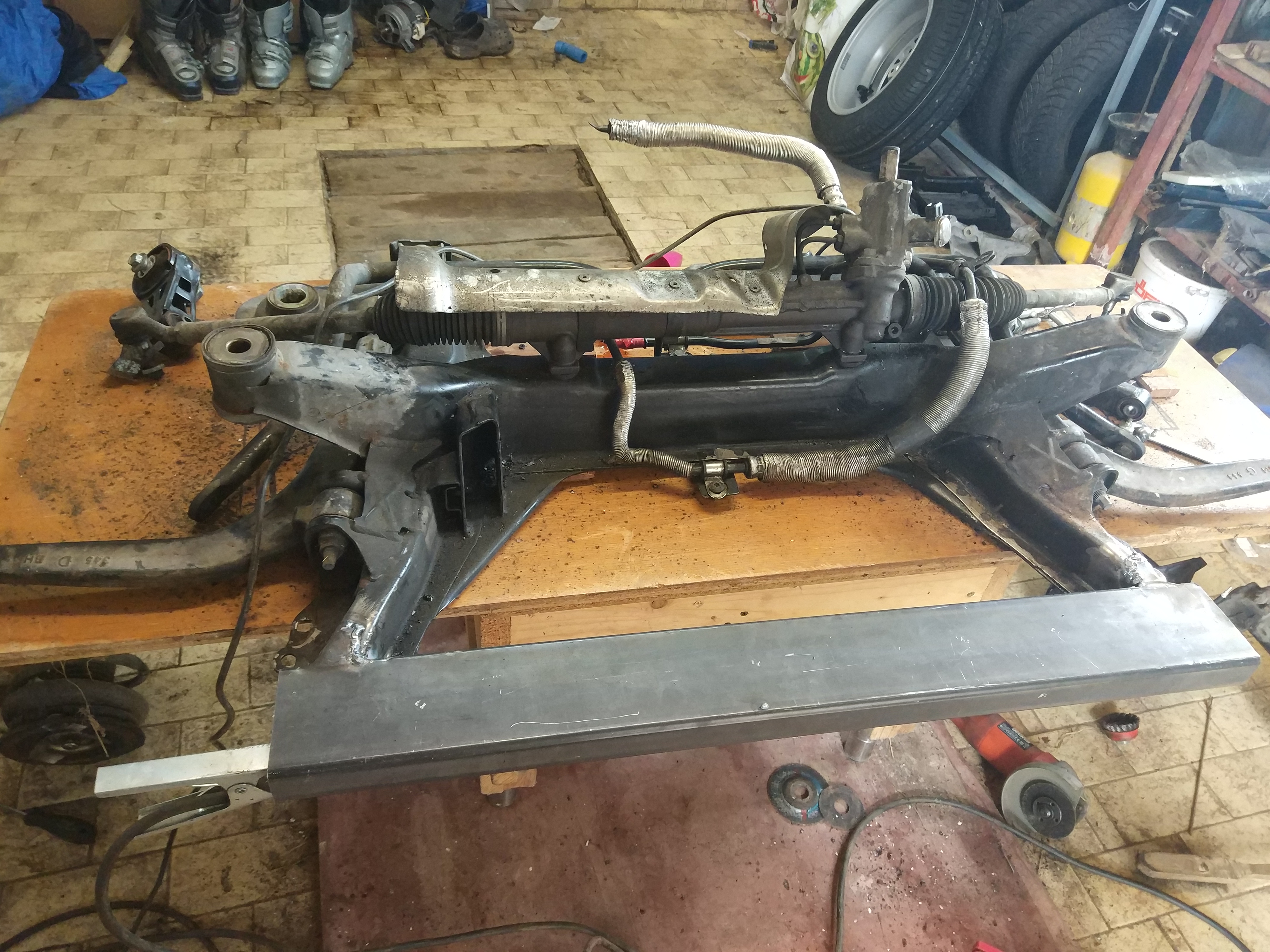

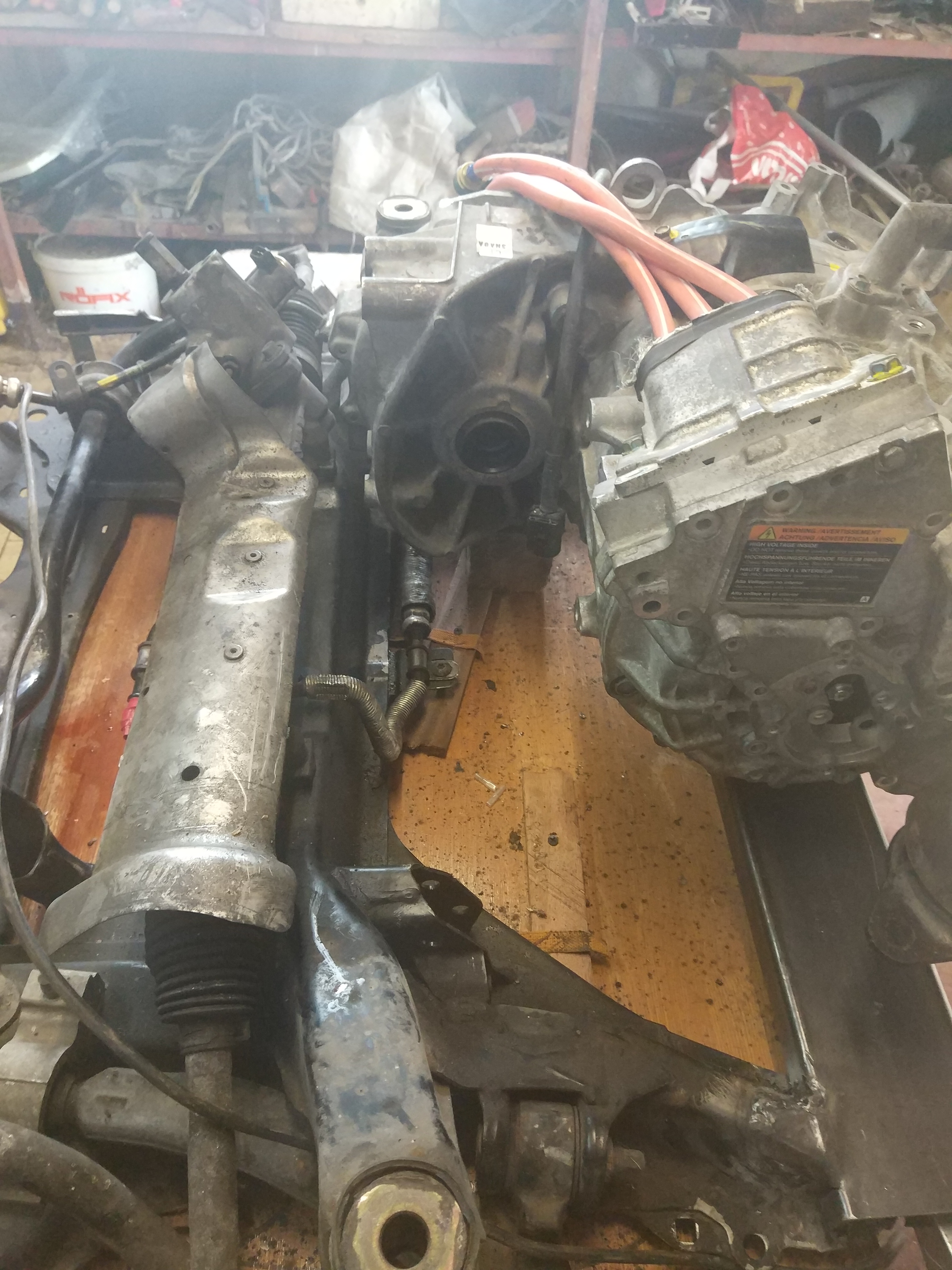

Hi Mike,mike@indra wrote: ↑Mon May 06, 2019 7:49 pm @Johu if you want to spend some time with one of our cars for fine tuning the software we'd be happy to host you and pay expenses kf we are able to use the system for customer projects.
Think I mentioned before that we already have a solution for controlling the stock inverter, we are just looking to add more power!
just saw this, must have overlooked it last time. Thanks very much for the offer! Will get back to later.
"Drove" my Touran today, so now I have something to work on right here.
