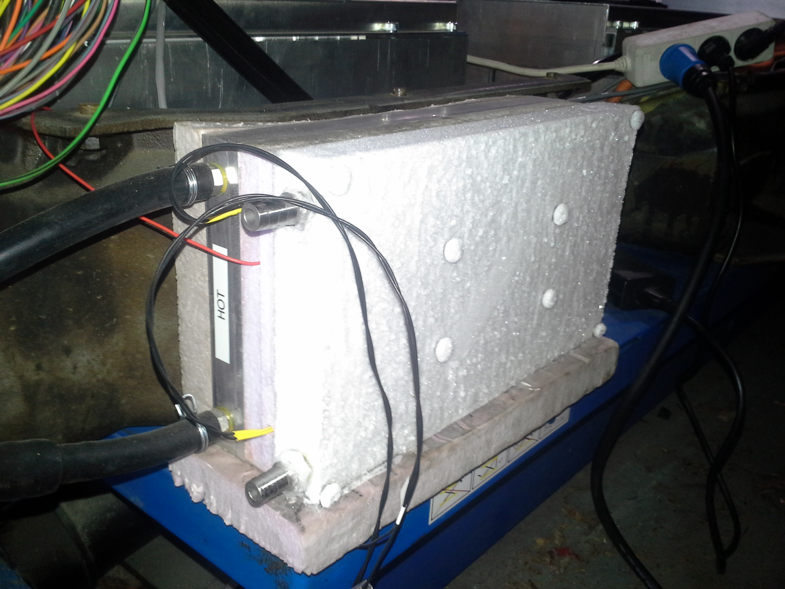

This is first test setup:

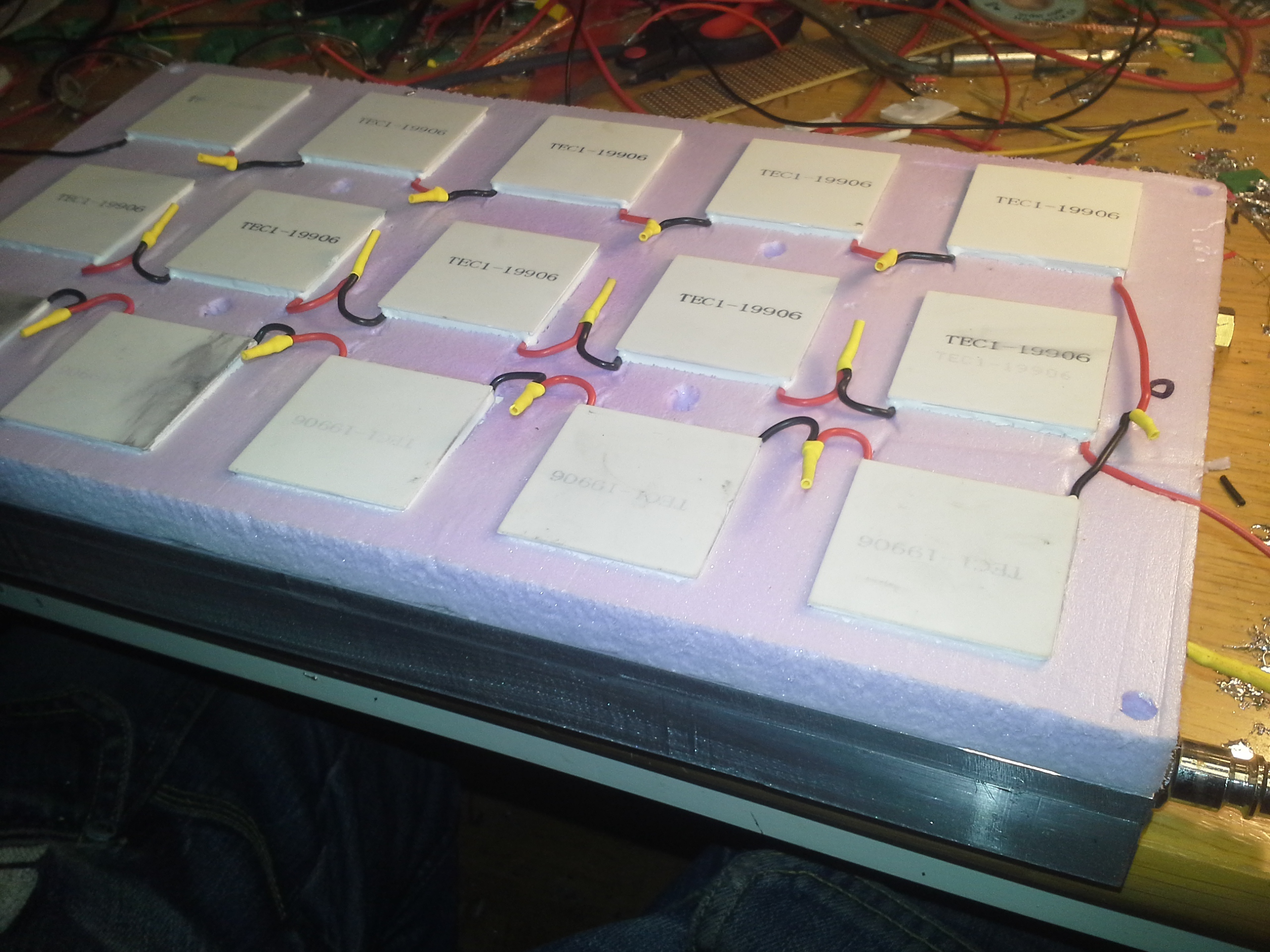

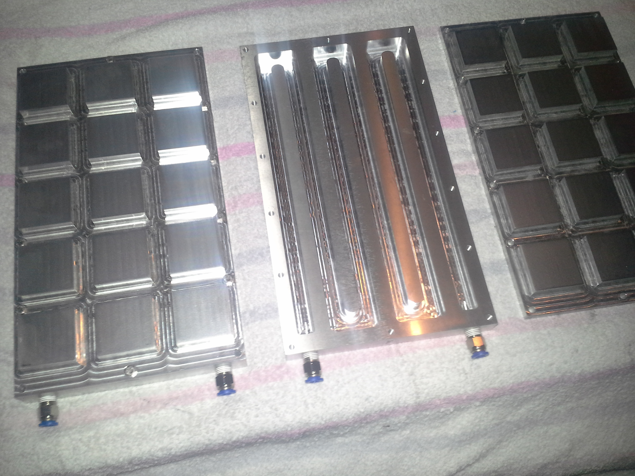

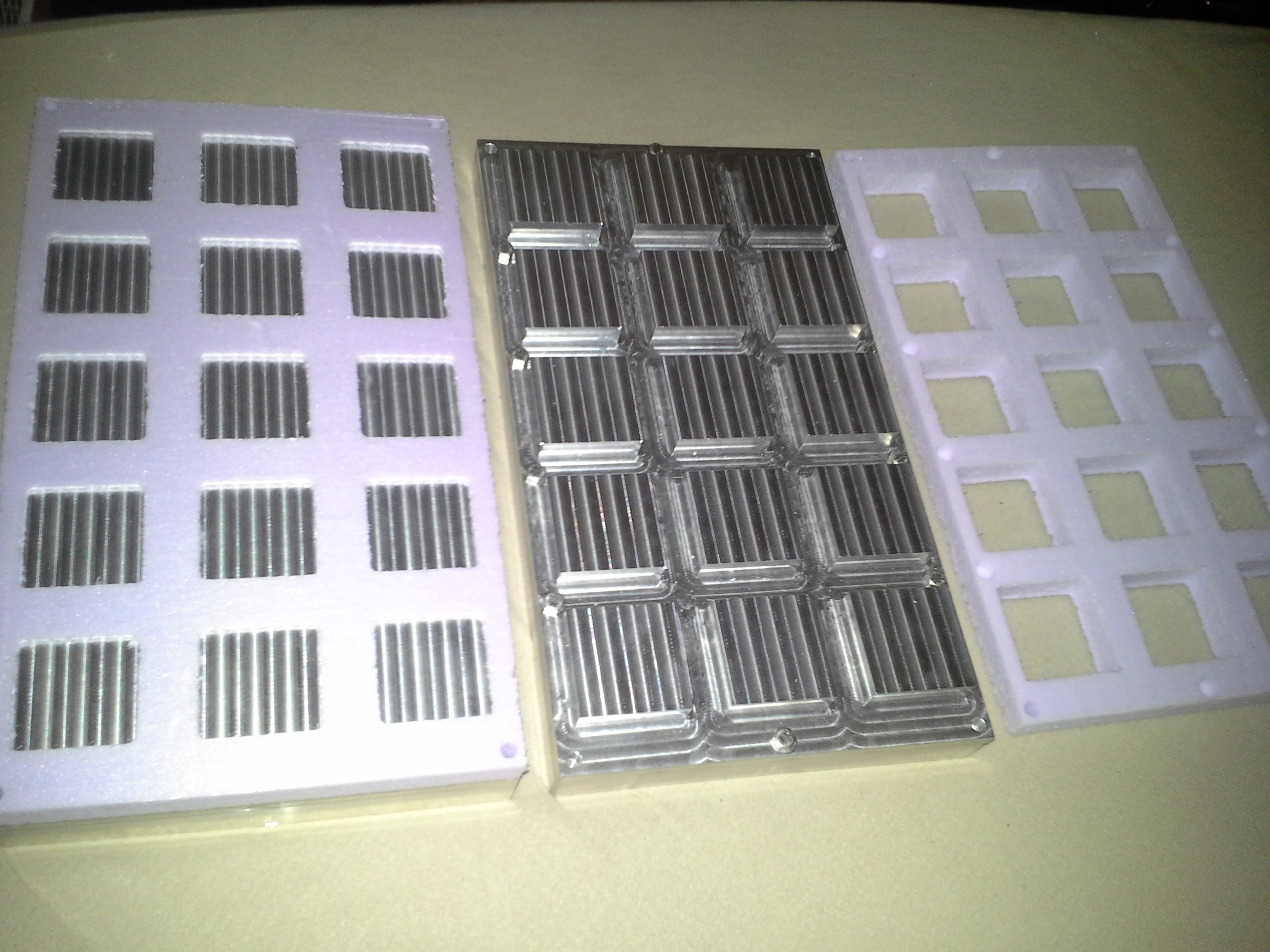

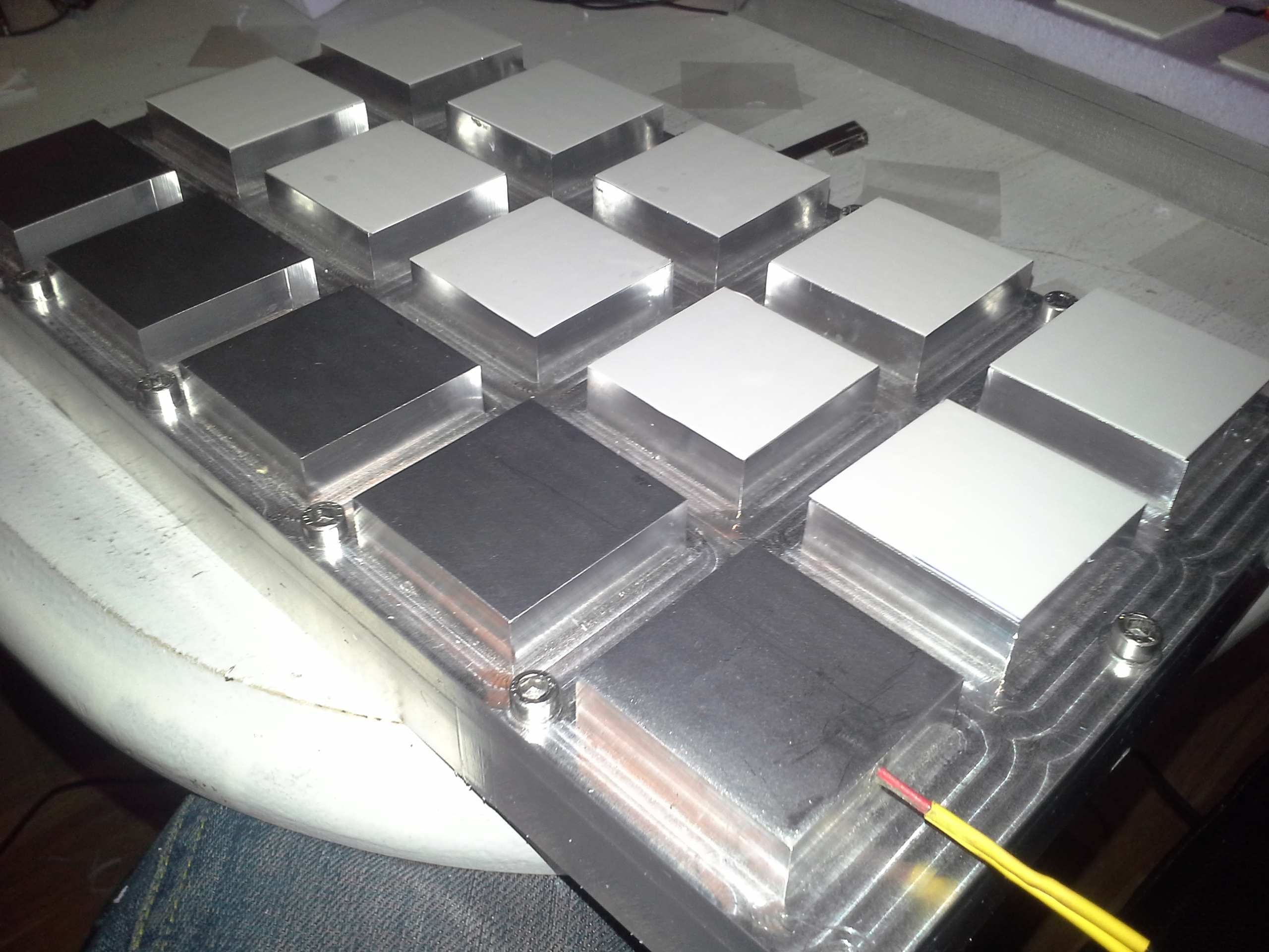

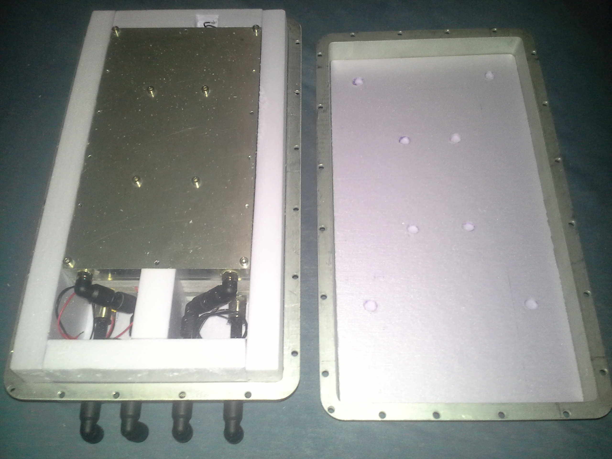

I made it from 20mm aluminium.
Isolated around the TEC with some PU plate.
Conductive "sheet" added. And mounted temp sensor on the first and last TEC.
Mounted the TEC's in series.
Test connected to battery pack, the ising was a problem, the first TEC's died after a while.
Probably because of wet and 300VDC don't work well :) And to much PWM test, they don't like that either.
Mounted in water tight enclosure. No condensing at all. Also put in some Silica dry-packs.

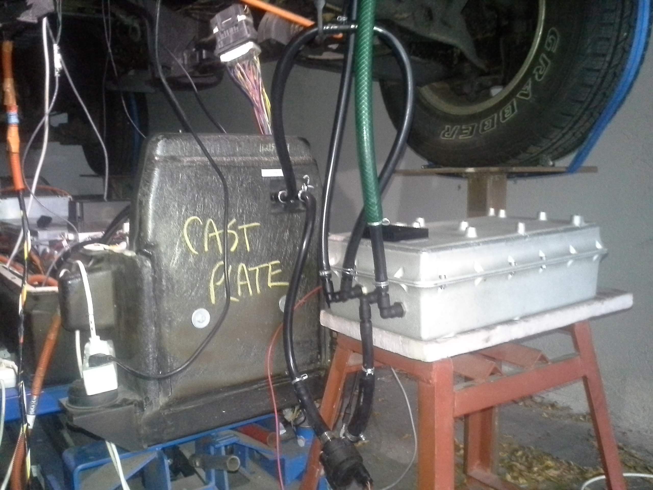

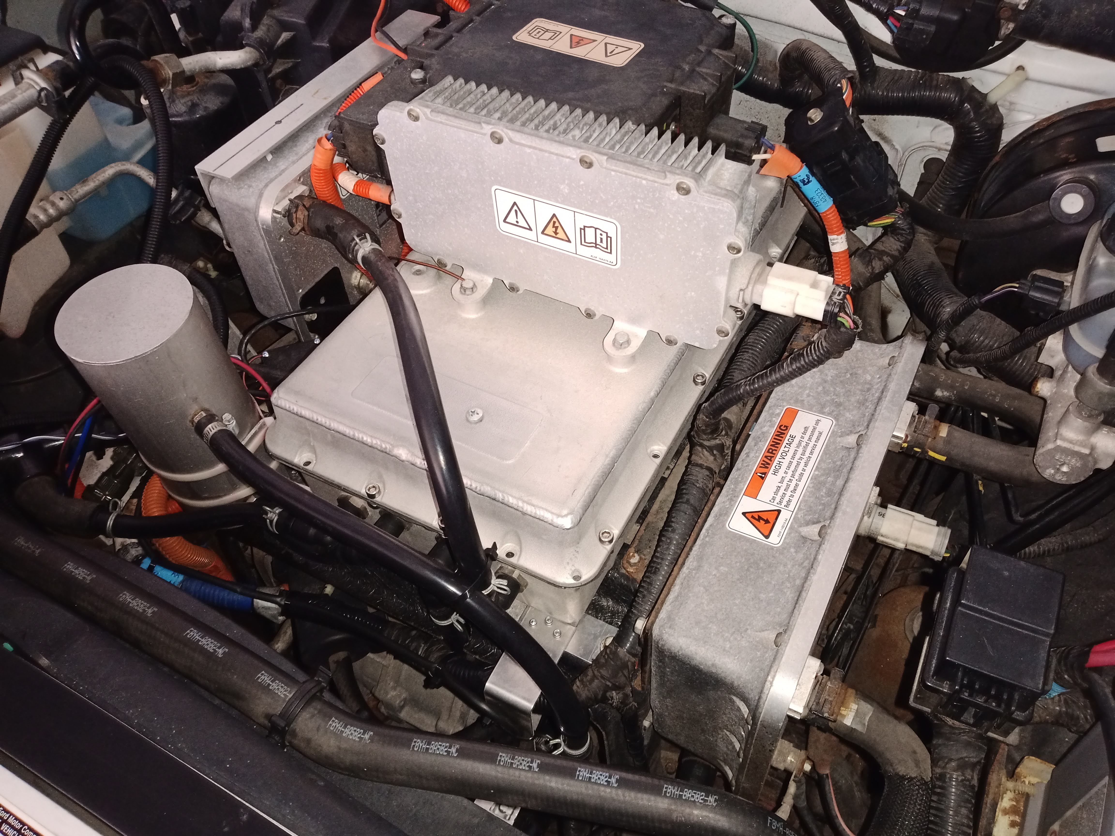

It's mounted where the original charger was, together with a small coolant reservoir.
Tesla chargers are installed inside the truck.
