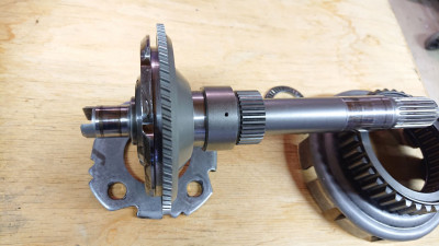

Ahh, sorry, I see it was planets to carrier, not ring. Makes sense for disassembly. Same principle, thoughKevin Sharpe wrote: ↑Sun May 10, 2020 6:07 am Yeah, not sure why this is so difficult, Damien has already posted instructions and a 'how to' video![]()

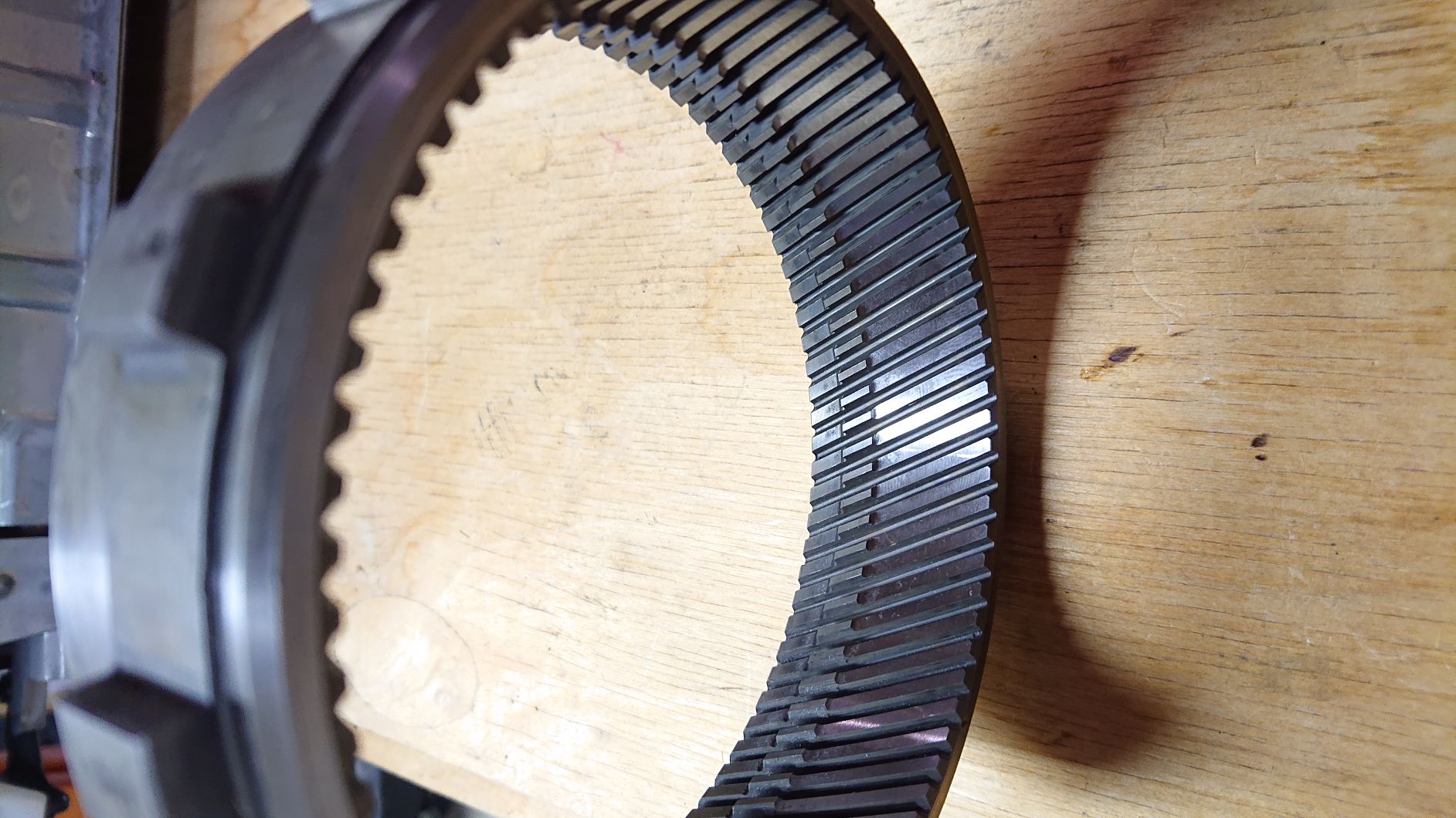

Re: Transaxle Modifications

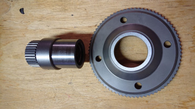

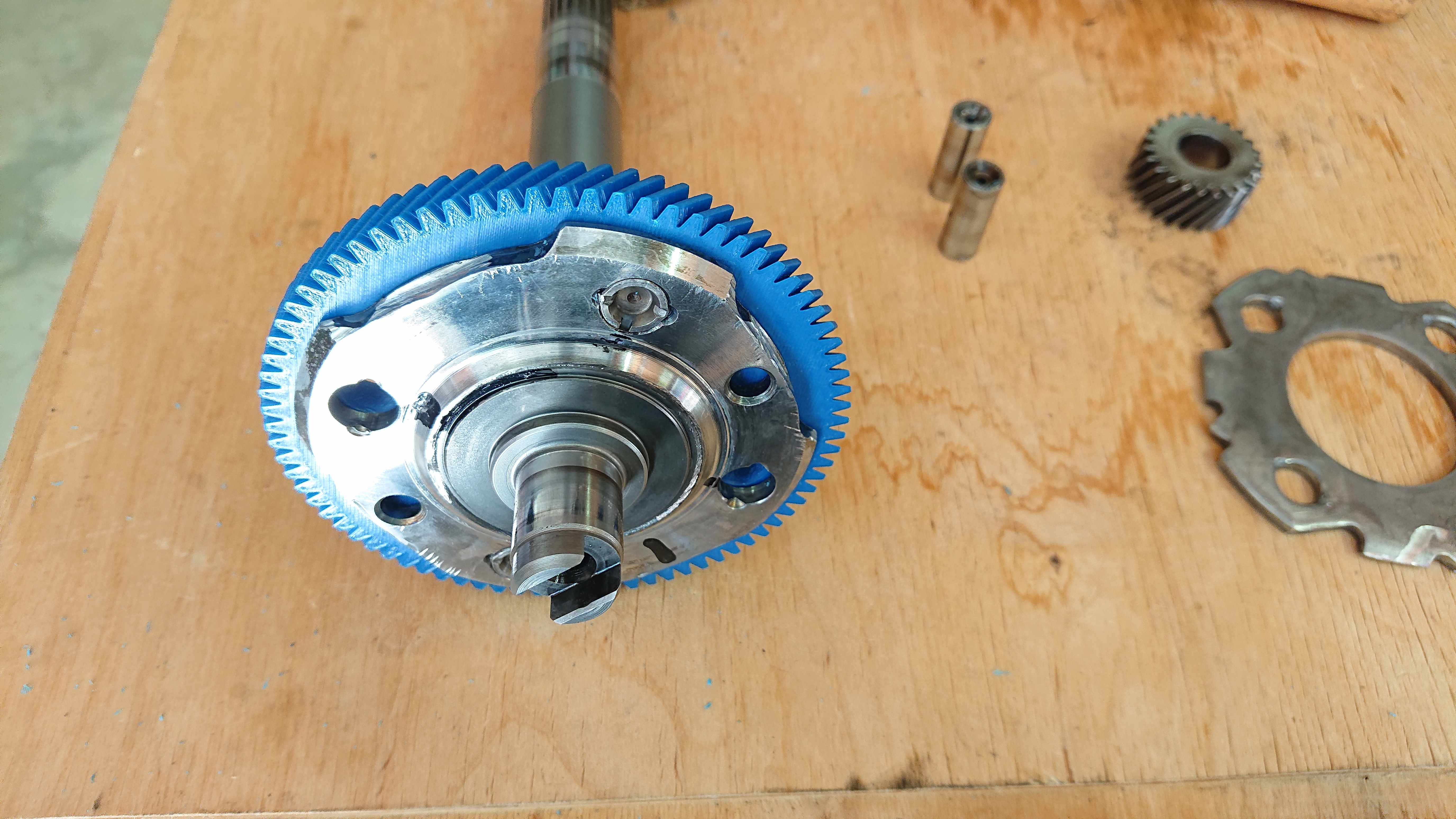

Mock up gear made. Remove planet gears and outer part of their cage is next. Measure thickness required for new part, to simply re-use original planet gear pins to secure a ring gear... More pics to come.
This is something to be machined out of steel to drop into the PSD?
Looking good. If this works will you share the model? I would much prefer to have a new gear machined than weld the old ones
I assume that the oil pump will rotate when Mg1 and Mg2 are locked up via slot at the end of input shaft?

that is correct RetroZero.
My project has finally started moving again. I have had an axle that mates with MG1 and MG2 directly. My first shaft didn't have a slot for the oil pump, but the company making the shaft have worked out a way to add the oil pump slot.

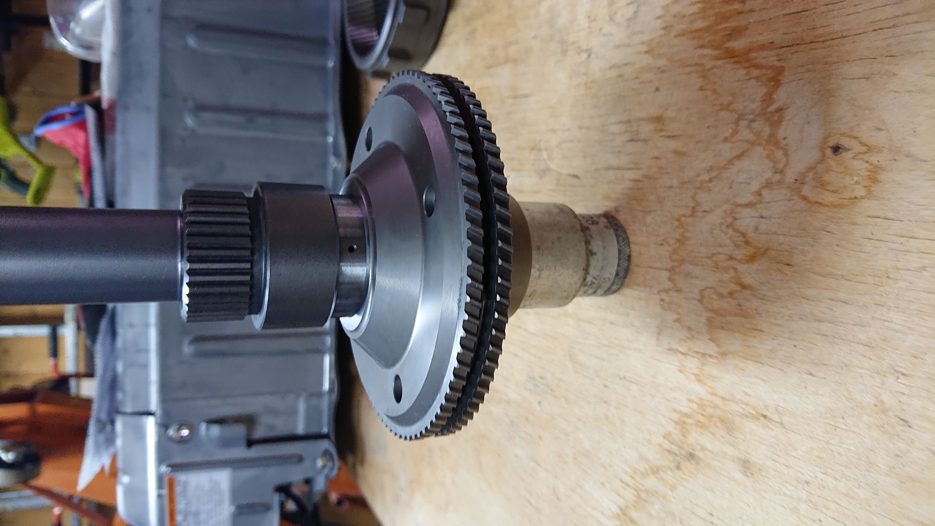

Just ordered a planet flange gear as per Toyota parts list. It's the gear connecting MG2 to Planet Carrier, which in turn drives chain and differential.
All my dear ENGINEERS want to know so much about the gear before even looking at it, that I took the initiative to buy the closest possible gear and have it 'slightly' modified...
They require, tooth angle, pitch, depth, clearance, type of (hardened) steel used etc etc....
So, since the Flange Gear is what transfers torque to the wheels (via the chain drive), MG1 and ICE are complimentary and basically provide extra Amps to inverter to keep MG2 happy...I think.
So if MG2 flange can handle 50kW, it can surely manage 30kW from MG1 no?
Will then have the flange gear lined up with pinion and teeth modified to correct depth ....cross fingers there is no COVID 2!!

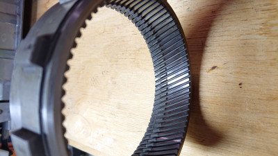

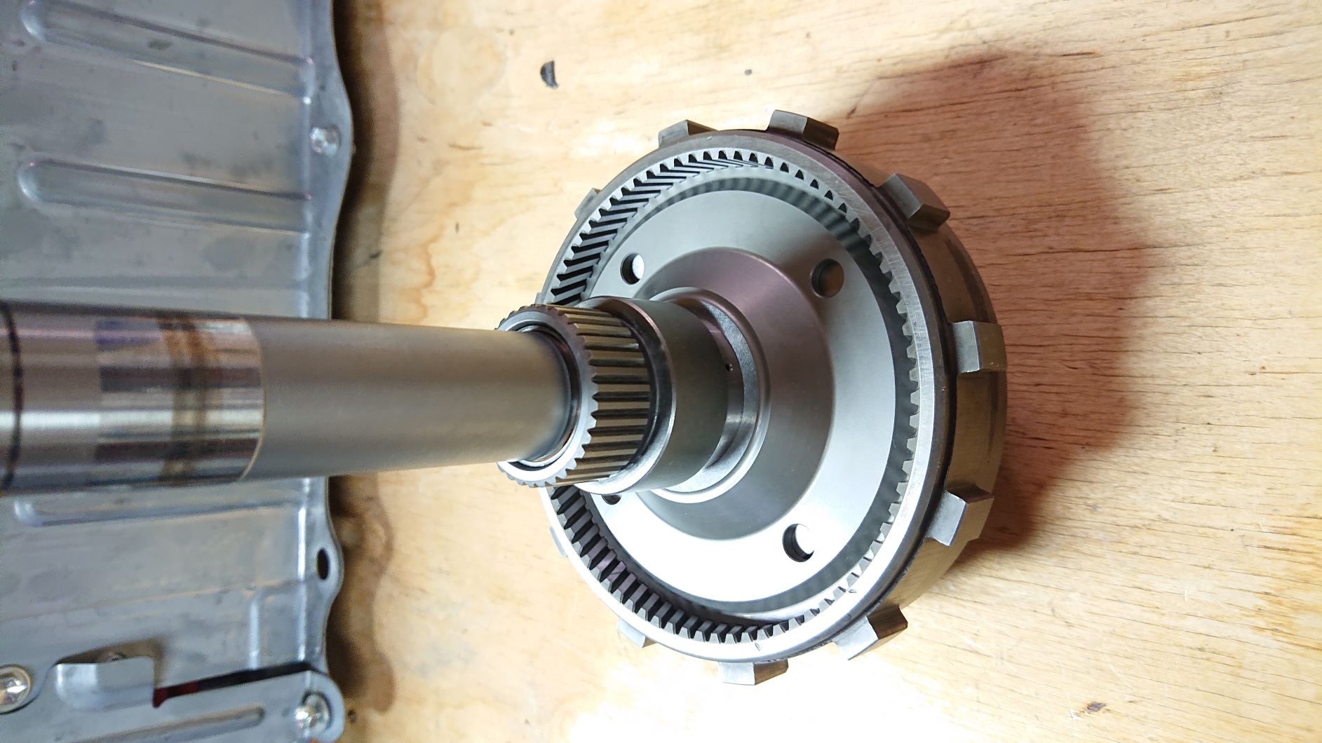

After a long 3 months of finding some one willing to do some "out the box" machining....One "soon to be welded up" Gen2 PSD lock up solution (when in tight regulations situation) is going intoo next phase...
Take one MG2 output gear, machine it along with MG1 output pignon. Then machine the outer carrier to match the MG2 outer teeth (remove 1.5mm).
Then find some nice people to weld it all up ( with a spacer in the middle for some clearance)
