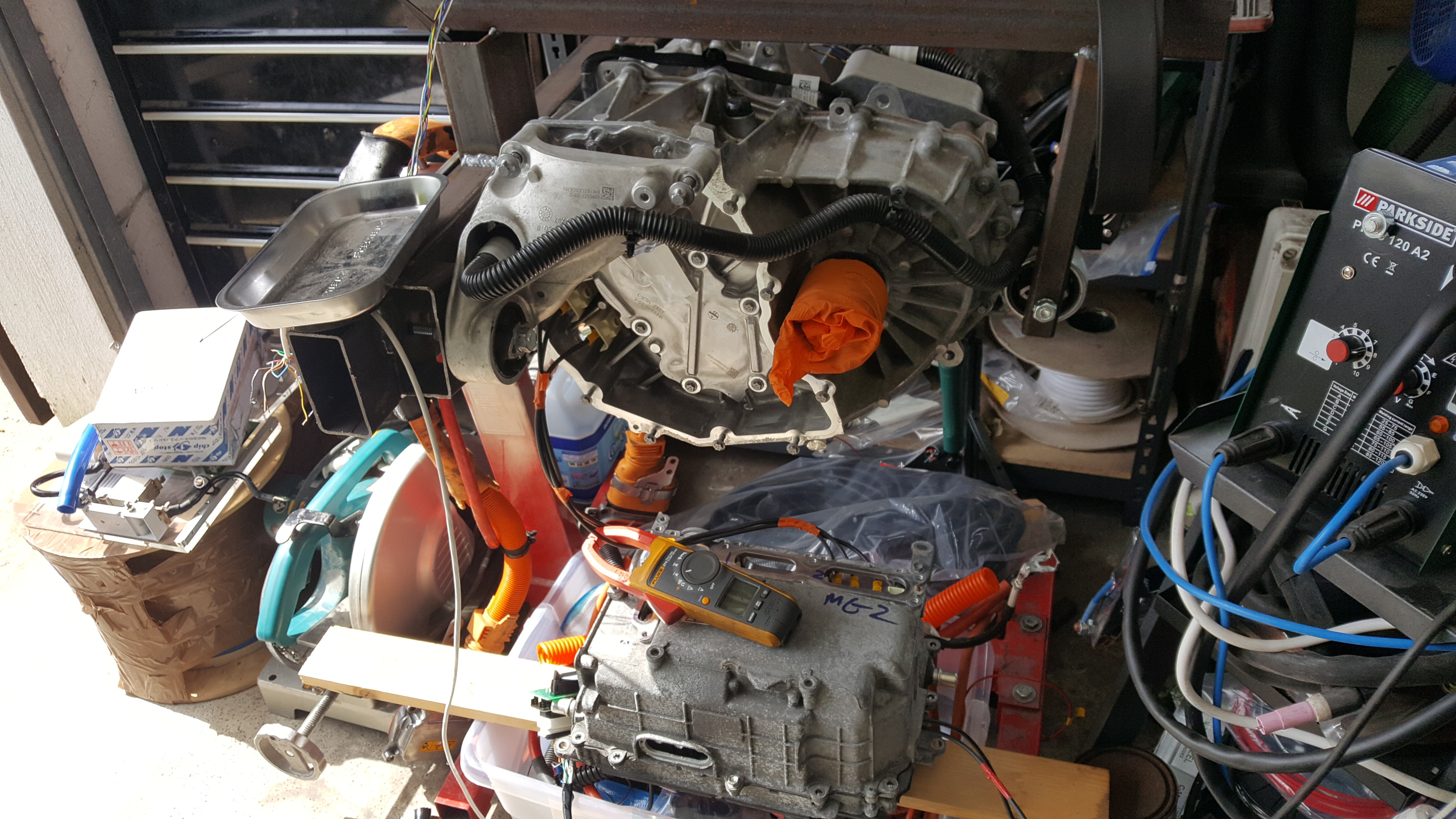

So went to work on the M3 rear drive unit today with the prius inverter and foc firmware. Of course it didnt work as the Prius inverter has current sensors on Phases 1 and 3 not Phases 1 and 2 as required by the foc firmware. Sooo went poking around the firmware and made some changes :
      if ((Param::GetInt(Param::pinswap) & SWAP_PWM) > 0)
         timer_set_oc_value(PWM_TIMER, TIM_OC1, dc[0]);
         timer_set_oc_value(PWM_TIMER, TIM_OC2, dc[2]);
         timer_set_oc_value(PWM_TIMER, TIM_OC3, dc[1]);
Unless I'm missing something somewhere else this should make the pinswap swap phases 2 and 3 not phases 1 and 3. Here goes ....
Posts: 3639
Has thanked: 9 times
Been thanked: 274 times
Yep that works. I can't seem to upload the bin so will wait for Johannes to do it properly:)
