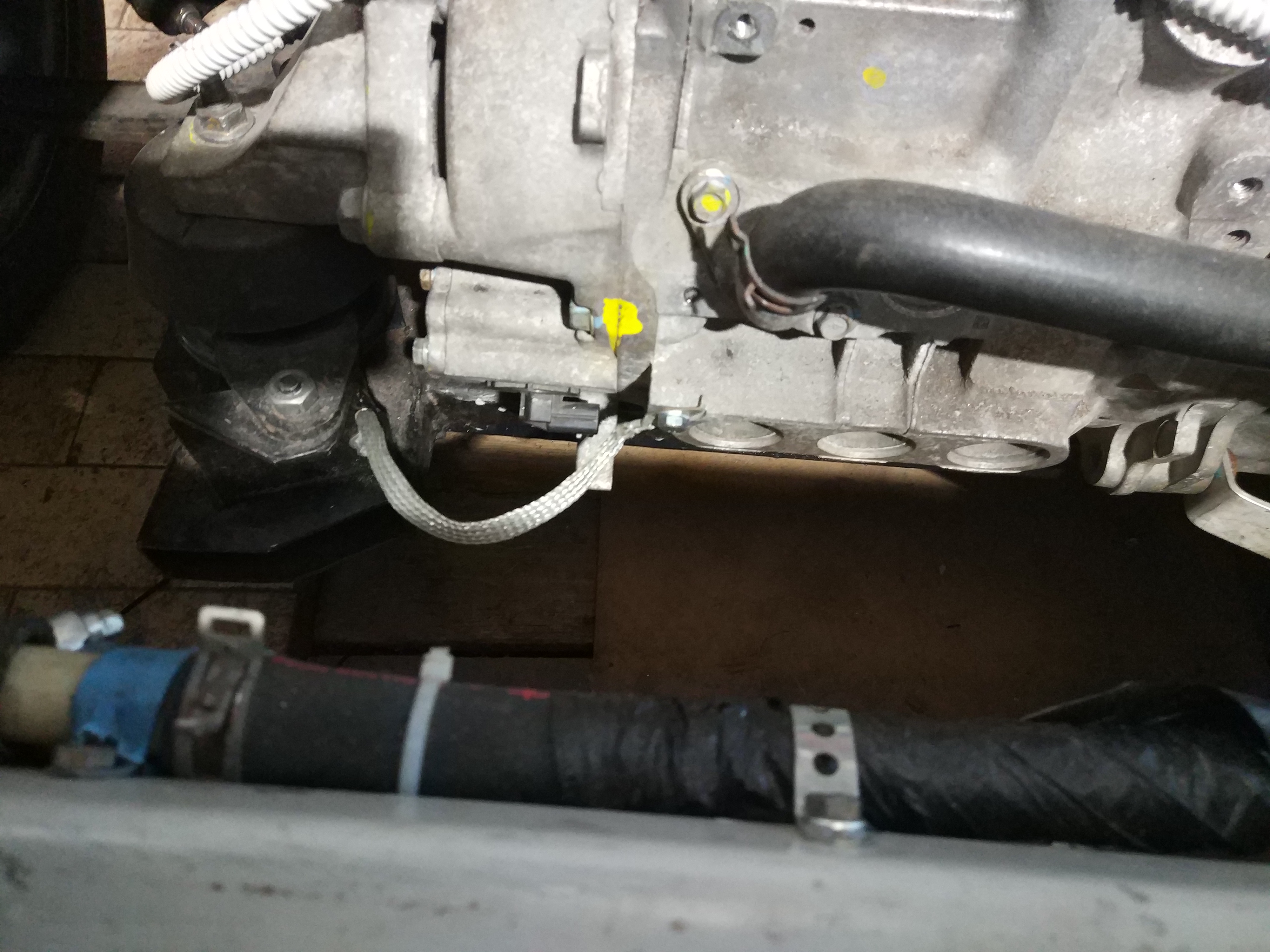

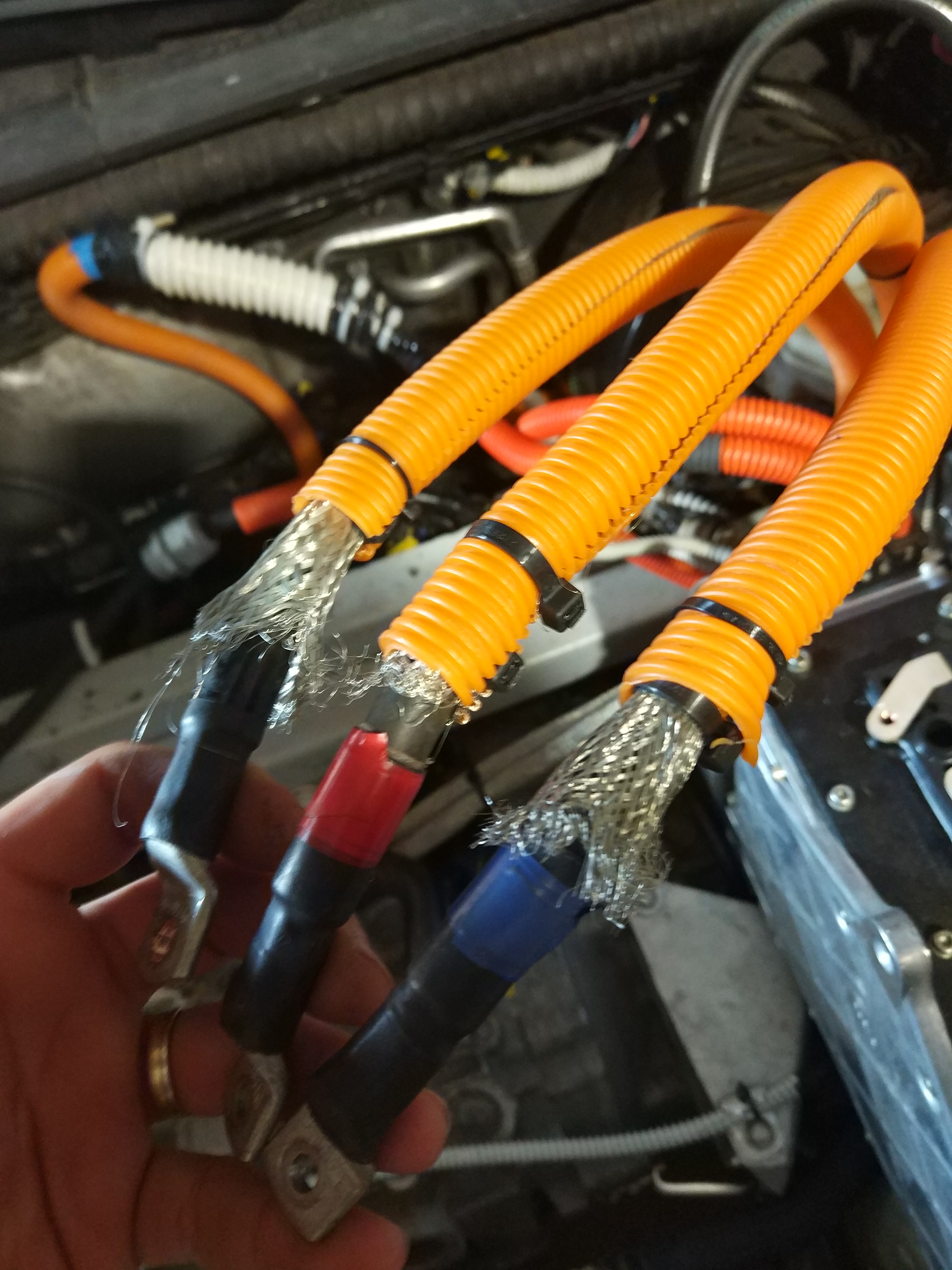

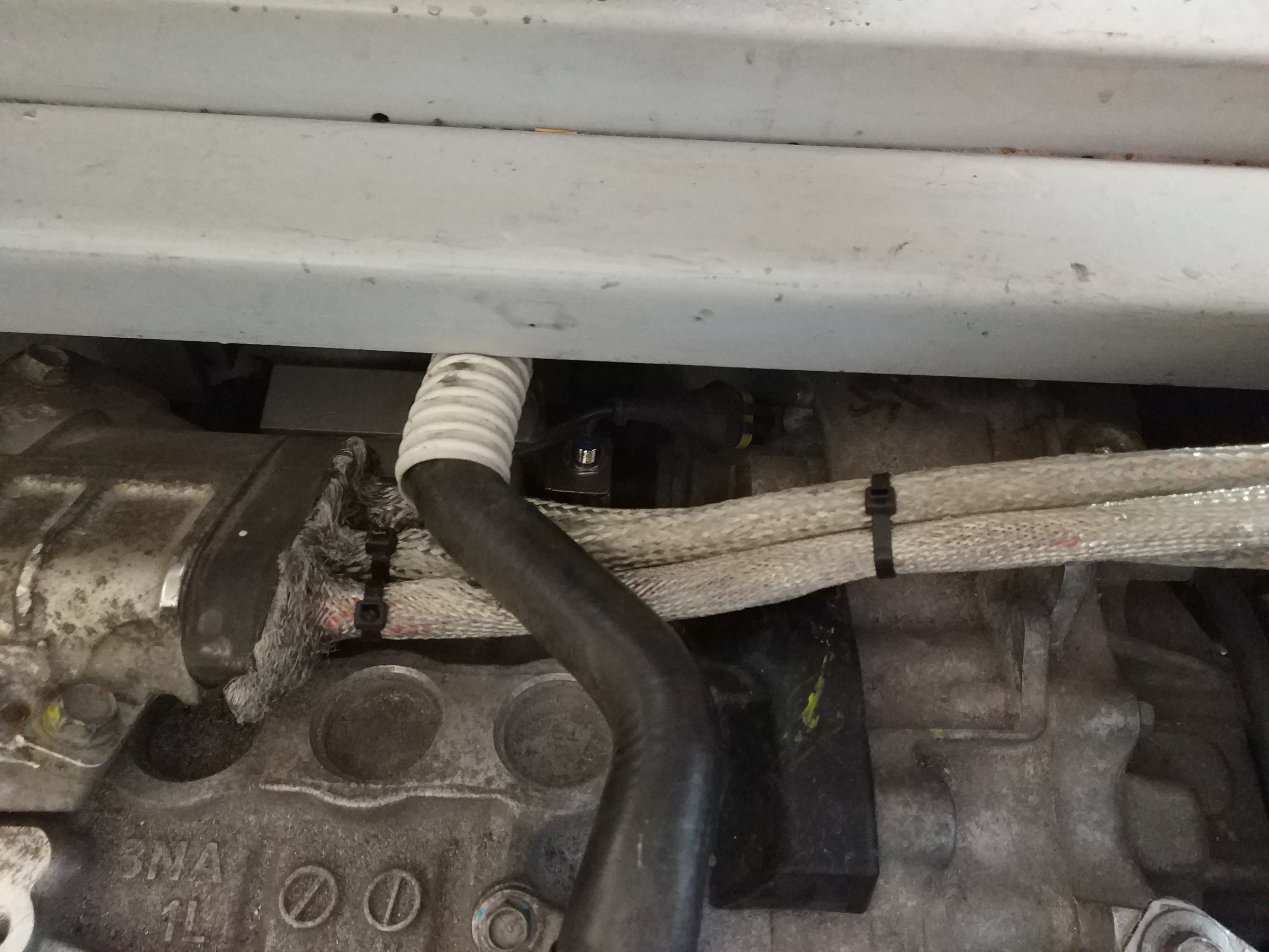

1. I will put every phase cable in braiding mesh and then close it in orange wrapping. Similar what Leaf motor had in original
I will connect all meshes together and finalize connection with one piece of mesh going to car chassis
2. I will use a smaller wrapping for my sensor cables and also ground them to car chassis.

I found a reliable way of getting a phase cable size of shield mesh. I bought/got a 18p or 24p marked signal cable with shielding and i used numbered signal wires for inverter interface harness. I cut off the cable in desired lengths and carefully took off the shield. Then i bunched both ends together to expand the shield. I put it over phase cable and fixed in one end. Then i pulled on the other end so it naturally closes around the cable. I fixed both ends and in between with plastic zipties.

Well yes, like i said i will shield phase cables primarily.

Also for EVdisplay i found one FTP cable and cut the shield before connector. I pulled some of it out of the insulation and fixed a wire with eye connector on it. Reason is that i want to pull the shield to GND level not to BATT-. Well see how it goes when i assemble the battery box back.
Also i affixed motor and connector with the same braids so they are grounded to one another and to GND level.
