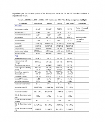

As of right now, no one has written software to support using the inverter that way( boost when throttle, buck when regen), but it is possible with the current hardware, but extreme care has to be taken, as I don't believe the buck/boost modules are as bulletproof as the inverter stages. Also, if you choose to use the boost converter in the way that I think you are (Battery ---> Boost ---> Inverter ----> Motor), you will be limited to the power that the boost stage can deliver (27kW).
