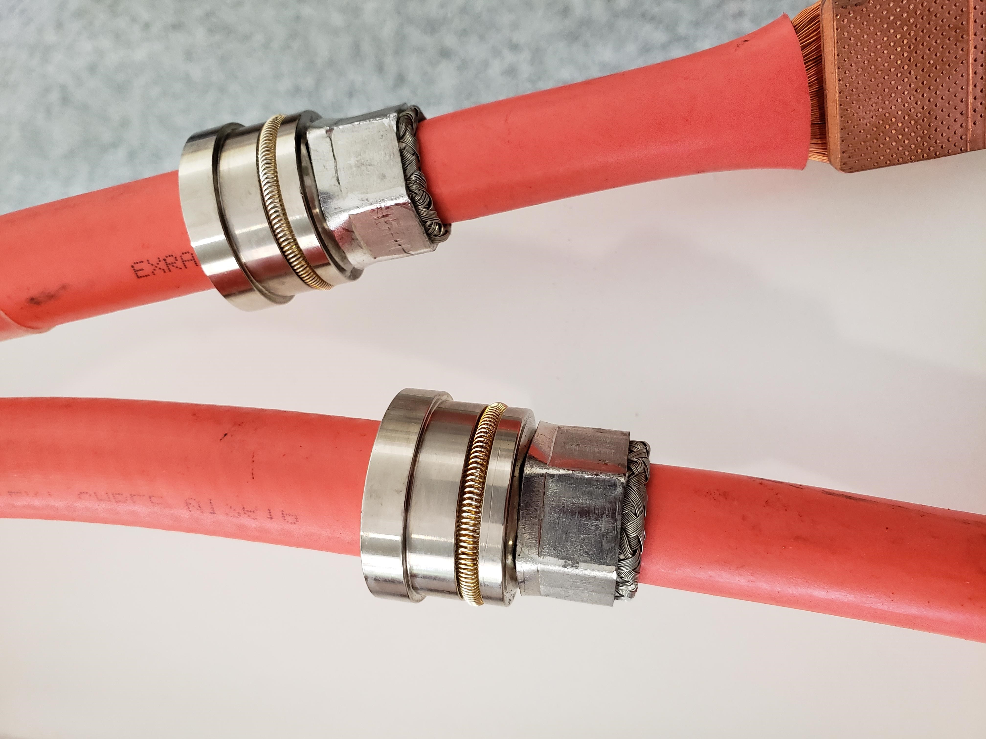

I'm not super happy with the stock HV cables for the LDU from Tesla, and am considering building my own bespoke cables, but there are some bit's I don't know how to source, or even what they are called. They are the connectors/Shielding terminators in the attached photos.
Any help would be appreciated.

I'm still looking for the crimps. In the meantime I did find this;

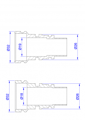

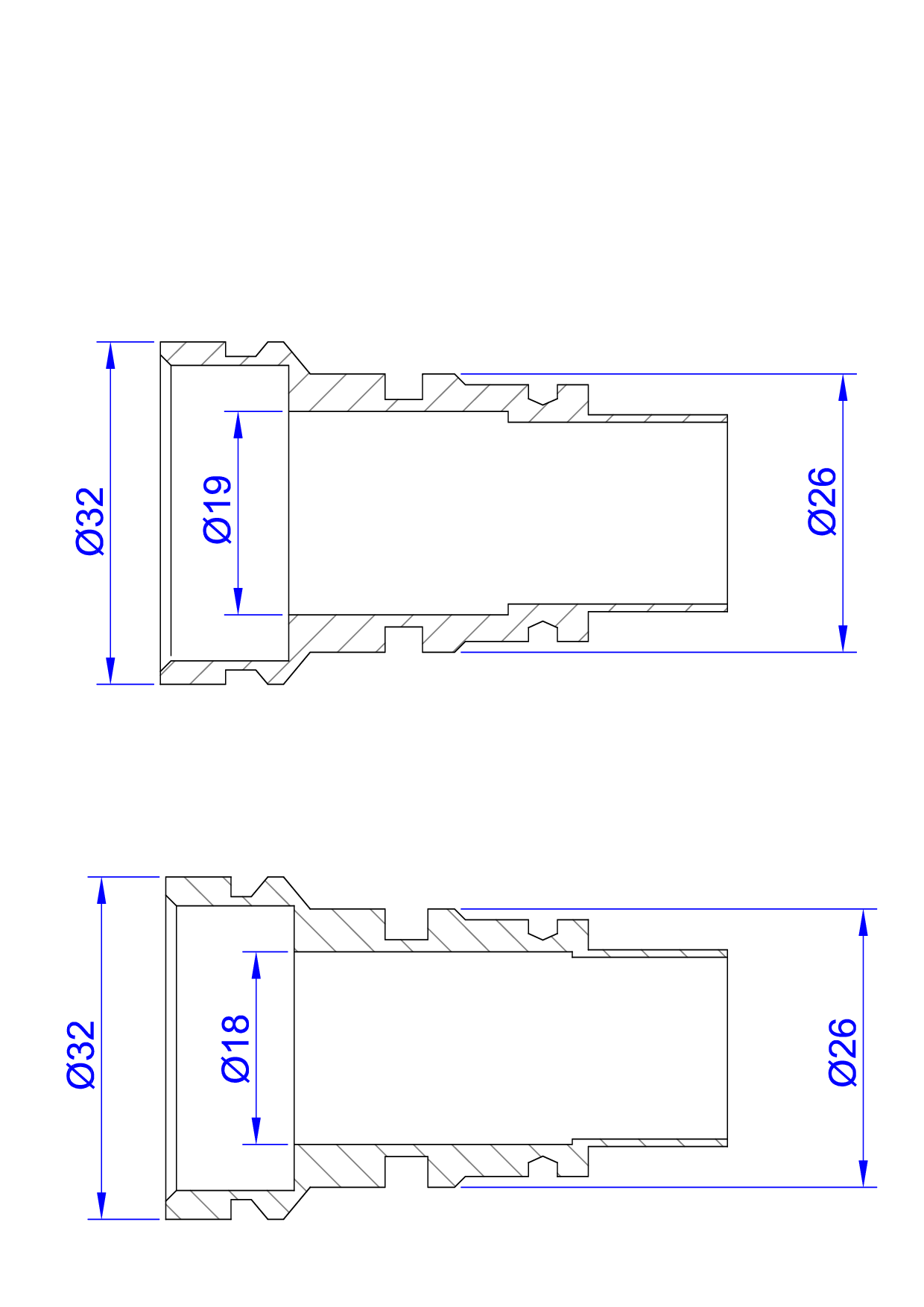

I have a similar problem, I need longer cables on the motor. My 70mm² cable has a larger outer diameter than the AWG 2/0. I will make stainless steel parts to make it fit.
Posts: 2754
Location: Bristol
Has thanked: 264 times
Been thanked: 717 times
I am also working on some adapters that we hope to sell at Zero-EV. Utilising gland components to work with 70mm2 or 50mm2 shielded cables.

Hank wrote: Thu Jun 04, 2020 6:24 pm I'm not super happy with the stock HV cables for the LDU from Tesla, and am considering building my own bespoke cables, but there are some bit's I don't know how to source, or even what they are called. They are the connectors/Shielding terminators in the attached photos.
I couldn't find anything and decided not to wait any longer :)
viewtopic.php?f=11&t=37&p=15806#p15806

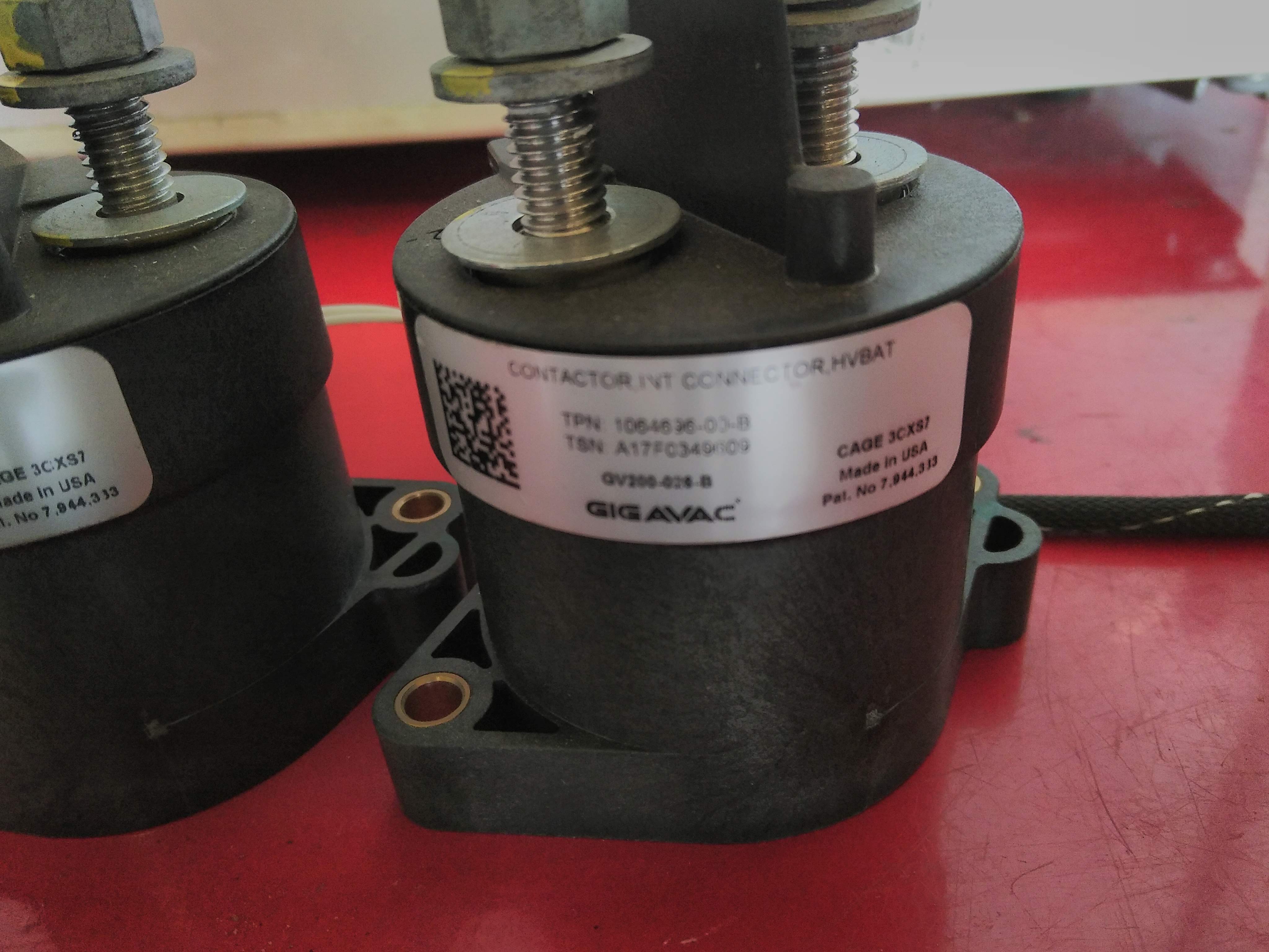

Kevin Sharpe wrote: Fri May 22, 2020 6:32 pm
konstantin8818 wrote: Fri May 22, 2020 5:37 pm So I need to attache them back?
If you run a contactor that requires an economizer without one then you'll burn out the coil.
We had the Tesla Model S/X contactors on the bench this week. I can confirm they consume ~2.5A @ 13V and get very hot. They require an economizer.

Went ahead and tested Ford Focus Electric 23kWh contactors.
Main HVBAT+ TE 2098952-2
It Will disconnect at 1.2V0.3A
Reconnect happens at 6.6V1.56A
Draws 2.7amps at 11v stepping down from 12V el-cheapo.
When adjusting the voltage down to point where current is 1A, it will take 4.2v
Charge/precharge contactors TE 2138551-3 draw
0,7A@12V
0,35A@6V
Cutoff 0,16A@2.8V
Cutin 0,28A@4.8V
Measured with a DIY adjustable 1-12V power supply made with about second cheapest semi ready parts on ebay, so not the most accurate but still wanted to share.
