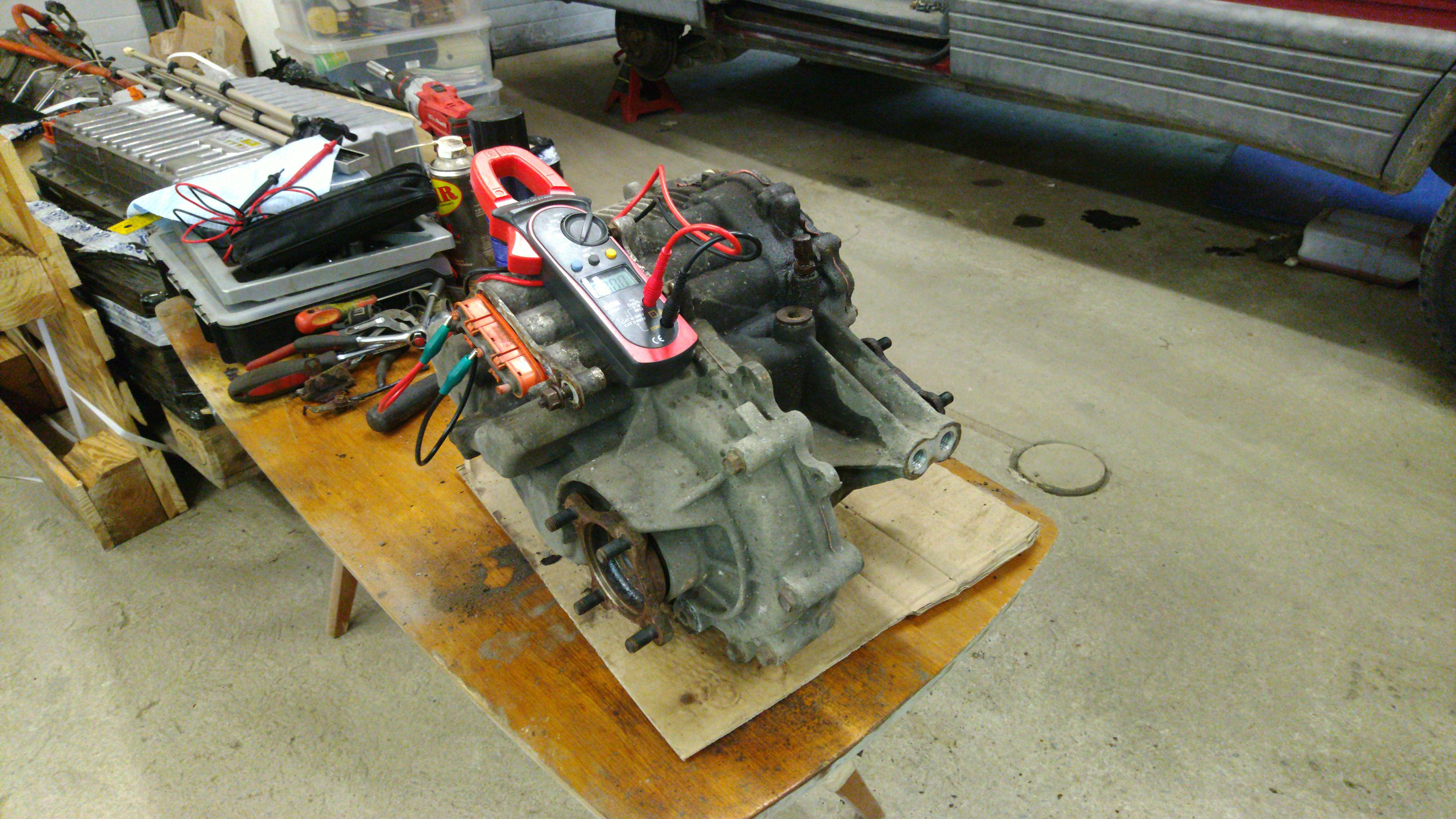

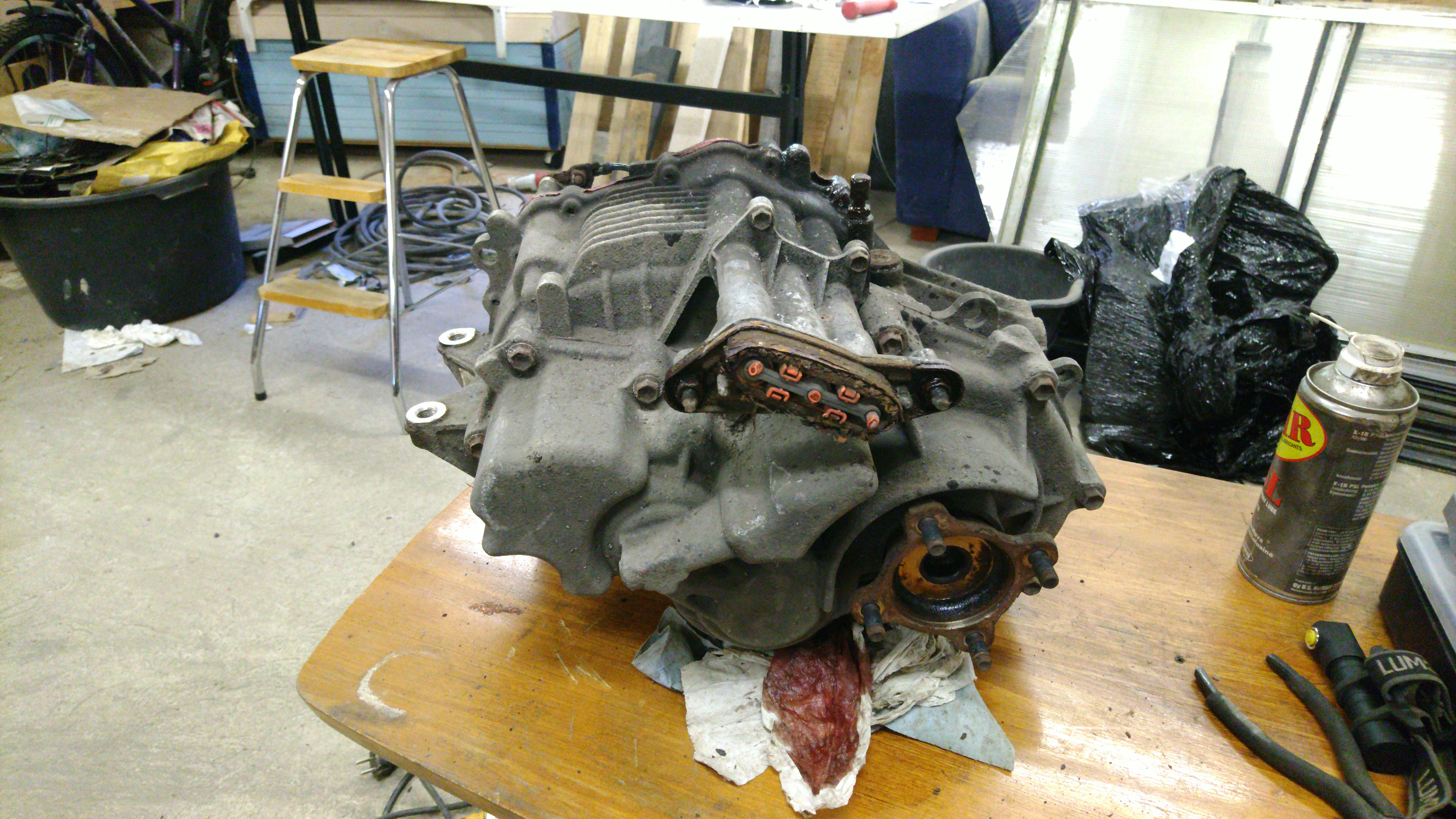

So happy news for the busy, lazy or poor people who don't yet own one of these. Because I now do!
This unit appears as if it was used as a boat anchor for some time. But it seems to be working and the electrical contacts seem fine. It even came with a reasonably serviceable high voltage connector.
I think the most interesting and easy test for this is: How much voltage does it output per rpm? I spun one side by hand at 30 rpm and kept the other side still, resulting in 15 axle rpm, which is about 102 rpm at the motor. The measured AC voltage between two phases was about 5 volts. That's rms voltage of course, so it'll take about 7 VDC at the inverter to do this. That means this motor does require almost 700 VDC at the inverter in order to produce good torque at 10000rpm.
EDIT: Also, I think I miscalculated earlier. What I need for 100km/h is about 790rpm at the wheels, which means this motor will have to spin at 5400rpm, which requires according to this test about 380V. So, with a full 96 cell pack, it'll maintain that speed for a little while and when the battery is almost empty at 300V or so the car might have slowed down, maybe down to 90km/h, who knows. How much does field weakening help here if the required power is about half of the maximum the motor is designed for?

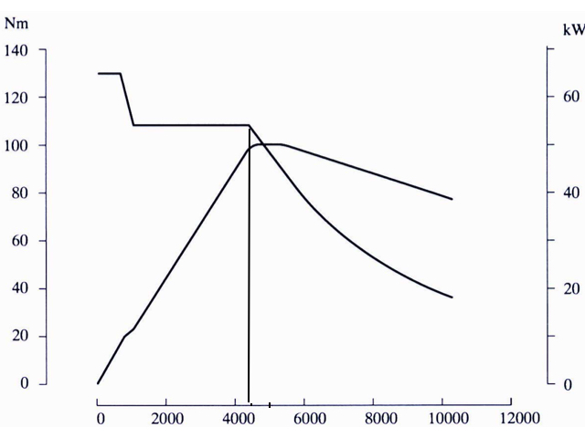

Based on the information in the post I am actually quite hopeful that this little gem could be used in a light weight car (looks like I shall be going shopping soon :D )
Based on the graph that Pajo_16 found and celeron55's spinning the diff, I have scientifically doctored out with paint (attached) and we can see that the knee of the curve is at I would say 4400 rpm, at that speed we would need:
Voltage req = 4400 x [7 / 102 rpm] = 301 volts which is quite close to the native battery voltage (288v)
Now if we say our system is 95% efficent (probably optimistic, but this will give us the smallest current)...
Current draw = 50000 / (0.95 x 317) = 185 amps
Based on the graph also our Nm/Amp shall be:
Trq Amp = 110/185 = 0.6 Nm/Amp
Now with a full battery accounting for sag etc say we kick out 390volts
We will get 390 x185 x 0.95 = 68500 Watts! So it looks hope full we can get full at least power in 96S config
Motor speed shall be:
MTR RPM. = 390 x (102/7) / 1.05 = 5683 rpm
Now assuming Field weakening can produce a similar constant power region:
based on "49 kW @ 4,610-5,120" (thanks pajo)
we will get maximum power between:
Pmax SPD = 5683/4400 x (4610 & 5120) = 5954 & 6613
Now if we take a smallish tyre say 195/50/15 (Mazda mx5) our tyre circumference shall be:
Tyre Cir = [195 x 2x(50/100) + (15x25.4)] x Pi = [195 + 381] x 3.14 = 1809 mm or 1.8 m
Our Maximum power speed shall be:
Speed = [1.8/1000] x 5594/6.8 * 60 = 89 kph
Speed = [1.8/1000] x 6613/6.8 * 60 = 105 kph
Pmax 49 x 5683/4400 = 63.3 kw
I know there is quite a large margin for error in this but I thought I would share and see what your thoughts were (if i'm off my rocker):

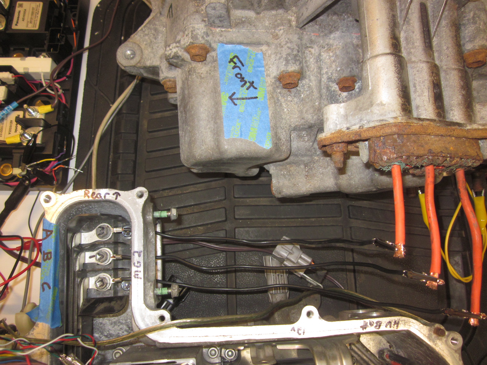

Yup, I have a working MGR with a 2005 Prius (Gen2) inverter :) Granted, this was after much wire swapping of the inverter, resolver, phases etc :(
I would say this, if you are doing something that is uncommon, I HIGHLY recommend using an ammeter on the DC supply and keeping current <10A until you absolutely 100% confirm proper functionality. Unless you have Bussman/Cooper stock or just like plasma :O
A picture is worth 1000 words.
Gen2 Prius &gt; MGR
Gen2 Prius > MGR
