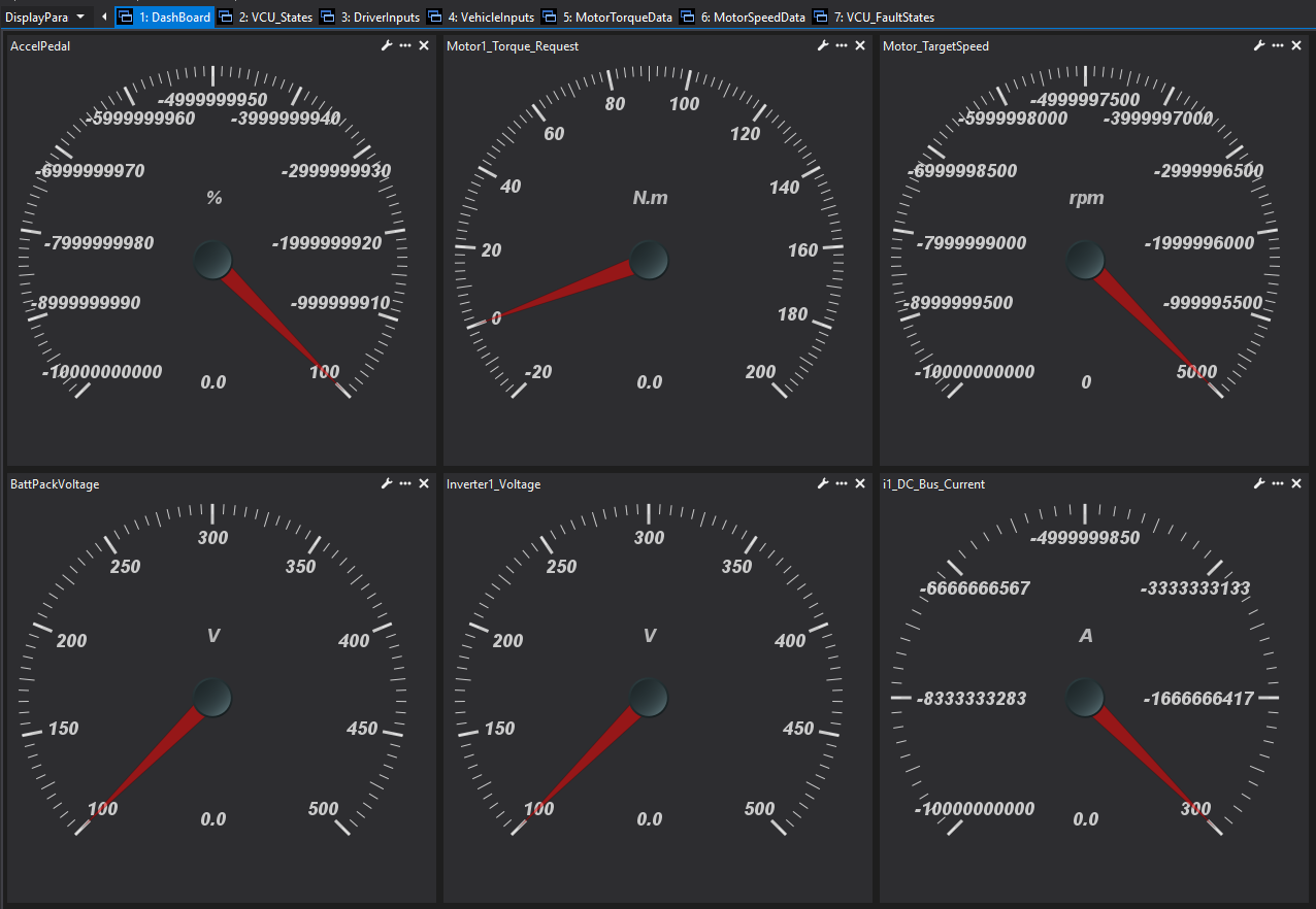

That's not encouraging. LOL.
Someone put stupid defaults for Minimum to -1e10.
Edit: After playing with it, I'd say it has potential, but it is certainly not as intuitive as AEM would like to believe, and I'd also say it's not ready for prime time yet. The fact that they have a disclaimer when you want to do a firmware update, and you have to manually reset the ECU (instead of prompt and go, or have a button you can click), is not quite polished enough for me.
