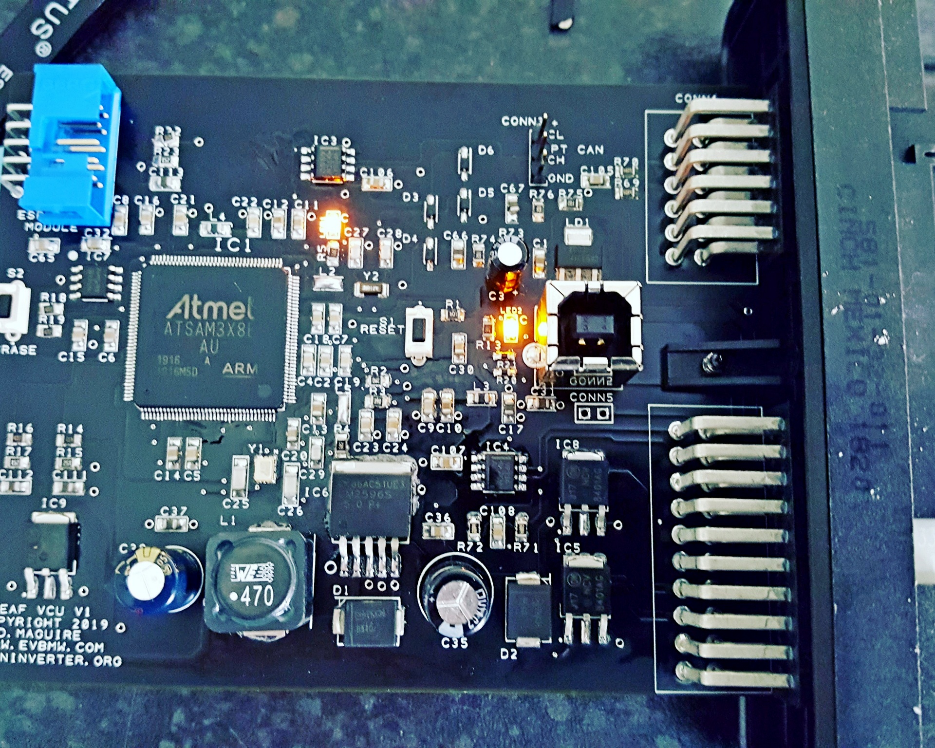

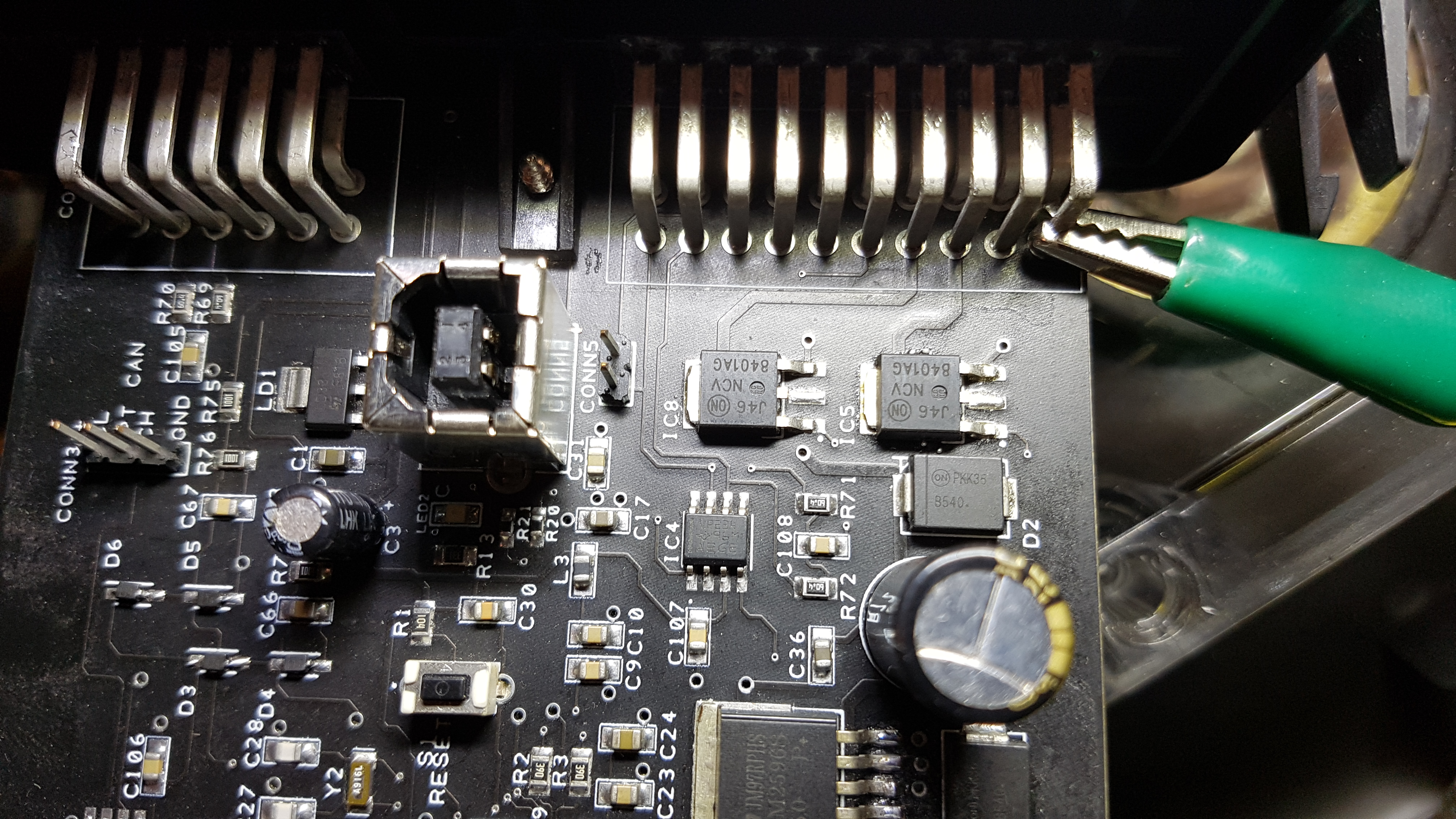

I tried to power up Leaf VCU v2 board and didn't succeed. As I've seen on photos here, there is a shottky diode on the power supply lane, with grey line facing other way.
Is it placed correctly on my board?

konstantin8818 wrote: Thu Aug 20, 2020 7:57 pm As I've seen on photos here, there is a shottky diode on the power supply lane, with grey line facing other way.
Note that both D1 and D2 in this photo have the grey line positioned away from the '+' symbol on the PCB. I've no idea if this is correct but they are consistent :?

Grey line represents "-" so according to silkscreen everything is correct, but here is early pcb design that was working correctly, according to Damien:
I believe same mistake is on this diodes as well:
Scheme differ from silkscreen:
kiwifiat
Posts: 99
Location: Vancouver, Canada
Been thanked: 11 times
Re: Leaf Gen 1 Inverter Board
Post by kiwifiat »
konstantin8818 wrote: Thu Aug 20, 2020 9:05 pm Grey line represents "-" so according to silkscreen everything is correct, but here is early pcb design that was working correctly, according to Damien:
Both diodes D1 and D2 are back to front on your board. Take a look at the schematic to confirm.

For reference, here they are on my board. Looks like they are reversed on your board. All working up to two days ago. More to follow on that :roll:

Flipped all diodes on the board. Now Led2 glows, but Led1 is not. WiFi also powered up.

konstantin8818 wrote: Fri Aug 21, 2020 8:17 pm Flipped all diodes on the board. Now Led2 glows, but Led1 is not. WiFi also powered up.
Shuld led1 glow if board is not flashed?
Led 1 sould flash once the v1.5 firmware is flashed onto the board. Led 2 stays on.
