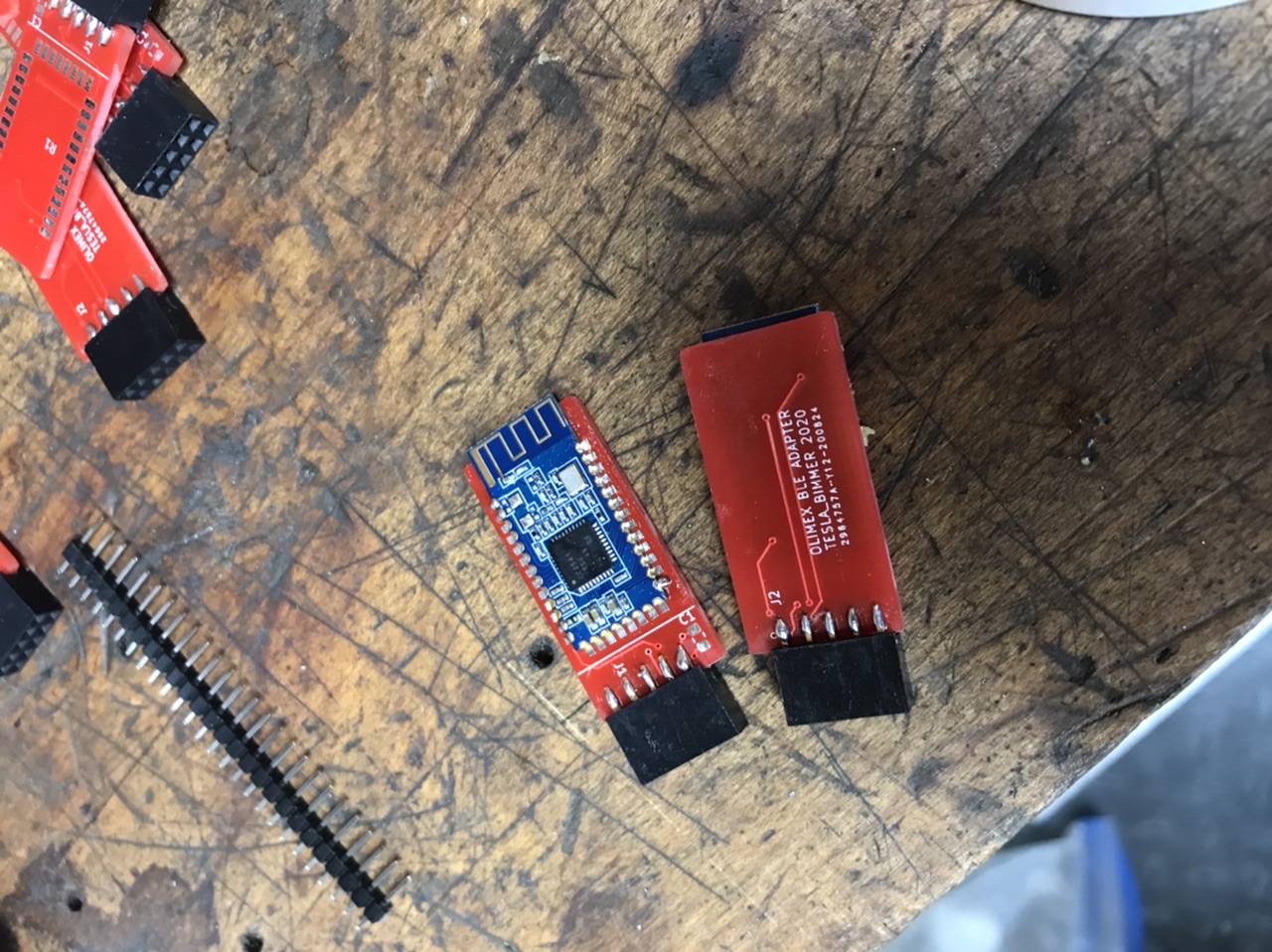

Just to add yet another dimension to all this dash stuff, I’m working on a web-Bluetooth interface since I find the WiFi connection can irritating when you have more than one openinverter based product in the car and/or you want to stream music. The BLE allows multiple peripherals at once without hijacking the phones WiFi data stream. I’m in the early stages and just getting a handle on parsing serial data from an HM10 device. So far the only real limitation I’m seeing are 20byte packets
The basic premise is the html and js files are hosted to a standard webpage and the HM10 provides the two way data interface.
Like I said, very early stages haha.

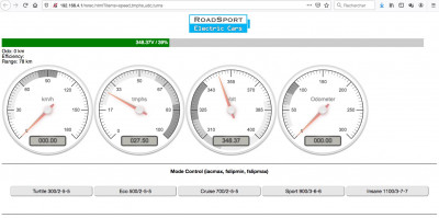

Thanks, I am waiting for custom CAN gauges, so meanwhile I had a draft written, to display main data and shortcut buttons to modify several parameters at once.
It's now uploaded, with customized copies of gauges.js and inverter.js
Basic but efficient display. Odo is based on "turns" but this value still needs to be tuned to real distances. At least I'll have computed data on efficiency (or battery discharge VS actual distance since start)
I am also working on an more elaborated algorithm to compute the remaining range in km, based on a sample of SOCs values during several runs.
To proceed on this algorithm, I shall need a way to store text values in a file. Anyone knows how that could be achieved ?
Maybe I can use this logging stream, emulating Johannes' log js script :
viewtopic.php?f=5&t=127#p1048
