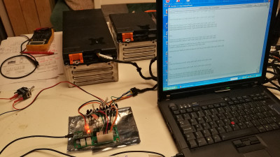

Thanks for your help Tom!
I just got first messages from 35.8kWh E-golf modules with SimpBMS.
Now let the tweaking commence!
I am now running SimpBMS direct to VW harness 5QE971690AE input connector.
1slave 4S3P+2*2S3P non-slaves now for test.
Can terminated at second slave connector.
Input enable goes from factory harness input connector to third slave input connector pin3.
I connected it to pin4 at second slave connector that is wired to input enable pin3 in first slave connector.
-Ask VW not me
-Ask VW not me

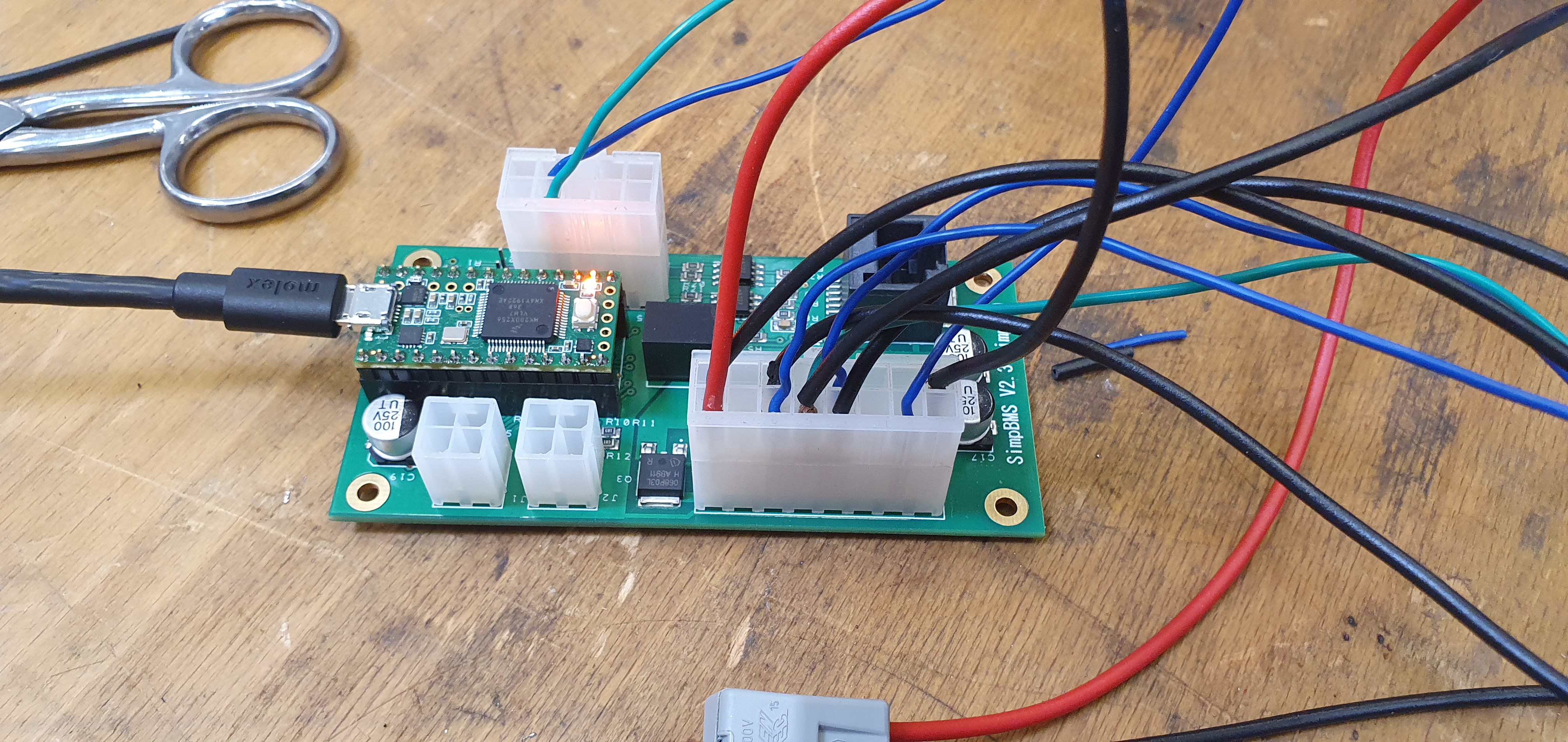

Re: Simp BMS
Hey folks,
My DC-DC converter recently died on me and I'm guessing it sent a voltage spike to the 12V system (and to the Teensy/SimpBMS accordingly) as my BMS was not able to communicate with the Tesla modules after the event. I don't have a way to prove this theory, but was tipped off by the Teensy troubleshooting page #3 most common problem: https://www.pjrc.com/teensy/troubleshoot.html
Good news is that I replaced the Teensy 3.2, reprogrammed it, and we're back up and running.

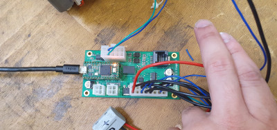

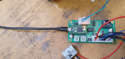

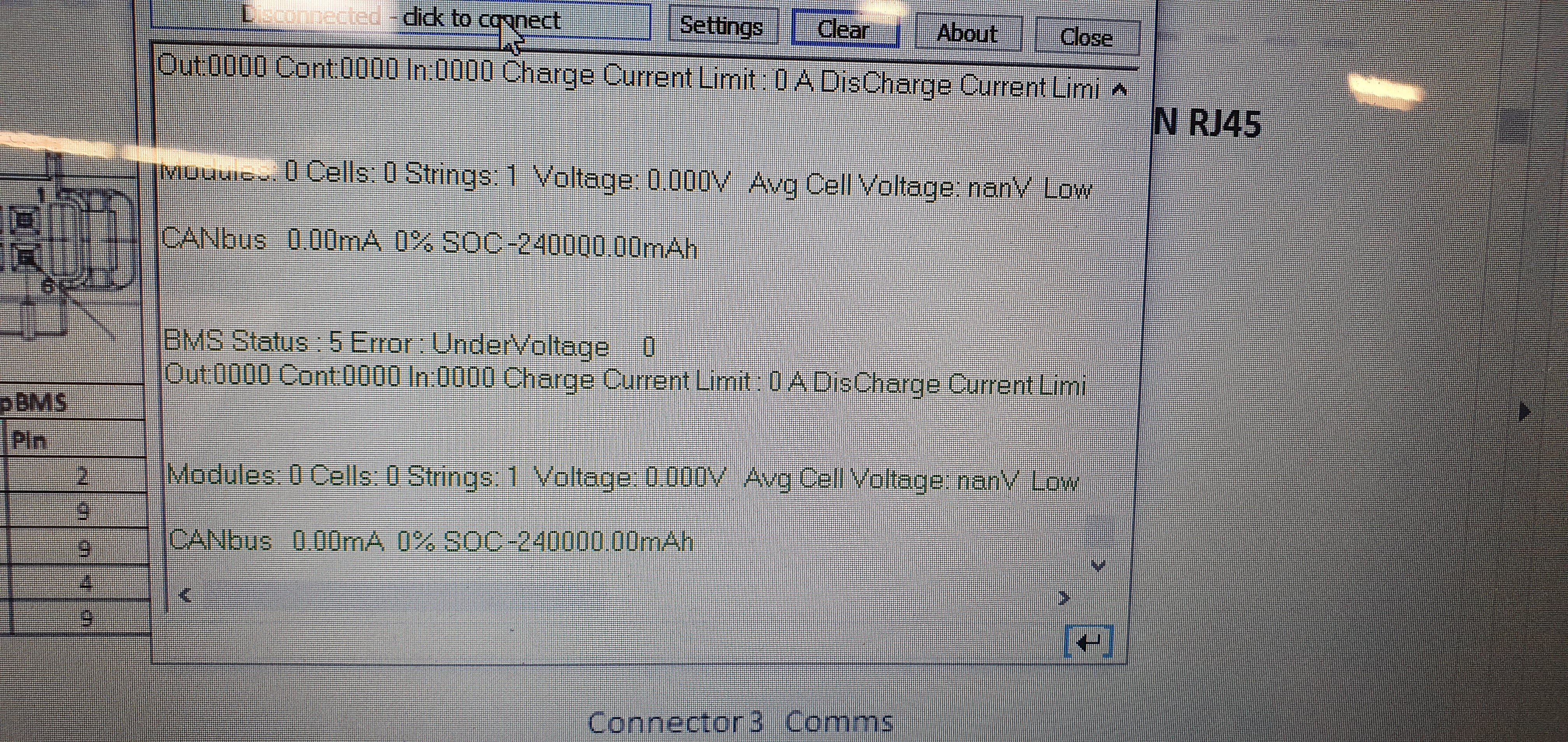

Re: Simp BMS
we are trying to connect the same module ( using the wiring that is provided in the manual ) to simpBMS but we didn't manage to get a signal.JaniK wrote: ↑Sat Aug 29, 2020 7:02 pm Thanks for your help Tom!
I just got first messages from 35.8kWh E-golf modules with SimpBMS.Now let the tweaking commence!
-Ask VW not me![]()
did you use a different wiring scheme than the one that is in the manual ?
can you provide me with the wiring schematics that you used ?
did you connect any contarctors ?
are they necessary if we have protection on the power side ?

Re: Simp BMS
Sorry for late reply.ghaz77 wrote: ↑Thu Sep 24, 2020 11:47 amwe are trying to connect the same module ( using the wiring that is provided in the manual ) to simpBMS but we didn't manage to get a signal.JaniK wrote: ↑Sat Aug 29, 2020 7:02 pm Thanks for your help Tom!
-Ask VW not me![]()
I looked at your pictures and heres my thoughts.
There is a small error in the manual.
1. You need to Swap can H/L on SimpBMS connector.
It is labeled wrong only on the wiring basics for the VW connector.
SimpBMS connector X5 pins 9/4 are swapped. (Tom knows.)
2. I put a 120R resistor on SimpBMS connector and also the last module on the wiring.
3. Also I needed to put the non-slaves to the slave module to get it working properly.
I have all the original VW wiring sorted and tracked. But my notes are a mess honestly. So I will share later when its easier to read by others.
PLEASE NOTE! Your module looks different than mine, (mine are Samsung, yours I think is Panasonic) so this is maybe not the way it goes. So do not connect like this if you are not absolutely sure!
(My module was working +nonslave-=+nonslave-=+slave-=simpbms) Tom told me to check polarity and I checked and also looked how the PCB tracing/wiring is connected in every module before i connected them. Also I asked all questions first for safety.

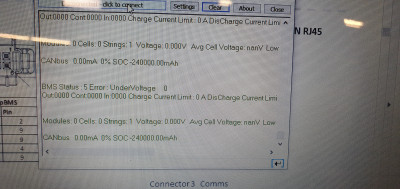

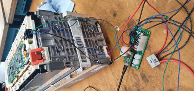

Re: Simp BMS
Hi Tom,
I bought the simpbms a while ago and have finally got around to installing. I'm running gen1 volt slaves on a lg chem pacifca 96s pack. If you see in the attached image it sees 96 cells but lists 99 cells in the read out, with cells 3,82,89 and 96 reading 0v. I've checked my harness at those cells with a meter and get 3.5v on each of them. Do you think this could be a communication issue?
- Posts: 2462
- Location: Bristol
- Has thanked: 217 times
- Been thanked: 608 times
Re: Simp BMS
It sees 96 cells, it does list the 0V readings reported by the slaves. Its just down to the structure of the BMS slaves, so if you see on top left of the read out 96 cells detected you are good.Dusty4 wrote: ↑Sun Oct 04, 2020 5:25 am Hi Tom,
