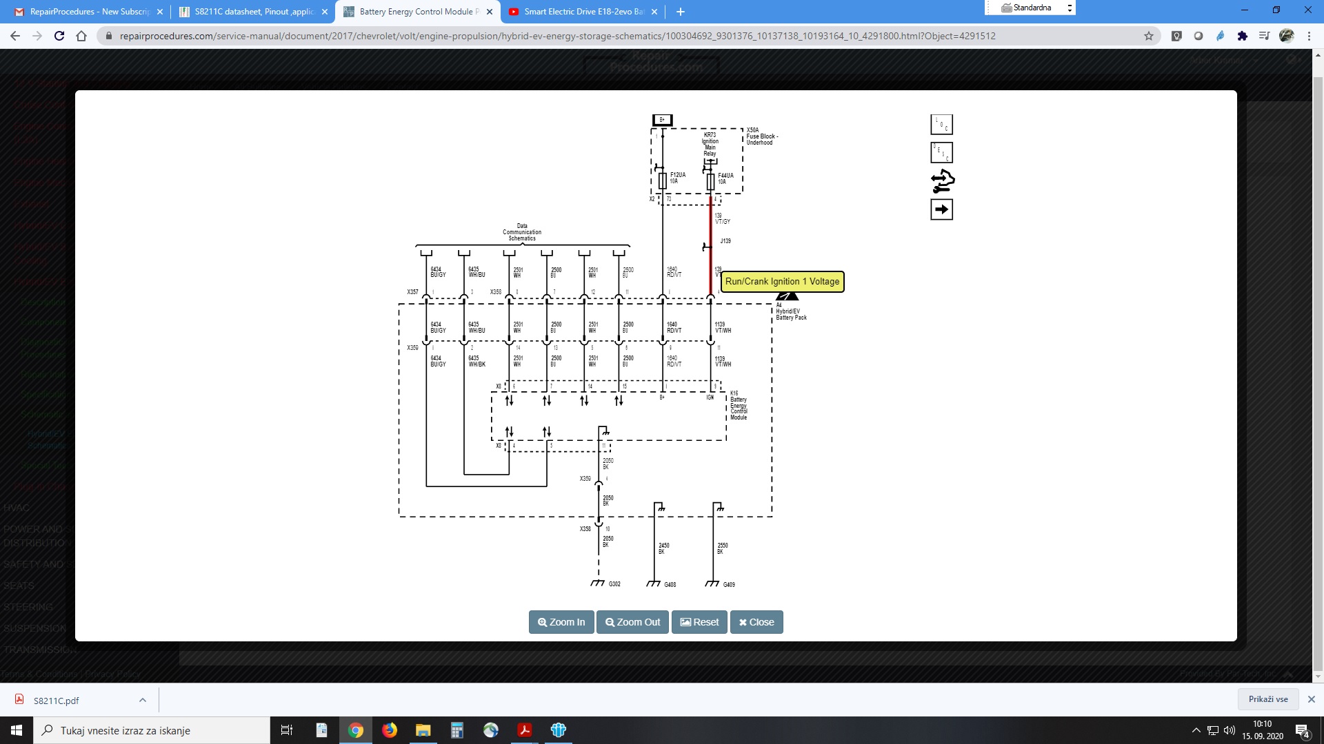

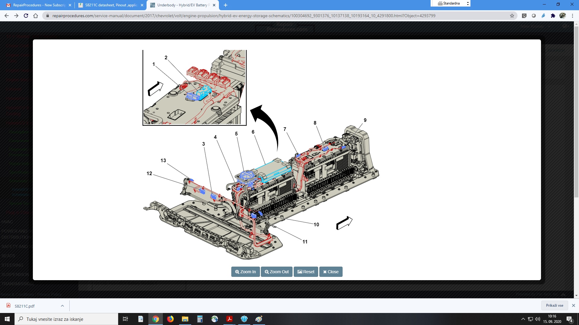

I have one 18kWh Volt gen2 2018 battery at home. Also i will get complete BMS with harness. Right now i am missing front face with current sensor and contactors. Also i have invested whole 15€ into accessing the Chevrolet workshop documentation here: https://www.repairprocedures.com/
Now i have pics of relavant connectors and schematics.
My intention is to fuse them together into original configuration and use the Fault output of BMS to signal the edges of cell envelope.
From schematic i see system uses 12V to power BMS and ignition signal +12V from key. Output is CAN signal and one 5V Fault signal line.

The way wiring schematic looks it still depends on HPCM2 which is located under the passanger seat.
But charger and DCDC this time are not run by CAN bus but rather by PWM signal which is more characteristical for coolant pumps and fans...

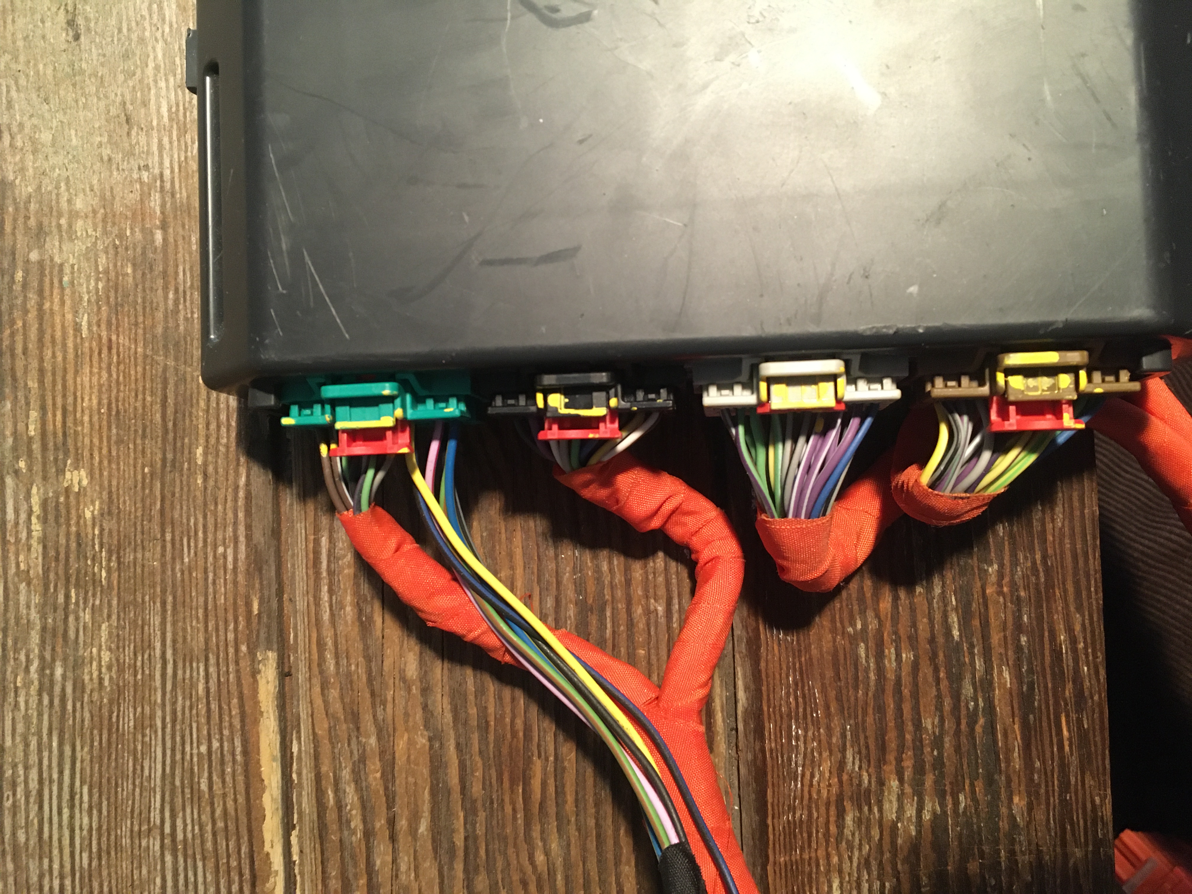

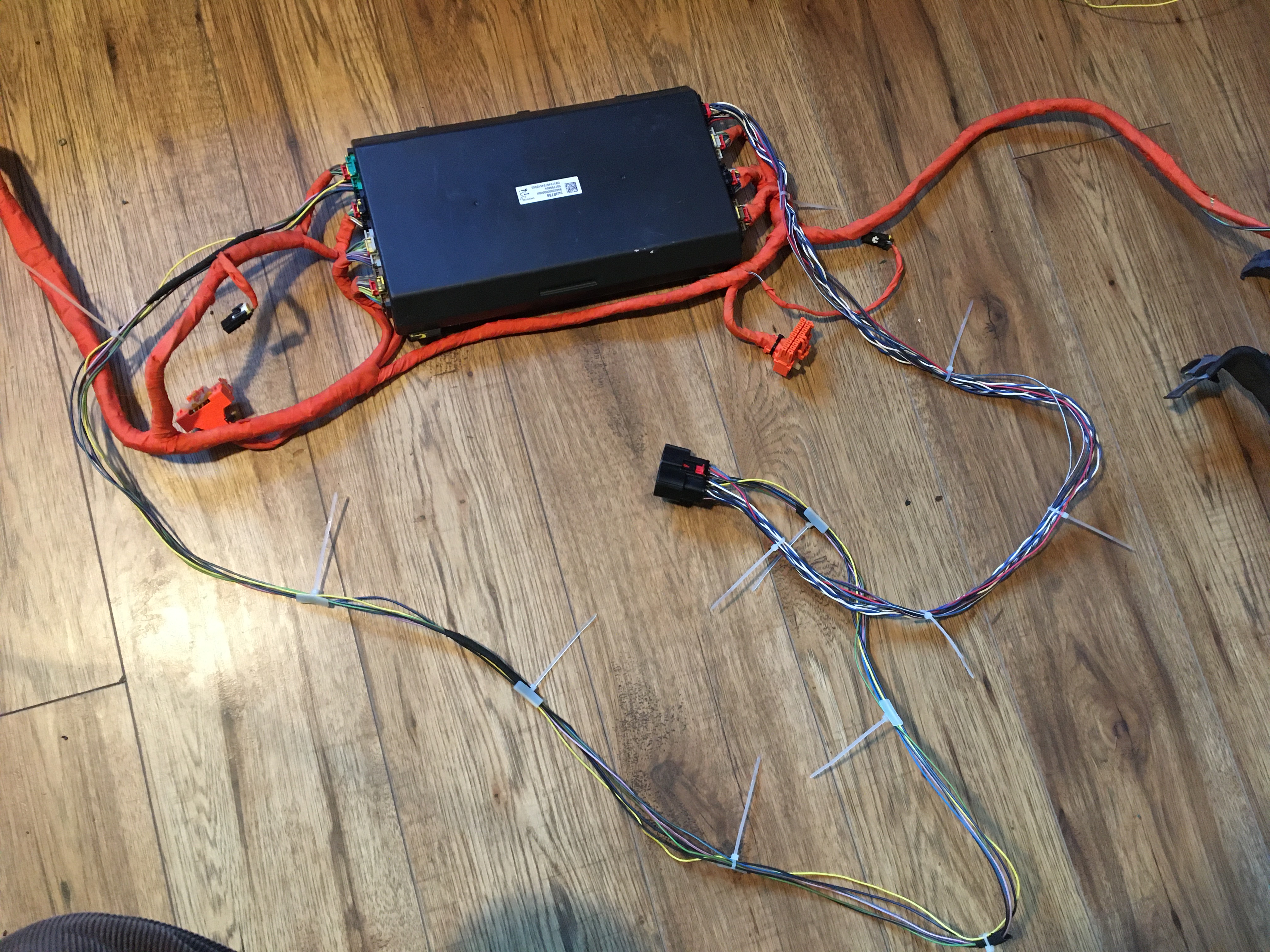

new bms harness is in. it seems there might be some year variation between the gen2 battery. the connector interface to the face box (contactors/heater/current sensor) are different.
connections to the battery and bms are the same.
Posts: 1011
Has thanked: 180 times
Been thanked: 372 times
Re: Volt gen2 BMS

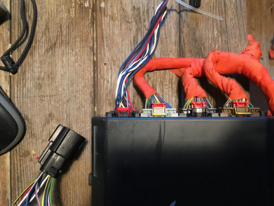

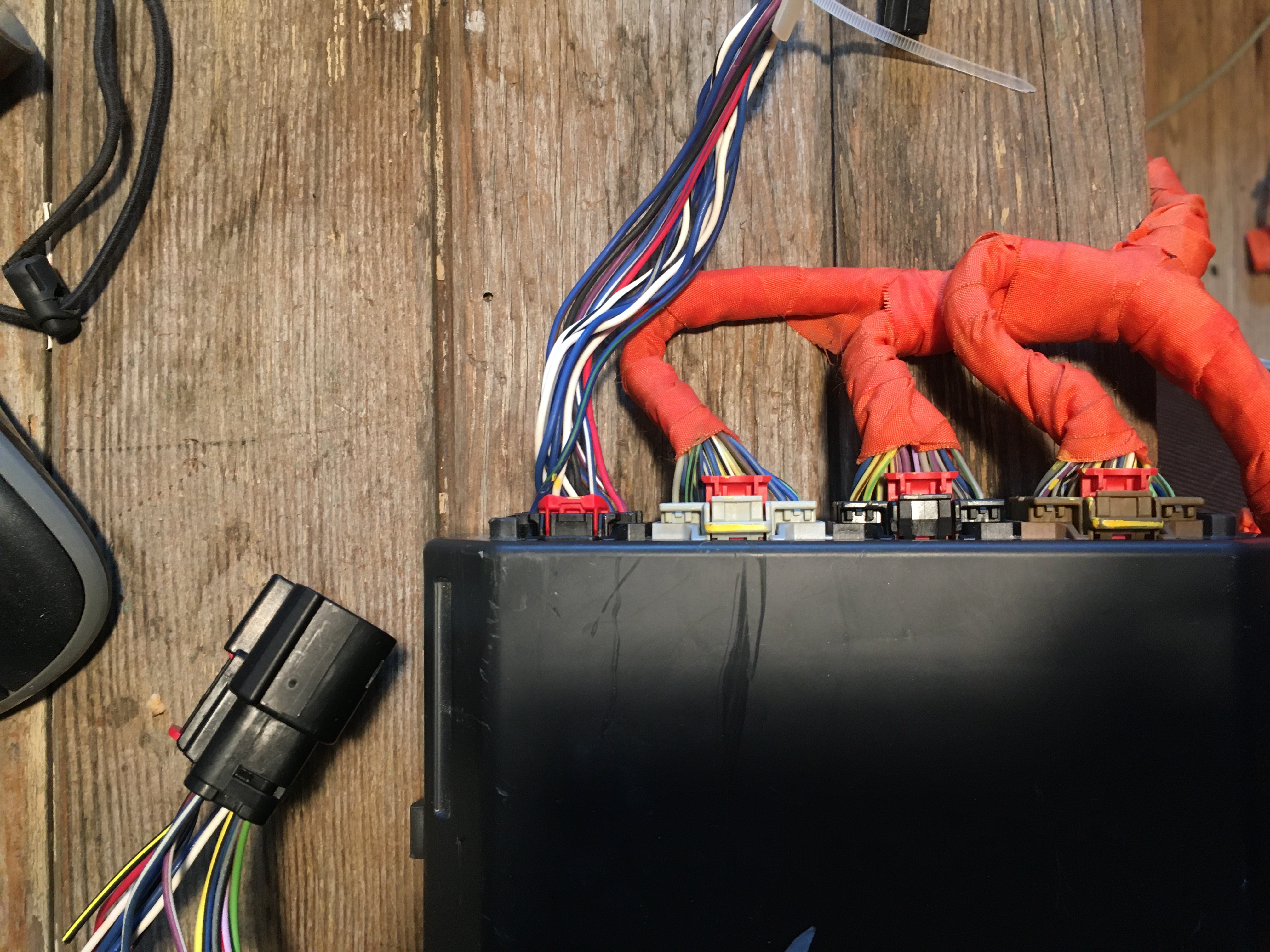

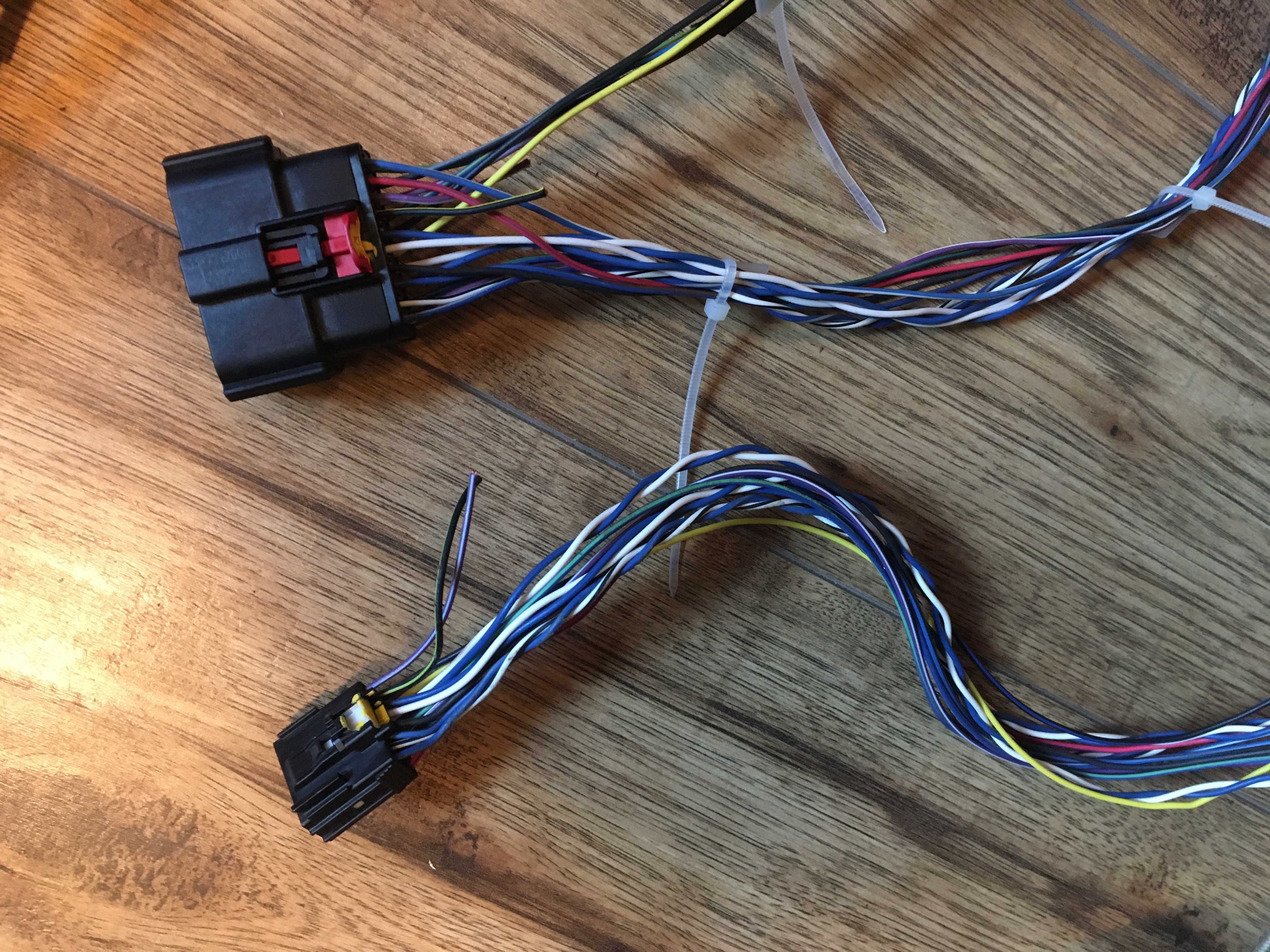

mid year change in bms harness. Must be connector cost reduction.
my new harness won’t interface to the old relay box harness. see connector difference:

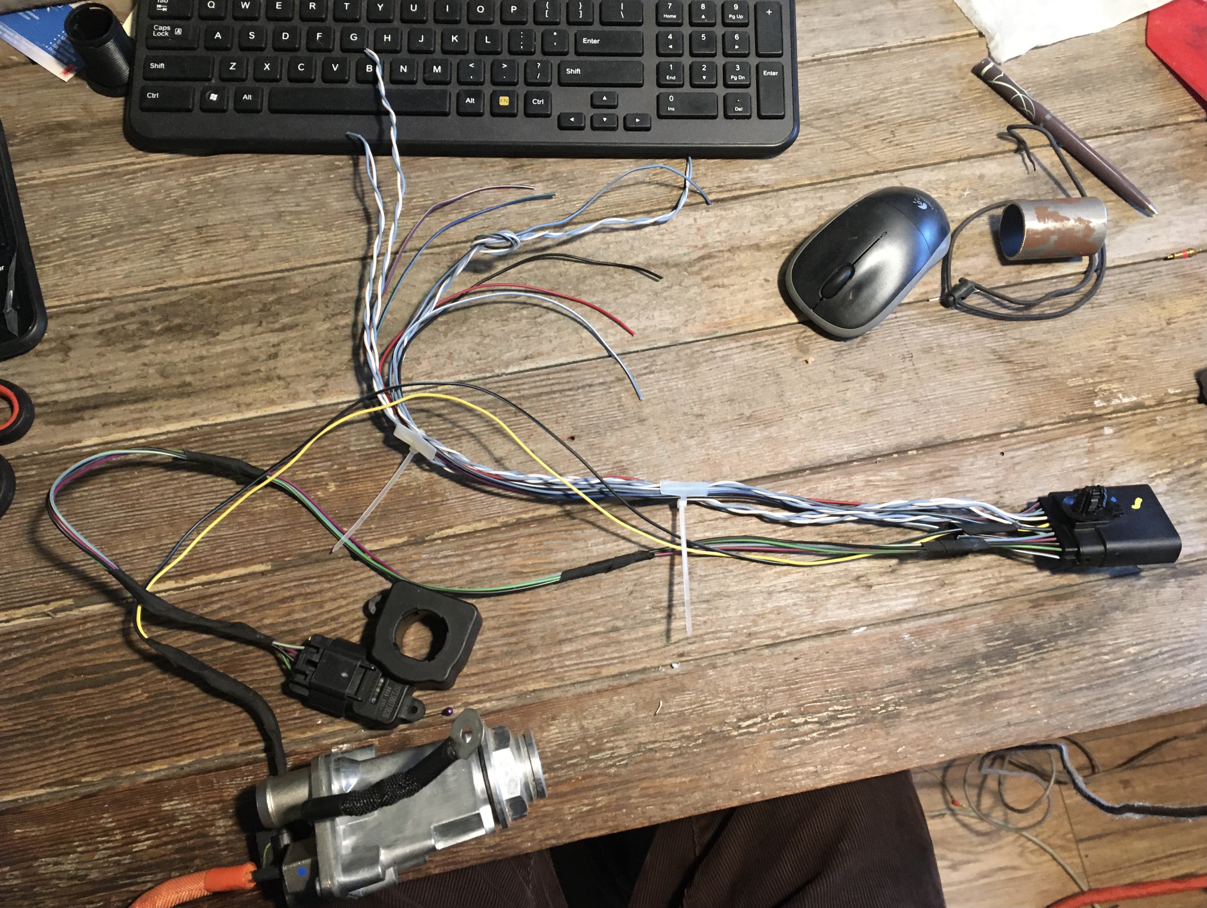

Separated the harness, and split out the stuff for everything other than cell voltage and cell temp monitoring. Taped it all back up. Then swapped over what was left of the older harness with the new.
Half of the green connector takes in some cell and temp signals, where the other half takes in the water temp and current sensor, which are part of the relay harness.
These 6pins where the only pins I needed to swap on the connector. Everything else stays.
On the other side of the bms box the black connector directly across from the green one handles all 3 can lines, power, ignition. This is easily separated from the loom.
Once separated, there will be 2 lines for heater temp that rout to the green connector, and 2 lines that rout to the service disconnect. Service disconnect lines you can ignore as these do not interface to the bms.
now with that all swapped over, the relay box/heater/current sensor loom plugs in with the old connector and I have the lines needed to start testing.
relays and water heater are not controlled via the bms, like arber stated earlier.
The faceplate connector ends where cut off as I’m not using the face plate. so that leaves just 3 Canbus’s, 12v power, ignition signal, 5v fault?

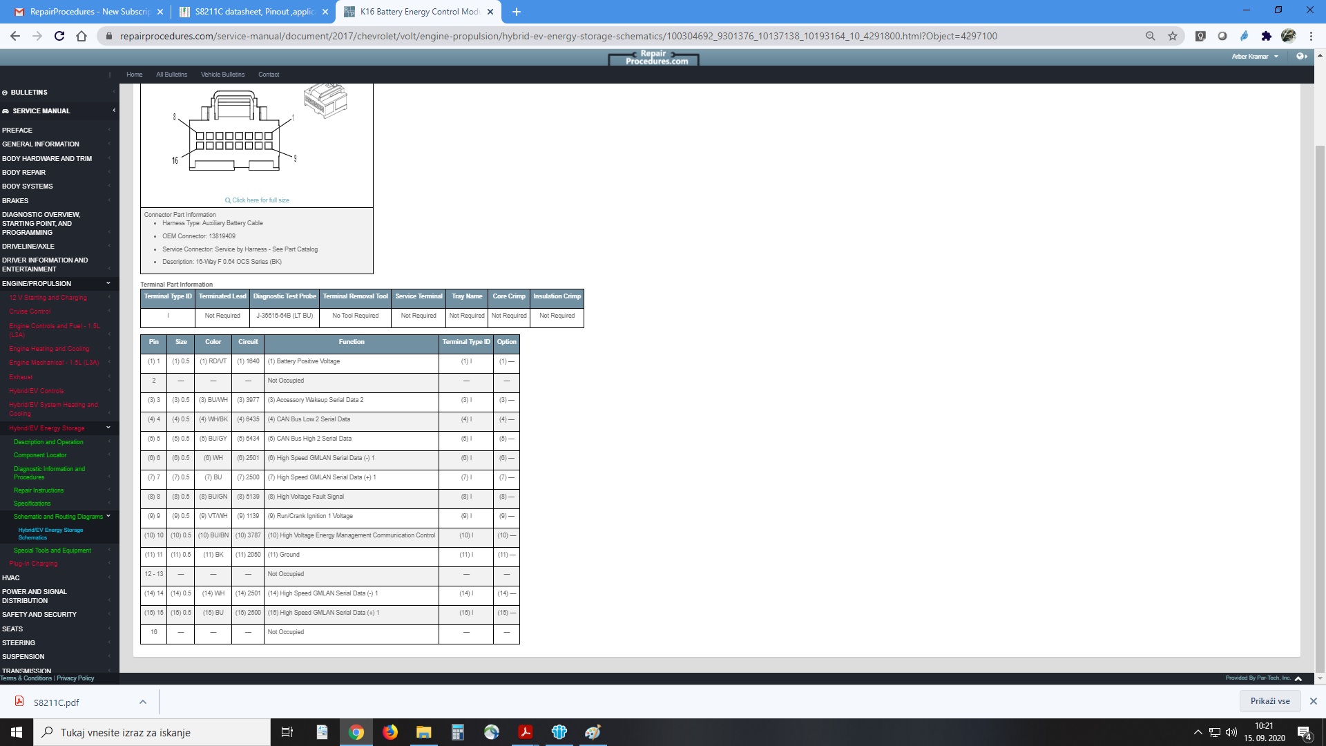

@arber333 do you have anymore photos of pin out from the manual?
Posts: 3577
Has thanked: 134 times
Been thanked: 342 times
Re: Volt gen2 BMS
Bratitude wrote: Fri Oct 30, 2020 6:02 pm The faceplate ends where cut off as I’m not using the face plate. so that leaves just 3 Canbus’s, power, ignition and a few others wires.
@arber333 do you have a photo of the pin out diagram from the manual?
Yeah i have them and i will upload them to my github. I am working on Outlander charger interface right now so please bear with me.
Also you do need to connect Current sensor into the BMS master unit. It is located on the front panel behind contactors and it seems to be DHAB S/51.
https://github.com/arber333/Volt-2-BMS

And yup! the current sensor from the face plate and the water temp sensor are connected.
